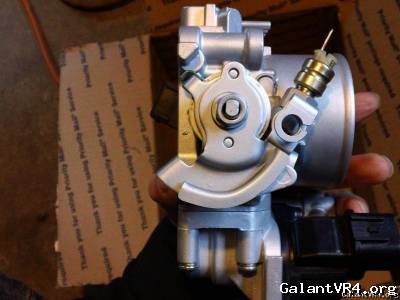

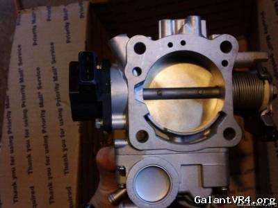

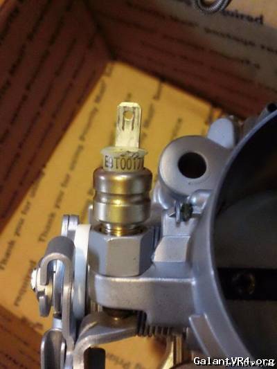

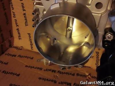

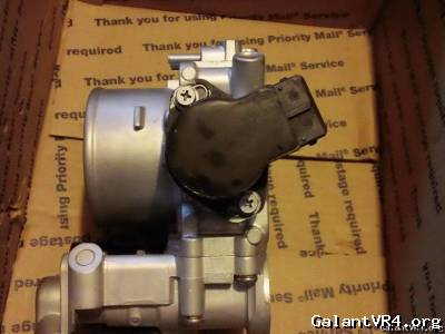

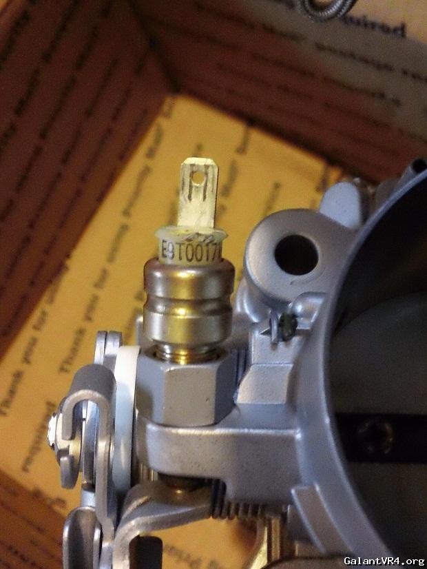

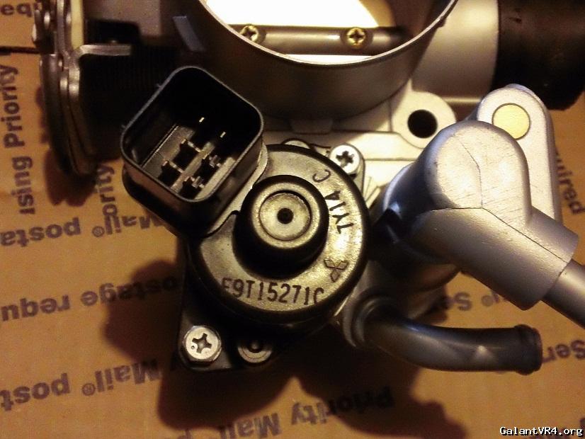

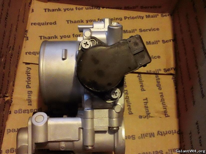

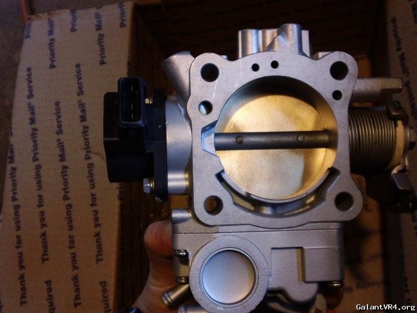

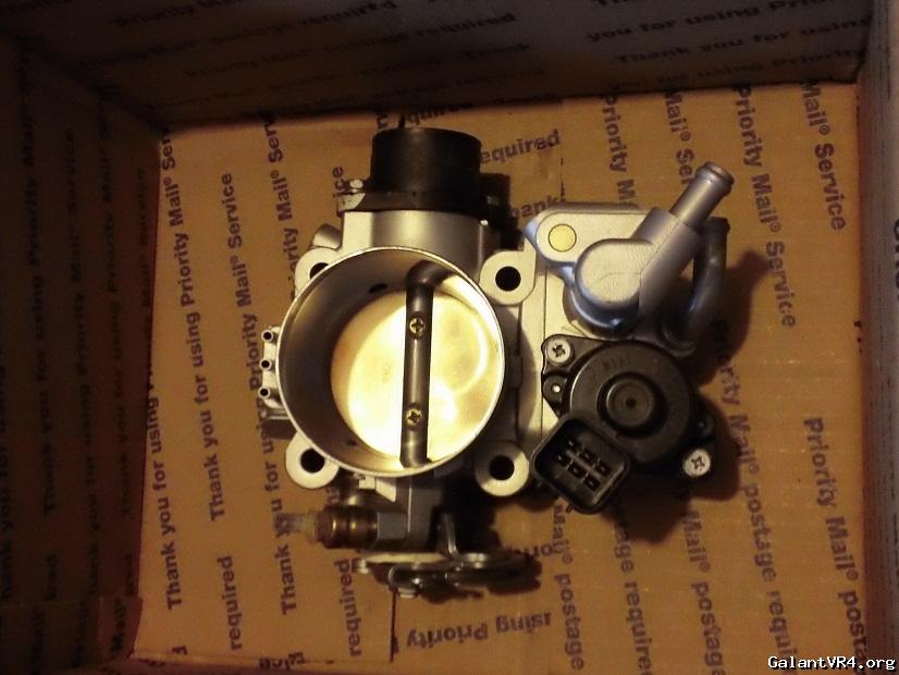

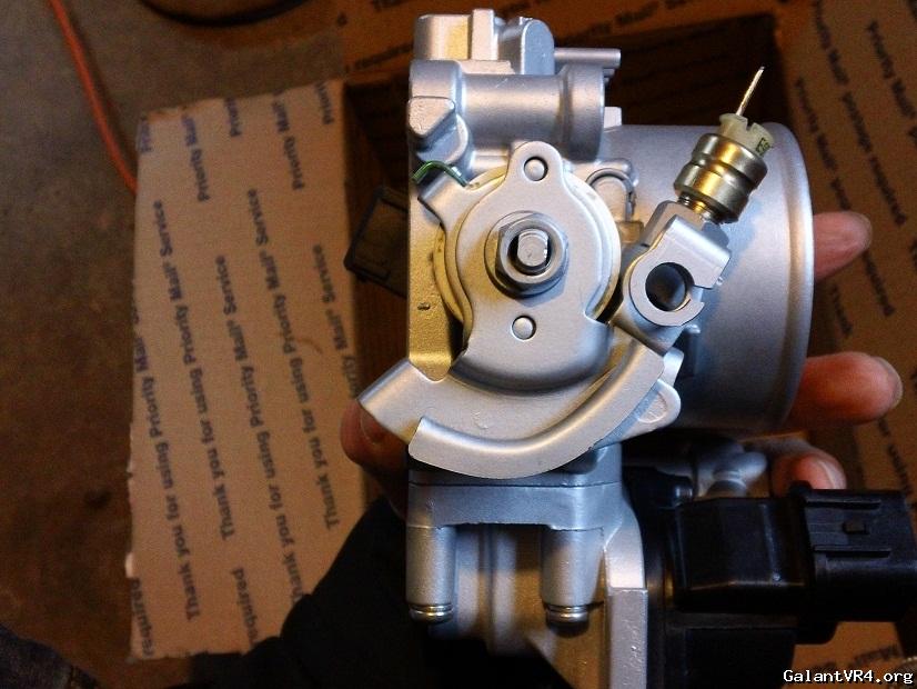

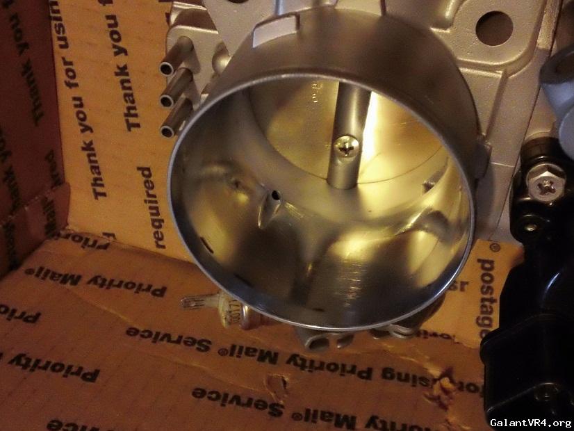

Got my N/T TB back from Steve Monroe. Sent my TB out Monday and got it back today.
Worksheet:
*Inspect
*Disassemble
*Clean & bead bast TB & parts
*High PSI air blast media removal from all openings/follow-up probe of openings
*Paint all steel parts
*Taper/polish thick lip of TB entrance (Did not bore to 65mm)
*Chase BISS screw threads & install new BISS screw & o-ring
*Install & lube shaft seals (Upgraded to "Uber Seals good to 40 psi for precaution)
*Install throttle plate
*Loctite throttle plate screws
*Install throttle level assembly
*Install FIAV using new o-ring gasket, screws, & washers
*Test sensors (ISC & TPS replaced)
*Test throttle plate for smooth operation
The revised ISC I had on the old TB was internally corroded. The TPS was replaced too, but he didn't specify why. Both sensors are warrantied for a year. I also got four correct-length bolts and a new non-OEM gasket supplied by Steve. Chose not to delete FIAV with block off plate. If it turns out to be an issue later, then I will do the VFAQ free-mod. Looks very nice.

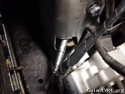

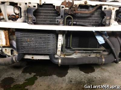

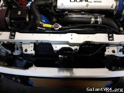

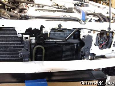

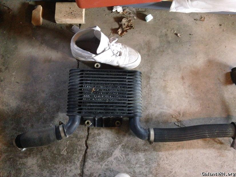

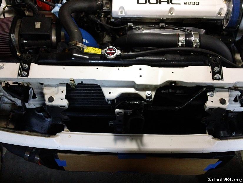

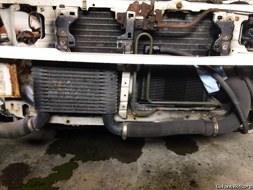

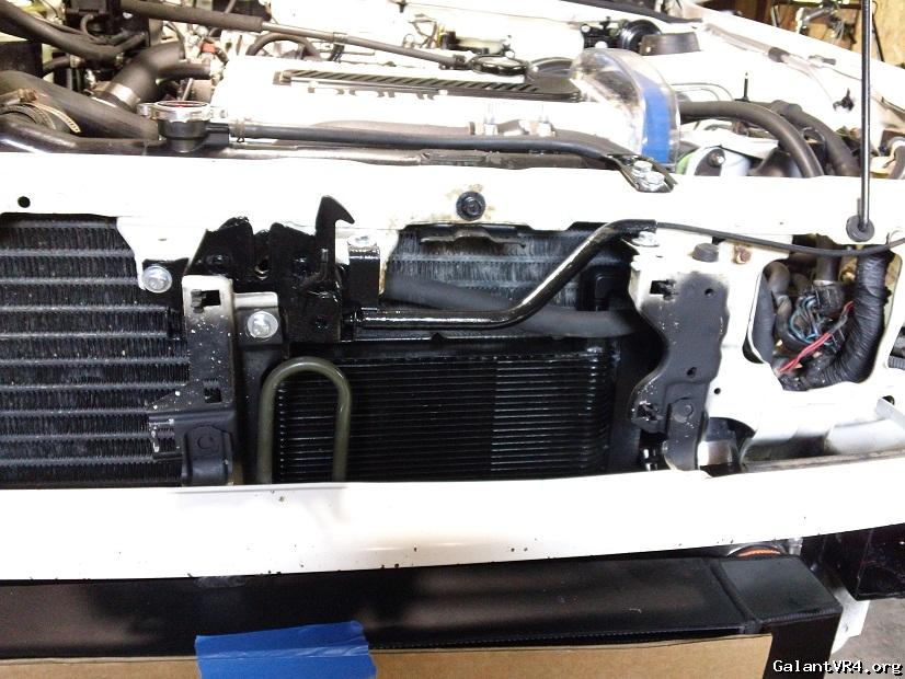

Decided to take a huge, but much needed step and removed the stock intercooler setup. Taking off the front bumper was a pain due to a few broken bolts. One of the previous owners tried to take it off before and must have gave up after shearing bolts. One of the two thick bolts removed from top. Thanks for that... Well after some dremeling, we got the bumper off. Both fog lights had every screw stripped and rusted, so we had to dremel the side bracket to get them out. I got one bracket off on the PS side, but sheared two out of the three bolts. God damn it. I'm going to let my buddy do the other side. He seems to have broken less bolts than me.
The oil cooler leaks a bit, so that's why I have the towel there. I will drain the oil and make sure everything is nice and tight before the oil cooler gets sandwiched. The oil cooler should not be the same size as the intercooler though. Aiyahhh...
Comparing said aiyahhh intercooler to my moon boot. Aiyahhh...

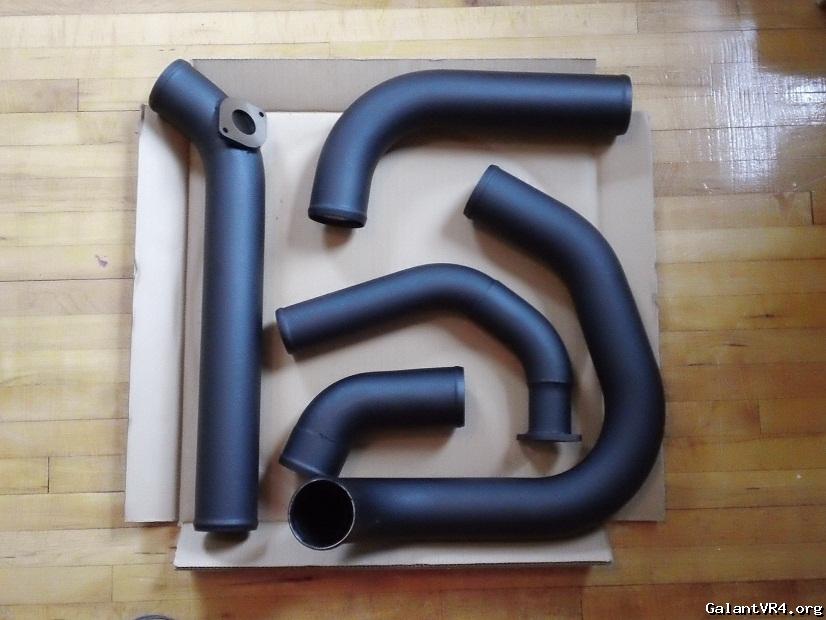

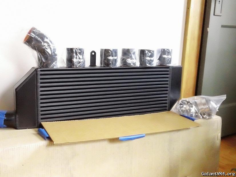

Got a giant package in the mail. Came with the extra coupler needed to work with the N/T TB and they removed the elbow flange. BOV flange is for GReddy. Decided to get the intercooler anodized classy and sleeper. Couldn't get gloss black to go with my whole theme, but the wrinkle black piping is still very nice. It is supposed to be more durable, which is why they got rid of the gloss option. Robert was great to work with and even gave me a little discount. Thanks so much. Hacking to come. No turning back now...

I Like the first picture, has the leading edge vibe going on. Is that an ETS unit? Good stuff mang. Also, good bet on Steve Monroe. He puts other throttle body restorers to shame.

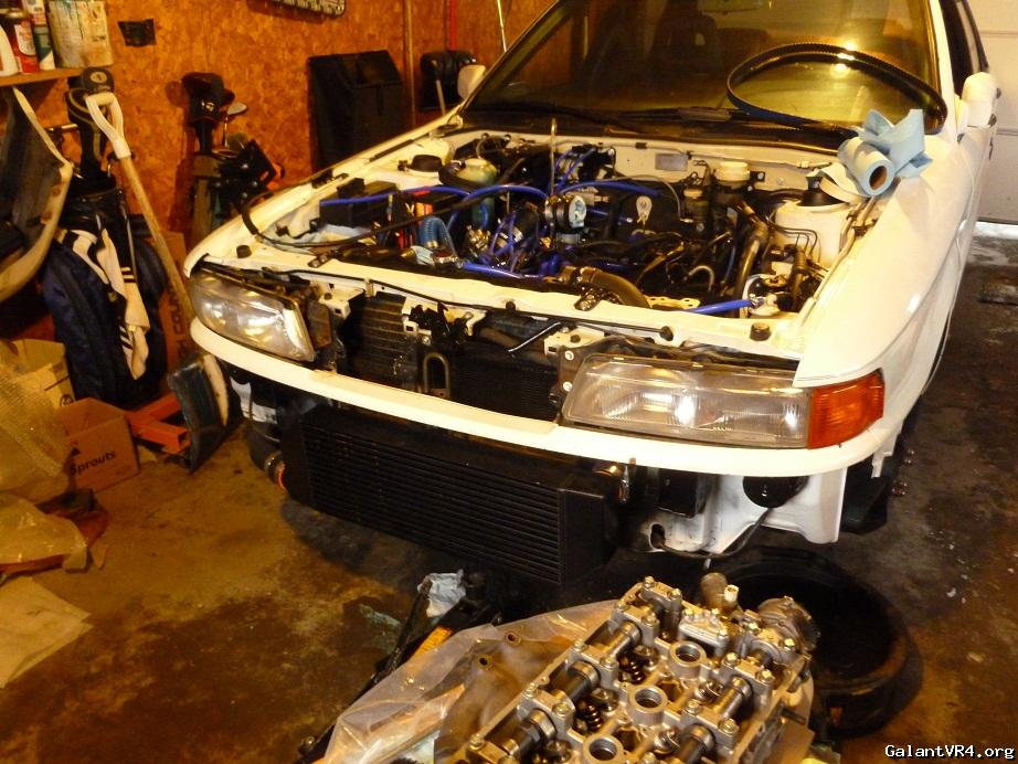

Lots of updates to come, but I am way behind again.
Back in July, I got the ETS kit installed to the NA TB without a hitch after Robert at ETS relocated the BOV for me. Installed a used GReddy RS recirculated BOV to the new location and am using a Home Depot spa hose for the recirc tube. The tube is somewhat ghetto and it bothers me a lot. Will probably try to get a metal recirc pipe made and use couplers on both ends.

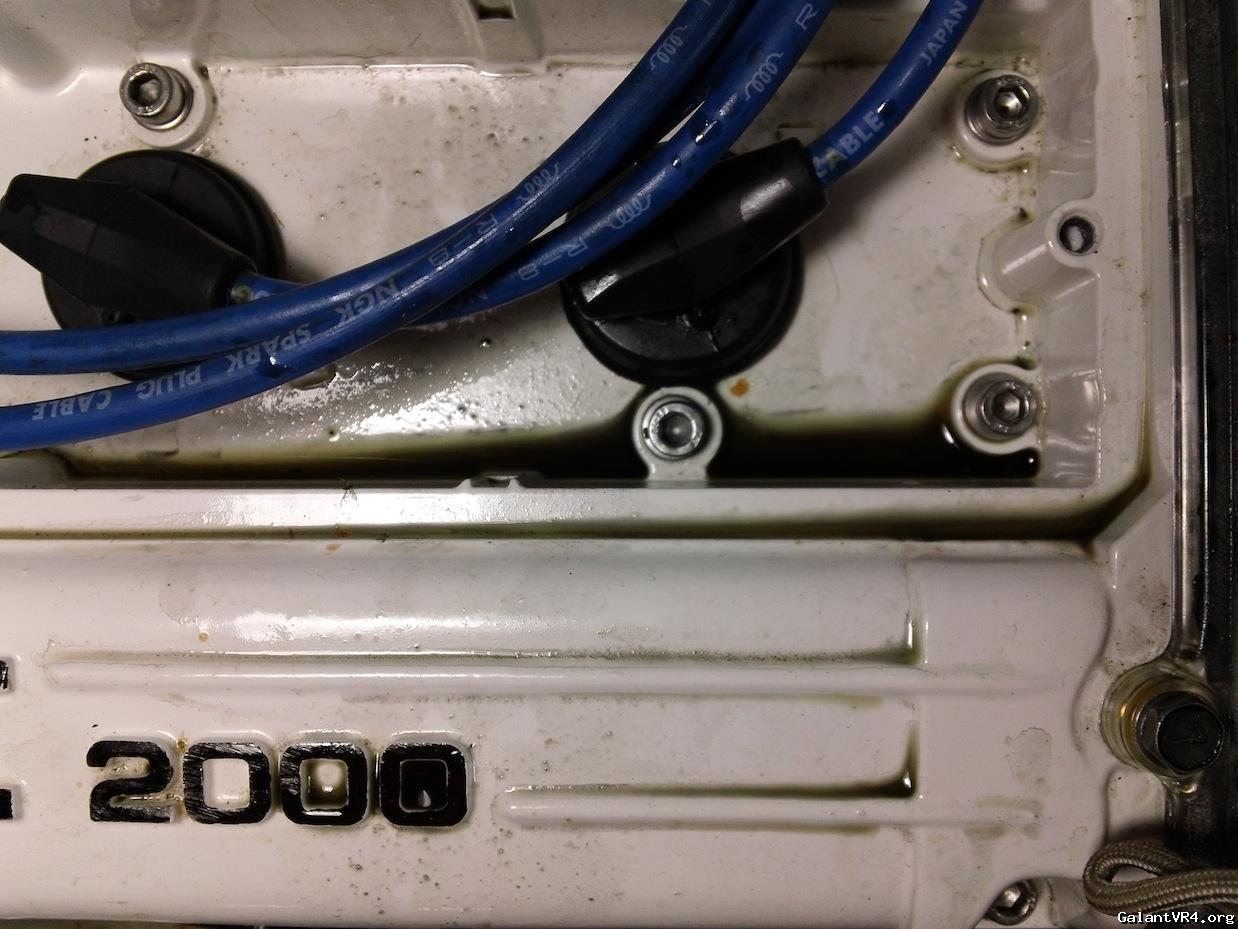

Also, tried to fix my leaking oil cooler setup by using Permatex thread sealant for oil and tightening it all down. Relocated it too, so it wouldn't be behind the new intercooler. Had to remove the A/C fan, which I forgot to mention earlier because the lines for the oil cooler kit wouldn't reach to the passenger side. Gets decent flow from the grille area now.
Took the car out late July for a shakedown. Had my buddy Charles do the driving again. He took it easy for about 30 or 40 miles doing break-in because the car is still not tuned yet, just a base tune from link. Like I mentioned before, I can't drive manual yet. My friends convinced me to take the car down a few mile flat stretch to try to learn a little. Killed the car a few times, but no bucking really. Felt so good to be able to drive my car for the first time since I've owned it. That feeling is priceless. Got nervous, so my other friend Moses took the car for a spin. He got on it a little bit once the freeway opened up to see what she was made out of and that's when this story goes south. The BOV purged at 4K rpms and then white smoke starting pouring out the hood. Limped the car back a few miles and cars behind us must have been worried.

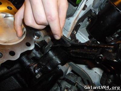

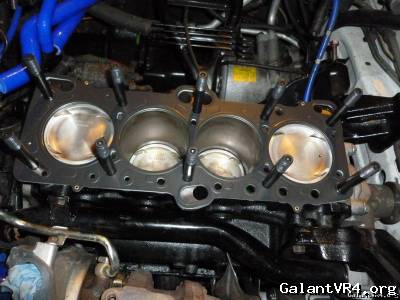

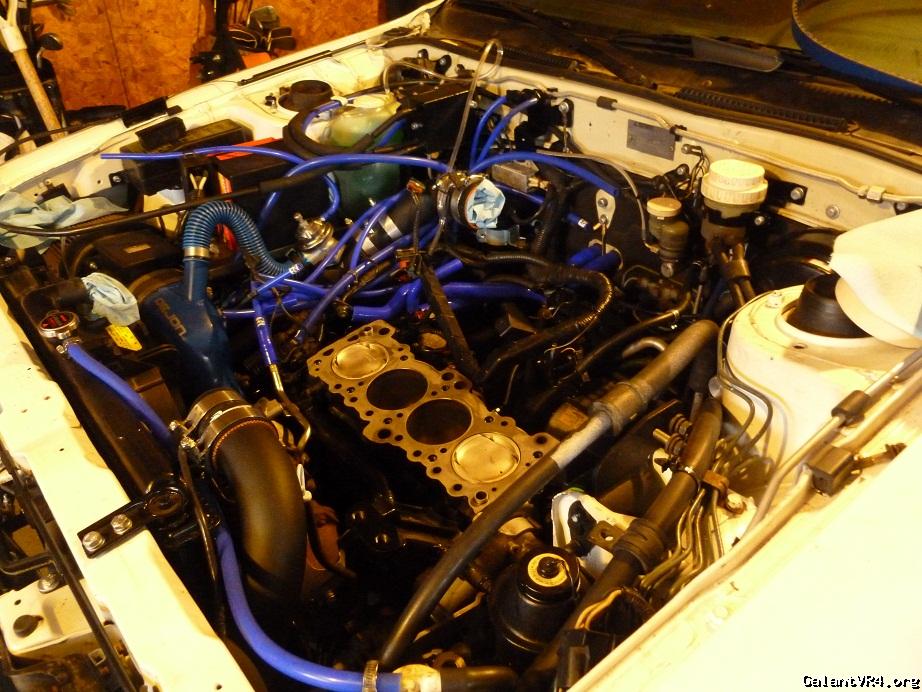

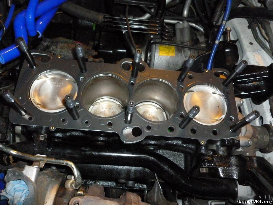

The head gasket must have blown... Oil was all up under the hood and pooled up in the VC area. Everything I had cleaned had become dirty once more. This is not what I was expecting. Opened up the radiator cap and cappuccino was all up in it.
Started breaking everything down to replace the OEM MLS with a 1.2mm HKS head gasket. Had the head sent in to Miller Hill Machine Shop for checking and resurfacing. The head was off .004. Before putting everything back in, my other Matt friend cut off part of the power steering bracket that gets in the way of the exhaust manifold, so I can drop down the head with everything connected on top of the studs. No contact issues anymore and probably no exhaust leak since the head can sit square with the larger casting of the Evo III mani. I believe the 2G and EIII mani are thicker flanged on the far right side. There must have been an exhaust leak from that area because carbon deposits had accumulated.
More to come later once I get reorganized. Still months behind on updates though.

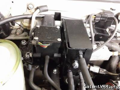

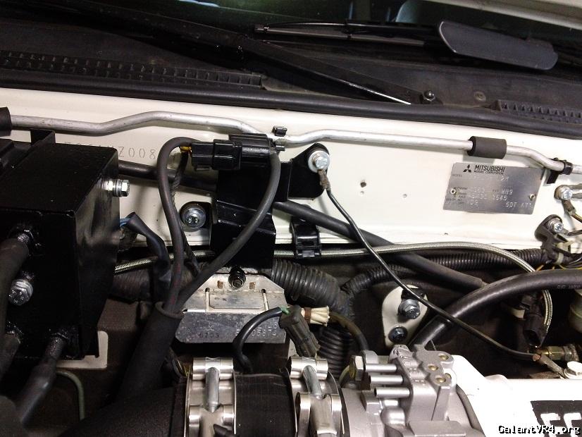

Here's a pic of the ETS kit installed. Also, I got OEM AMG corners and had them wired up by my buddy Charles to replace the Curtis corners because I got a RS Evolution Spec bumper. It also clears the intercooler nicely.
Replaced every single vacuum line minus the brake booster hose with blue silicone from SiliconeIntakes.com. RRE could not get a kit for me in blue anymore. Ordered as a general kit. Also, replaced all the coolant hoses with a kit for 1G DSM from RTM. Since the radiator hoses are for 1G DSM, I had to trim the hose a bit going to the t-stat housing. Have yet to put on the lower, but I am assuming it might need to be trimmed as well to fit. Lastly for hoses, I replaced the windshield washer ones with new clear hose. You can see where I have the BOV and recirc tube located too.

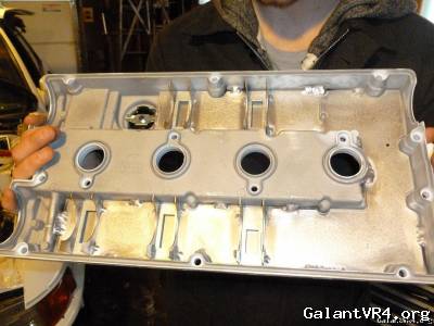

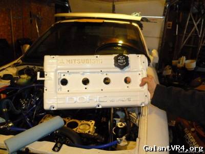

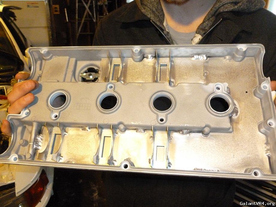

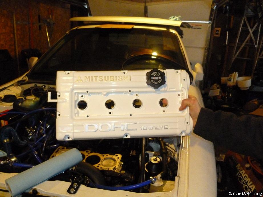

Had my Mitsubishi valve cover restored since it was ruined by a shitty sandblaster. Ordered up a new laser cut baffle from Kevin Kovatch, a freelancer on DSMTuners and owner of CompWorks. My buddy Matt took the old baffle out and had his work do the cleaning, blasting, welding in of baffle, and re-coat. Turns out they did a bad job welding in the baffle once I went to test-fit. Since there was contact with the cams, I had to order another baffle and have someone else do the work properly. Sent the valve cover to Detective Coatings and they did an excellent job removing the poorly welded baffle and put in another one. After another coating of gloss white and some polishing of the letters, I am very happy with the outcome. Replaced the Bonehead oil cap with the Evo cap and I like it.
HKS 1.2mm Stopper head gasket. This was a pretty spendy item, so I hope it will help.

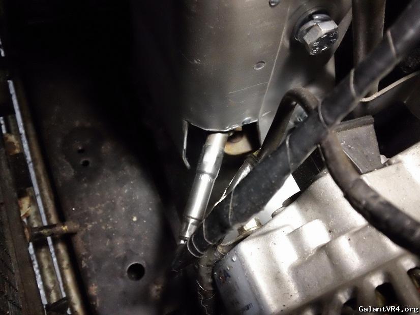

This is from a while ago, but thought I would mention it. Since I am using the 2G O2 housing, the NTK oxygen sensor I'm using gets in the way of the lower heat shield. Took a small notch out to clear.

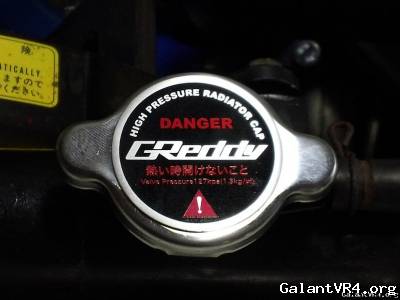

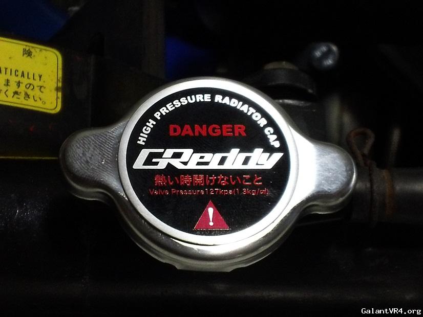

GReddy radiator cap to replace the old OEM one.

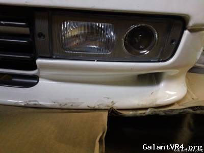

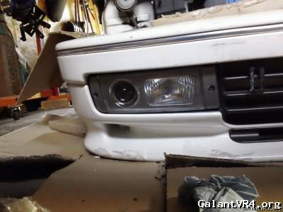

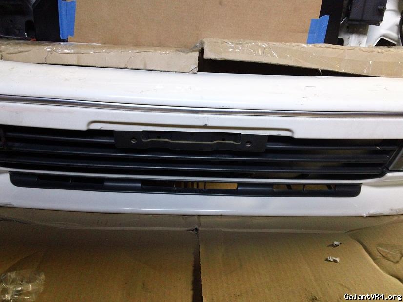

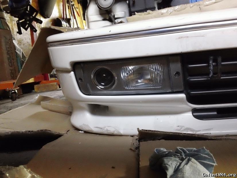

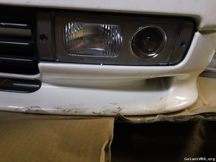

RS Evolution front bumper. I wasn't planning on getting one so early, but it just happened to be available on ebay shortly after my buddies helped me trim the crash support on the USDM bumper. Will get the most flow to the intercooler, which I consider an upgrade and it's light. I didn't cut the slats out of the USDM and I will not cut the slats on the RS either. Love me some slats. Bumper is in pretty nice shape too and no cracked end caps, just a bunch of tape residue. Need to get the fogs wired up as well. My buddy Charles should be helping me on that. Picked up some JDM brackets from Curtis, which are very nice. I couldn't get a wider shot of the bumper since my garage is cramped, so these are just teasers. The look of the black intercooler against the black slats will really keep it sleeper.

Thanks Shane. If I would have kept the valve cover red, then I would have also went with the Toda timing belt and red everything else. Since I am using the Zaklee timing cover, I felt that the whole color theme should revolve around the belt color. The GReddy RS BOV is even blue at the recirc fitting, but that will be hidden. Always liked the panda theme, but wanted blue accent. The damn Cusco bar has blue ends too! I like how some guys went with the HKS purple theme like James Foster and this was my take on a GReddy blue theme. Couldn't find compatible GReddy cam gears, so went the Fidanzas. I don't like mismatched colors in the engine bay really for aftermarket parts. The car is still more about go than show, but I want it to be show capable. It's also more of a street car, but I want it to be track capable too.

I also want to mention that the CM exhaust had a stainless bung welded in. Hooked up the AEM wideband sensor and also have the failsafe gauge powered up and connected to read boost as well. Still need an AEM oil pressure gauge. Both will go in the '89 underdash pocket, so the car appears stockish even with the Momo steering wheel. The 2G knob keeps it stock looking too. Will need to have a plate made to house both gauges though. I like having two gauges in one, but we will see how it works. Later on, I might actually try to get the failsafe feature of the gauge operational. With Link, I am going to change the stock boost gauge to a coolant temp gauge and I will be all good on gauges.

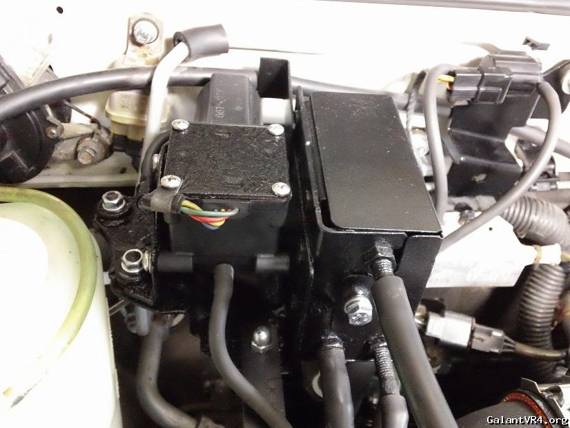

Hooked up the Greddy Profec B Spec-II boost controller to power and installed solenoid, and lines. I will have to relocate the solenoid closer to the turbo though. Was hoping the controller would fit in the ashtray, but it doesn't close all the way. Still need to install the HKS turbo timer.

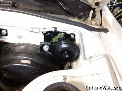

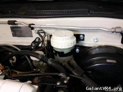

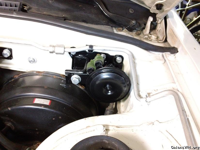

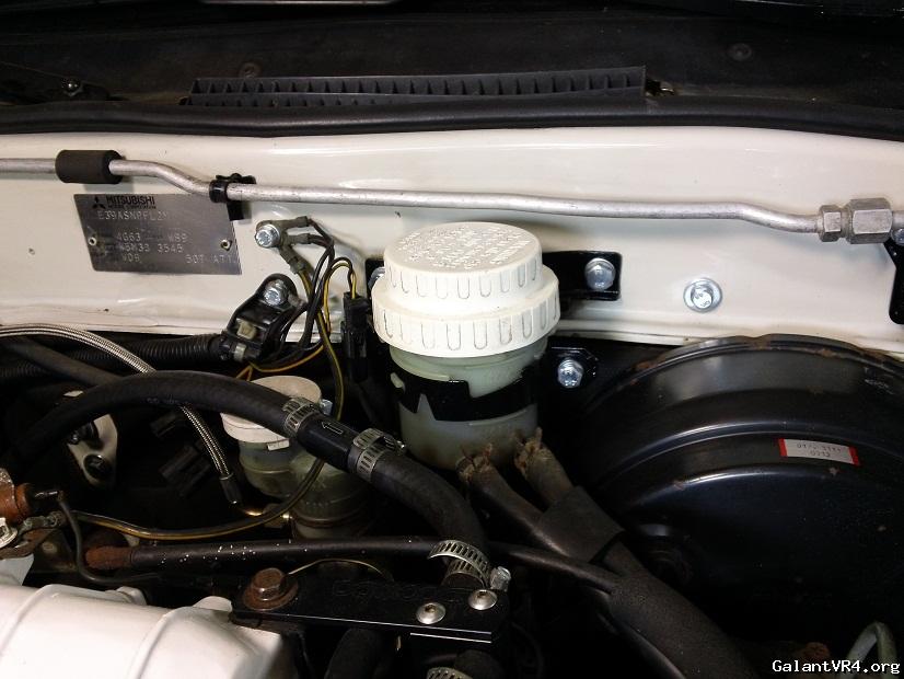

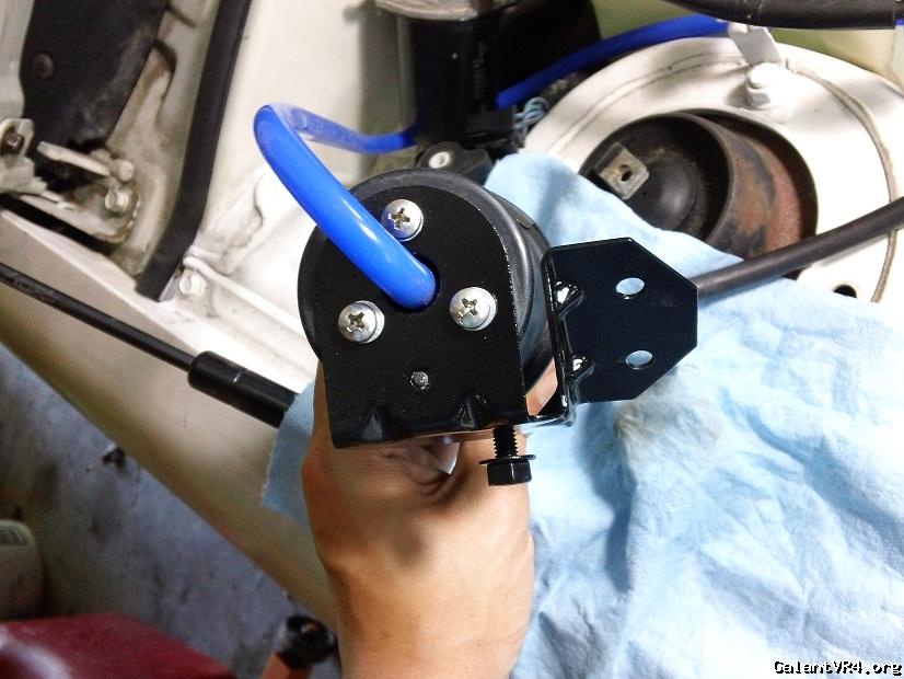

Replaced damn near every bolt in the engine bay with stainless. Also painted all 3 horns, brake reservoir bracket, cruise control unit, misc. brackets, radiator support brackets, and hood latch assembly. Some of these pics are from this past summer. Need to get new clamps all around still. The reservoir is still the old one, but will be replaced later.

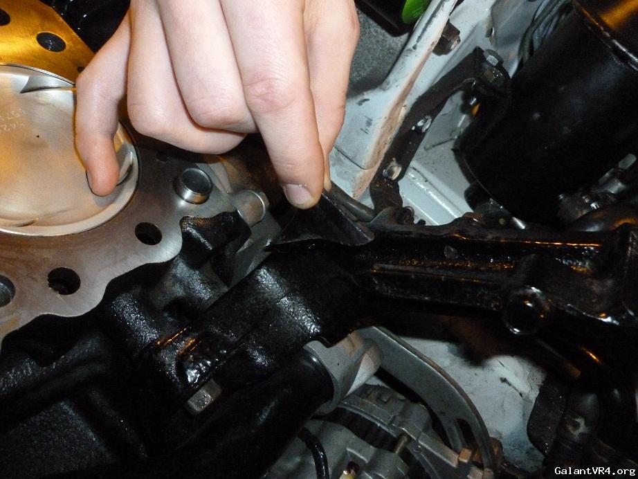

The belt has been set back on and my marks are perfect. All I have to do now is set the tensioner properly, install alternator belt and tension, and wait until spring to fire her up. Will need to find a tuner and try to get most of the new parts installed after like the brakes (want new replacement calipers and will paint black), suspension, hubs, and wheels/tires. Larger than Evo injectors, Supra fuel pump, and AFPR are also on that list too.
