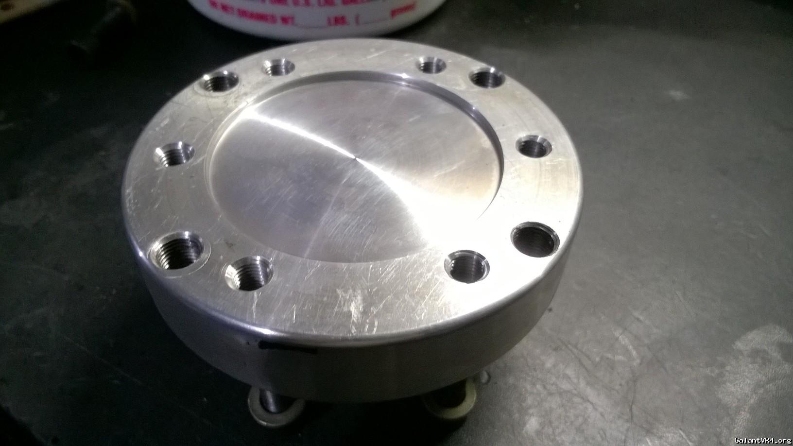

What is the part number stamped on your adaptor Brett.
I have the same driveshaft kit and mine is stamped MIPL1 same as listed on their site.
I haven't pulled the rear section of the stock one yet but I'm hoping mine is correct!
3,479

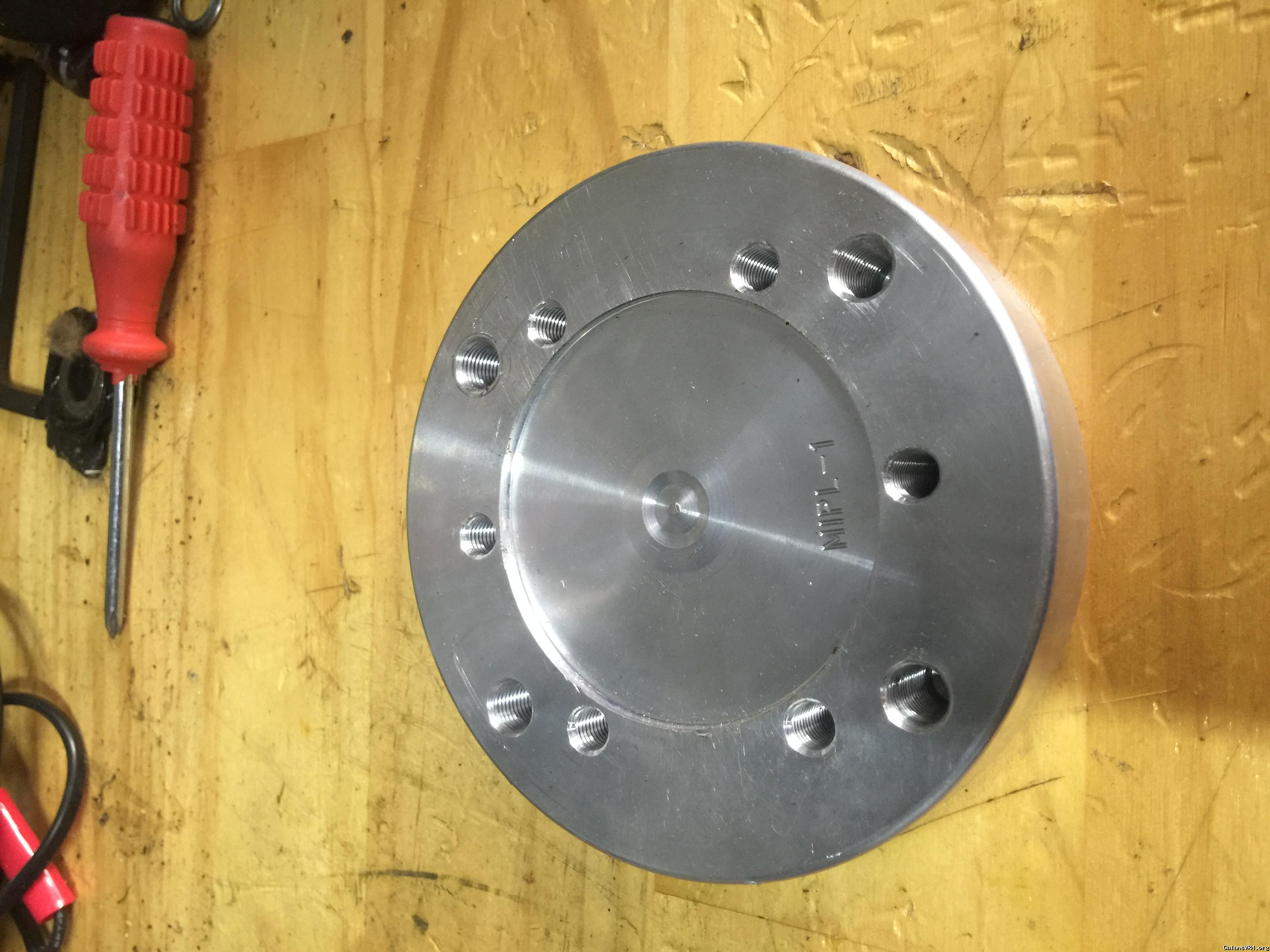

Funny you should ask, there isn't one on mine. However, in the pictures on DSS's website, the part # you're stating is the one pictured on the adapter they list for the DSM.
Here's the one they sent me:
And here's the one on their website listed for the DSM. Notice the completely different bolt pattern to flange design, and also the part number that's present, yet not present on mine: click
3,479
First, big thanks to Tim for helping me get things sorted. I had some issues getting the correct adapter from DSS, who sent the wrong one initially. For this specific transaction, I wasn't terribly satisfied with the customer service I received from either DSS or from ExtremePSI, who I originally placed the order with. But, I got the right parts eventually, which I guess is what matters in the end. If any of you guys are ordering a DSS driveshaft in the future, shoot me a PM prior and I'll make sure you get the correct info for the correct parts from the jump. Here's the adapter I was initially sent. Looks like a good fit, right?

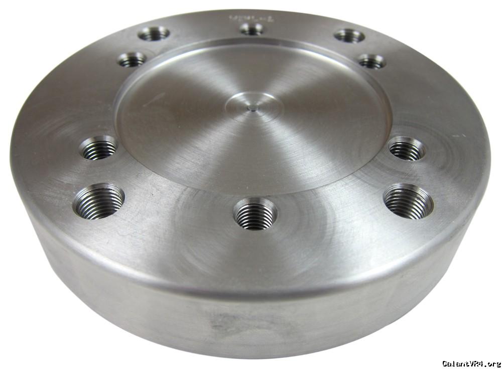

This is our 3.5" aluminum drive shaft for the Galant VR-4. This shaft is designed to replace the first 2 shafts of the factory 3-piece system. They are made from 6061-T6 aluminum and 3.5" in diameter, it also includes a custom 7075-T6 aluminum plate to convert the CV back to a u-joint style end and bolt to the factory rear shaft section. The first 2 pieces of the stock shaft is 22lbs and our single is only 12lbs.
