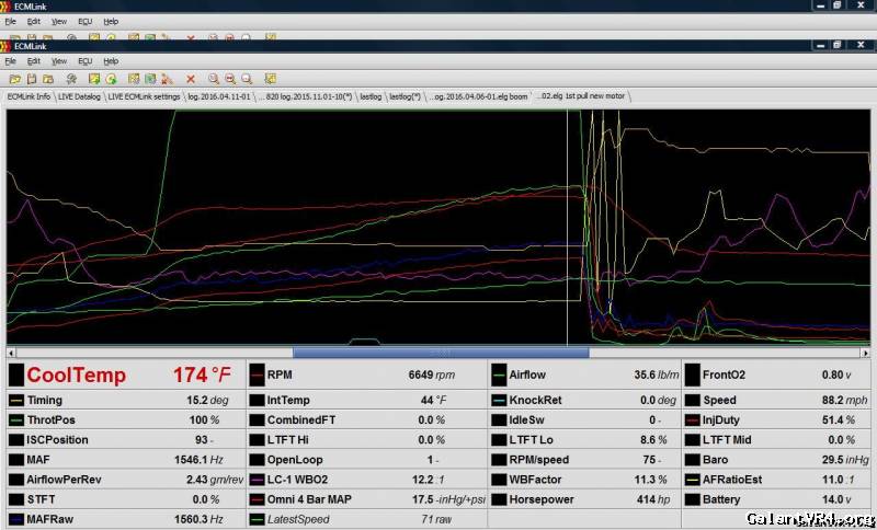

When the valves hit it jumped. What initially caused that I'm not entirely sure. I reviewed the log after it happened, and saw a ton of knock. That was the only event that occurred between the car running great and it dying /ubbthreads/images/graemlins/dunno.gif

I agree, iceman. I can't wrap my head around what happened. I suppose PTV clearance could have been an issue. Admittedly, I didn't check it when I assembled the motor. In addition, my intake cam wound up being 4 degrees advanced after I degreed the cams, so whatever the PTV clearance was inevitably got reduced. Even if that was the case though, I don't see how the car can run perfectly one minute, and eat all 8 intake valves the next. If PTV clearance was the issue, I'd think it would have bent all 8 valves on first start.
Regarding the timing, I'm positive the car was perfectly in time, and the belt was tensioned properly. I can say that confidently because A) I've done more 4G63 timing belt jobs than I can count and B) I verified it was good when I degreed the camshafts. There were no failed timing components, and nothing to suggest something failed and caused the belt to lose tension. Hell, even after the valves got bent, the belt was still tensioned perfectly. And, if the belt lost tension I think the cams would have been out of phase as well as the crank. But, when I lined up the marks after the incident, the cams were still in time but the crank was out.
There's only one event that sticks out between the car running fine and the valves getting bent, which was a sh*t ton of knock. How that causes what happened, I have no idea. All I know is it was good before then, which leads me to believe the detonation either caused a problem, or exacerbated an existing one. Those are pretty much all the facts I know, which I fully admit, still don't add up to bent valves.

Did you break the crank sprocket in half? Had it happen twice now with different cars or the woodruff key broke, never seen that on a 4G though. Worth a look. Also willing to bet that "knock" in your logs is the pistons introducing themselves to the valves. If none of the timing sh*t is broken, it well sounds like ya fucked up on the timing side of things homeslice. Knock doesn't doesn't cause your t-belt to jump, normally it puts a window in ya block!
3,479
The crank sprocket looked fine when I installed the new timing belt this last time.
Far as the log showing the piston contact as knock, I guess that's possible. Also possible I fucked up the timing, but IDK. Does the initial video of the car idling sound like the timing is off to you? Not arguing, just asking.
I've also got a log of the one knock free pull I made before I trashed the head. Logged ~400hp on 18psi (wastegate pressure). Not saying that's legit hp, but not sure that'd be possible on a car with fucked timing, yanno? I can post the entire log if it maters:
