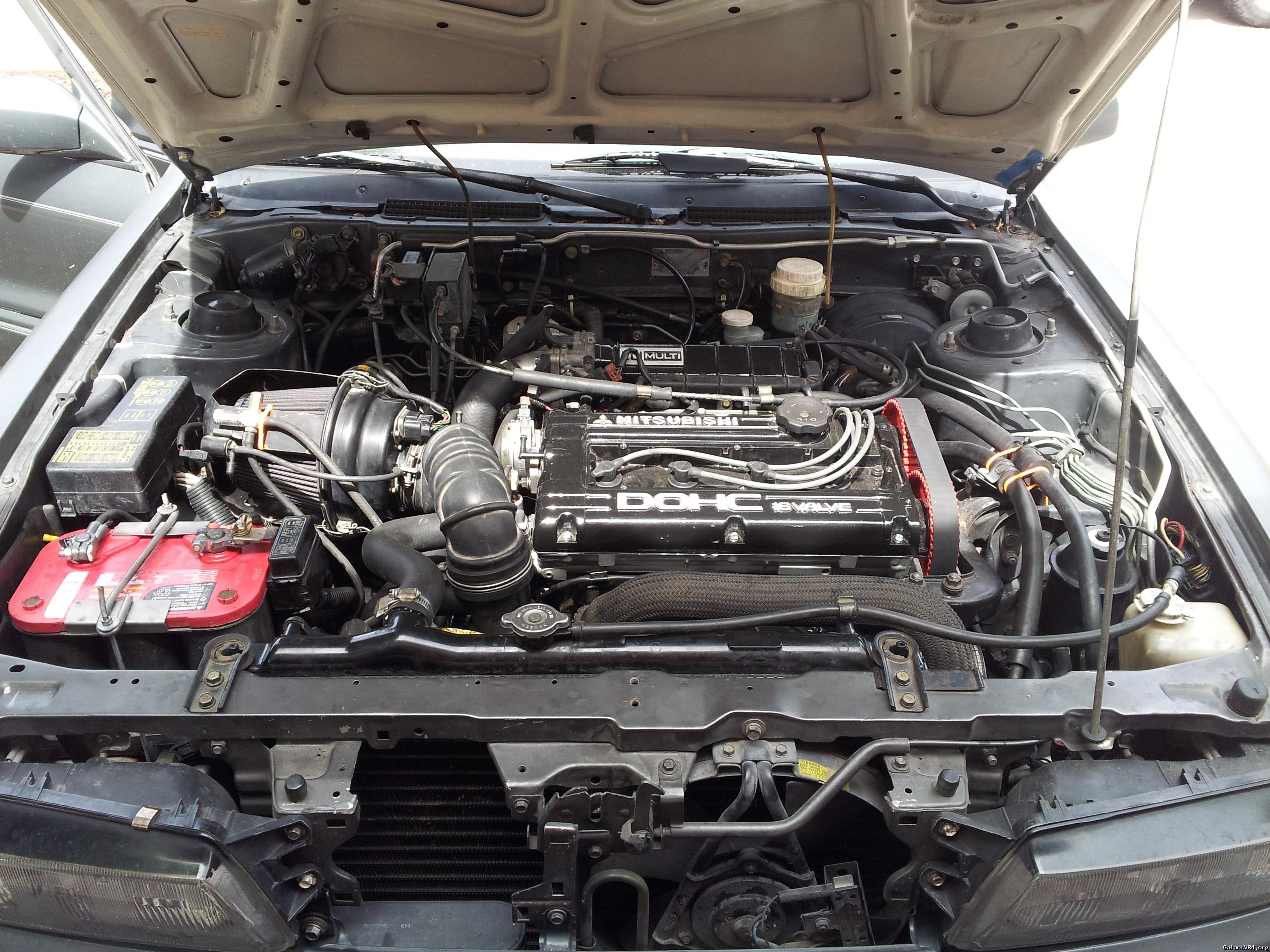

Old engine coming out. Was making some kind of noise in the head after a turbo swap and leaking oil like a BP oil rig.
I awoke my v3 lifters and rocker arms from their slumber in clean, Rotella T6, then buttoned up the head gear with assembly lube.
New cam seals.
New timing belt, tensioner/idler pulleys, water/oil pumps, BSEK installed.
After a couple weeks spent cleaning and preparing things. It was finally engine install day.
If you've been in this position, you know how much it sucks.
Fresh engine going back into 464/1000.
Not bad, if I do say so myself.

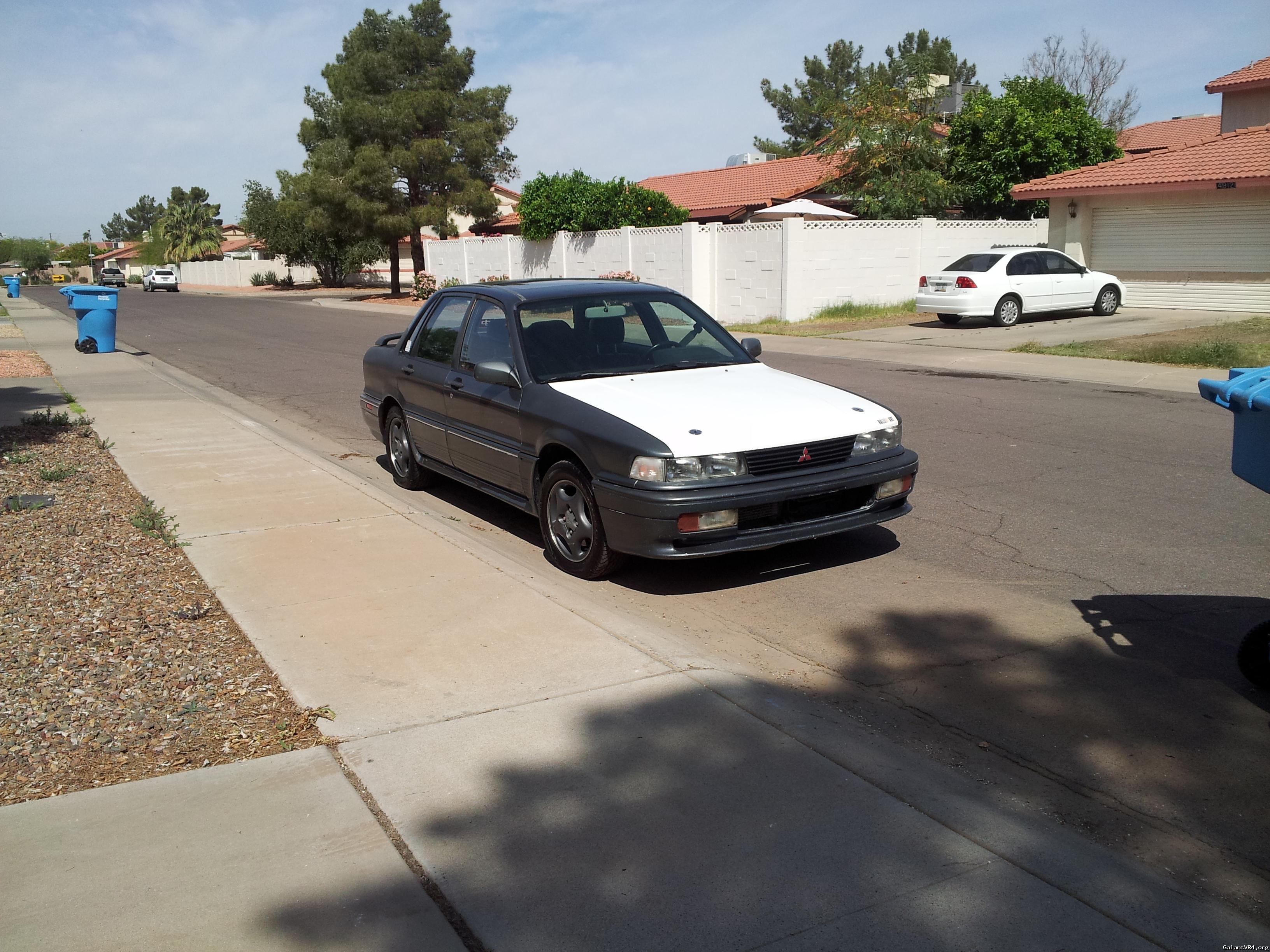

No idea what time it was, I began the walk home. It was about 2 miles. (No phone. Remember?) From the peak of victory to the depths of defeat in 15 minutes. From the nicest Galant I've ever driven to the worst night of my life. Ugh. I got home, grabbed my phone, texted Keith to let him know what happened, and he rolled by with a tow strap to help me drag it home. About 1AM, I was finally done for the night, sending poor Mike a dramatic, borderline psychotic email update, as our plan was for me to drive the car to work today and deliver it to him tonight after work.

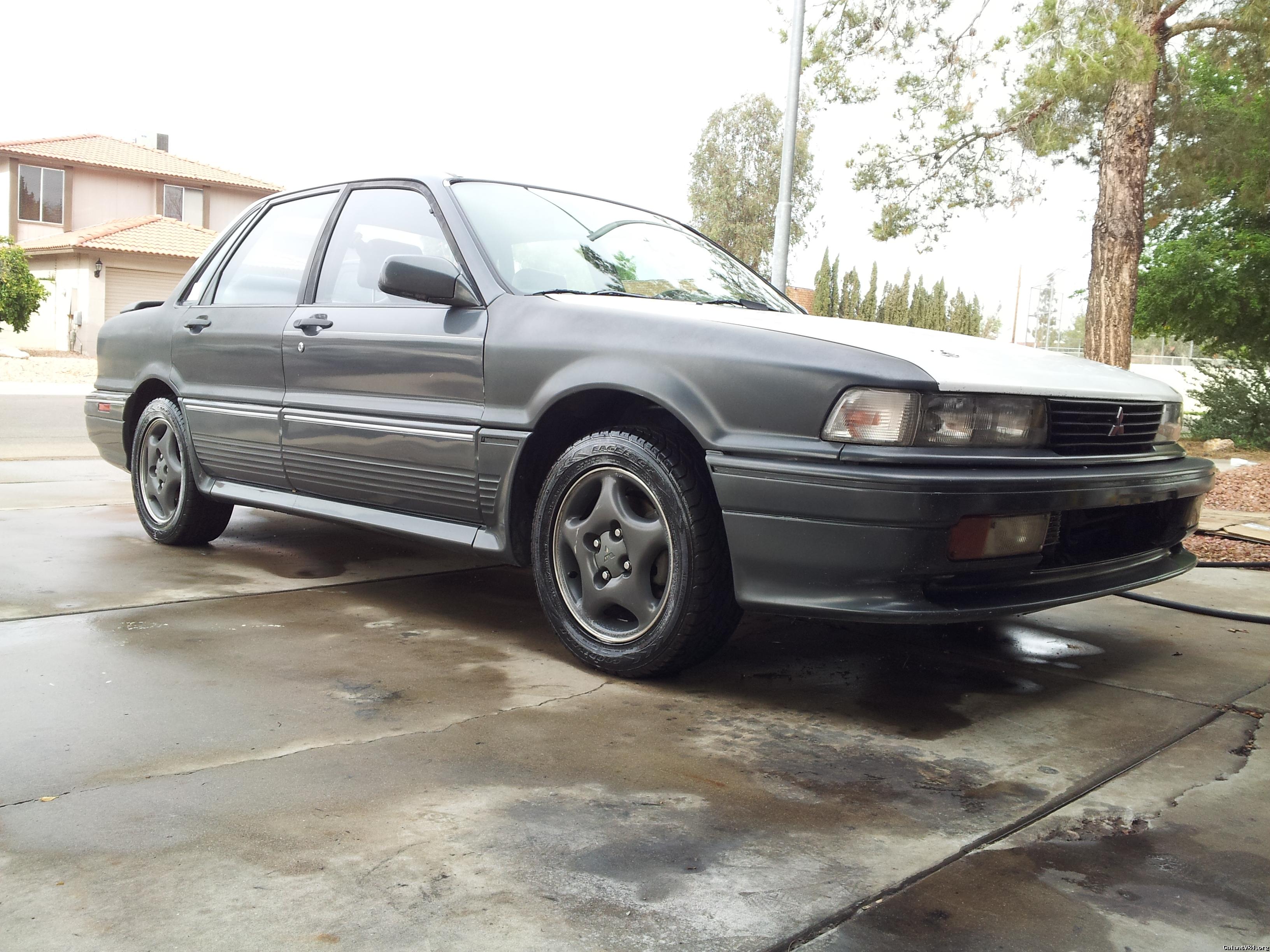

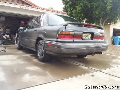

Here she sits. Funny. She looks pretty good, if I do say so myself.
Best I can tell, the hydraulic tensioner - the only part I re-used when I did the timing belt - gave up the ghost and introduced enough slack to lose timing. I won't know for sure until I pull the #1 plug and check those marks tonight after work. (I'm also going to open up the ECU and double check the board, yank the intake snorkel and make sure the turbo is still good - irony - and probably re-examine my vac line connections.)
For a few brief minutes, this was the nicest Galant in the world. That's the Galant I'm delivering to Mike. Hopefully tomorrow. Maybe other people can spin the condition of their cars for sale, I can't do that. When I hand Mike the keys and tell him this Galant is 100%, I don't want any doubts. It's just how I roll.
