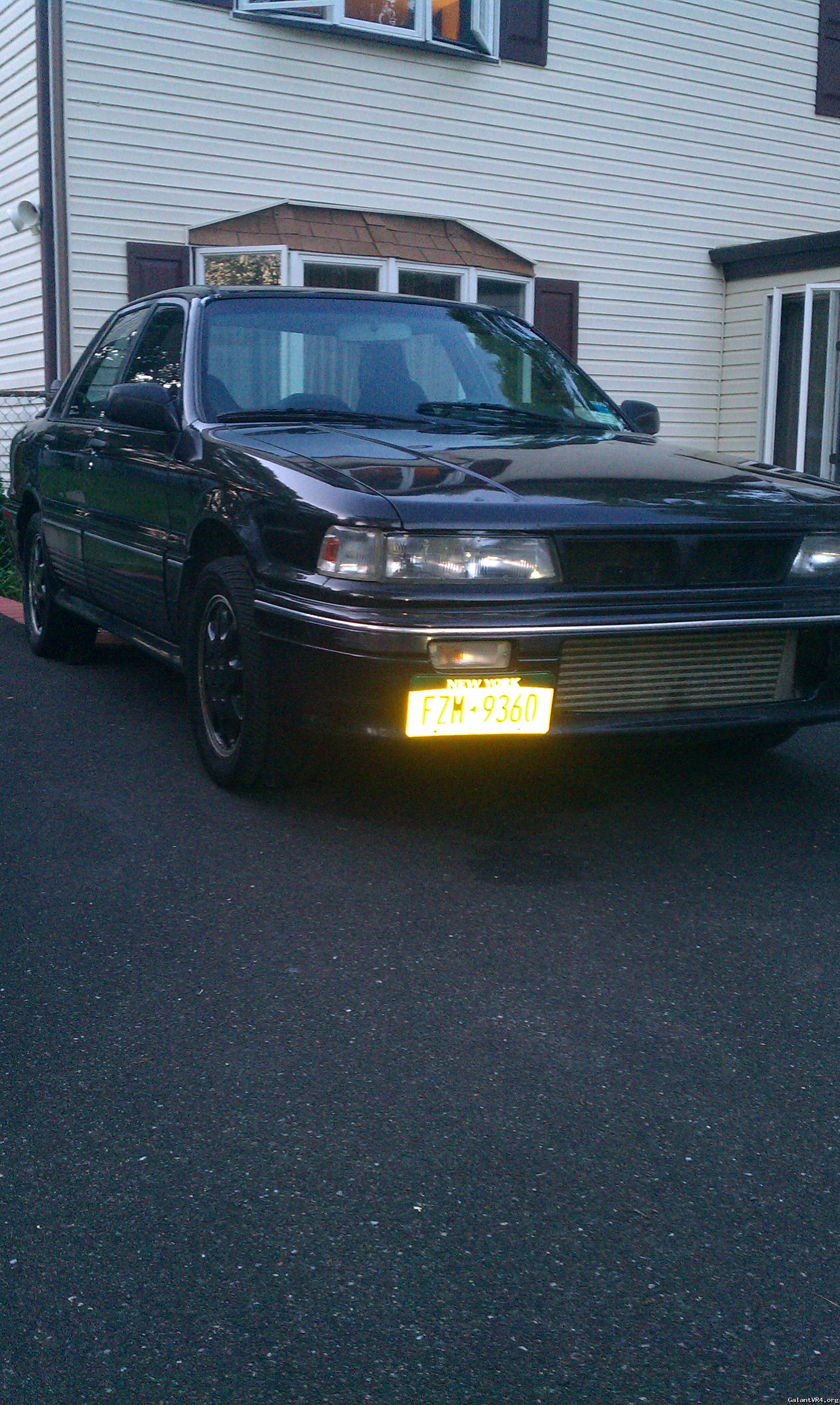

Wound up being a faulty connection on the maf harness. the car has a GM air meter on it. But I have plans to remove it. Now il do some cleaning up and show some more pictures.
