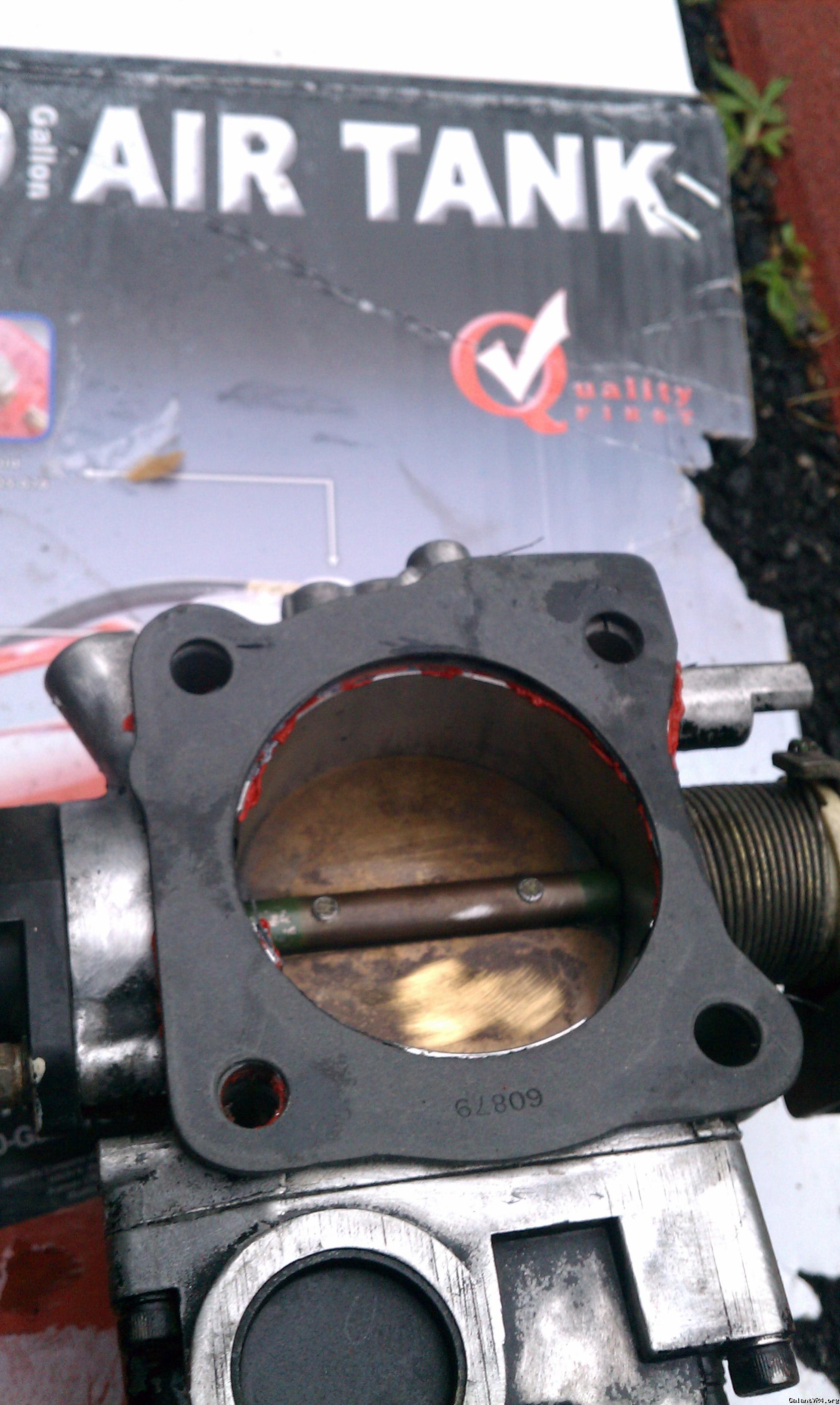

I applied the bl tester to the inlet on the 16g. Should I be placing on a charge pipe before the tb insted?. I should have been more clear wich im sorry for but I changed both gaskets on back to back days. Throttle body first. After that was done is when I first noticed the lean idel. Next day did the intake and still have the same lean idel. Gaskets on everything including deleted egr cap.also used red rtv. I have my scanner for obd1 ready to take home from work at six so I should find what is stored.

Quoting 16g16v:
Here's a shot of the TB to intake mani:
Notice how the "lower" portion ( to the RH side of the pic ) has the cutaway vs the opposite side. If you get the gasket in 180 out you will suck major air into the mani regardless of gasket and RTV use. It easy to flip by accident trust me.
On the boost leak test unless you opened the throttle plate you would not have heard much or any air pushing past the gasket. Hard part is with open intake valves, may not build much pressure in the mani.
To test where the leak is run the car at idle and spray carb cleaner around the gasket areas. If the idle changes you found your leak!

Thanks for all the help guys. I tried to pull whatever code or codes it had tonight but the scanner wasnt getting any power wich was weird. But thank you for the tb pic. I think I might have the gasket on upside down.. Tomorow when I take lunch I will snap a pic on how I have it set.

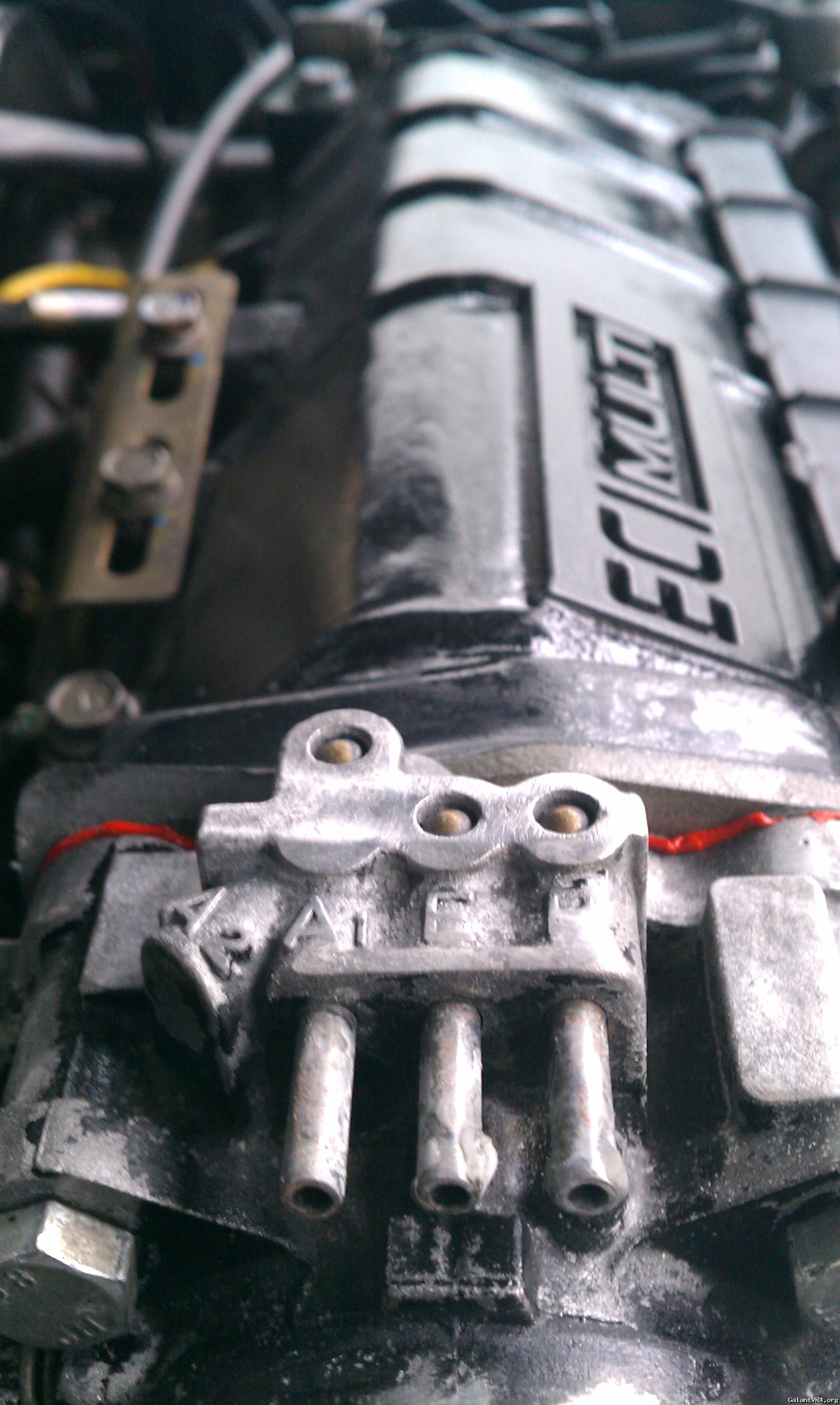

I did clean the tb with a wiz wheel just to knock off all the old liquid gasket funk. I also cleaned the highlighted areas in red with a rag and break clean. I just ordered a new gasket for the tb and il be able to install again tomorow due to the heavy reason we have been having here. Just to play it safe and to double check my work can I get an image of how the gasket is supposed to sit on the tb? . And I will post pictures tonight after six. Thank you guys.

Here's a 91 style 1g TB. Notice the trapezoidal notch on the left side, two small holes at top and opening at the bottom. Just match these up with the gasket. The surfaces shown should contact each other.

Thanks for showing me that image. This is the way i had the old gasket on.I just ordered the new one wich i will have tomorow.But did i have the gasket on correct. btw the rtv will be cleaned off .
