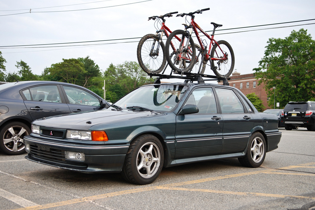

our cars are funny. when the wheel gaps are the same the rocker panel isn't level with the street. to make the car level the rear end has to be down like an inch.
that's how i see it anyway.
and my situation is exaggerated because i have no wing, no spare or tools, fiberglass trunk and no metal rear bumper (JDM) so there is seriously 125lbs missing from the back of the car so it probably sits higher than most.

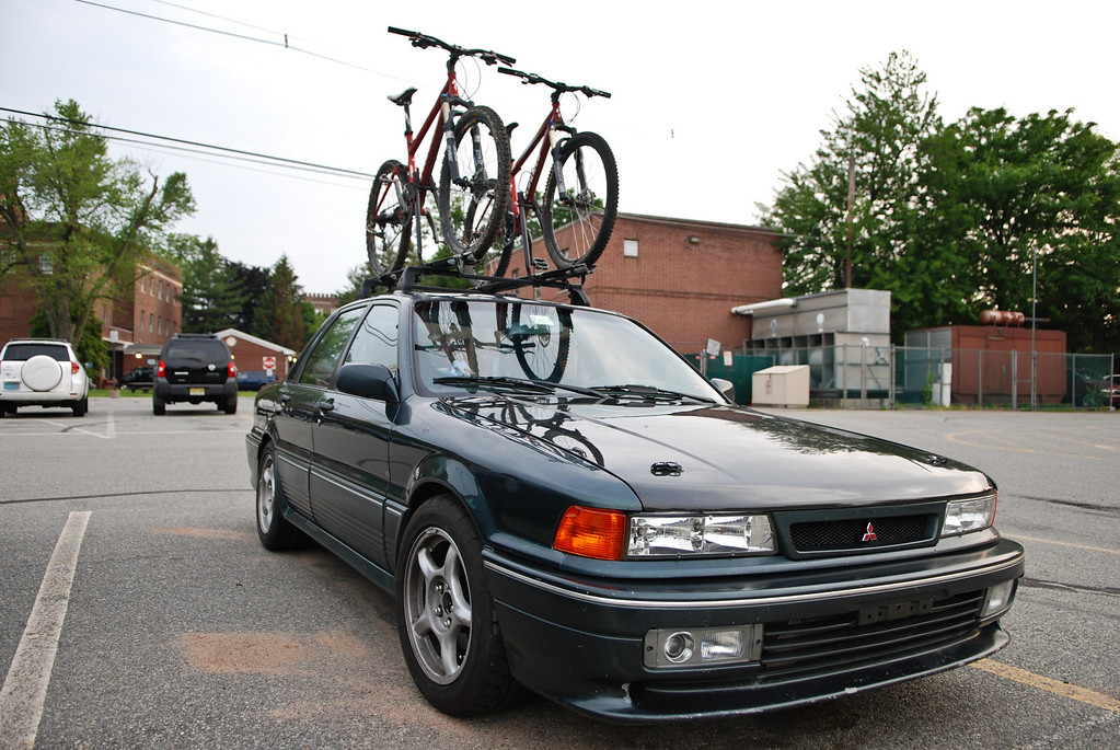

DAmn, Luke. I always expected your car to look like crap. It actually looks good with the JDM bumpers and RX7 wheels and lowered. Nice. /ubbthreads/images/graemlins/smile.gif Makes me want to find a set of those wheels for 503 and do the 5lug swap.

yeah i dunno, it's got a lot of door dings so i'm thinking about parting it out.
they are 225 50 16's
that center cap won't hold in anymore, not sure why but it started last weekend. pissing me off. with the rx7 rims the axle pushes the center cap out about 2mm but they always stayed in, until now. grrr
most of my car is spray paint, and it's chipped off in the front because the girlfriend smashed it into a curb /ubbthreads/images/graemlins/laugh.gif
