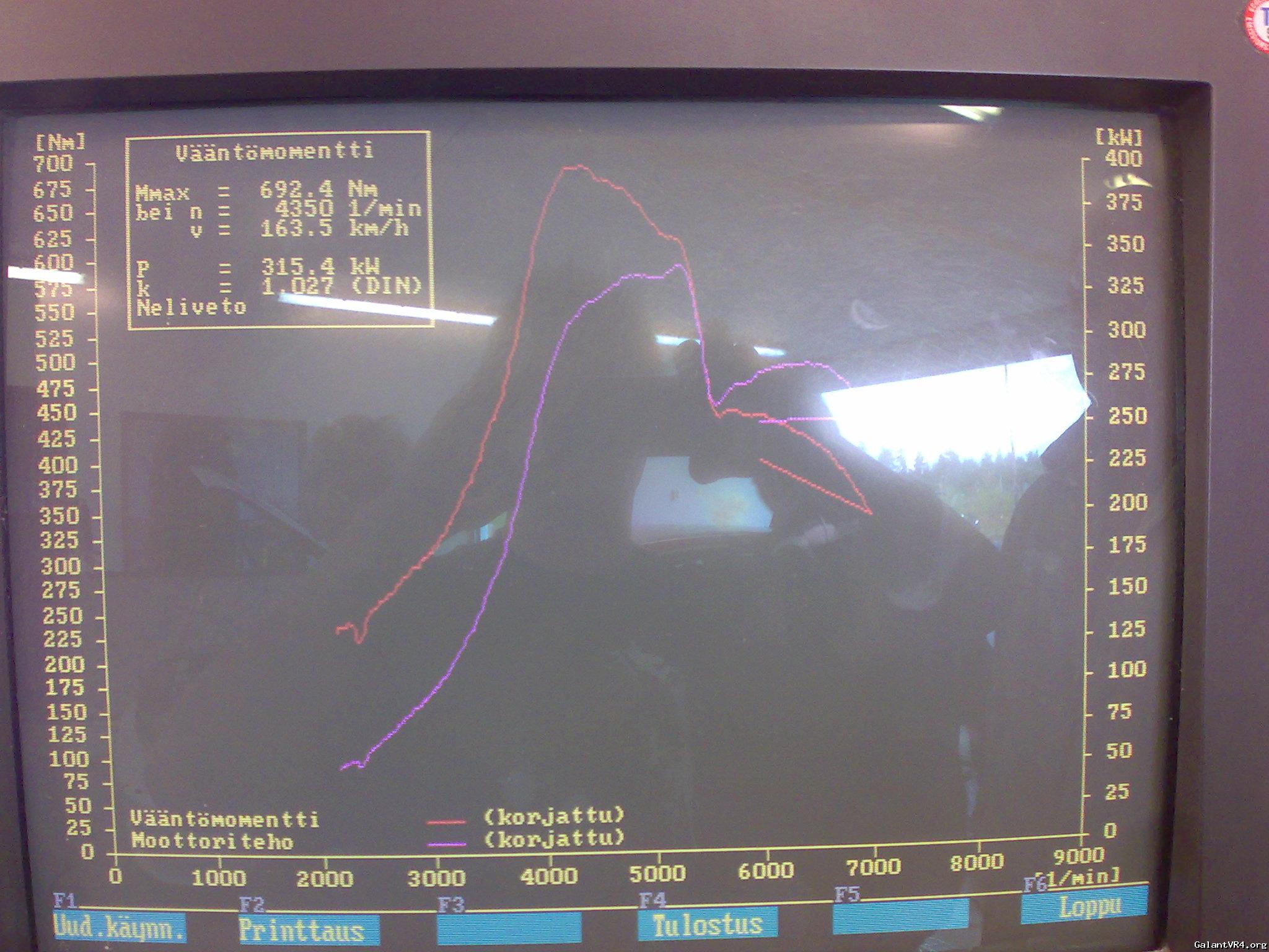

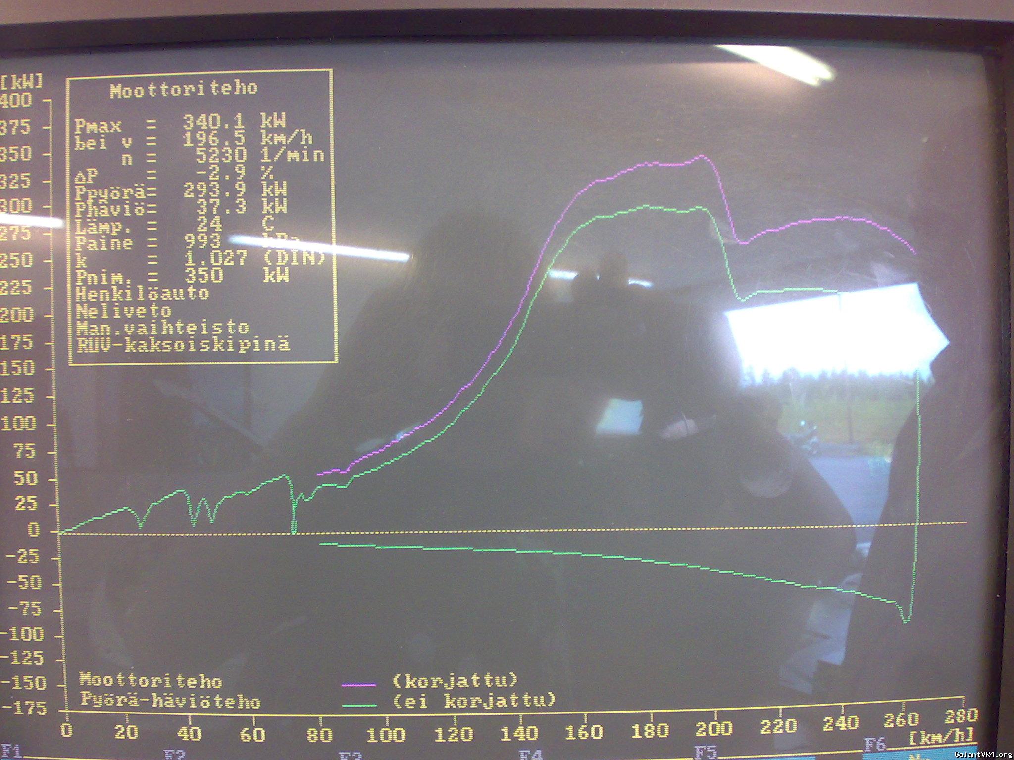

here is my rally vr4 dyno sheet with 45mm recistor and 98 gasoline "pump gas in finland", i think at same for usa 93?..boost is 1.7 bar and then drops 5300rpm only 1 bar bacause my wastegate solenoid it´s something wrong, i must chance this with apex boost solenoid.my goal boost is 1.7 bar abot 5500 and then drops 1.5 bar all over the redline, because my exhaust back pressure goes to high.i´m very happy with torque..
lOOKS GOOD?? What are those numbers mean over hear??? Fix that wastegate..

692,4nm=509 ft lbs 4300rpm/wheel hp is 293.9kw=400hp and engine hp is 340kw=462hp with 5230 rpm..

I assume its internally gated turbo so you need to fix that actuator. If its external just get a stiffer spring for the wastegate. Fix that boost and you will have even better numbers.

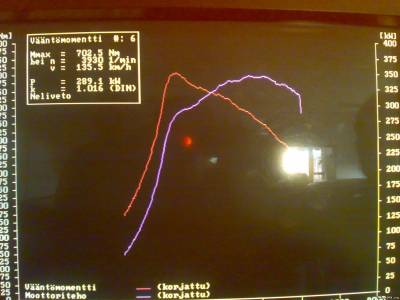

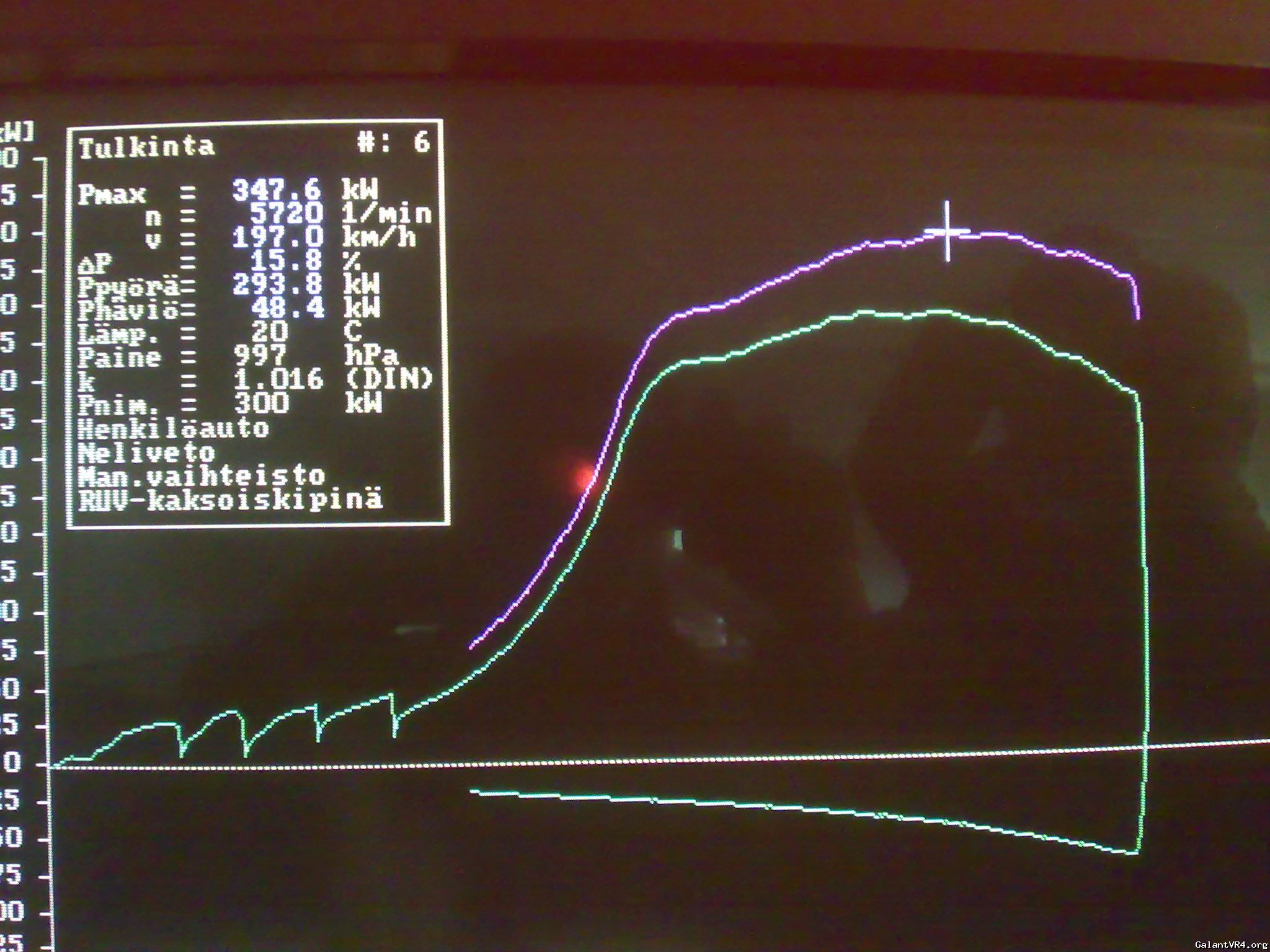

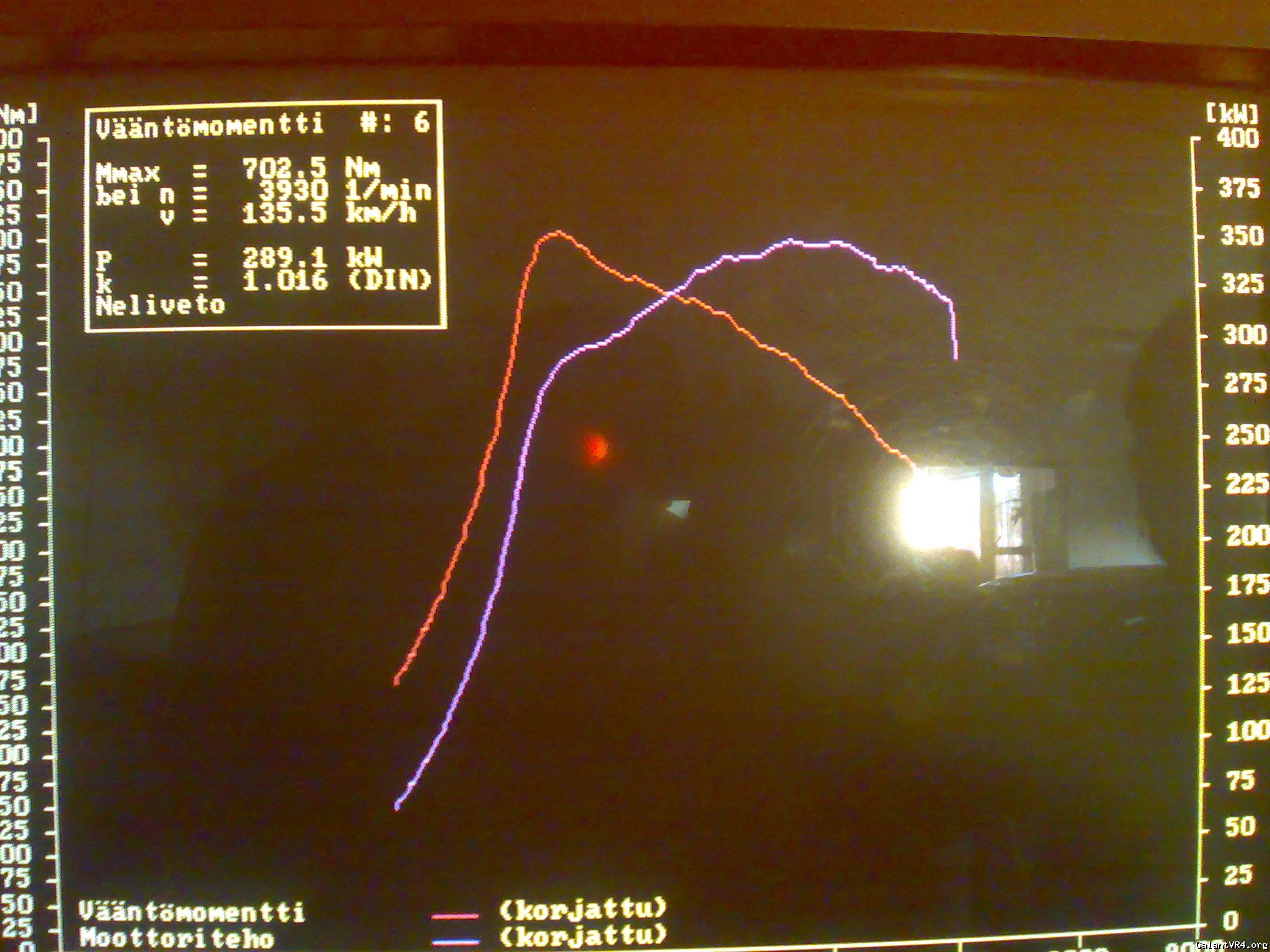

here new dyno sheet,spike boost 1.8 bar and then drops 1.4 bar..and now i use cyclone manifold,butterflyes open 4200rpm.looks like max torque is 400rpm sooner than before..
