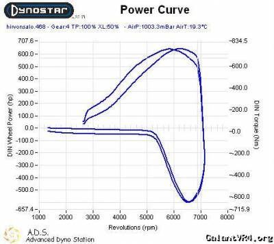

here is my new dyno sheet,2.0 motor before is 2.3 stroker.
race gas 102 ron octane,spool timing 16degrees,20degrees to the end.2.2bar spike and drops 1.8 bar.
my fp3052 broken so i change turbo.now i use non ballbearing because my antilag broken ballbearing turbos easily.
ok spool time is worse but power is amazin..

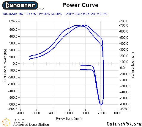

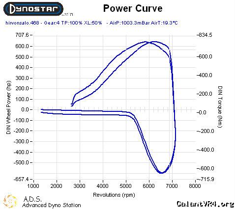

here is 3 dyno sheet.4gear,5gear and both.
i think at dyno pulls must use straight gear and is 4th,i try also 5th because i dont believe these 4th numbers..
dyno logs show 5th gear 4800rpm 2.2 bar and drops 6200rpm.
4th gear logs 2.2bar is 5800rpm to the end.
