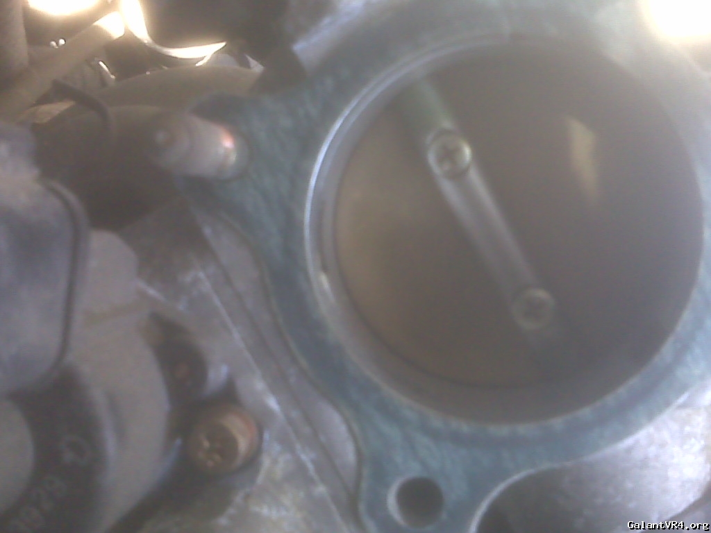

good: the throttle body is perfectly clean on the inside. see...

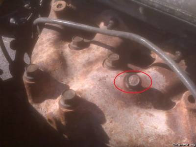

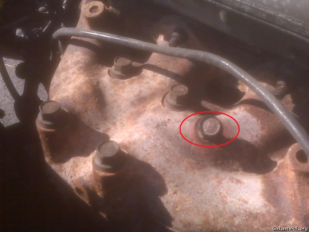

there isnt any oil in the intake piping...so im not exactly sure about the seals i have a couple questions too. number one...whats with this bolt that is in the exhust manifold? its not tight or anything and i cant get it out.

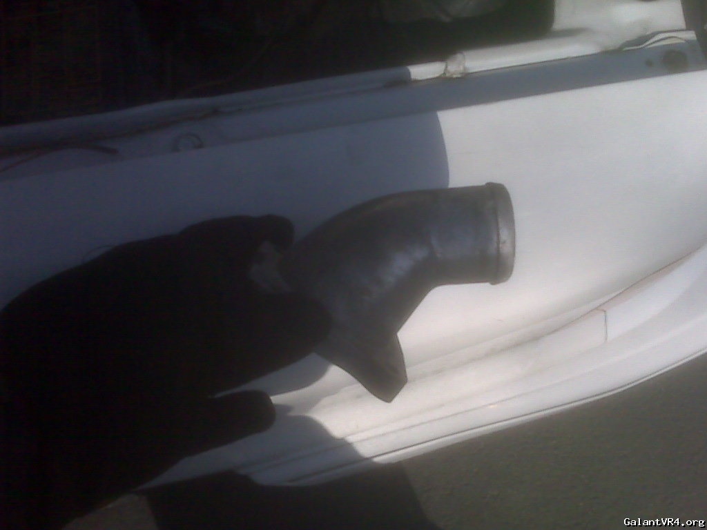

also...is this a 1g or 2g throttle body elbow? im gonna get a 2g if this isnt it. i dont really know what the differences in looks are.

The extra bolt in the manifold is prob where a EGT probe was mounted at one point. If it doesn't leak, I would just leave it alone.
The elbow is a 1g. If you do put a 2G elbow on there you'll have to make a adaptor for the upper I/C piping because the 1G piping is smaller than a 2G.

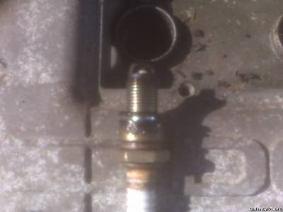

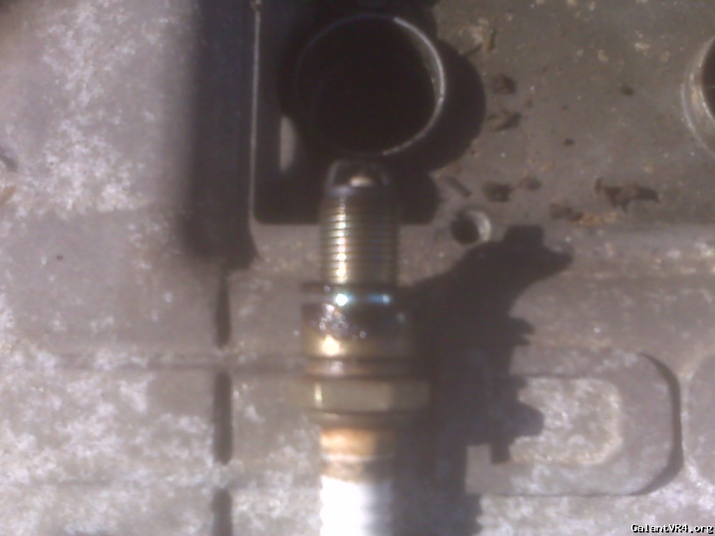

Quoting 91GSR:
goopy #4 spark plug
i had the same lookin oil residue on my #1 cylinder when i changed out the plugs to see if that was my starting problem.. well its not. but why is the oil gettin on the plugs? like his and mine?

so if i replace the elbow i have to replace all the intake piping? that bolt in the manifold is just bouncing around in there. i cant get it out, but it wont tighten down either. i have no idea what it is...

The stock piping is about "1 7/8,which is what the stock 1g elbow diameter is. Generally,"2 1/4 or "2 1/2 is what you would upgrade to. Unless you are into jerry rigging it (sounds like you are not),I would just port out the casting flash inside and run it until you upgrade the pipes and IC.
Can you see if that bolt protrudes into the manifold runner?

manifold runner? i felt under the manifold and i can tell it doesnt go all the way thru. and i know how bad the bolts can be if u take it off. im thinkin ill shoot it with some WD40 a couple few times over the next couple days then this weekend see if i can try and get it out again. my big plan right now since i have to wait for my ECU to come back is the rims/tires. i have the stock rims and brand new tires (less than 300 miles) from my GSR that im going to sand down and repaint for the vr4. only 3 of the stock wagon wheels came with the car so ill be selling them just for a little extra coin to throw back into the build.

If I were you, id address that mystery bolt issue first. If there is a nut on the backside of it (inside the runner) and that decides to come off, it will go right into the turbo and it will be ruined.

Like mentioned that mani was likely tapped for an EGT probe ( altho #1 is the better choice IIRC ).
Anyhow someone wanted that probe and just shoved a bolt in the hole to cover it. Worst case find another 2g or newer manifold to avoid leaks.
