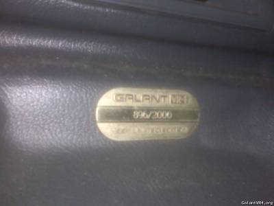

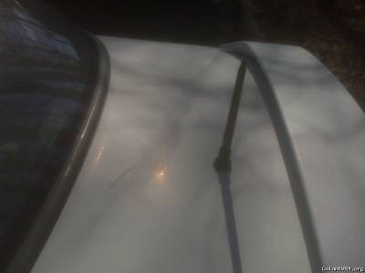

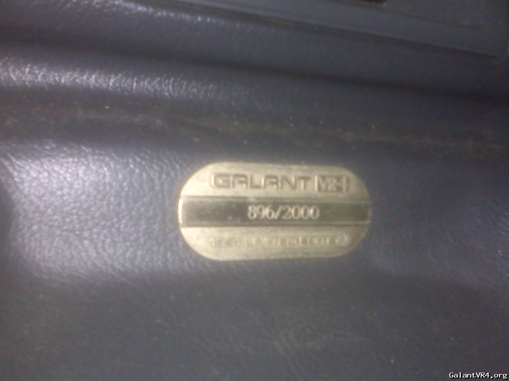

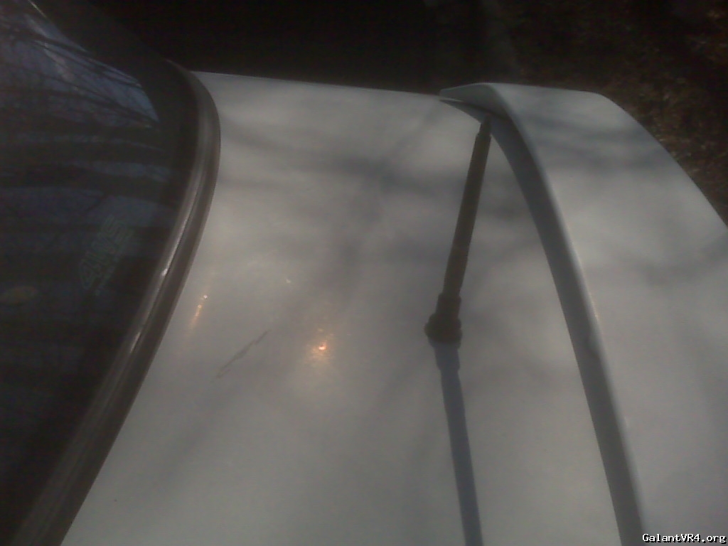

its actually 897/2000. he also has 3 more /ubbthreads/images/graemlins/ooo.gif 18XX/2000 was sitting next to it with a built motor, straight body, but the tranny was dicked up. he has two more up in richmond. there was a bit more body damage than i would like but still for 460 bucks u cant beat it. still has a full motor, non running, and just a few dented panels. still has the dash badge and two original keys, no key fob. interior is very VERY nice. it is extremely clean and the leather is in great shape. someon put an antenna in the middle of the trunk tho. took a lot longer to get it than i thought it would so no pics tonight cuz of the dark. tomorrow ill get some. also the vin is JA3CX56U9MZ01091...but carfax says it invalid...did i miss a digit or something /ubbthreads/images/graemlins/confused.gif he said he is oging to email me the info on the other vr4's he has so we can add them to the registry. is this one in the registry anywhere?

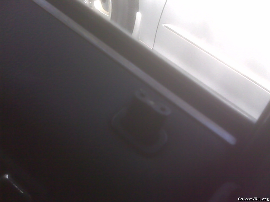

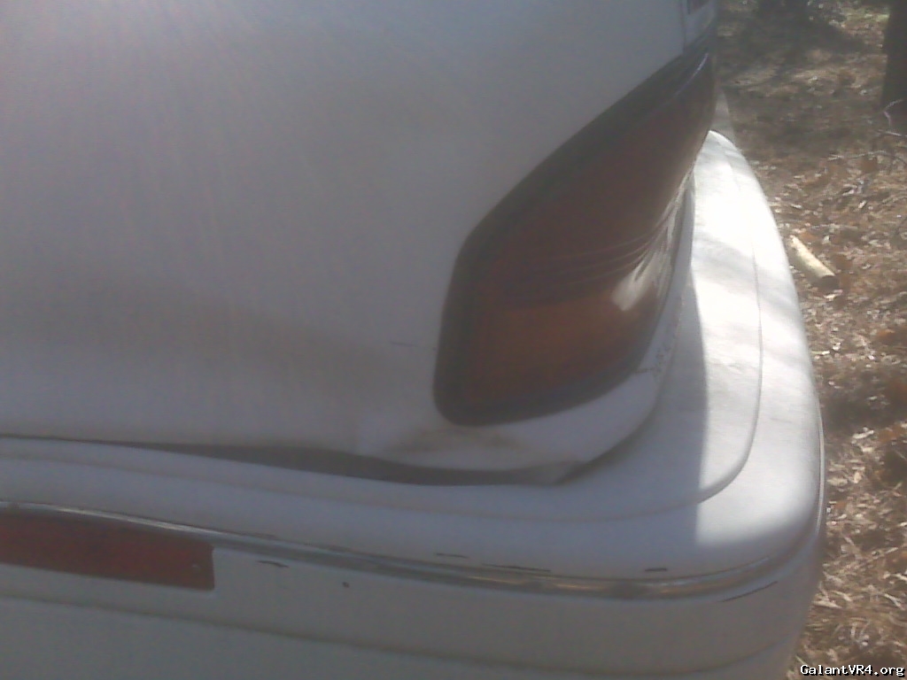

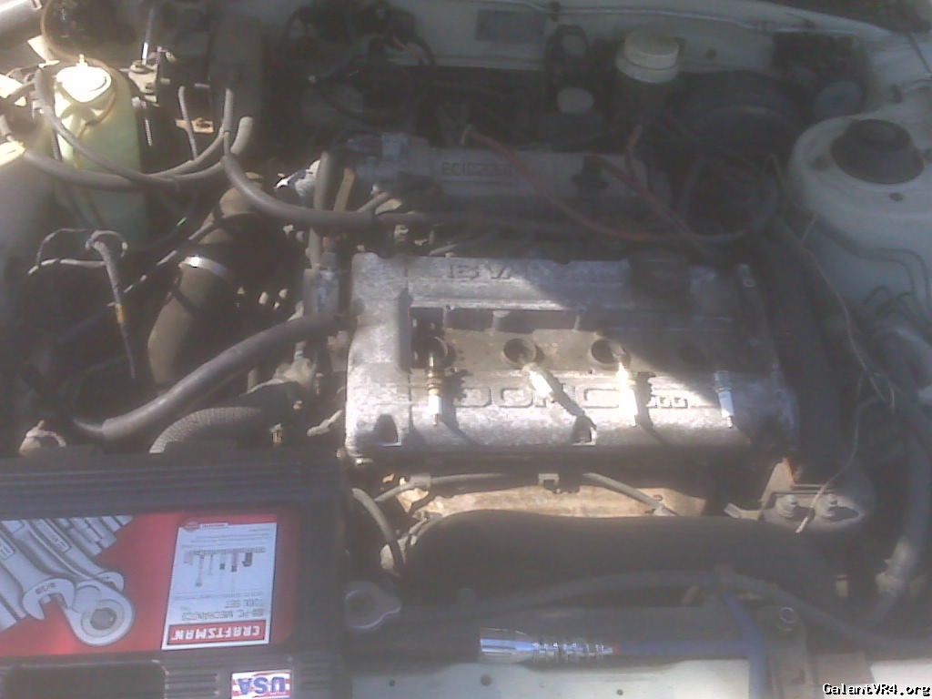

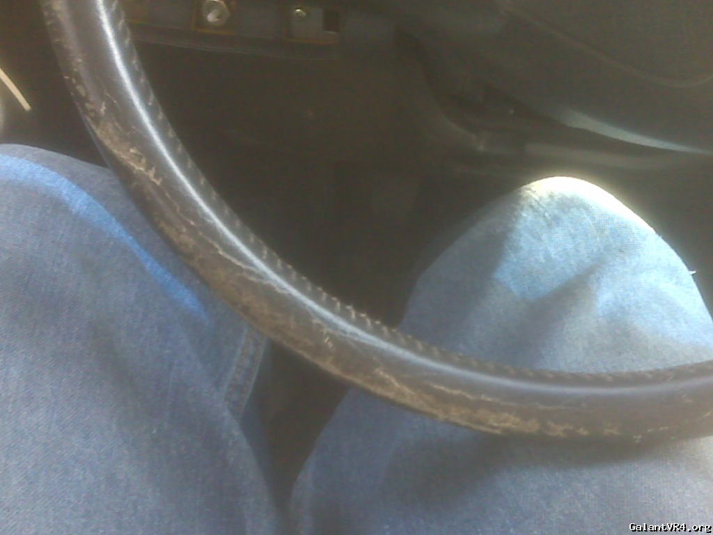

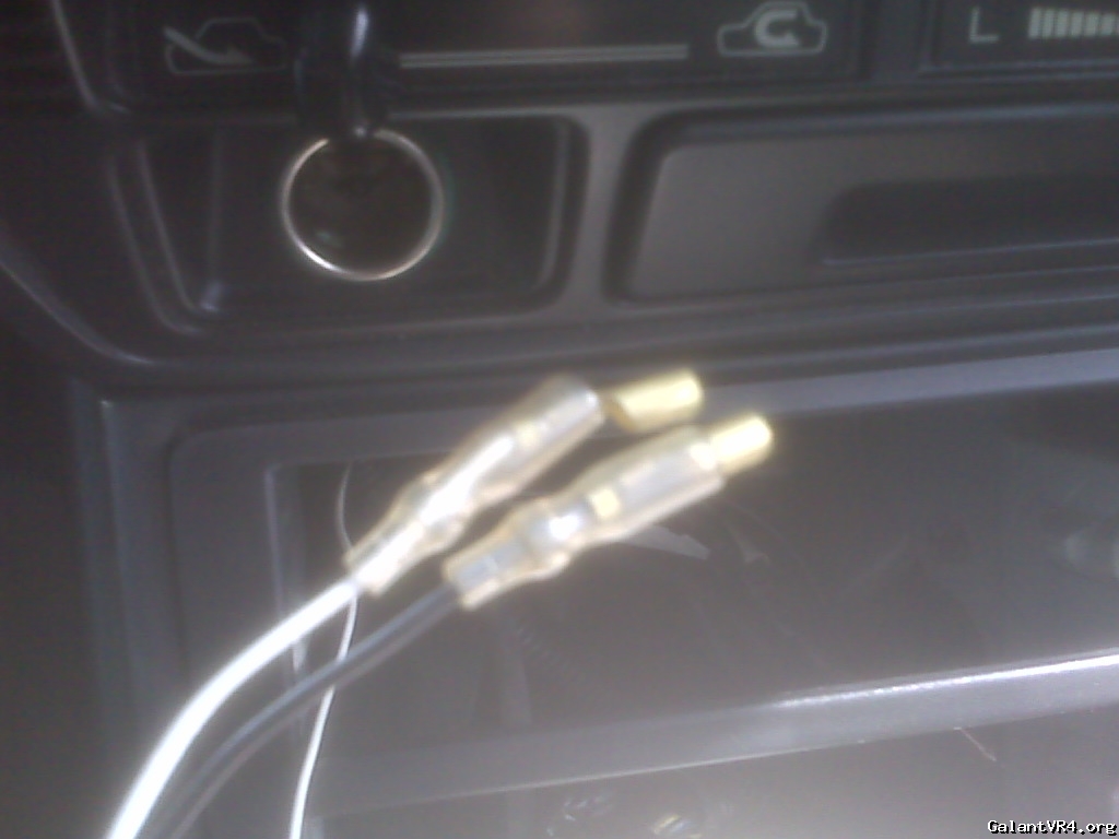

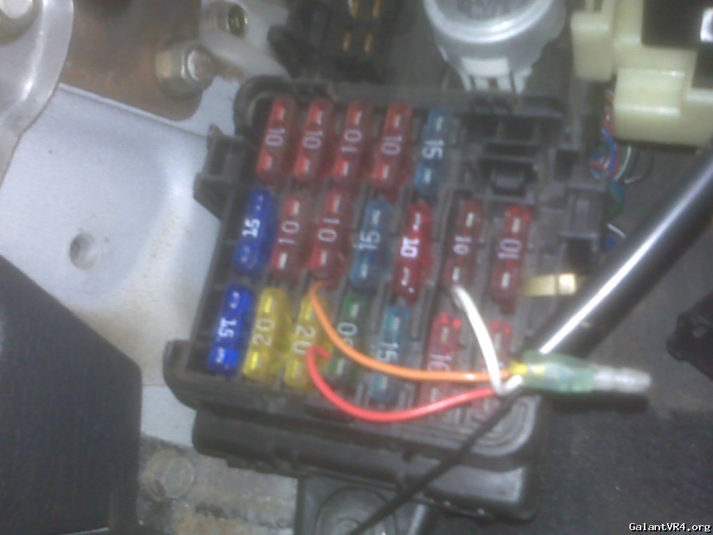

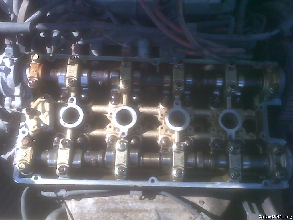

so i did some digging around this morning. found some good some bad...but overall this was an amazing find. i guess the guy that had it before me didnt know about the cap issue in the ECU cuz its all kinds of corroded in there. hope its salvagable. but, on the bright side, it has amgnecor wires (pretty sure they are AM) and NGK BPR6EKN plugs. the #4 plug had oil on it. dont know if this is symptomatic of something or if its just goopy. there seems to be some wiring done for some typ eof gauges. theres a black/white wire running from under the engine somewhere to the area where the stereo goes. there is also some wiring done into the interior fuse box. very little interior damage. just some rubbage on the driver seat and steering wheel, as well as the driver rear door lock is broke off, but still works. i hooked a battery to it last night and all the electronics work. all windows move, no sunroof. door locks work they're supposed to. took the valve cver off to see how ugly the inside might be, and it looked alright, but i am going to get a new valve cover and bolts cuz the current ones are fugly. pretty much i think if i just change out all the fluids, do the timing belt, get a battery in it and get the ECU fixed itll run. looks like a lot better situation than i was thinkin. now for the moment u havel all been waiting for...the PICS /ubbthreads/images/graemlins/smile.gif
the dash badge

over all ugly engine
drivers rear body damage
the dumb antenna in the middle of the trunk
interior damages
engine sans valve cover
this is the wire that runs to where the stereo is
and this is the wiring in the fuse box. anyone know what it might be for?

congrats on the buy hella dell, and good starting point, first check that the engine spinns freely without any binding to make sure that the timming belt didn;t go out and the valves arnt bent, remove the timing belt cover and check the belt for any signs of wear,cracks, if everything checks out okay then your off to a great start let me know if you need any help with something

the upper timing belt cover isnt on it and the timing belt looks great. just for piece of mind im going to change it out since i dont know when it was last done. when i took the valve cover off everything looked to be in good working order. how do i move the crank to find out if it binds without trying to turn the car on?

To turn the motor put the tranny in neutral ( I usually forget this part until I see the car moving ).
Look behind the driver-side front wheel. If the dust cover is in place next to the engine there will be a round hole about the size of a silver dollar. If no cover you will see the crank end and a square hole.
The square hole is 1/2". Put an extension on your driver, 1/2" of course, and turn the engine CLOCKWISE or as if you are tightening a bolt. CW is important as that's the direction the motor spins and it won't try to unload the tensioner.
Turn away! Now if it turns freely locate the very tiny notch in the crank pulley, line it up with the timing mark on the front case, then look at your cam gear marks. You may need to rotate the engine one extra revolution if the marks are not facing each other in the middle.
I'm guessing the bonus wiring was for some type of radio and/or radar detector hookup.

Put a big wrench on the bolt inside the crank pulley and turn it there. You should do the timing belt. I trusted someone that told me it had been done and that didn't work out so well. /ubbthreads/images/graemlins/banghead.gif
Like he said on the tooling/technique...
But not all of us are nineteen feet tall. /ubbthreads/images/graemlins/wink.gif
I usually both hand on the tools. One to turn and one to steady the extension
Then since all I can see is fender at the point, (because I'm not freakishly tall /ubbthreads/images/graemlins/tongue.gif ) I just eyeball the cam gears.
You want both dowells up, then align the two cam gear marks.
Then you can stand straight up and check the crank timing mark.
remove the tools from the crank before you walk away.
It makes a bad noise when you start the motor with them still in place.
