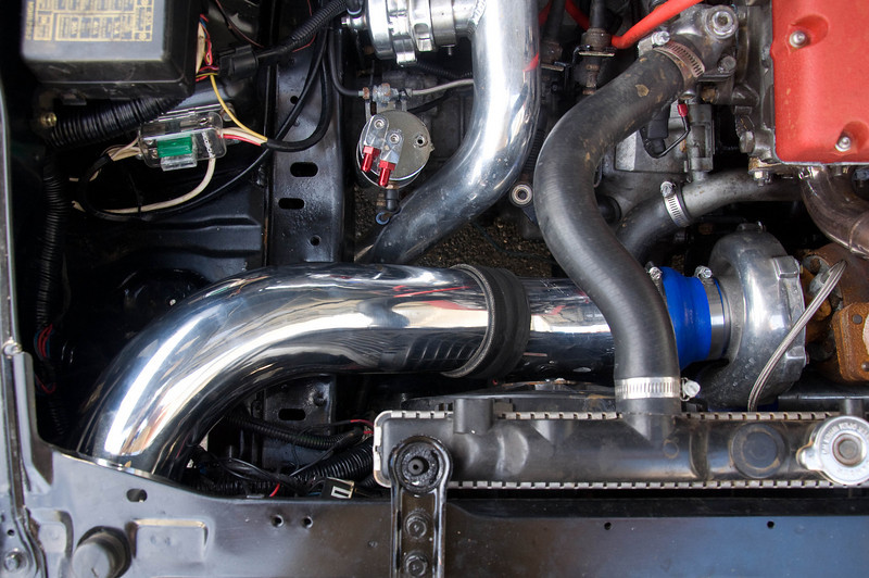

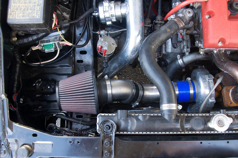

Finally got around to building a new intake pipe for #139. I'v had the filter and pipe laying around for weeks now and just never had the time to cut the U bend up.
Anyway, here's the 3" intake pipe (stainless steel) and little K&N filter I previously was running:
Heere is the new 4" Aluminum intake pipe with a big monster K&N:
Rather than make a permanant cold air intake pipe with the filter in the bumper, which has it's own problems (snow/water getting sucked in, the filter gets trashed, missing plastic fender liner, cutting sheetmetal for passage), I just made it convertable.
The pipe lines up with a hole for the headlight which gets removed at the track anyway. So now I have a "ram cold air" setup for the dragstrip that takes 2 minutes to swap. the filter & bend for the longer 90* bend.
The Ubend was $37
Filter was $60
3" to 4" silicone reducer was $20

I sure hope it's worth a little something for power at the track. Last time I ran the 11.1, I had no intake at all, just an open turbo. So all the track improvement this could gain me should be in air temp by pulling ambient air instead of "through the radiator" air.
Also got started on the nitrous install, mostly in planning it out. Solonoids mount, hose routes, throttle microswitch, fuel supply fittings, jetting are all figured out. Maybe wednesday Ill actually drill/tap the ic pipe, mount the bottle, and run the lines. Then it's really just wiring in the relays and switches for activation and bottle heater. Ill likely have it totally complete on wednesday.
After checking the few jets I had leftover in my toolbox, seems I only have 37/22 (50hp hit @ 30psi fuel pressure) and a .065 jet (which is like 125hp, way too big to start with). So I need to find some flare jets too. I used to have every jet from .018 to .075 in a tackle box, but stupid me gave it to the guys that bought DSMotorsport. dumb, that will always be handy and relevant. Mostly I need a .020 and a .018 fuel jet so I can lean it out as my current tune is at nearly 50psi base fuel pressure and Id rather not chase my tail moving fuel pressure instead of just pulling fuel via jetting.
Anyway: racegas, 50shot, new intake: hopefully about 10.75@129. Should be interesting the next time out at the track!
