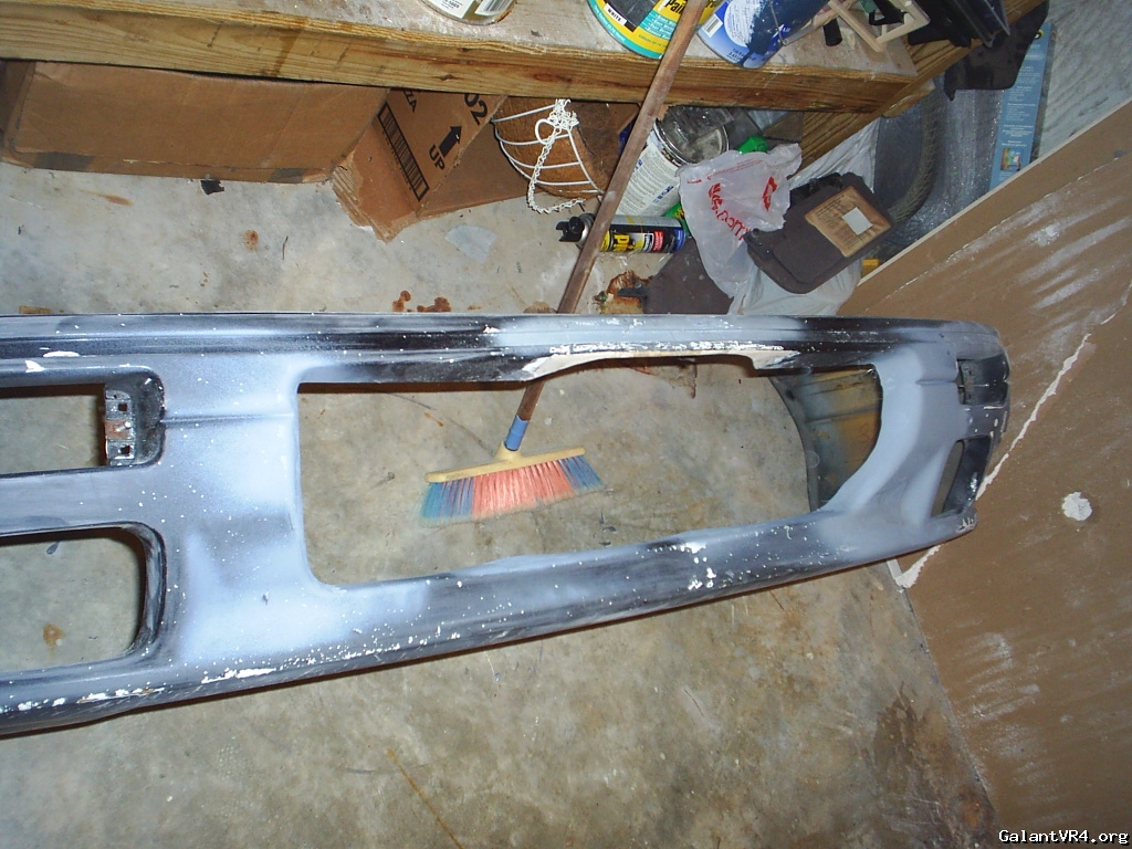

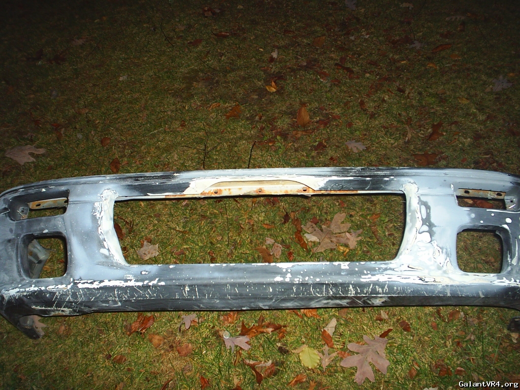

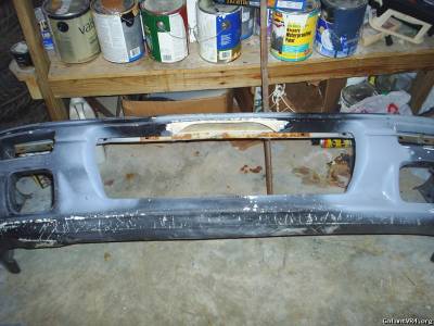

i know mine isnt the first one like it but i thought i would share.

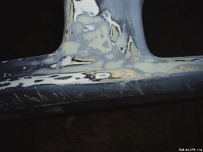

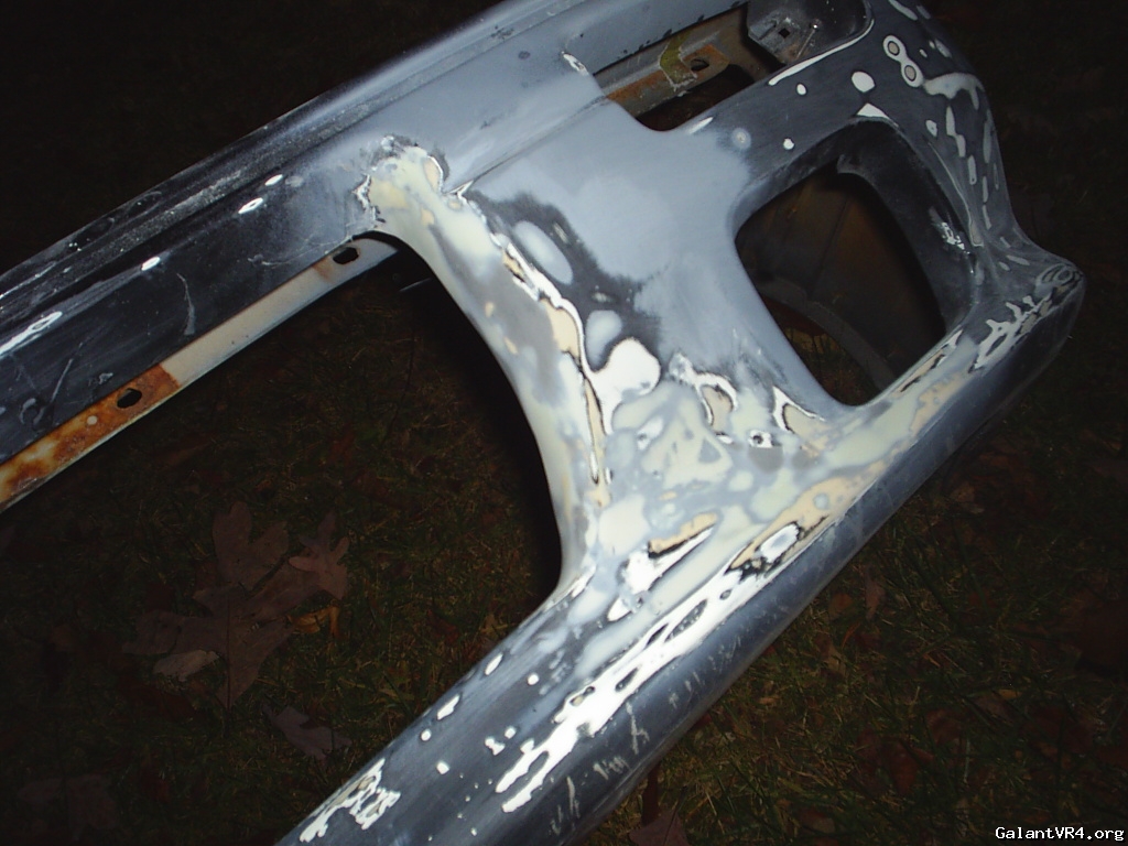

this is the first stages of it
this is right before primer

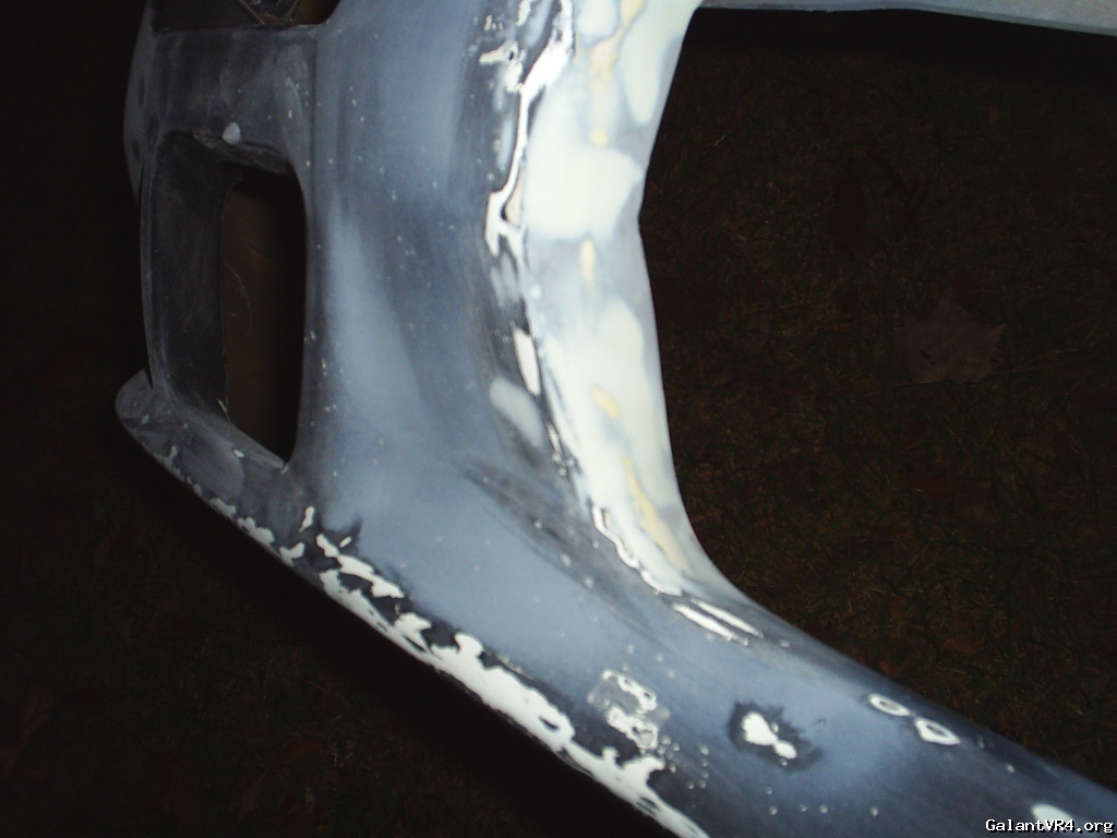

there was a crack there

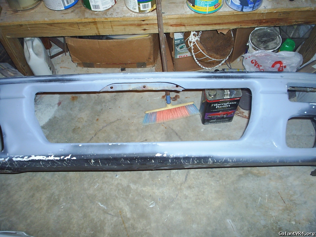

and all primered up

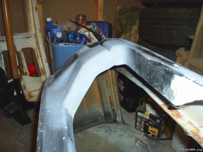

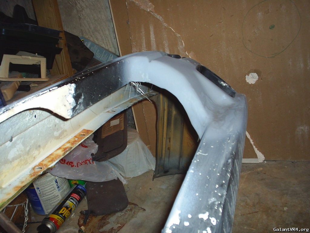

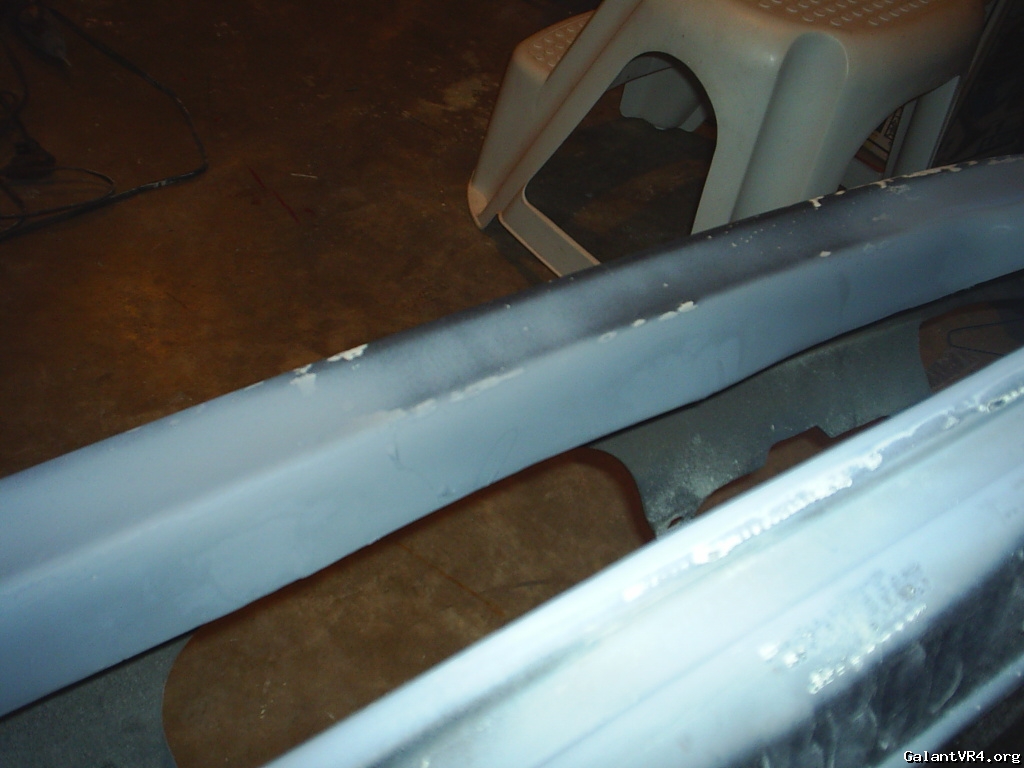

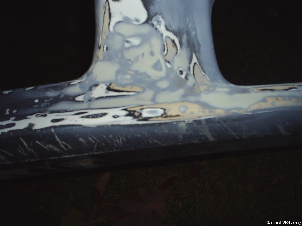

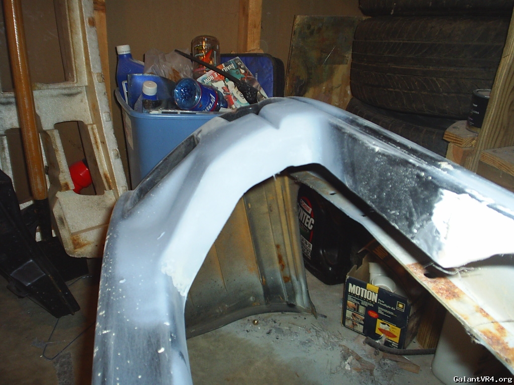

i started this on friday. i have about 10 hours into it right now. i still have to sand down all the rock chips and primer it all to get ready for paint. im still thinking of a way to fill in the big hole on the top of it.

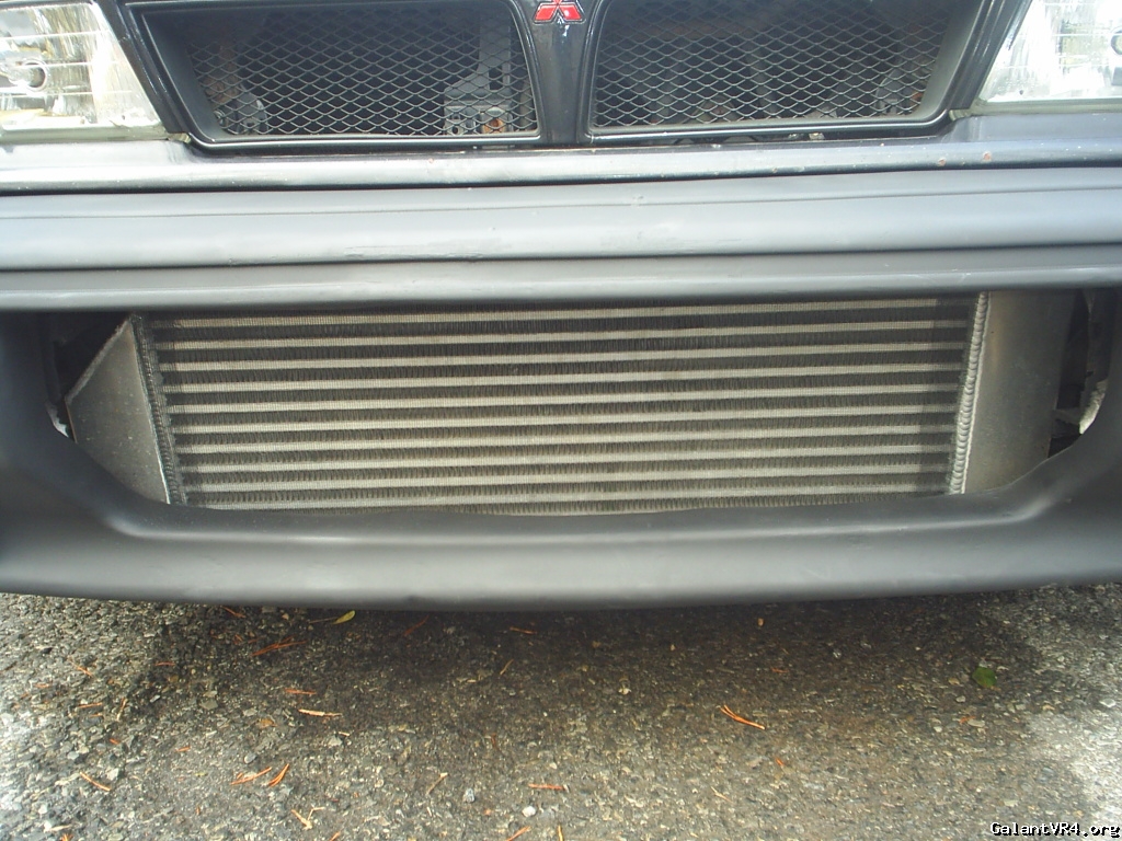

i got the other ones but that one i dont know what to do with it. the front bumper looked like crap befor i started so im kinda making it look better than it did when i got it. i also wanted more air to my intercooler /ubbthreads/images//graemlins/devil.gif
i plan on going to a jdm front bumper but this it so tie me over till then LOL!!!

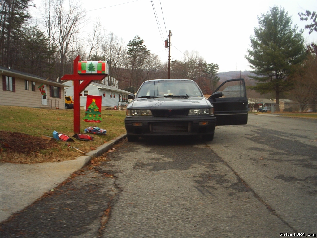

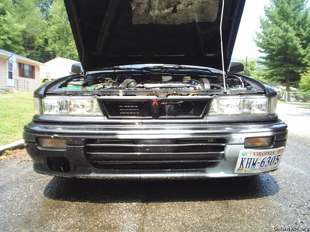

this is befor

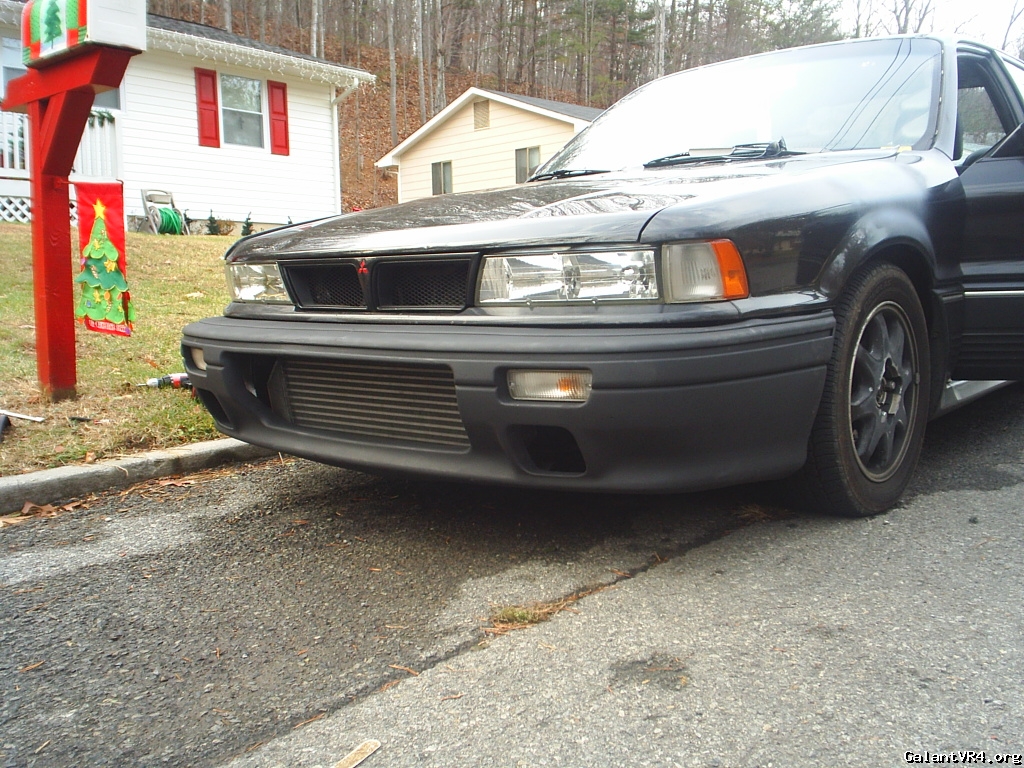

it will take me a few more days to finish it. im hoping by this weekend i will have it done. then i will take pics and post them up just for you guys /ubbthreads/images//graemlins/rofl.gif

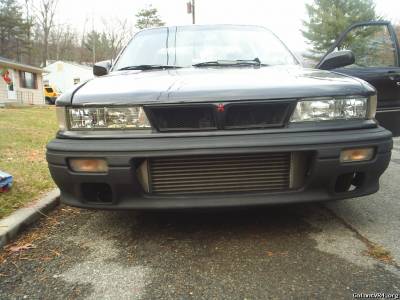

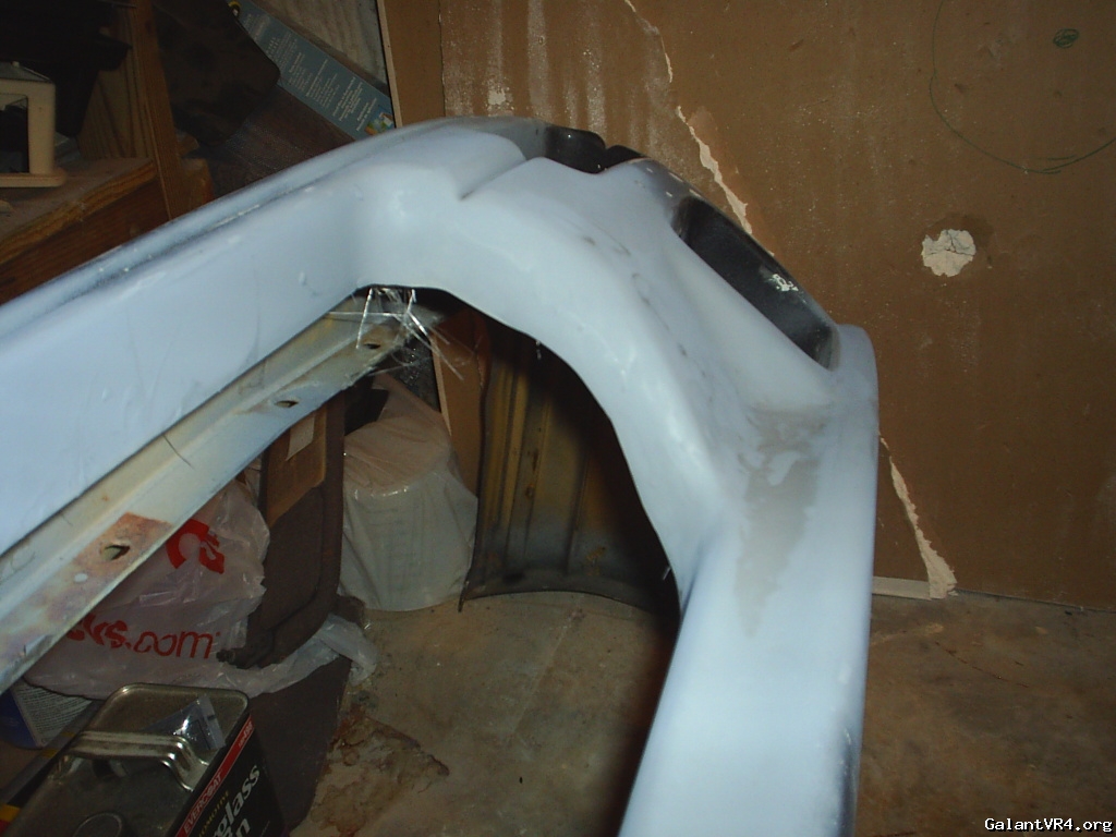

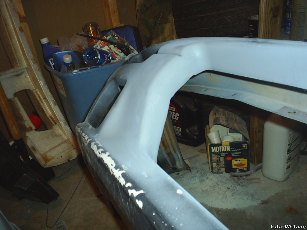

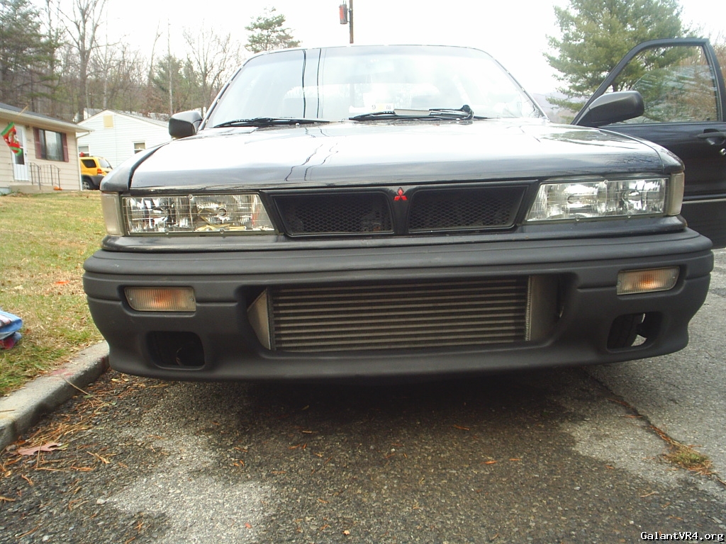

i wasnt going to do it bc it would take away the sleeper look. but my bumper was in need of some work.
so i started it and thats how it came out.
thanks for all the compliments

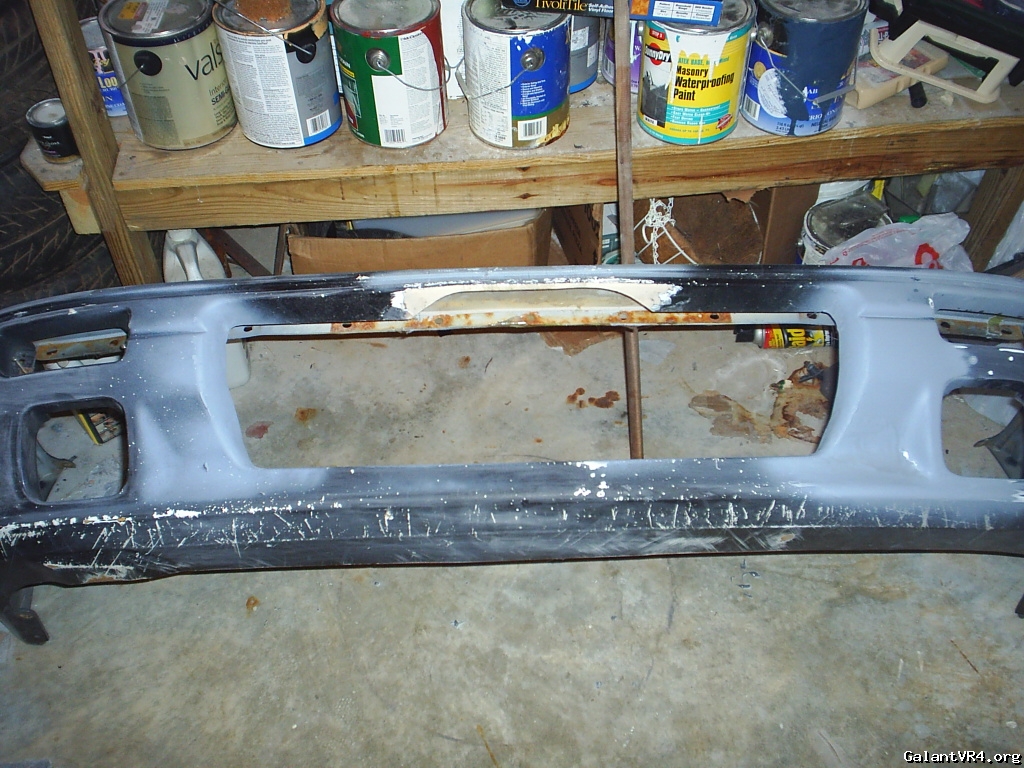

Maybe i'm missing it but what exactly did you do besides remove the slats ?
clipse90gsx
Feb 28, 2007
465
roanoke va
i filled in the holes from removing them. when you cut them out you have to holes on the sides on the bottom and the top. i got the sides and bottom done but didnt do the top.
I like how that turned out, looks like it came that way. /ubbthreads/images//graemlins/applause.gif
