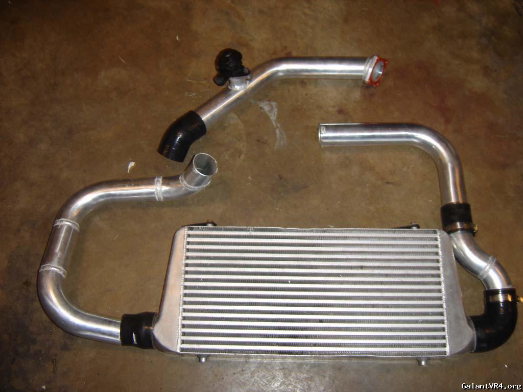

got it off i see you cut the bumper support did you cut into the frame in thr front at all... here is a pic of my set up
the only problem i have ran into is to where to relocate my external oil cooler... i'm thinking if i just have it behind the FMIC it should be fine... and what did you do for the hood release? I just fab'd up a 1/4 in think piece of angle iron and drill holes and connected it to the top of the front clip right behind where the grill goes

I didn't cut my support at all, but the previous owner did. There is no room on mine for the fogs because of the way the IC piping is routed.
