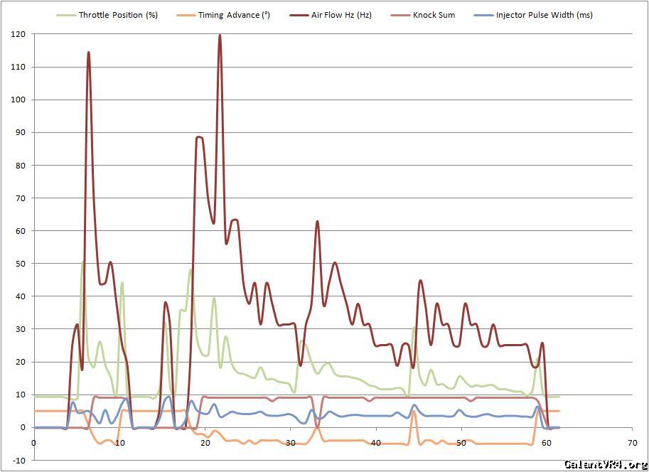

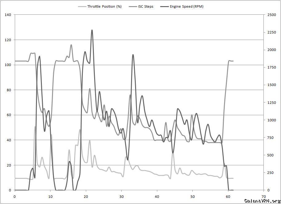

I finally got around to converting my logs.
Here's one where I had to keep the throttle over 10% just to keep the car running:
The Low Fuel Trim is not graphed, but it was at 140%. Mid and High were at 100%.
Also note that my MAF Hz is only being logged at 1/2 the actual value, so 100Hz chart value is actually 200Hz.
So what can you make of this log?
