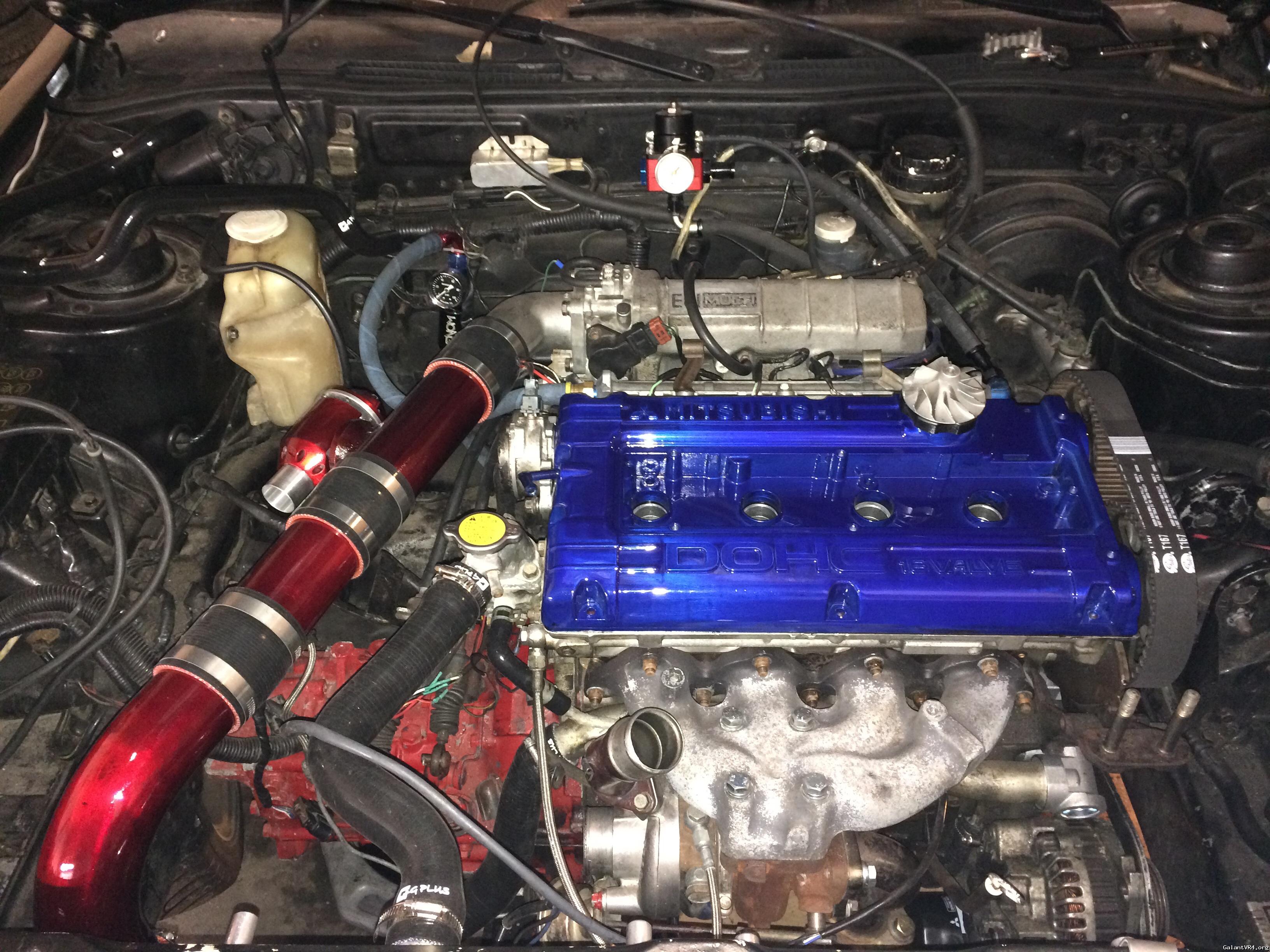

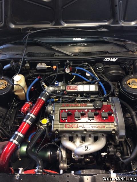

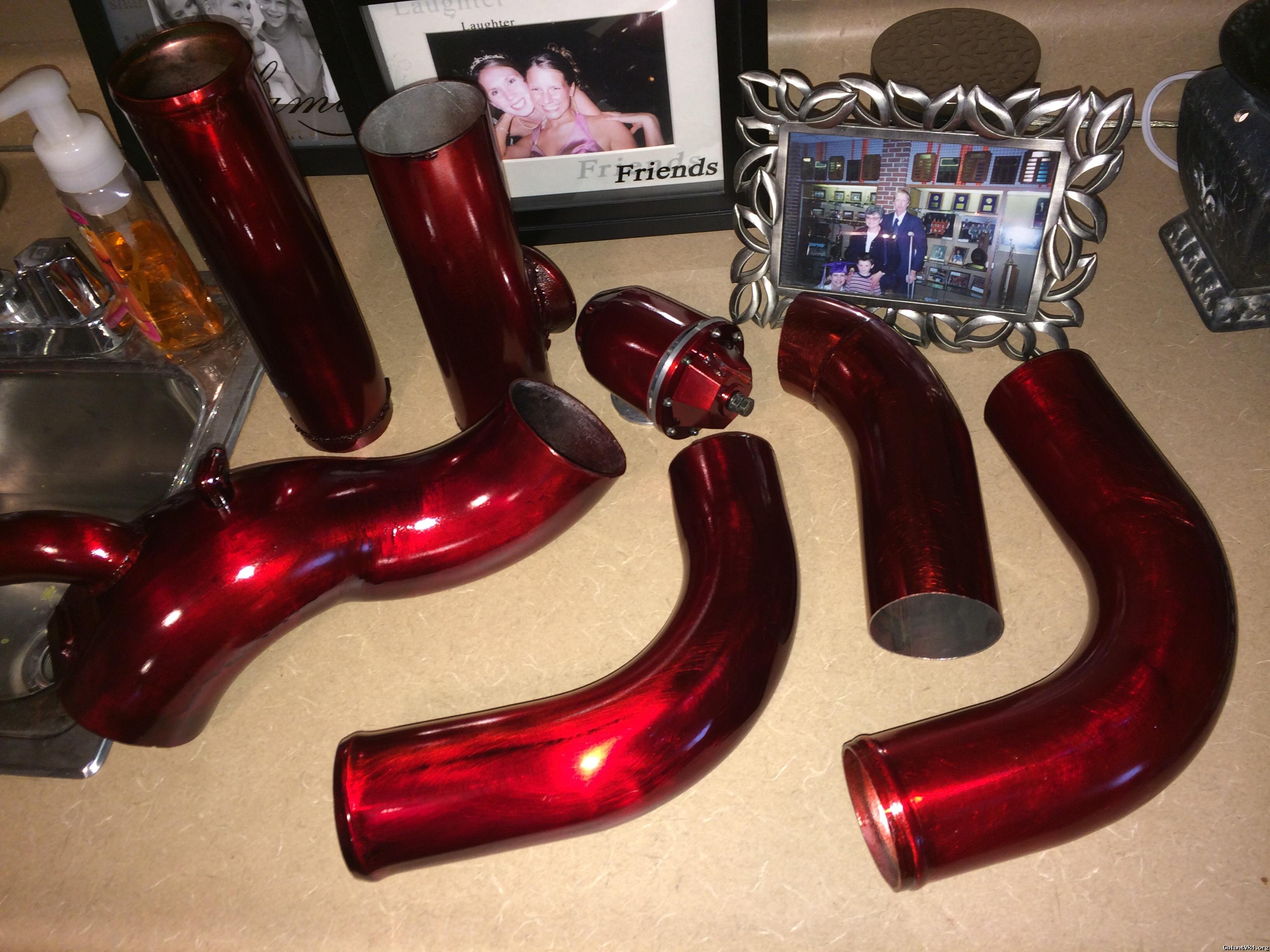

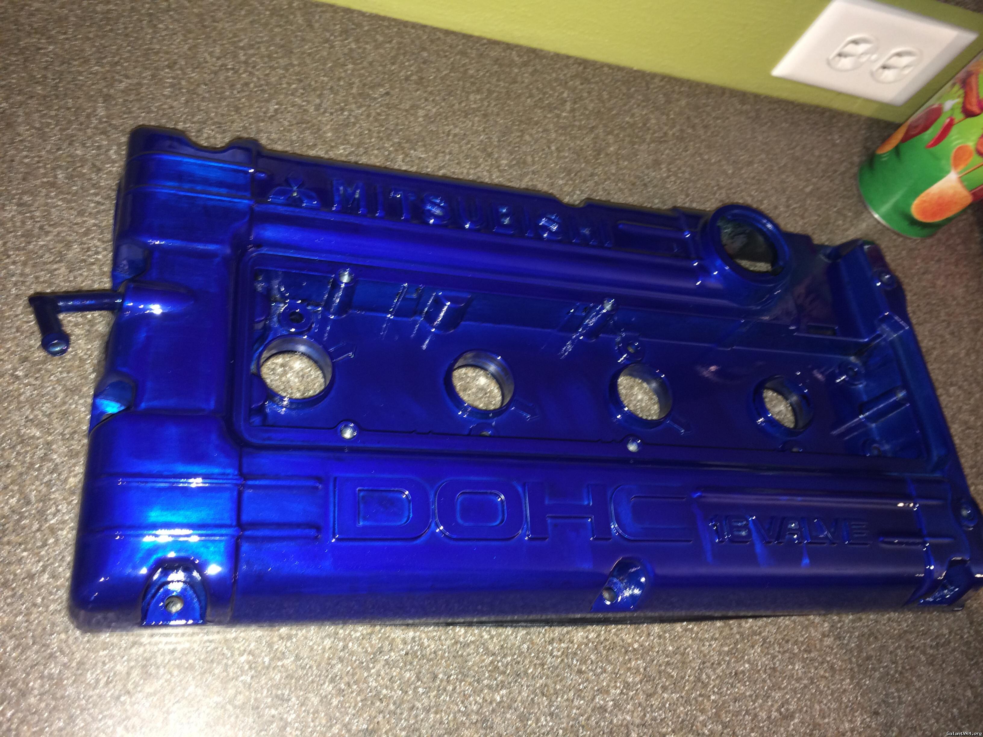

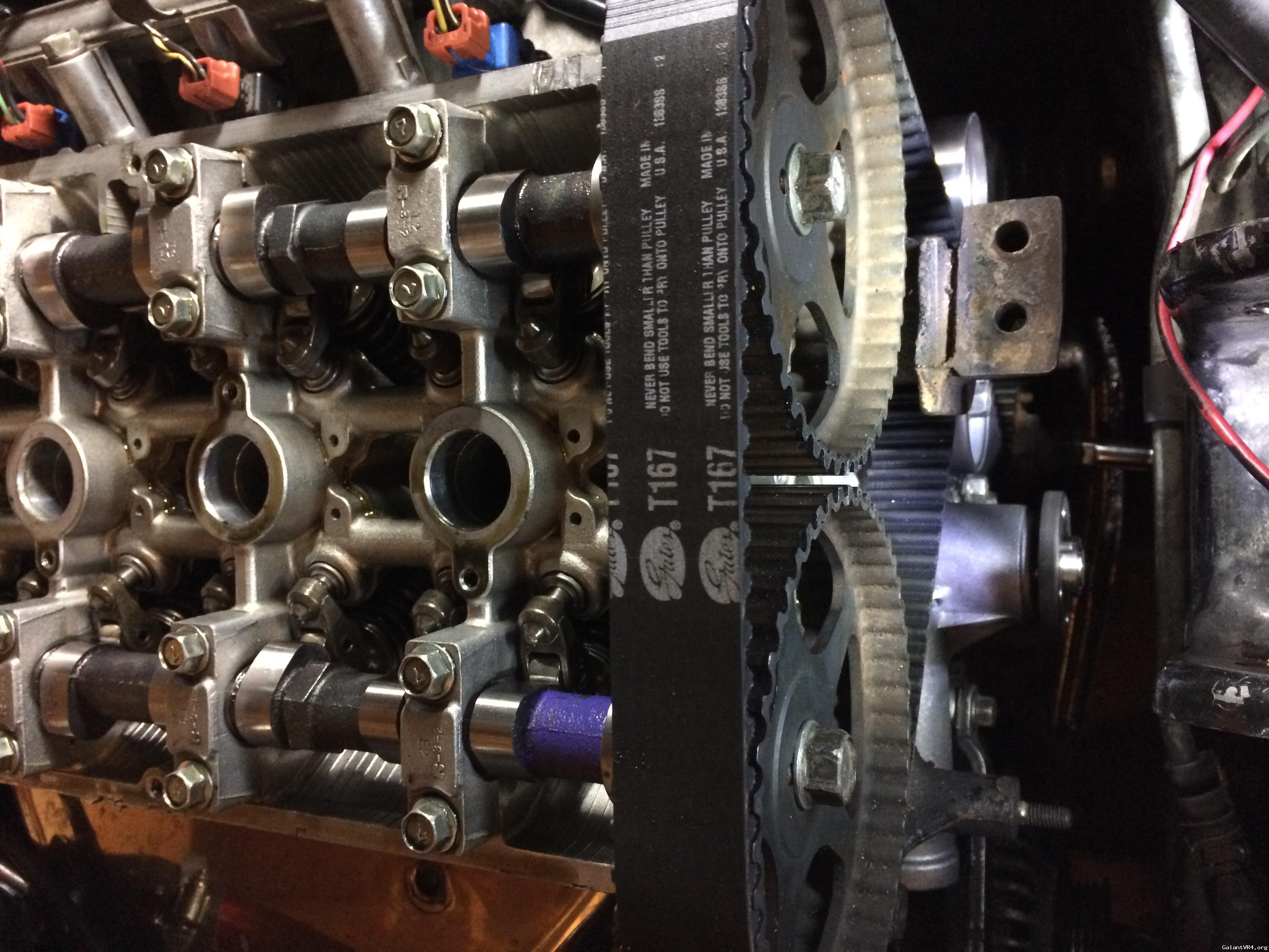

My Intercooler piping, sanded it down and used duplicolor metalcast red
Fp2 cams and t belt installed

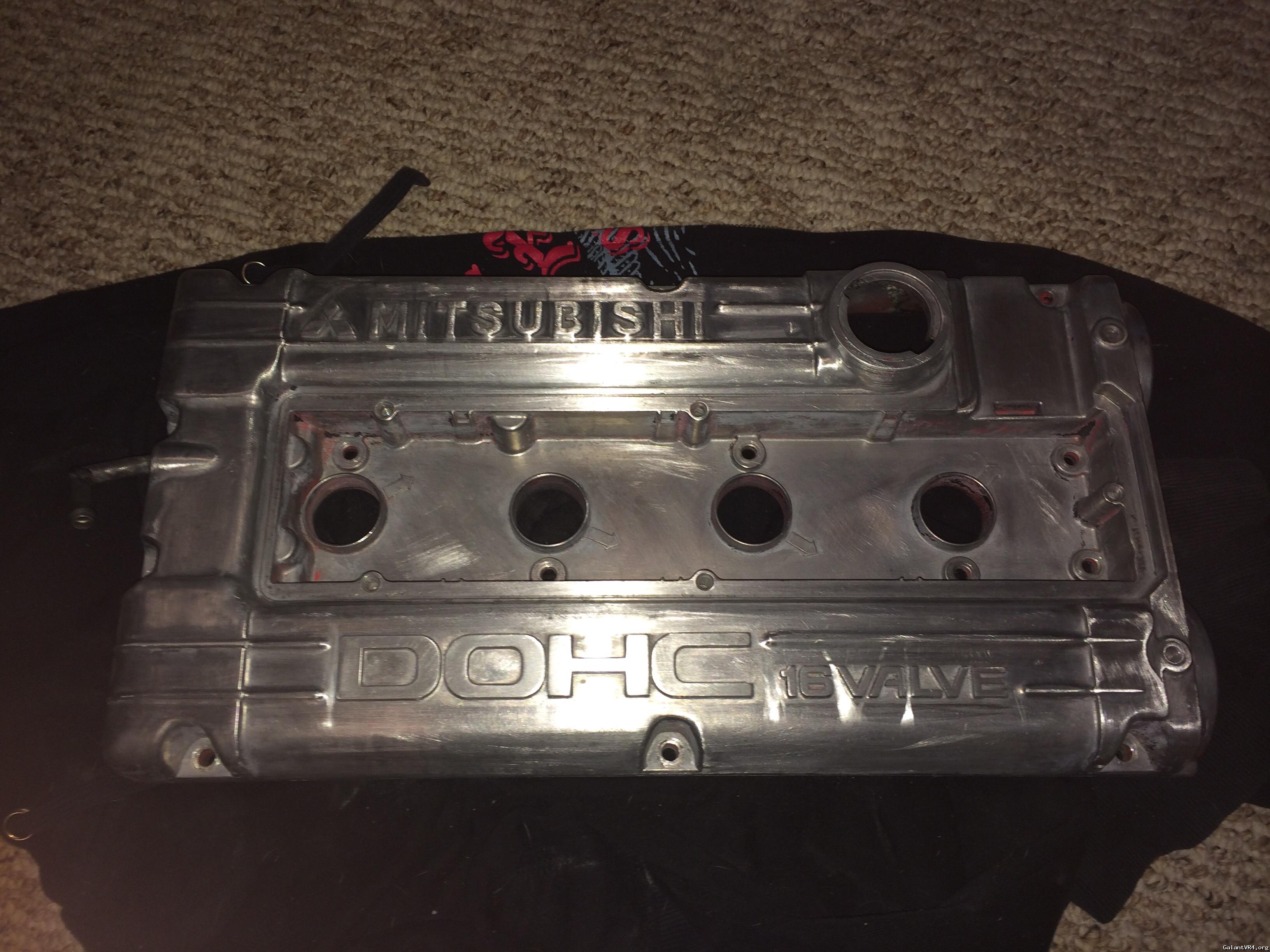

Valve cover before
Valve cover prepped and ready for paint
And after, I went with the same duplicolor metalcast but blue obviously lol
Mocked up, the letters on the valve cover will be painted the same red as the piping

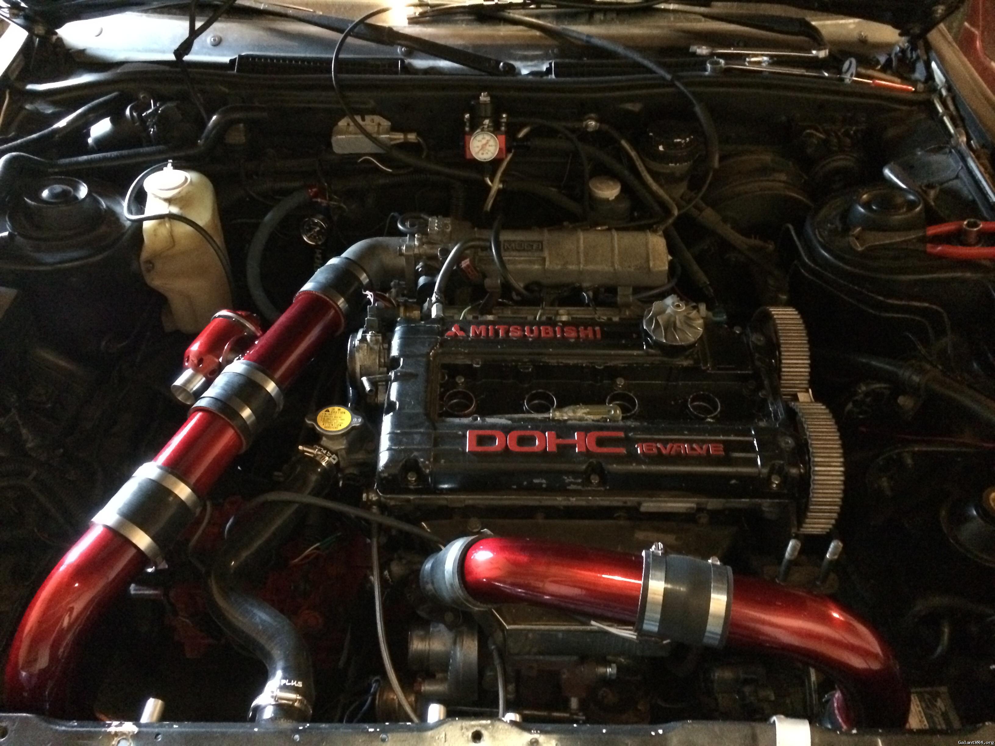

It has been a while since I have did an update on where the galant is at now. New mods include:
Precision 3255 turbo
HKS 272 intake and exhaust cams
FP exhaust manifold
1000 cc Precision injectors on e85
Shifter base bushings
Tein pillow ball mounts
White plasti dipped rims (I will be powdercoating them now that I am sure I like the color)
Speed density with GM map sensor
DW 300lph in tank pump
NRG Suede wrapped steering wheel
NRG quick disconnect wheel hub
And other stuff I know I am forgetting.

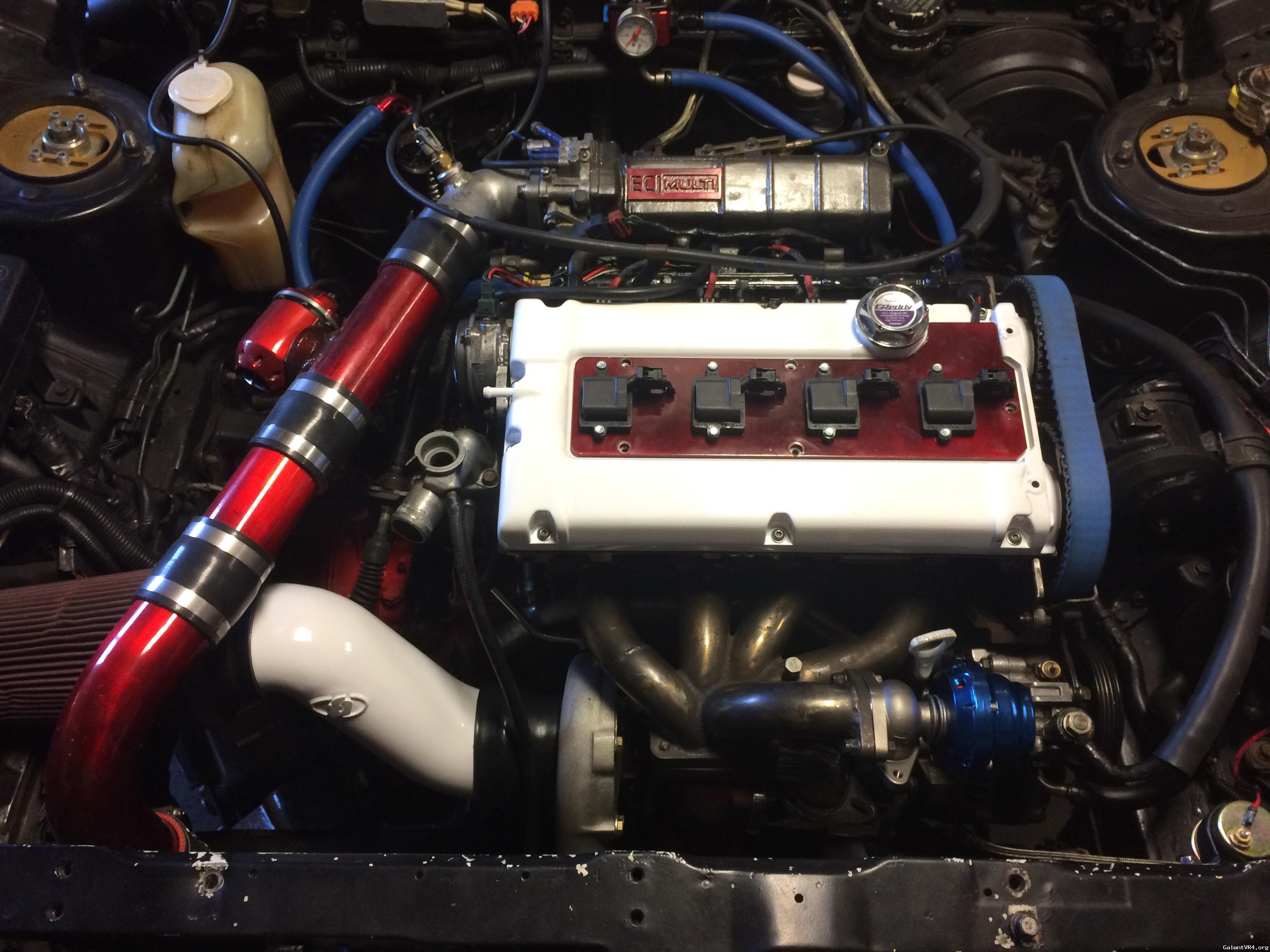

Update time!
So I have been busy working on installing a lot of new parts on the car since the last update.
New parts:
South Florida performance t3 manifold (it's been welded on the inside and cleaned up to match the t3 gasket.
Brand new PTE 6153re dual ball bearing turbo
Cyclone intake manifold (t25 wastegate actuating butterflies)

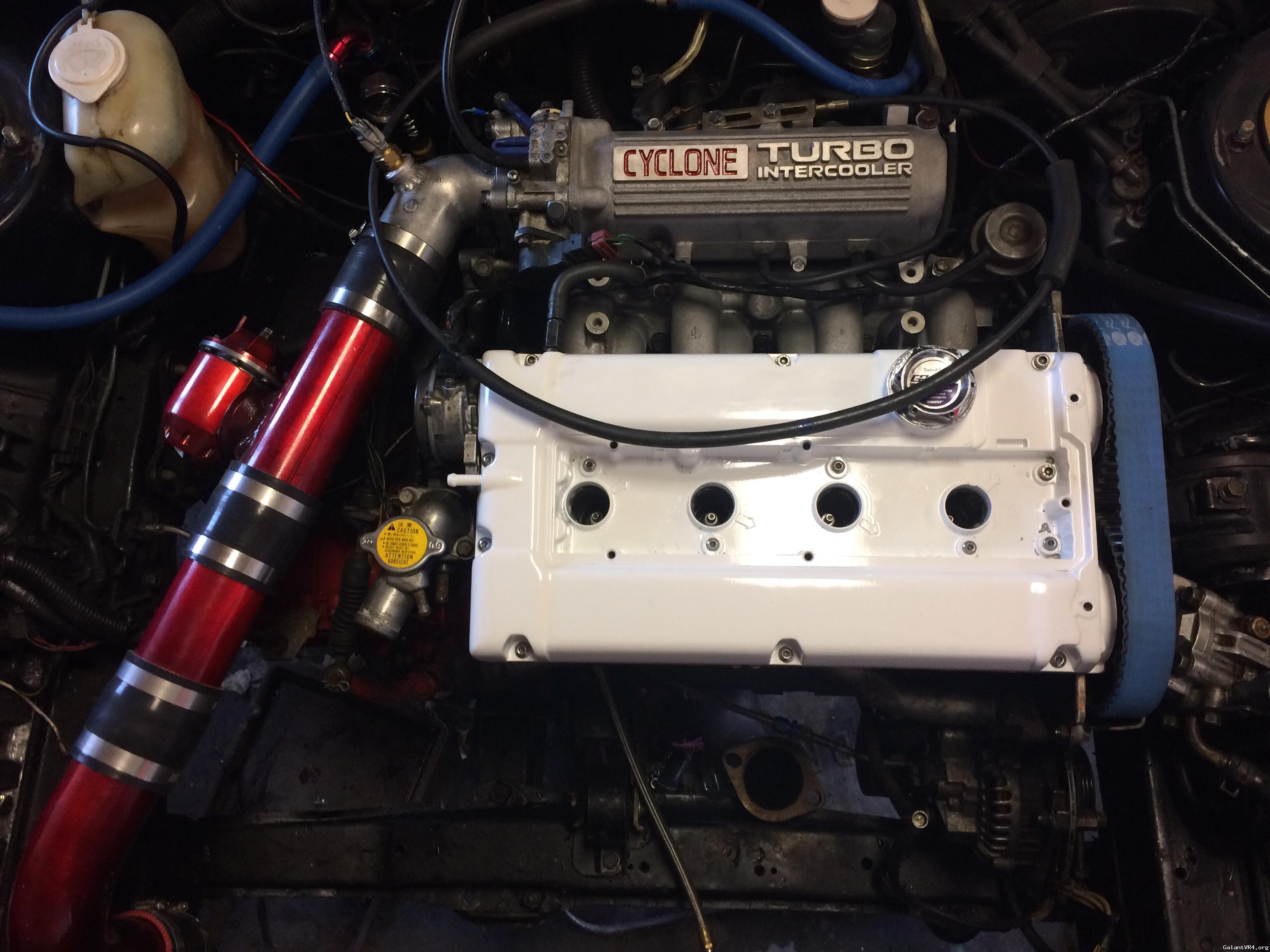

Shaved valve cover and powdercoated white
2g power steering pump
-10an oil return with bung welded to pan
38mm external Tial wastegate
Stainless exhaust manifold studs
Vibrant silicone vacuum lines
FIC 1650cc injectors
5 lug swap with all brand new Mitsu bearings and dust caps
Powerstop cross drilled and slotted rotors
3000gt vr4 4 piston calipers
13.1" front rotors
Evo x MR BBS rims (powdercoated white)
4" fp intake powdercoated white
Gates blue timing and balance shaft belts
2g injector clips
I haven't gotten a chance to start it with all of this, due to not having a second set of hands to help me bleed the brakes, I also had to take the turbo setup off due to breaking off a stud in my head :/ So as always it's JSB!

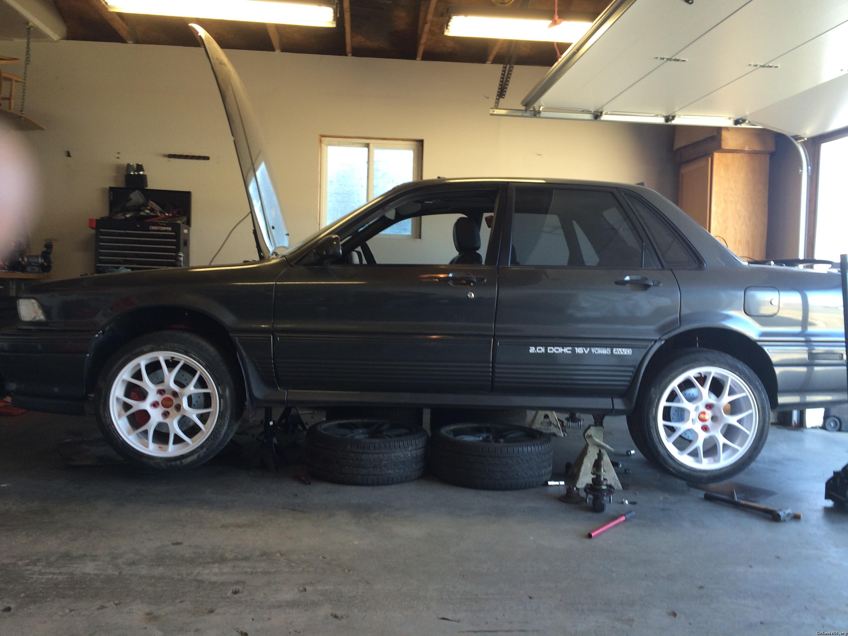

14of2000
Aug 12, 2012
147
Sioux Falls, South Dakota
Hey guys, its been a while since I have updated this. With JNava adding it to the calendar, I figure its time for an update <img src="/ubbthreads/images/graemlins/smile.gif" alt="" />
This is the full mod list at the moment.
1991 galant vr4 222/2000
Current mods
-Body/paint-
2002 Isuzu Trooper Anthracite Pearl Metallic Paint
Real carbon fiber AMG replica grill with yellow fogs
1993 Galant LS front bumper ( No Fog Light Holes )
De badged
Shaved trunk lock
Shaved Antenna
JDM Clear Corner Lights
Performance Cafe' HID's
LED front Bumper lights
Evo vortex generator
Hella horns
-Interior-
30% tint in the front 20% in the rear
Torque solutions shifter base bushings
SlowBoy Racing weighted shift knob
NRG suede wrapped steering Wheel
Sparco Pedals
Alpine 4 channel 450x4 amp
Alpine mono D class 450x1
Innovative mtx-L wideband
HKS Turbo timer
Battery Relocation to Trunk
Suede shifter boot w/1g shifter
Rewrapped headliner/ visors/in black suede
-Suspension-
5 lug swap with all new Mitsubishi OEM bearings and dust caps
Evo 8 Enkei rims
4-bolt Viscous LSD rear with no 4WS
Torque solutions carrier bearing bushings
New drivers and passenger cv axles
New lower control arms
Removed All Emissions
Tein camber plates
-Brakes-
3000gt VR4 4 piston calipers w/bertha brackets
Ceramic brake pads
Cross Drilled Powerstop Slotted rotors 1/4'' Spacers in the Rear
-Transmission-
Stock rebuilt Tranny/t case
Act 2600 clutch
Fidanza 7lb flywheel with auto tranny ring and extended bolts
Braided stainless clutch line
-Motor-
ARP headstuds
Stock rebuilt motor with &lt;5000 miles
HKS 272 cams
New gates blue racing timing belt and balance shaft belt with all new pullies
Zaklee clear t-belt cover
Mhi tensioner
All gaskets replaced with all Mitsu OEM gaskets
Prothane tranny and drivers motor mounts
2g injector clips soldered and hear wrapped
3G lifters
Powdercoated valve cover white
-Head-
6 Bolt head
Ported and polished
Light polished chambers
Valves unshrouded
1mm OS nitrade stem
Cut Valves
Iron guides sized to valve
3 angle valve job
1 Surface cut
BC0100 Springs
Titanium Retainers
New valve keepers
New valve spring seats
-Turbo-
Stainless t3 5 bolt o2 housing
3" Megan downpipe
3" Turboback exhaust
Map performance tubular exhaust manifold
PTE dual ball bearing pte6152
Tial Wastegate
-Intake-
Jdm cyclone intake manifold activated via link
FP intake with 4" filter
N/A Throttlebody with blocked FIAV
Tial 50mm BOV
Short route 2.5” aluminum intercooler piping
Punishment racing 34"x12"x3.5" intercooler
-Cooling-
Mishimoto aluminum radiator tucked
2 10” Pusher fans
Black silicone radiator hoses
-Fuel-
Aeromotive fpr
Dueschworks 320 lph rewired w/-8an fittings from tank to rail
1850cc FIC injectors
-6an fuel return
-8an fuel feed
Venom fuel filter
-Engine management/Electronics-
ECMlink V3 Speed density
GM IAT
3 bar MAP
Innovate MTX-L
Intrepid COP kit
Glow shift Boost, Oil Pressure, water temp gauges
-Boost control-
W/boost by gear

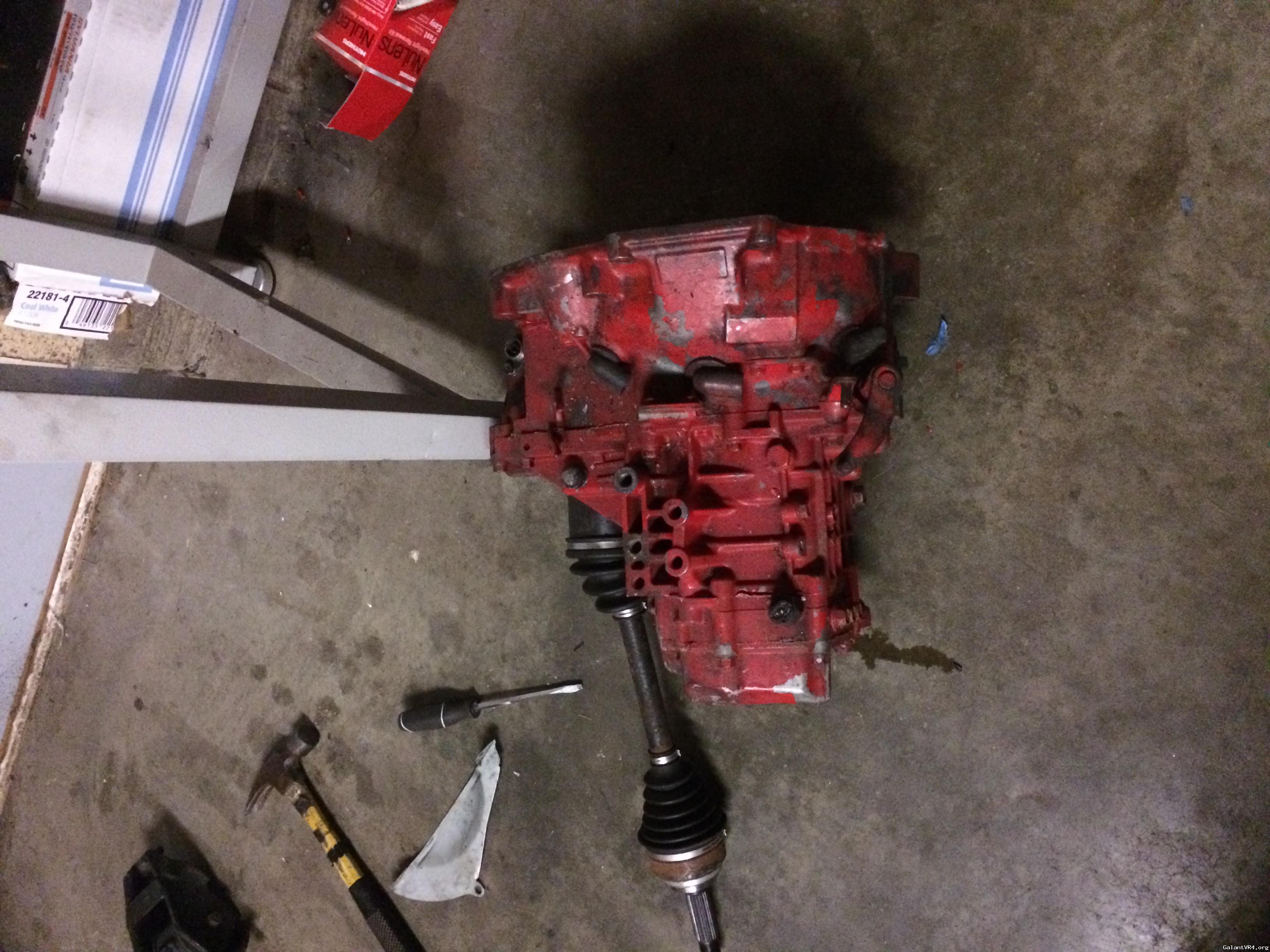

At this point its still on the jackstands. I just got done installing the Ksports that I got from Nate Crisman (thanks again by the way!) At this time, I modified my intercooler piping To make it look better than it did. (All those couplers really annoyed me lol) I also have the transmission out to get a fresh coat of NOT red paint, as it sits now.
So while the transmission is out, I will be pulling the engine to prep the bay for a fresh new coat of paint as well. So things are all coming together nicely! I will be posting pics of all this soon.

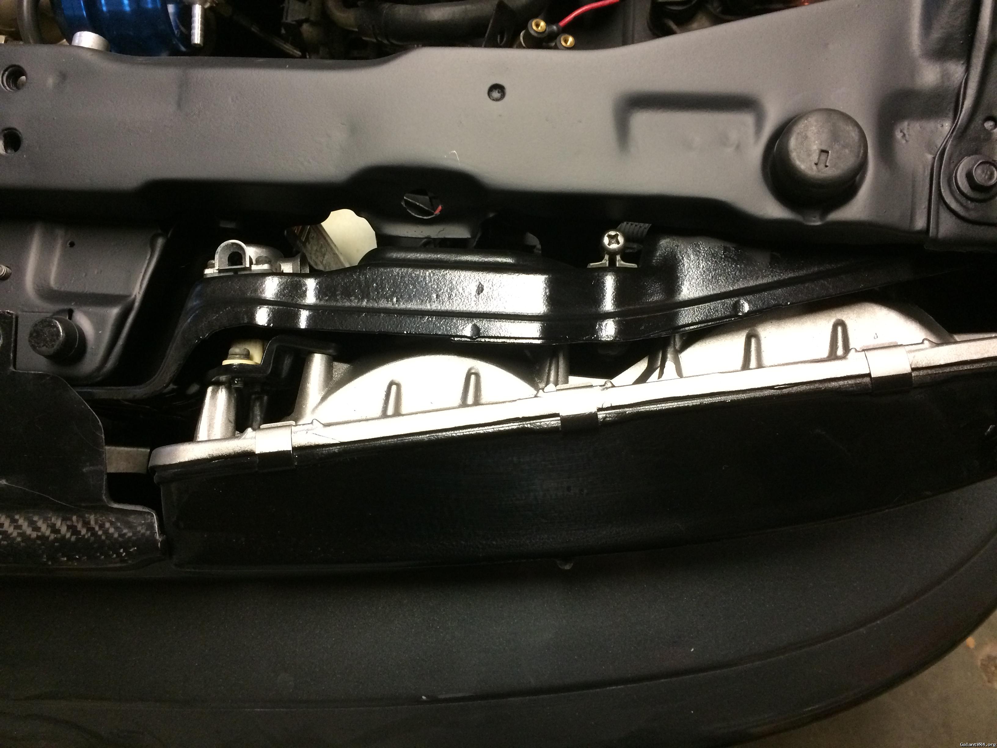

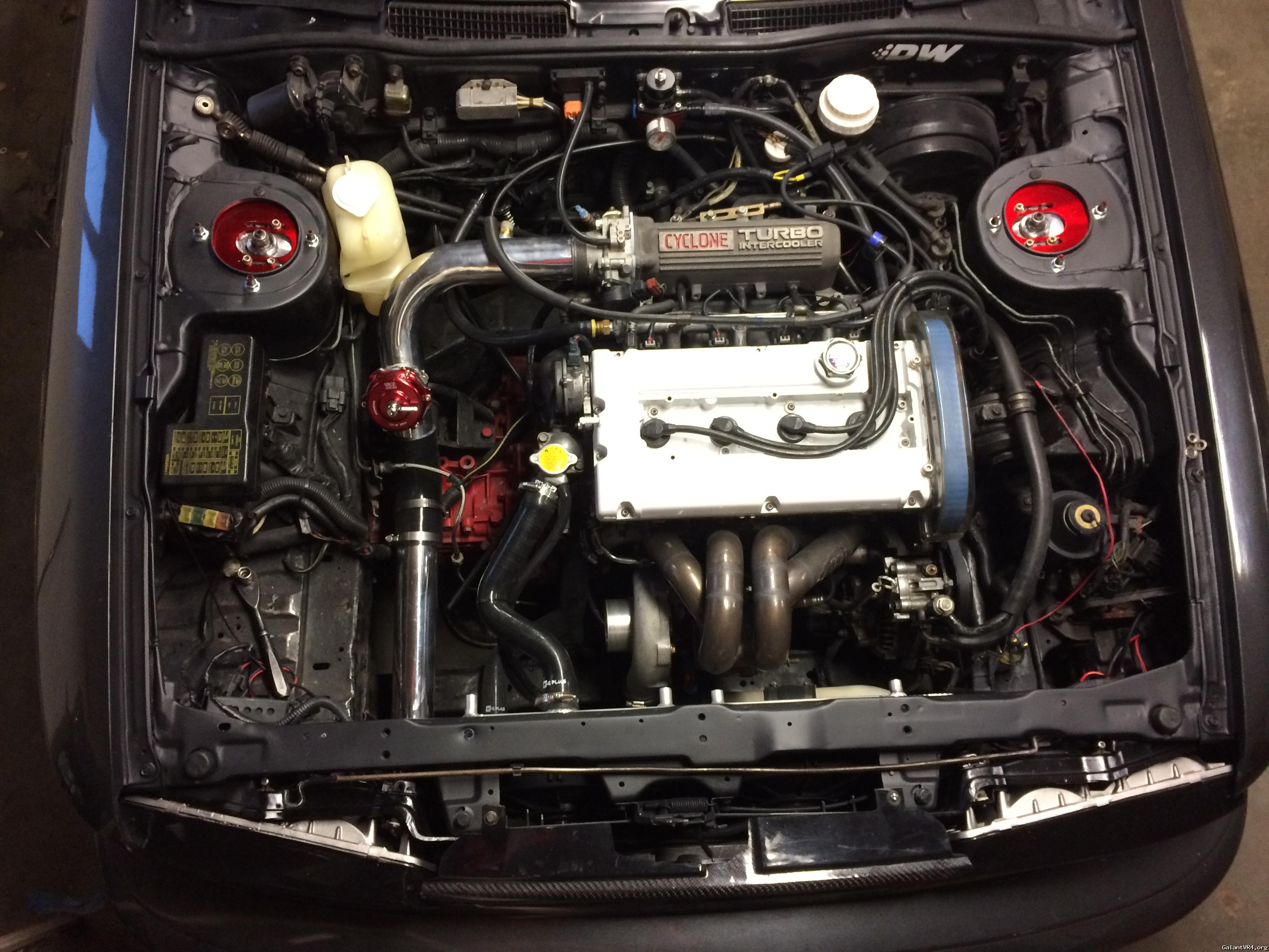

This is what's currently getting stripped and repainted with some alumablast paint.
My engine bay as it sits now. I painted the top of the fenders, cleaned up the headlights, and also painted the radiatior support

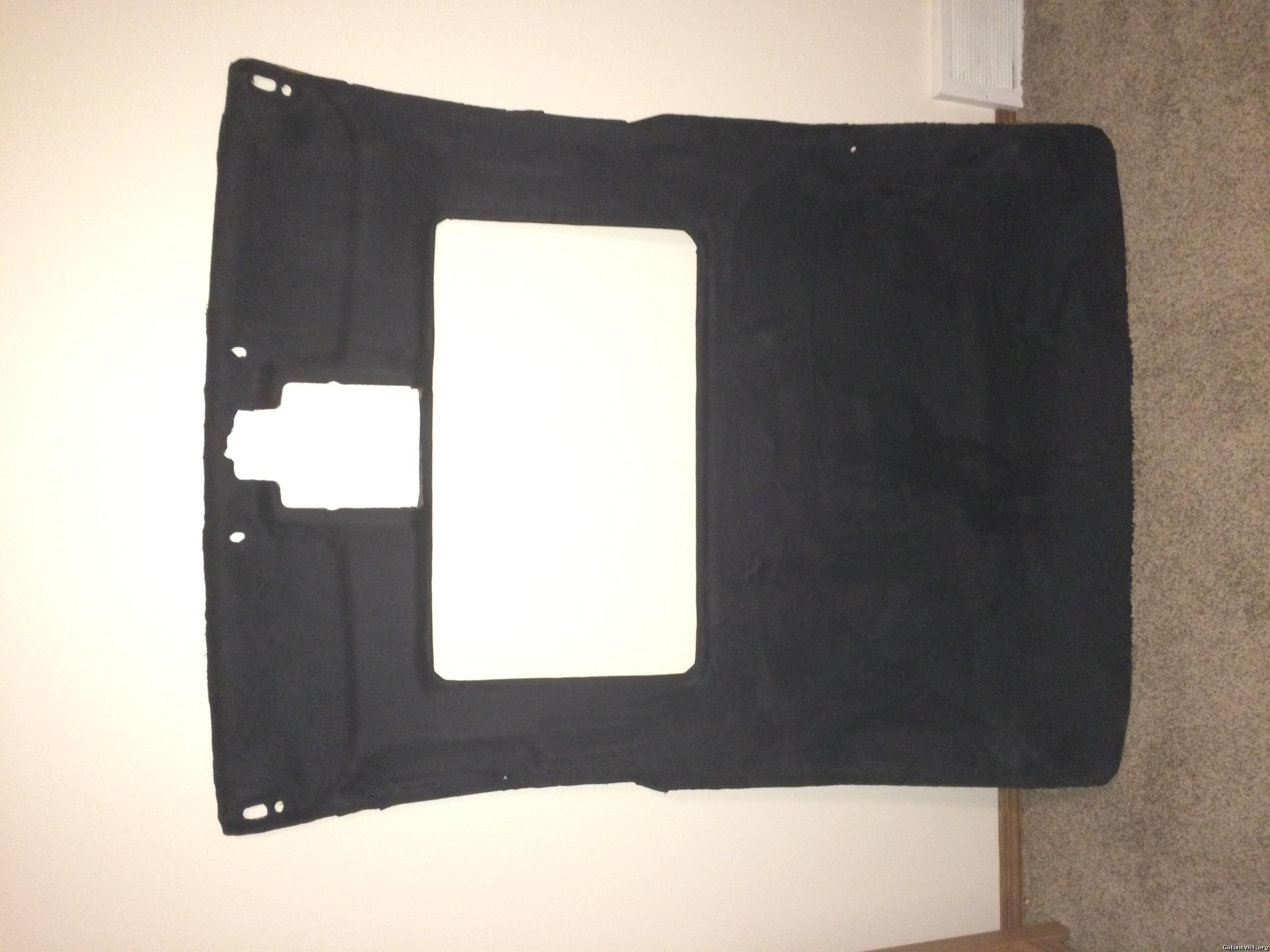

I just got don't wrapping my headliner with black suede. Turned out pretty good. Although I don't know how to get the sliding shade out of the sunroof to get that done as well

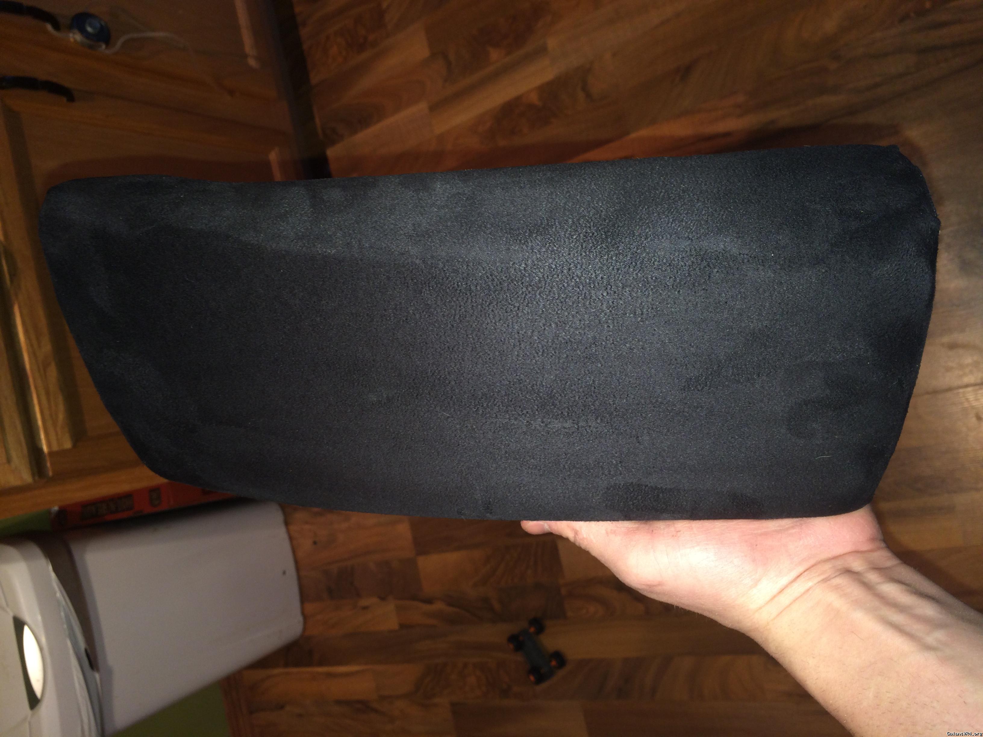

Also did the arm rest and visors while I was at it

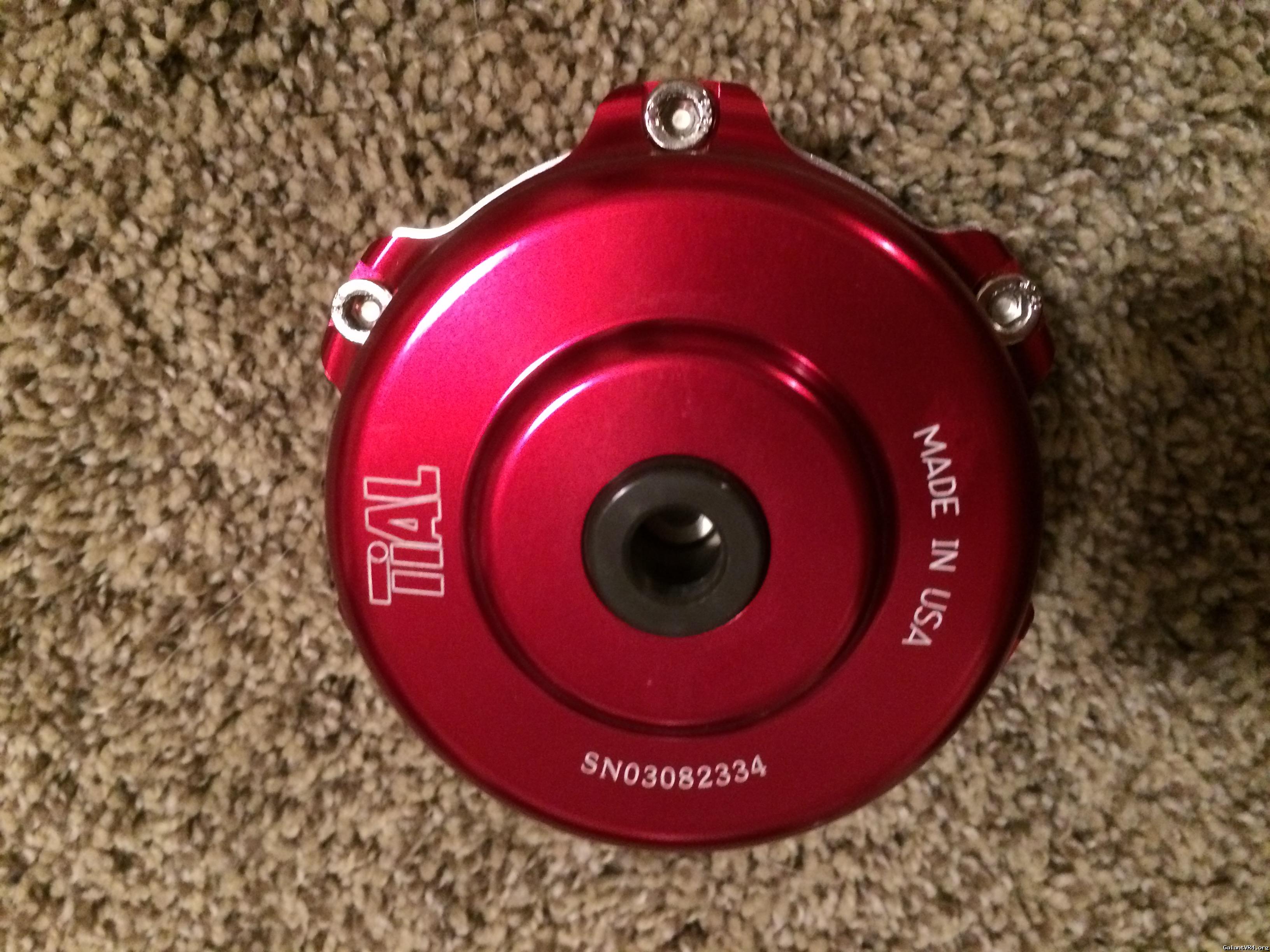

Fresh and new Tial /ubbthreads/images/graemlins/smile.gif
This is the headlight after freshing up
