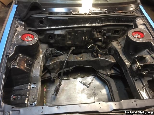

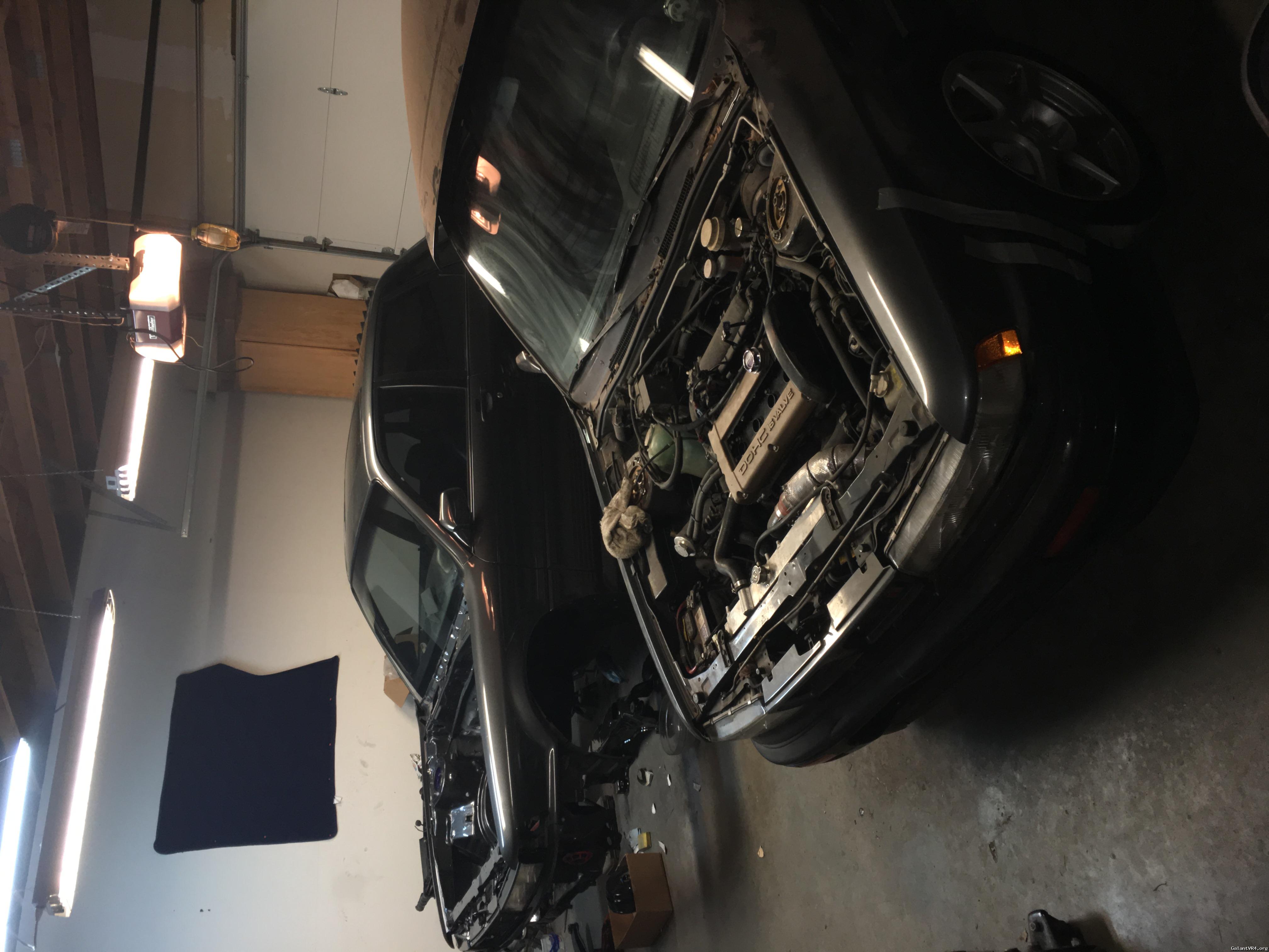

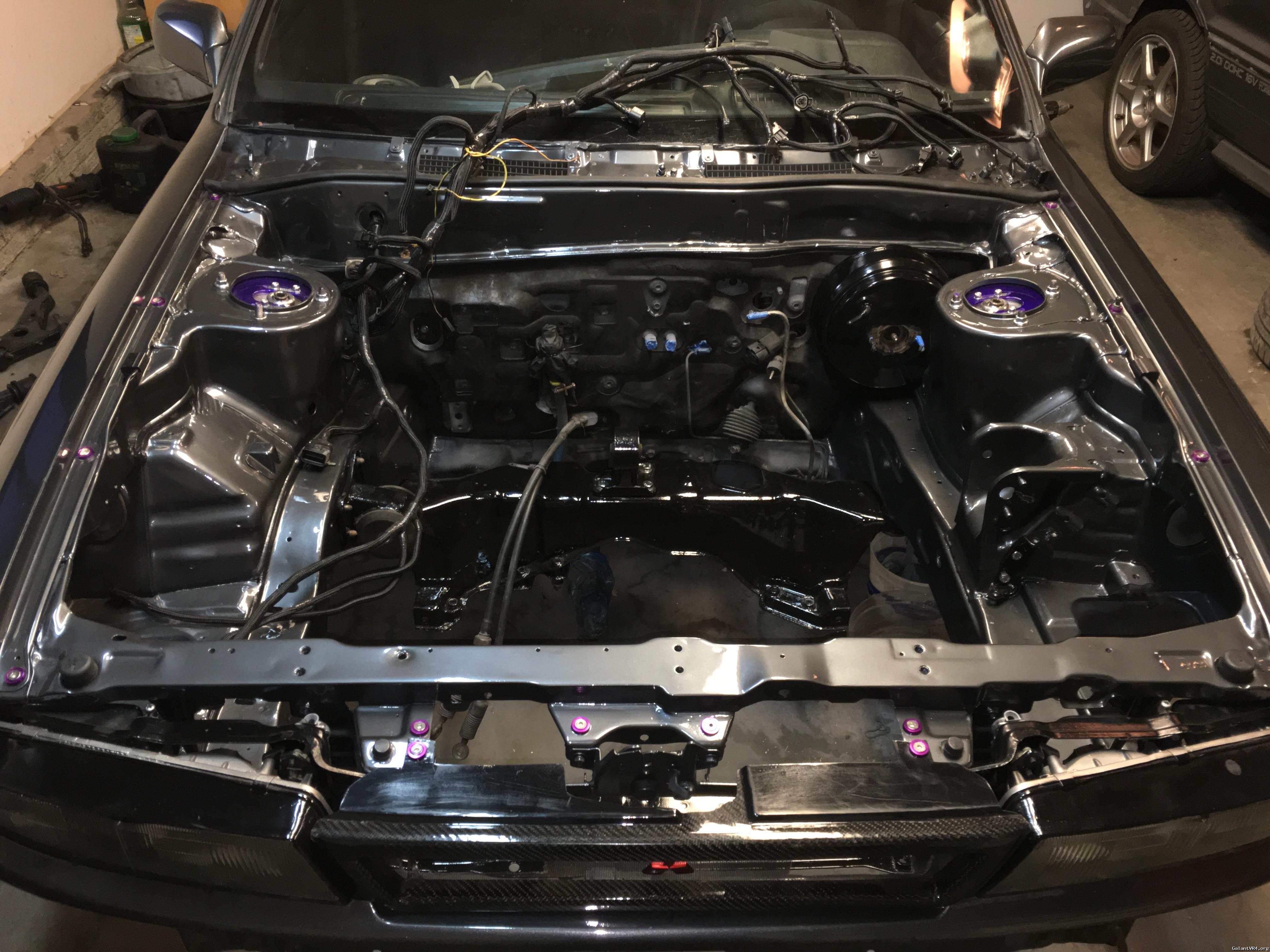

pulled engine going to be sanding down and repainting. I don't know what color to go with, satin black? OR the body color?

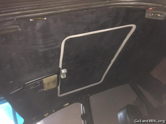

Suede headliner installed. This took forever to get done, During the install process I put some closed cell foam to block some road noise.

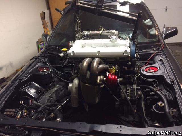

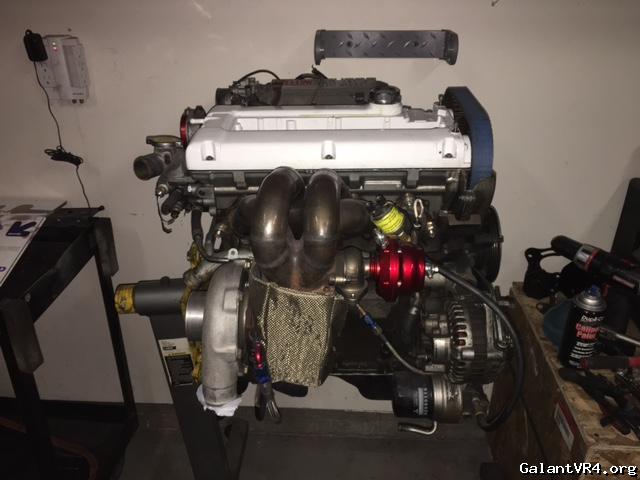

Engine in its new home as of now. Thanks for letting me use my old engine stand Prove_it (Ryan)

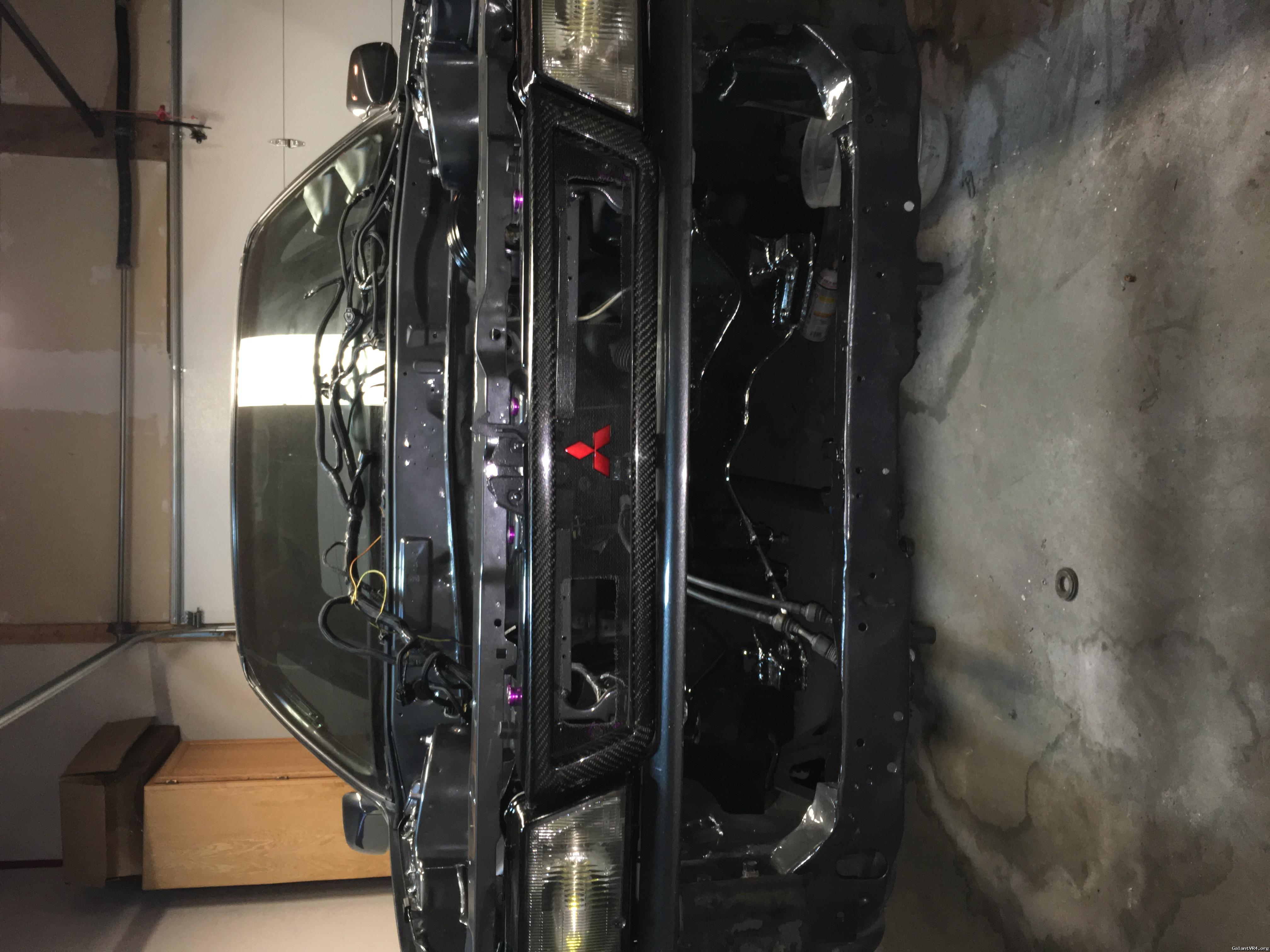

Coming out!

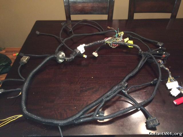

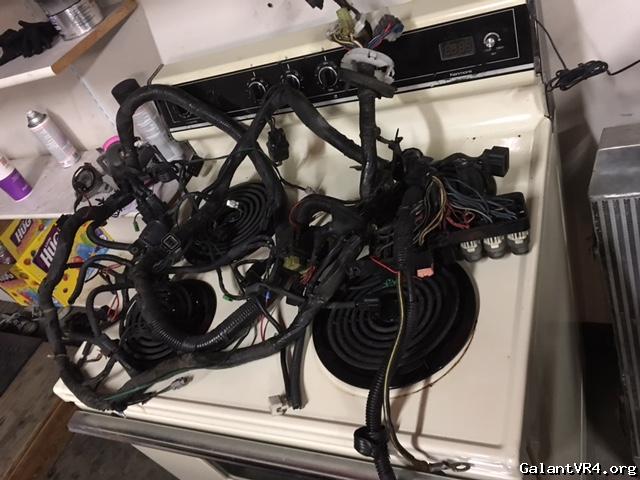

Harness rewrapped and partially tucked, I spent a lot of time on this as well. I used silicone tape and its AMAZING. Also removed a lot of the un-needed wiring.

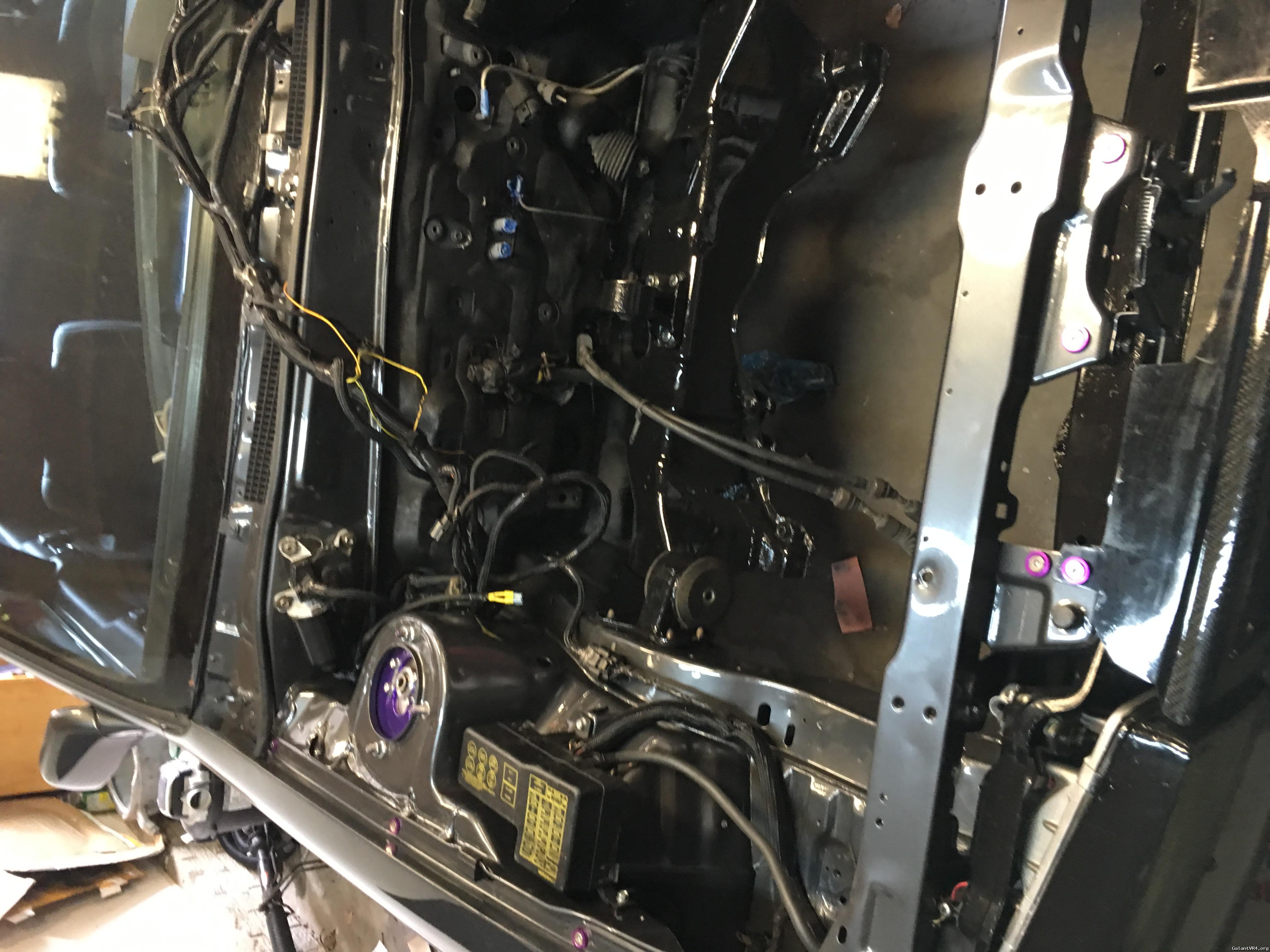

Front harness waiting for the same treatment as the engine harness. This is actually done now, removed ECS, ABS wiring.

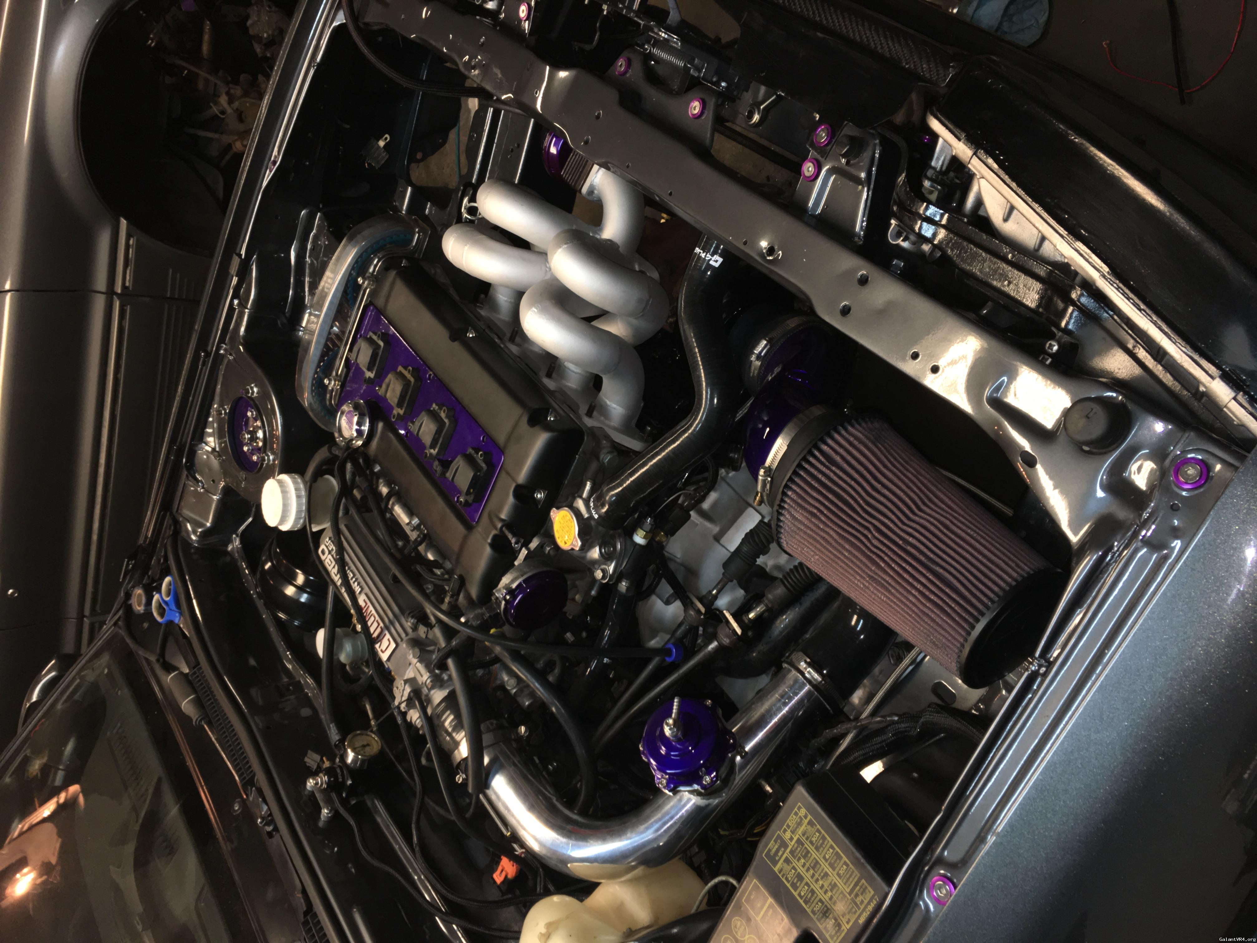

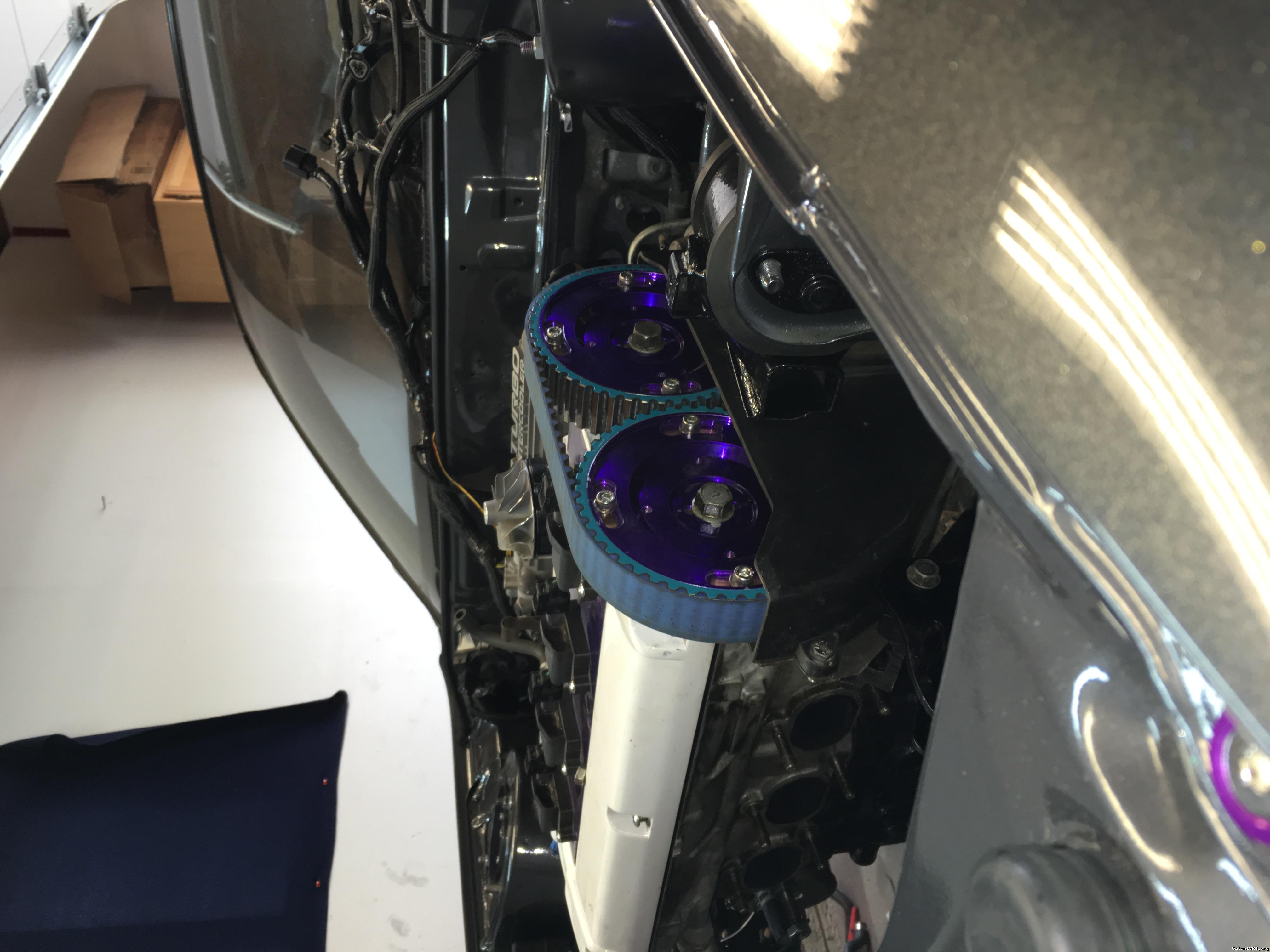

love the car . Engine specs ? :eclipse:
Thanks! It’s taken a while to get here, but I’m super happy where it’s at.
Engine/head
HD Wiseco 10.5CR pistons
Eagle Rods
Stock bore
Straight cut oil pump gears
Uncut crank
Ported/polished intake and exhaust valves
BC 1mm oversized intake valves
BC 1mm oversized exhaust valves
BC springs/retainers
HKS 272 cams
Athena Headgasket
