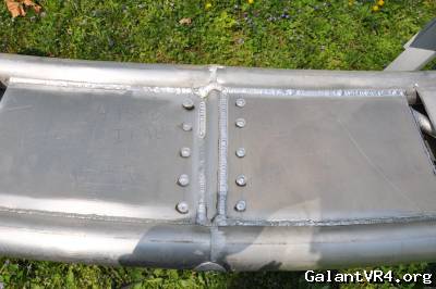

Seriously. TIG weld it or get it TIG welded. I just did this end cap yesterday.
