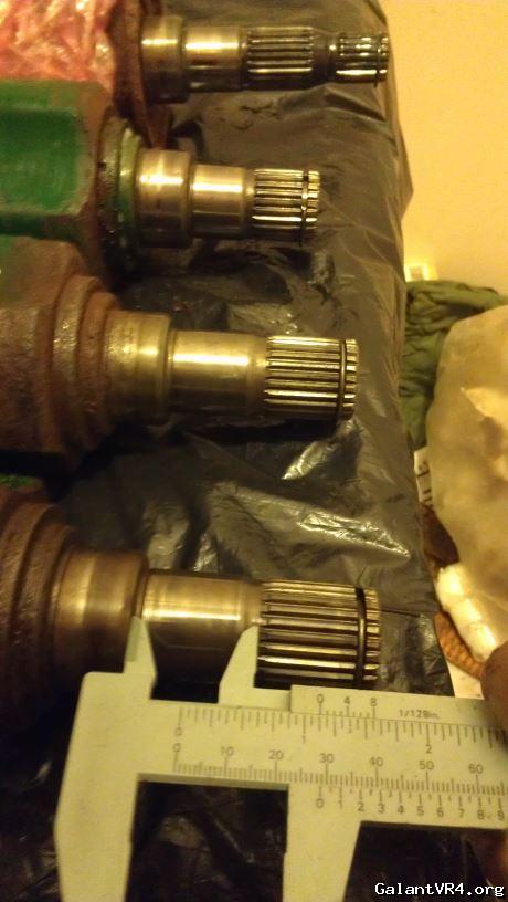

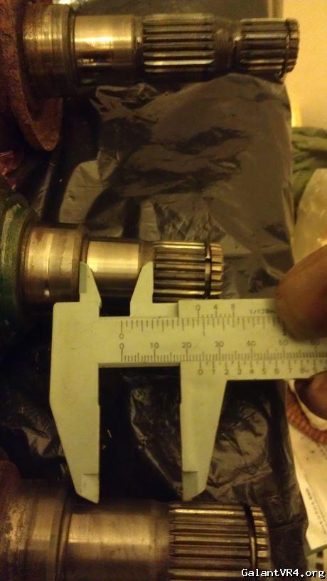

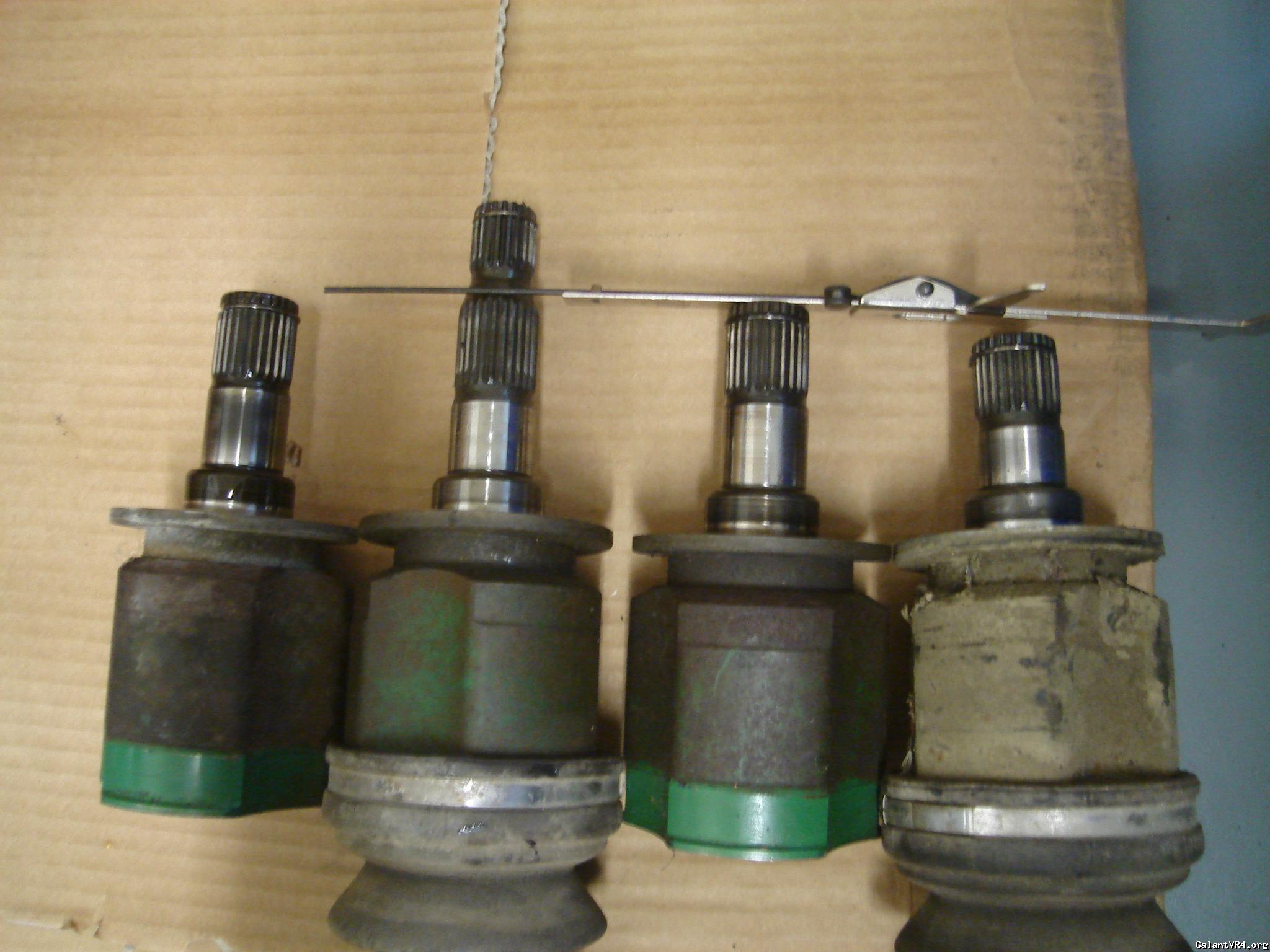

Is this is the first time trying to install this axle/diff set on your car? I once encounterd an issue when I tried to replace the single-splined side axle with a stock one (i.e., non-LSD). It wouldn't go in far enough for the ring to slip past the side gear to lock. (I think it was bumping the other axle or was hitting the pin the pinions ride on??) Anyway, side by side I could see the non-LSD version was longer. If this is a new diff/axle setup for you, you may be having the same issue. Below are pictures I found on this forum and elsewhere comparing them. Correct (LSD) axle is 4mm shorter.
Believe this is the 1G set. 1 & 3 = non-LSD, 2 & 4 = LSD
2G measuring non-LSD
2G measuring LSD
