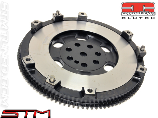

To reiterate I'm using a South Bend Heavy Duty TZ-Series Kevlar Clutch
I've narrowed my options to :
-Stock resurfaced
-RRE No Name
-Comp Clutch
-ACT StreetLite
By the way, The RRE Looks a lot more like the CC than the ACT to me. What do you think?
