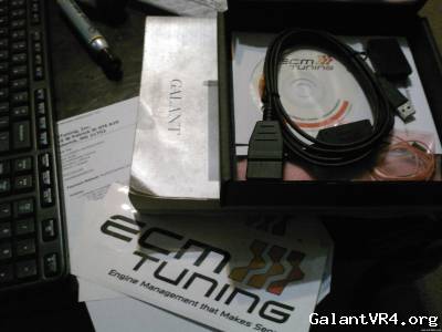

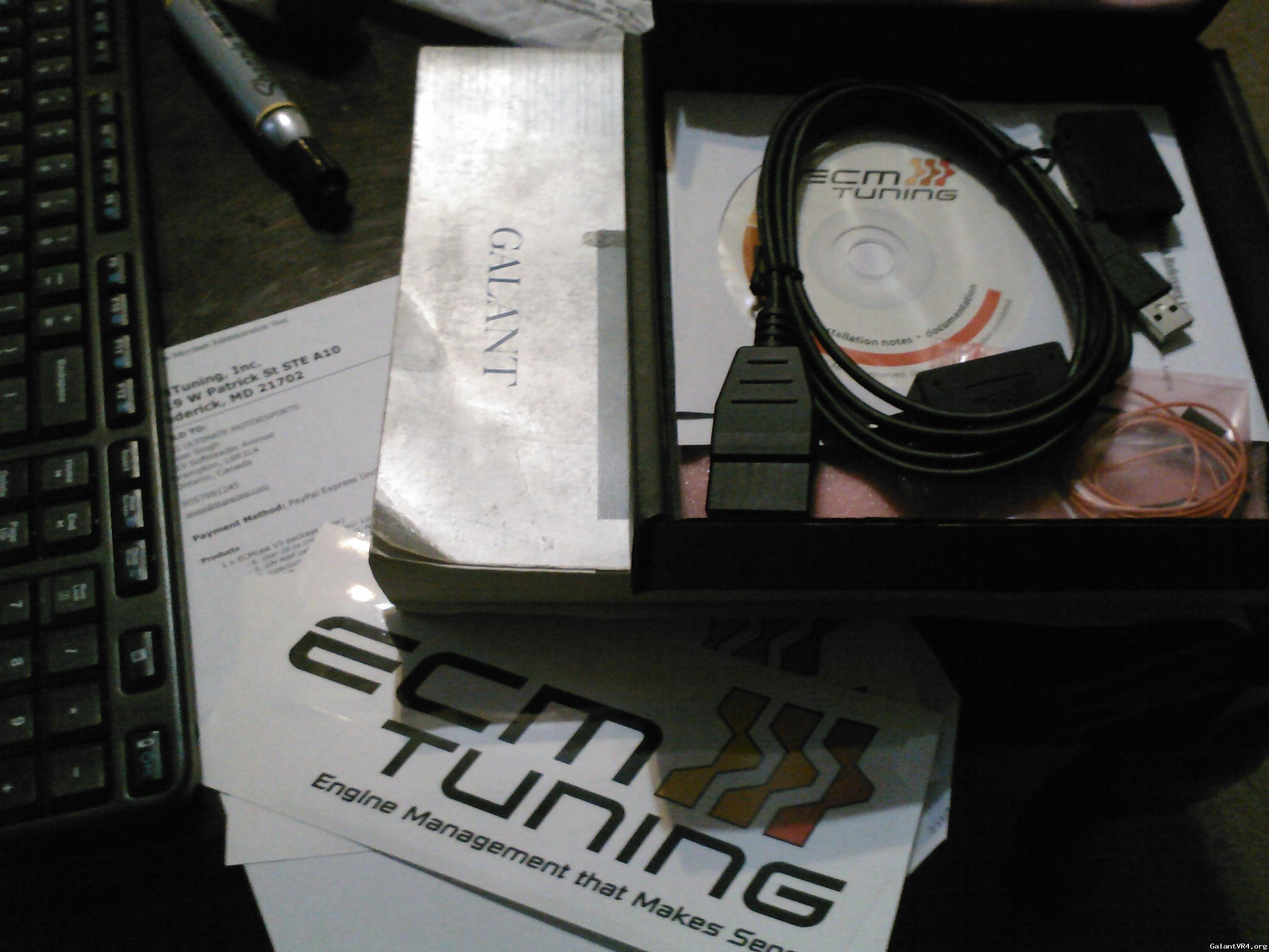

Unrelated but look what I found when I got home.
