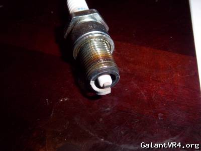

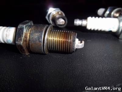

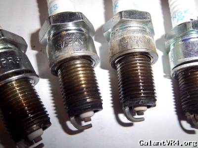

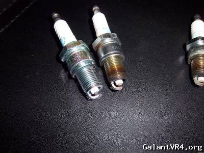

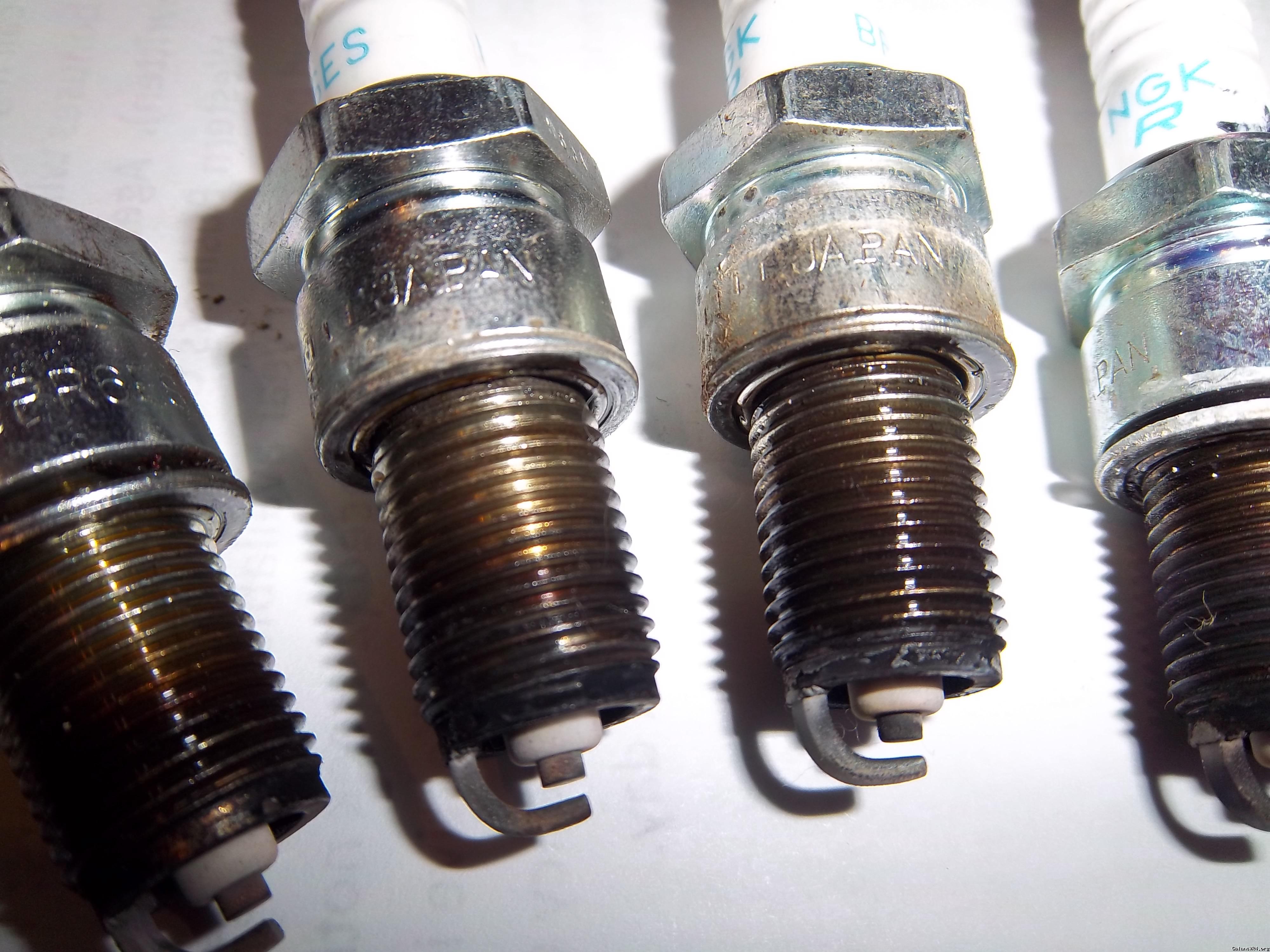

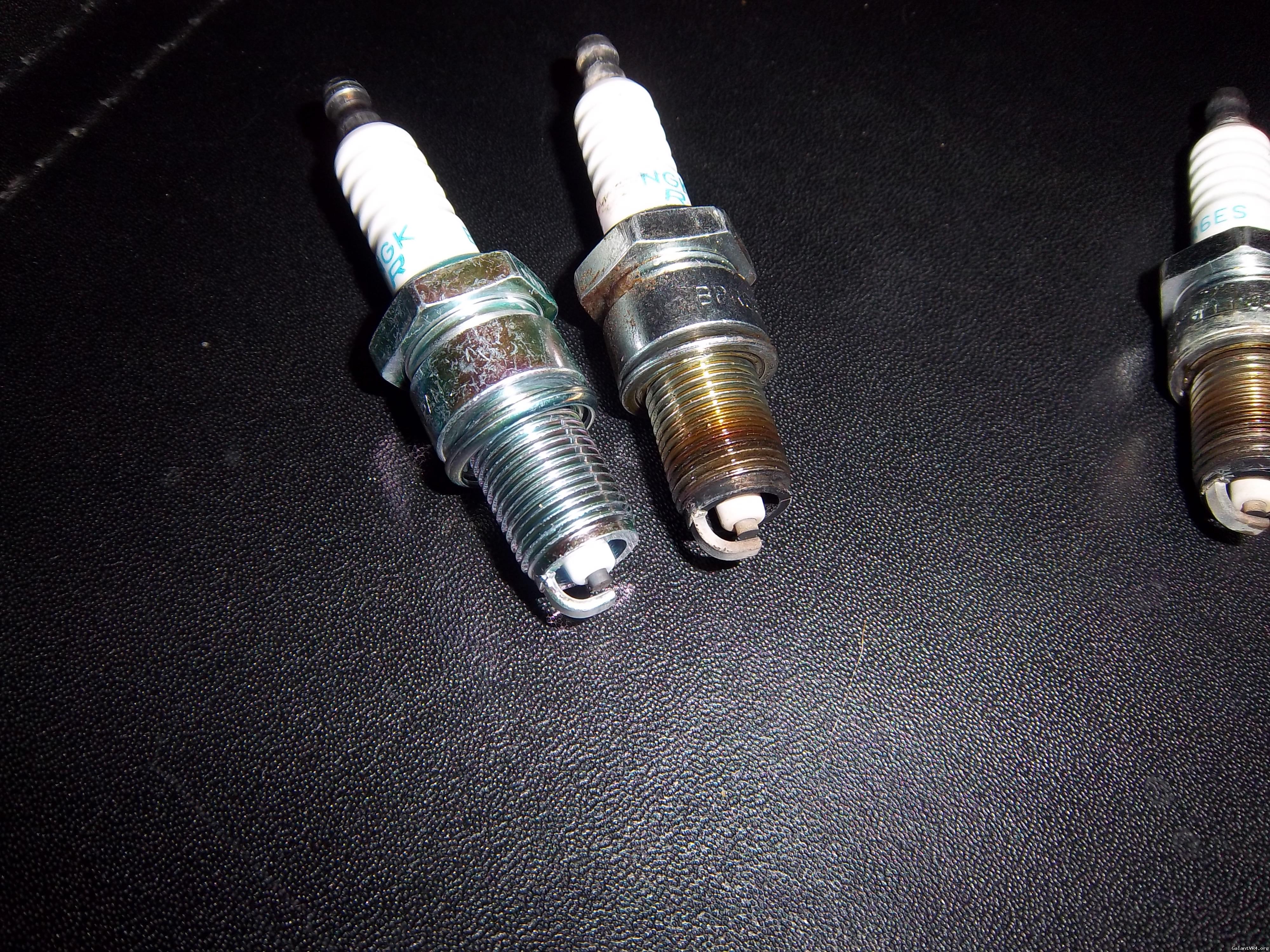

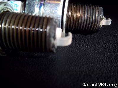

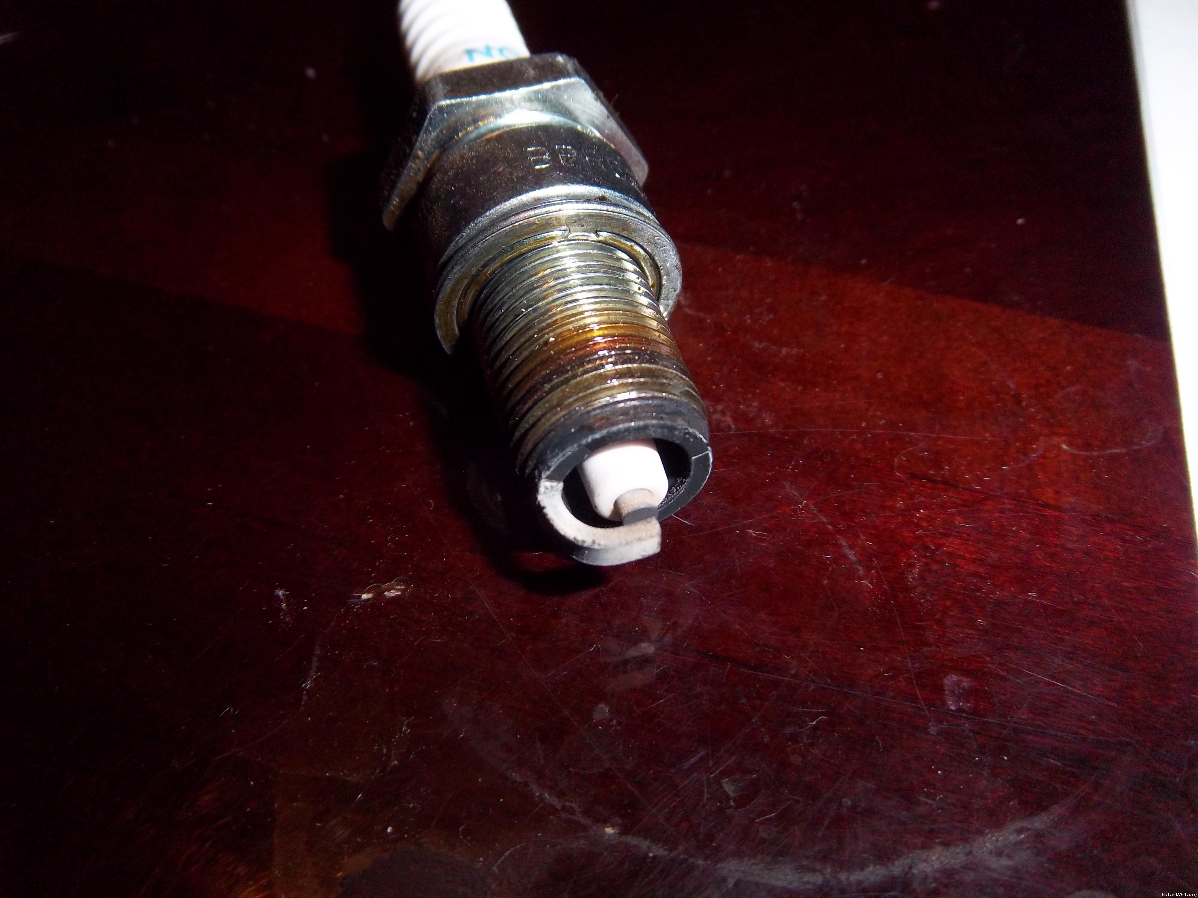

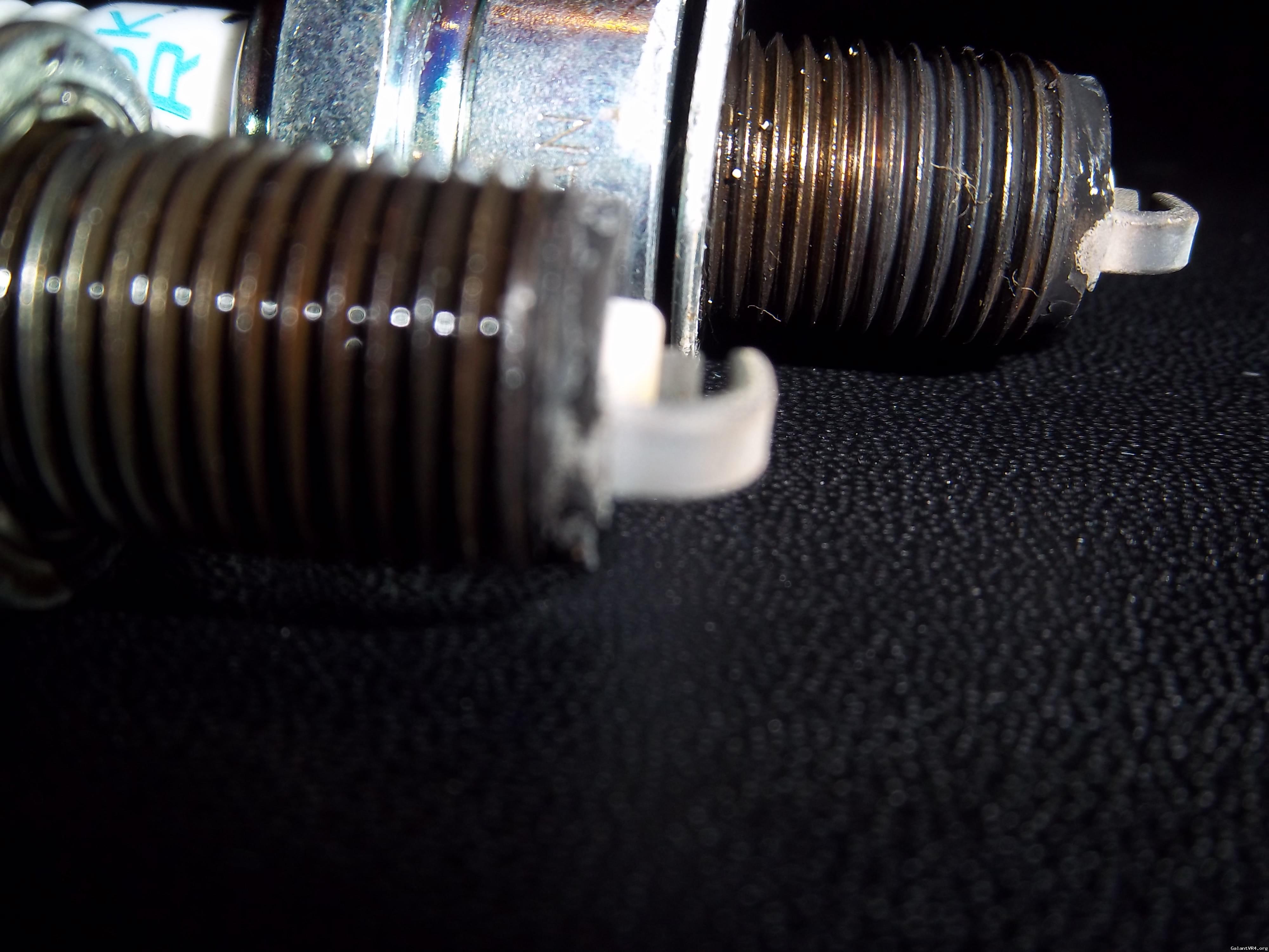

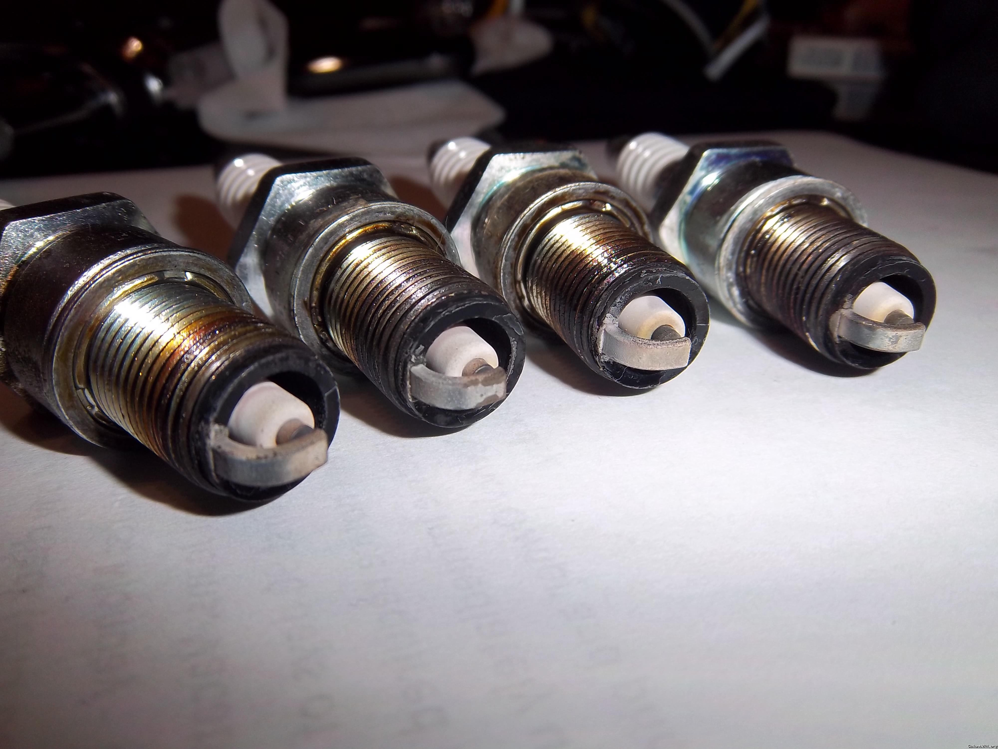

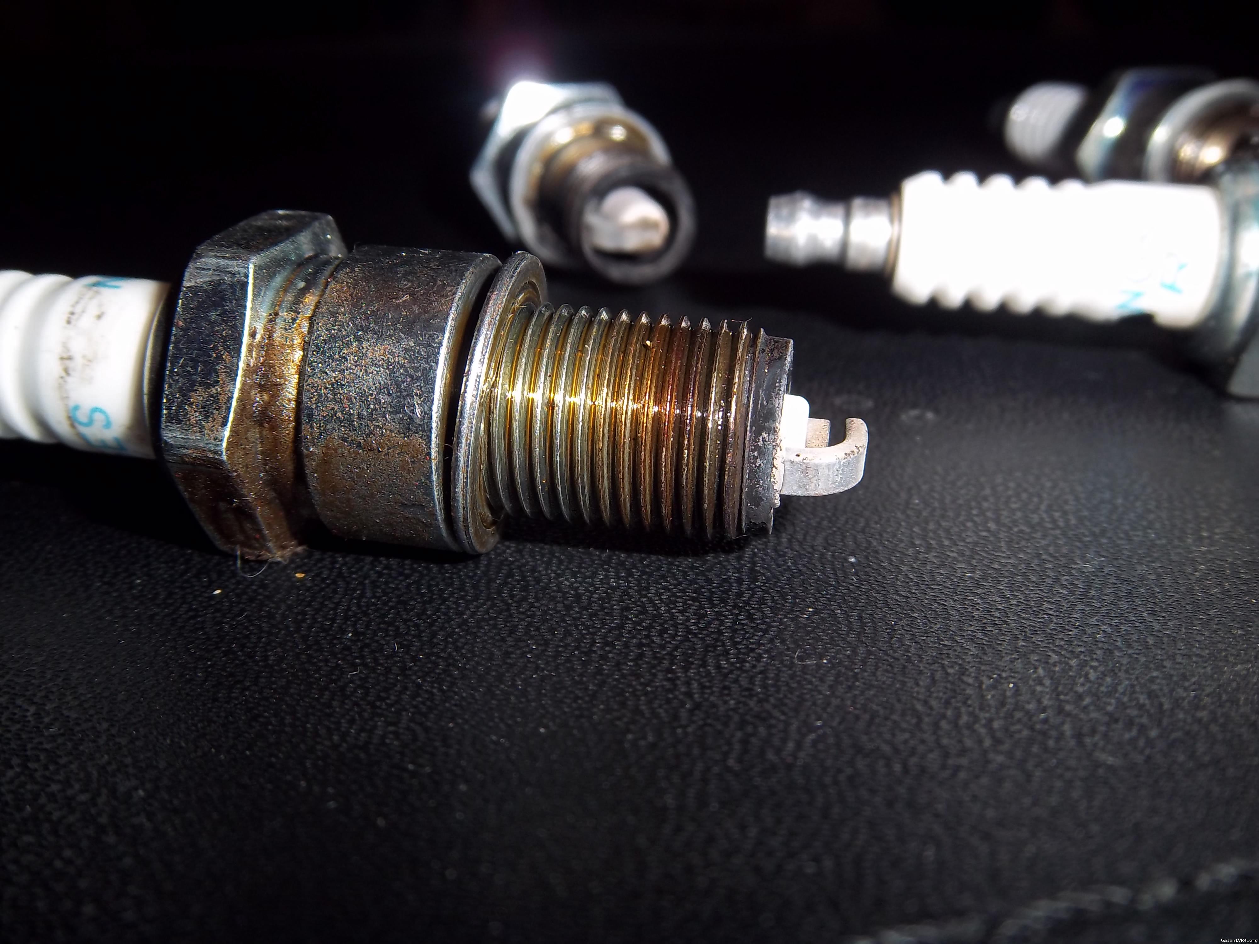

Please, please refrain from beating on the car too much, pull your spark plugs, take a picture of them and post here in this thread so we can at least determine if it actually is running lean or it's sensor/guage error.

I will try and take pictures of the spark plugs today, but I dont have a socket to take them out so it might be tomorrow.

Not quite as white as i was expecting, but definitely looks lean-ish.
