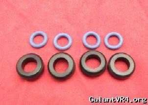

Also I have some good RC550's just need time to get them in...can I just buy some O-rings from home depot to replace the old ones on my fuel injectors. After I get the fuel filter and new injectors I will see what happens...

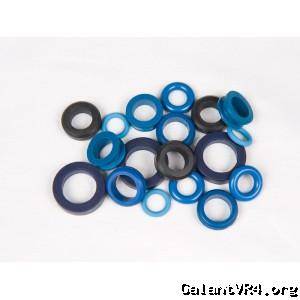

O-rings from Home Depot = a big NO.
Everything in your fuel system has be fuel resistant type rubber, likely VITON for seals.
Injector O-rings for the rail hook-in are cheap, as are the base rubber pieces that hook in at the head.
FIC's
