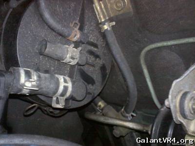

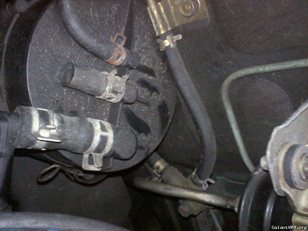

just wondering if any thing does not look normal
and is there supposed to be 4 ports a1 a e p
0r just a e p

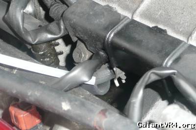

AND IN SECOND POST, SECOND PIC, IS THAT THE EGR VALVE
i just dont know what these are since there all just laying around

u have none of them hooked up
did u run lines like the taboo speed shop says?
i dont have a cat so im not worried abut smog should i try and run lines like one of the taboo speed shops diagrams

Yeti has a vacuum bracket still hooked up. its stock material. Yeti- your posts would be easier to understand if you through in some punctuation. sh*t makes my eyes cross.
Egr valve, second picture, yes. That must have a Vacuum line off of it. Find it on the diagram and make sure it goes to the correct spot.
check for cracks or leaks.
Same with all the other lines.
Have you made a vacuum tester yet?
Hook up your boost gauge, and make a vacuum tester.
You system should hold at least 10psi for a decent time before dwindeling away.

AND is this the EVAP. can?
