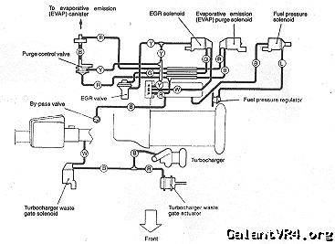

would this be the right one also if anyone else could find a bigger diagram cause i cant read this one
Launch
Aug 17, 2006
350
Texas
Yep. TONS of help, tips, and of course all the mitsu factory service manuals and CAPS(parts lookup w/ diagrams)

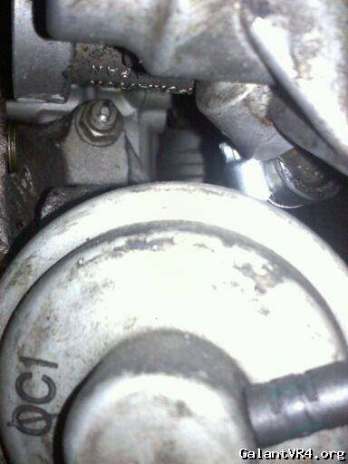

I've been having my fair share of problems too. Found a boost leak, it's crack. This explains my maxed out low fuel trims.
I could hearing hissing sound while it was idling. Located on the intake mainfold, between the TI.

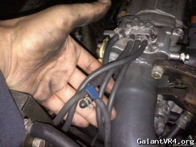

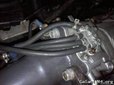

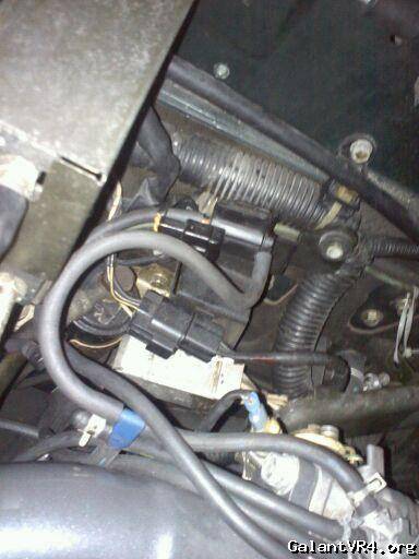

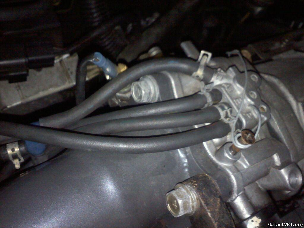

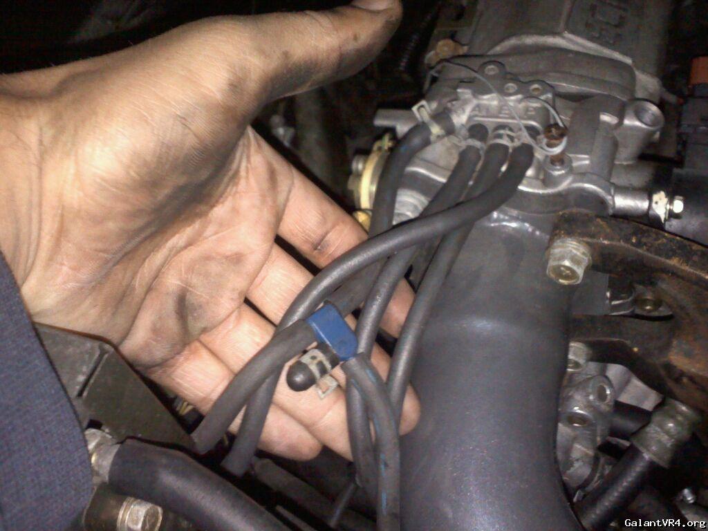

ok vacuum lines are all over the place will take some pictures
