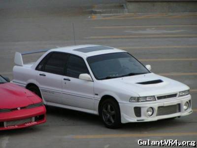

If it's supposed to be a US VR4, then it's a clone gone bad!

I'll agree with the clone gone bad comment. It definitely appears to be an AT galant that someone gave a gvr4 makeover to.

this can't be a real vr4 judging by the first couple pictures in her showcase not having vr4 side skirts and dog legs and then scrolling down shows a post by her saying......
Update.
grill, AMG center grill, VR-4 side skirt kit , JDM corner(amber difuser removed), JDM decalc and '93 headlight and Full LED Conversion(Tail, parking, brake,...)
that confirms its not a vr4 along with the other things people noticed. and also probably only reason for hideous front bumper.
possibly the Canadian version of the the galant gsx? an AWD Eagle 2000gtx ... its completely a Mitsubishi car (says Mitsubishi on all parts) only thing different is eagle badges instead of mitsu.

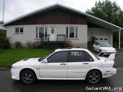

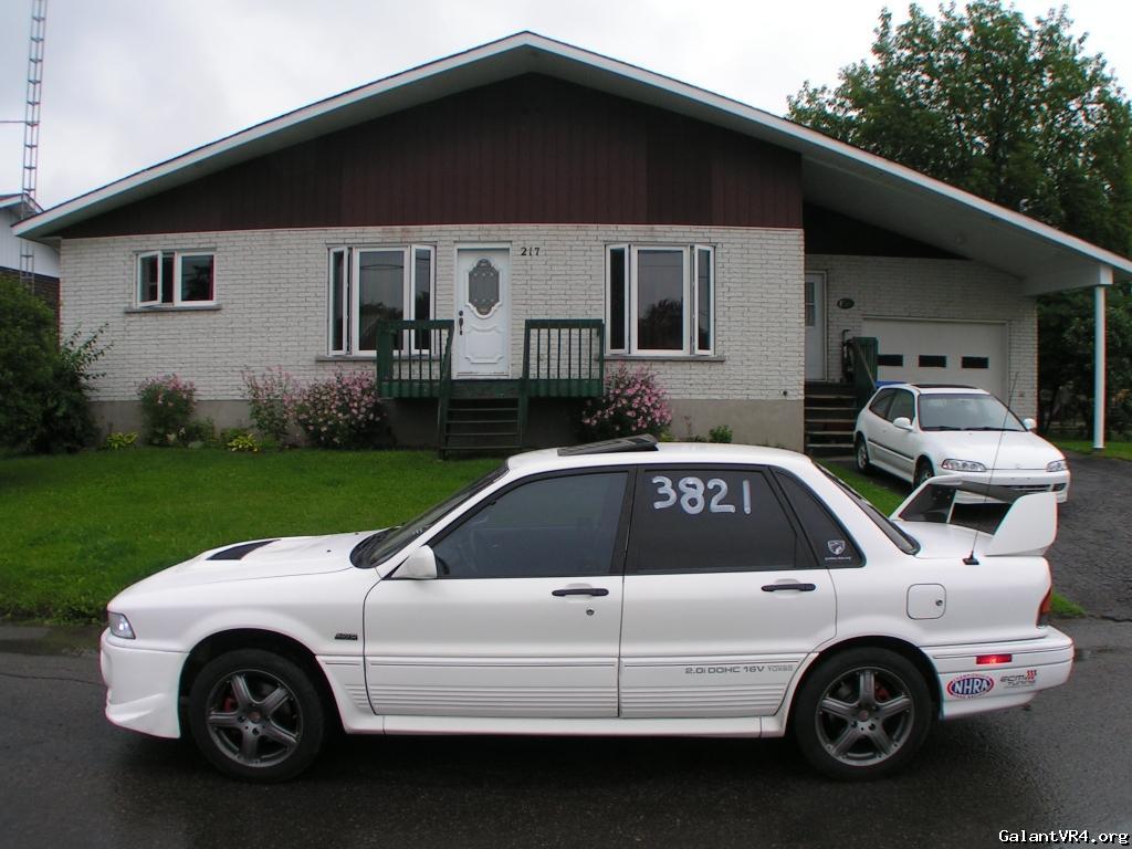

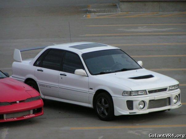

I dont know why, maybe I do not came here ofen, i was Unregistered. I have to regestred again.
It is my car.
Its a Eagle 2000GTX AWD AT NT converted to turbo (t25 + head gasket sandwitch to reduce CR and then engine replaced for a turbo engine with a evo III and i rebadge the can as an galant vr4
Here is the mod list:
'92 Eagle 2000GTX rebadger Mitsubishi Galant VR-4
