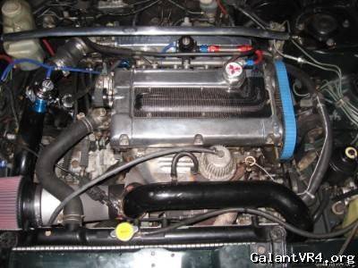

Its been awhile but here is an old pic of a hx-35 with bep housing. The wategate on the first runner, radiator was moved over for the intercooler pipes.
