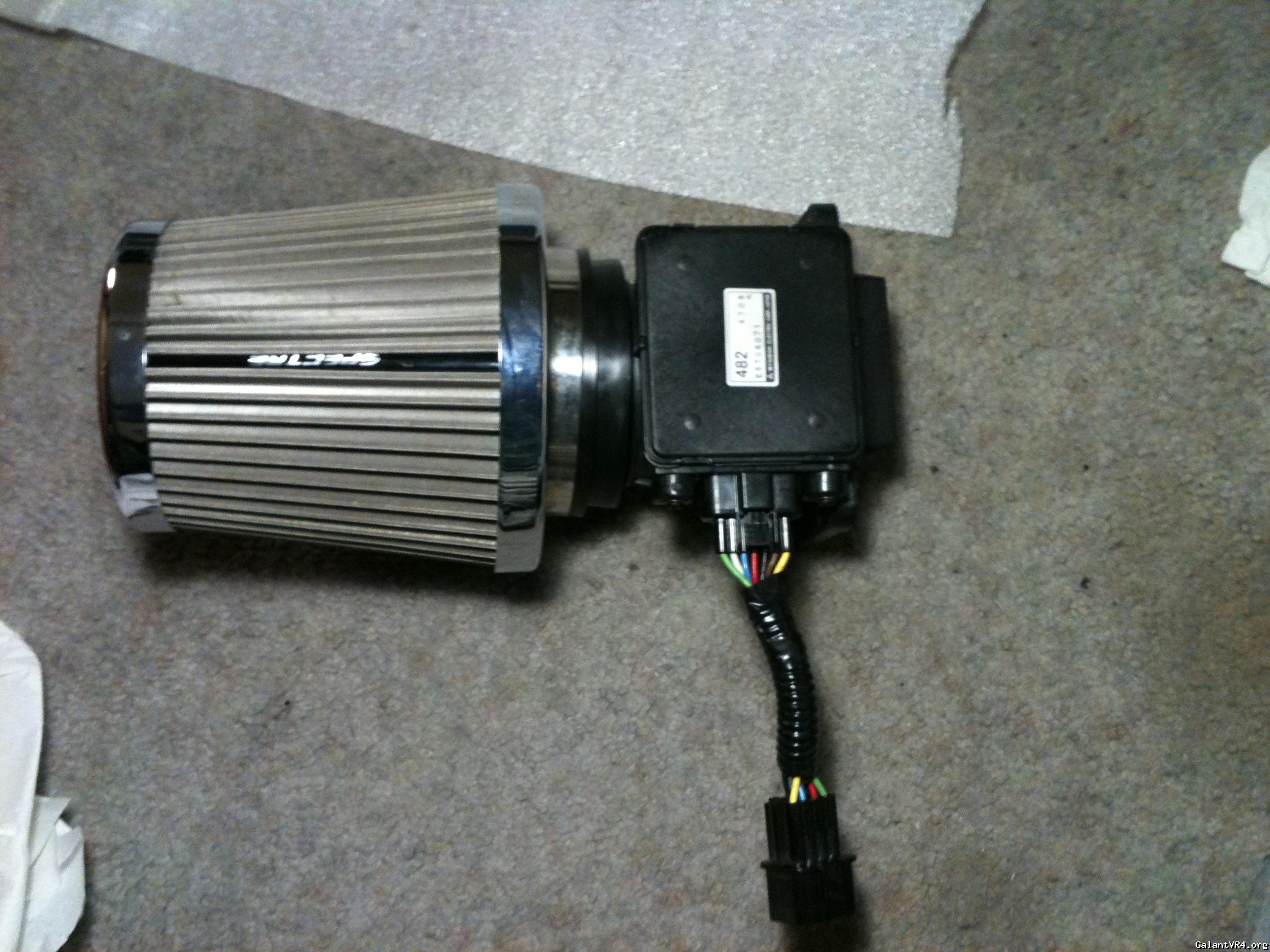

How to make evo8 maf sensor work on galant vr4 ?
Hi every one i just got evo8 maf sensor with custom harness any thing ele to make it fit on galant vr4? /ubbthreads/images/graemlins/dunno.gif /ubbthreads/images/graemlins/dunno.gif

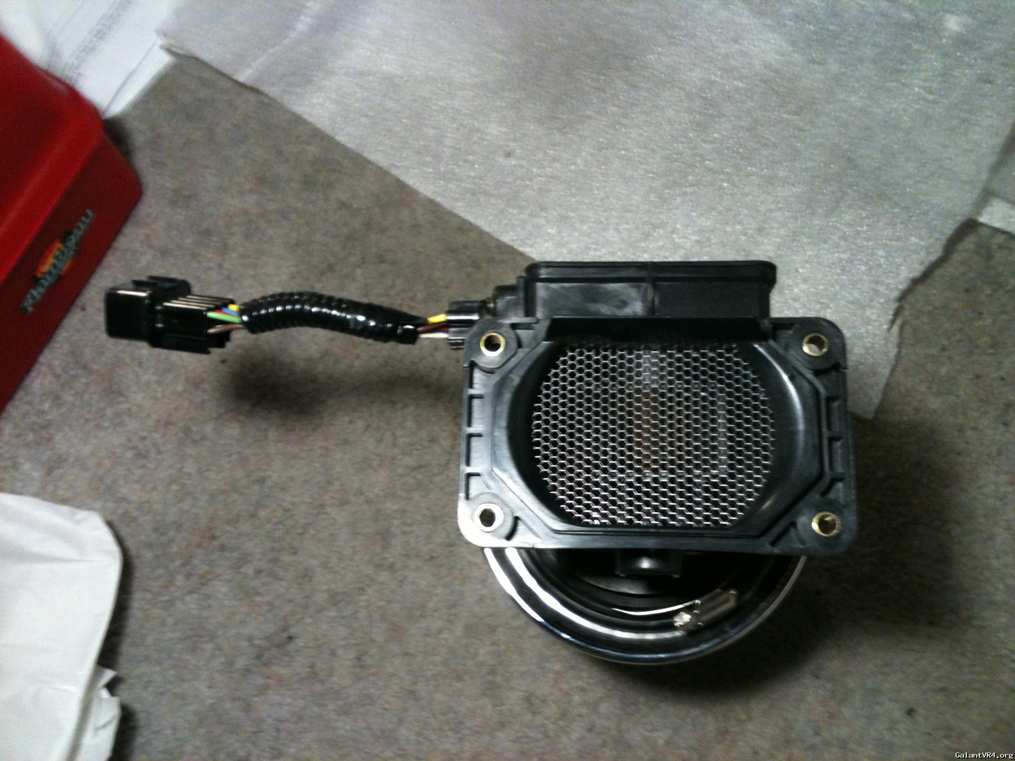

The filter goes on the other side of the maf. The side you have filter on now is the exit side that attaches to the intake pipe. You will need a maf filter adaptor for the side with the four bolt holes in order to attach a filter.

Technically, that's not the MAF out of an EVO, but very close. Just making sure you weren't taken...
