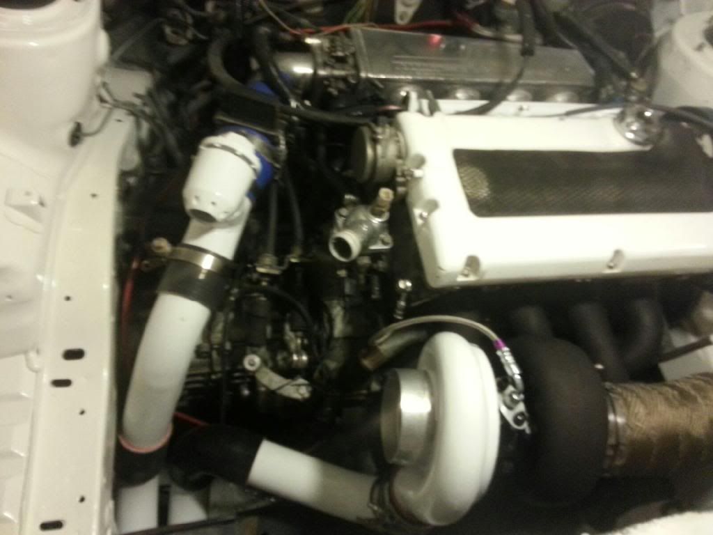

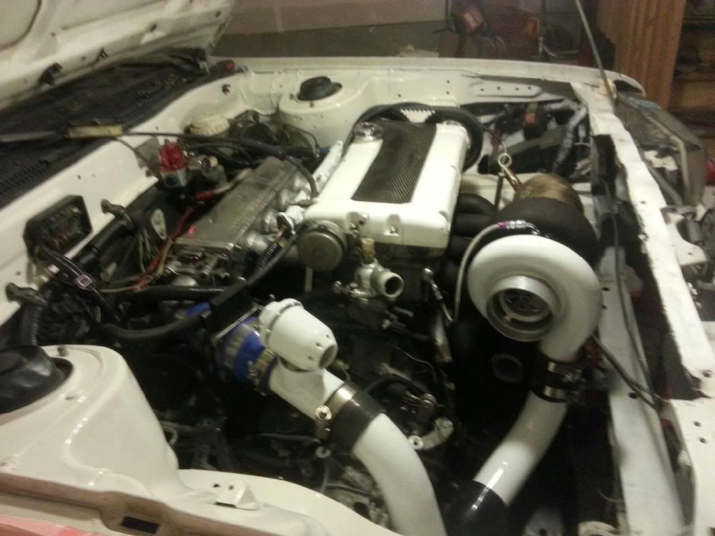

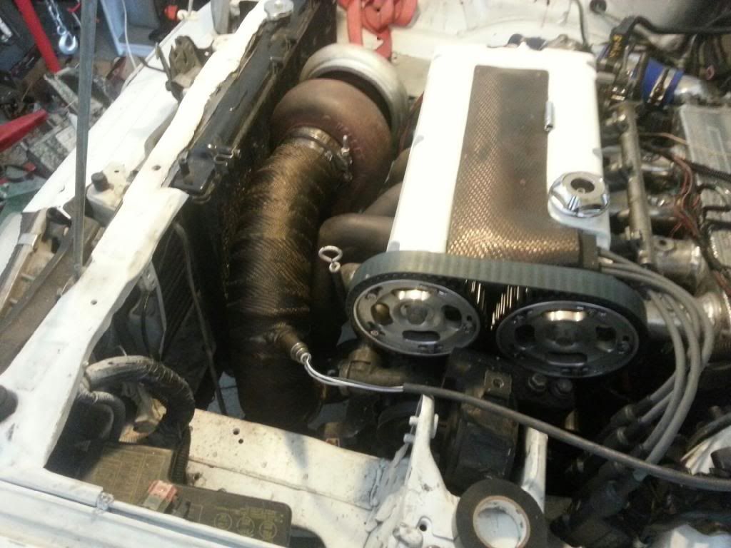

Mines getting really close to done, just some intercooler piping now.

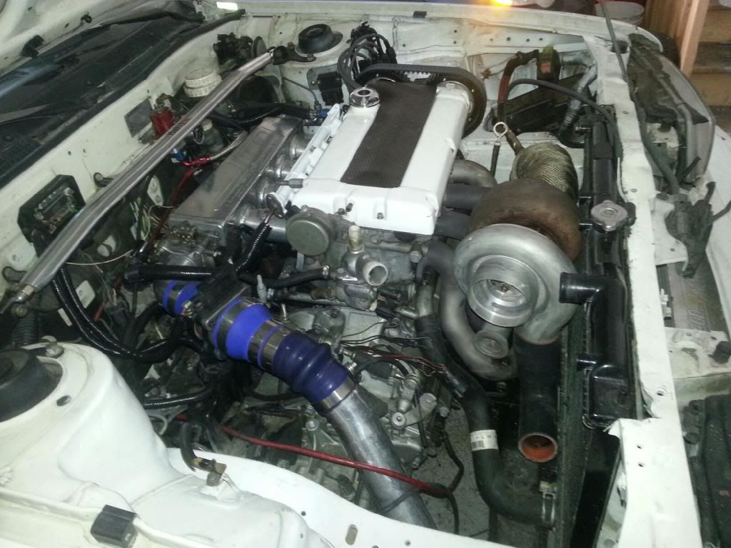

I love that you fit it in there with the stock radiator. Using pusher fans I assume?

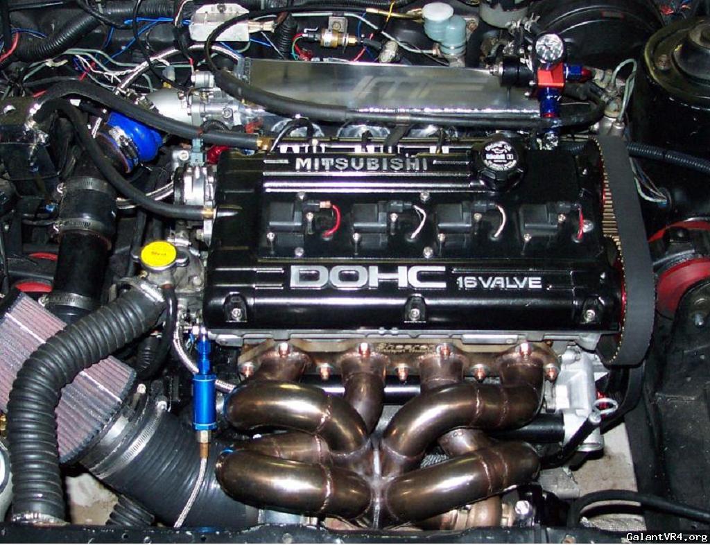

Mine is on an HKS manifold and not that big by today's standards. If I didn't have the WG where it is, I could probably run the stock radiator as well. I'm running a srirocco where the condenser used to be.

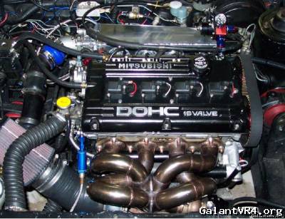

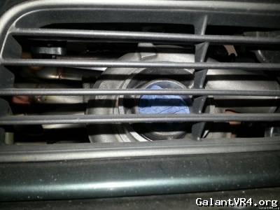

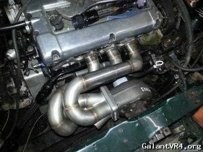

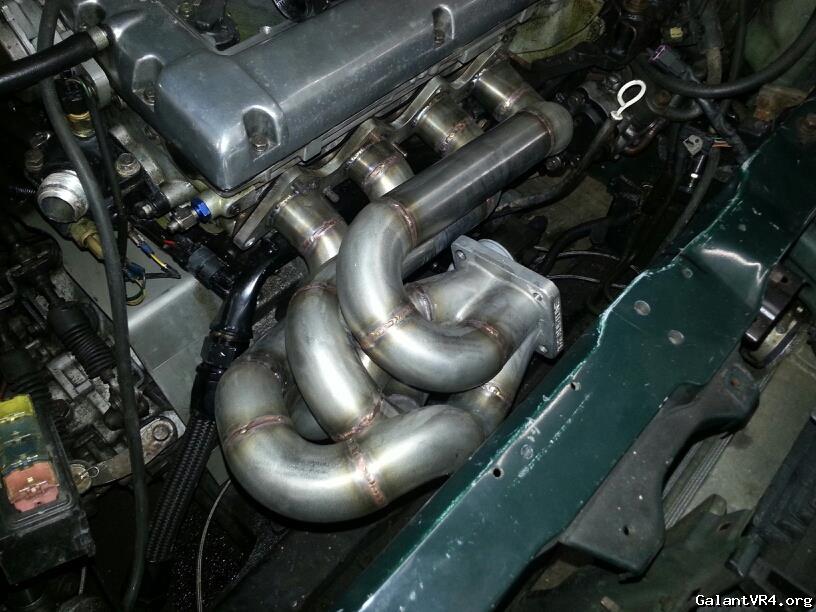

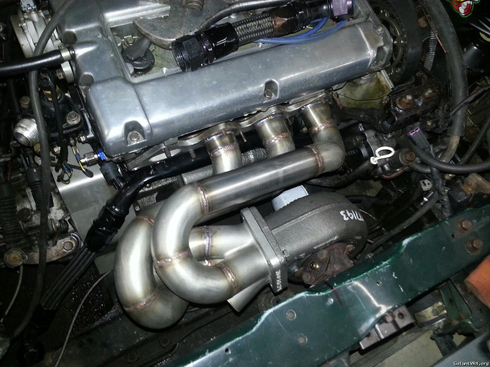

Hmmm I was going to do a top mount setup. I'm going with a front mount setup though. It seems to look similar to the setup Boz had on his car, only better laid out and a less cool head flange. I'll post up some pictures in a day or two.

It honestly won't be to bad. I'll take some pictures when I get the downpipe fabbed up, but there is actually lots of room in between the turbo and the block. The runners are all above or far enough to the passenger side that they don't interfere.

It's a Shearer manifold.
It's a afco scirocco style radiator that sits on the front frame rail.
Here's the progress I've made....intercooler piping was a little bit of a bich to get right, especially since it was just piping I had laying around.
