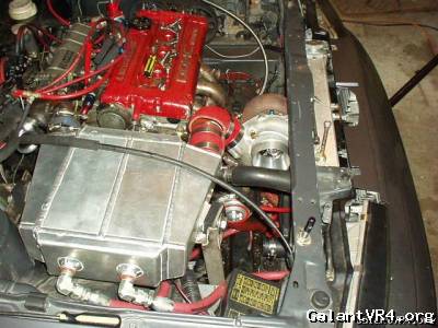

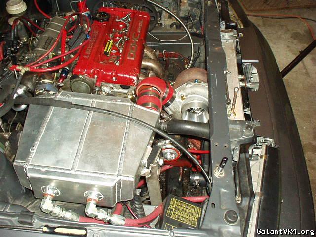

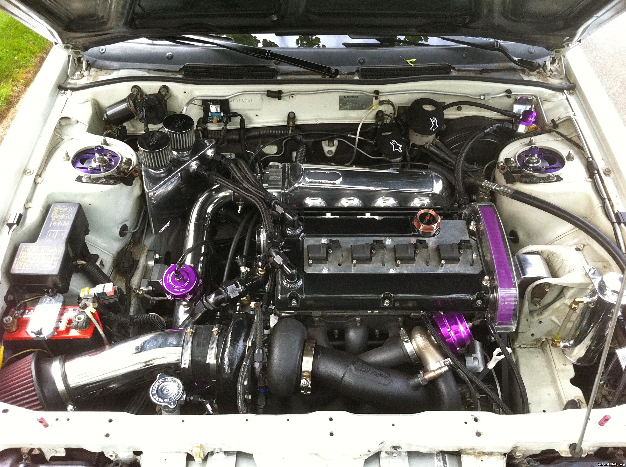

I had a topmount manifold built by JMFabrications to retain A/C, P/S, stock oil filter housing etc. Not cheap, but looks sexy and performs very well. I can fit a 35R, S300, or even a 37R with this setup. All have been test fitted while building. I have my fans relocated to the front, and run a DSM radiator tilted slightly forward.

I run a GT35 in mine. It was a tight fit between the turbo and radiator, but it fit. Having said that, I like more room for activities, so I moved the radiator forward a bit...

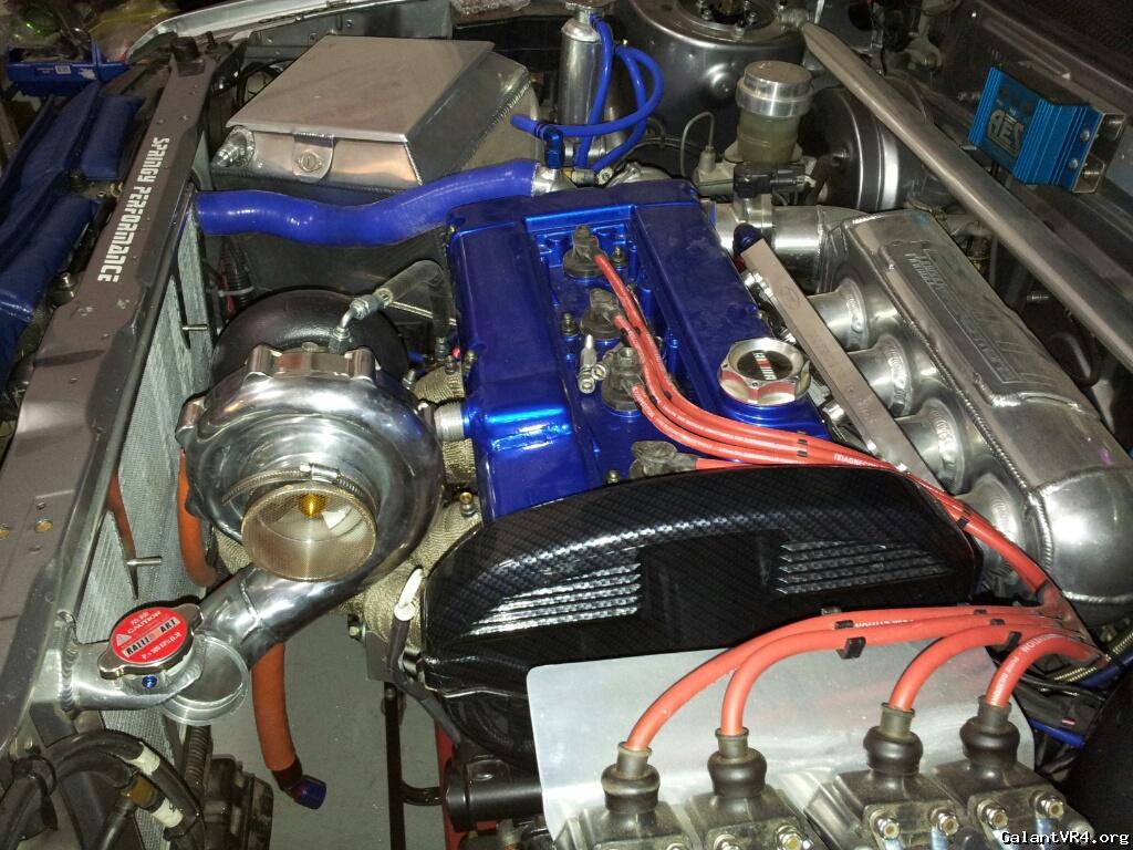

I wanted to be able to fit a 35R in my galant and have it spool it like a 30r, plus retain power steering and A/C. The manifold I had JMF build me was just a beautiful peace I did tuck the rad tho in order to gain more room. This exact manifold is for sale in the for sale section by another board member... Just saying....

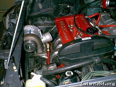

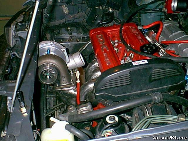

Below is a 42r reversred on a HKS manifold back in 2005- needed a smaller radiator, etc.

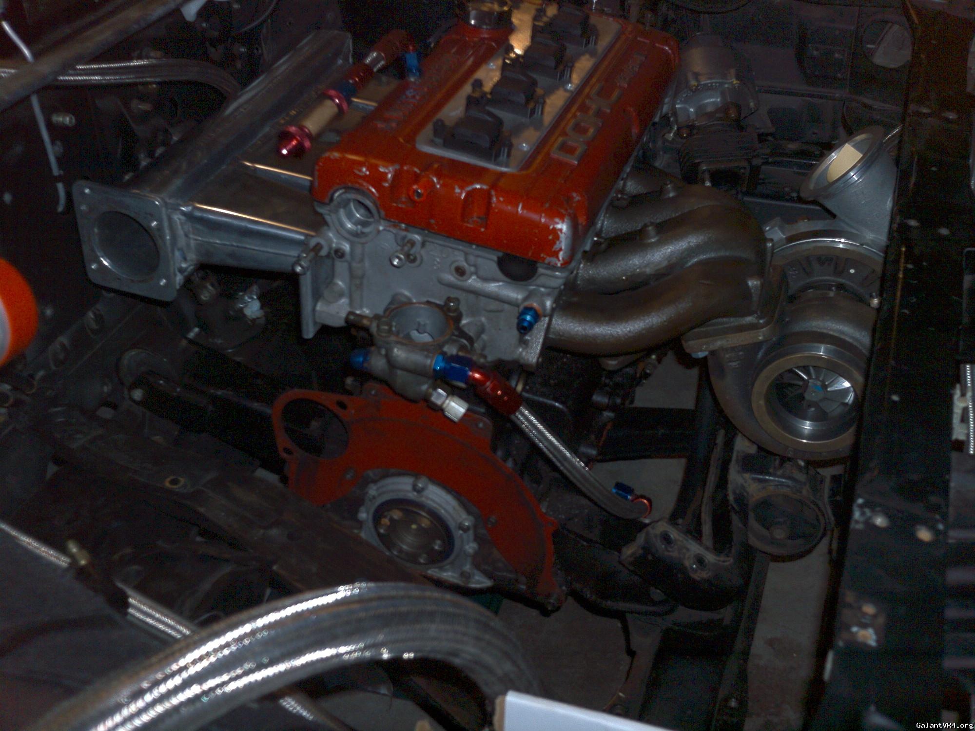

Below is a pte true T-70 back in 2001, also needed smaller radiator- has a Team Ducktape manifold to make it top mount
