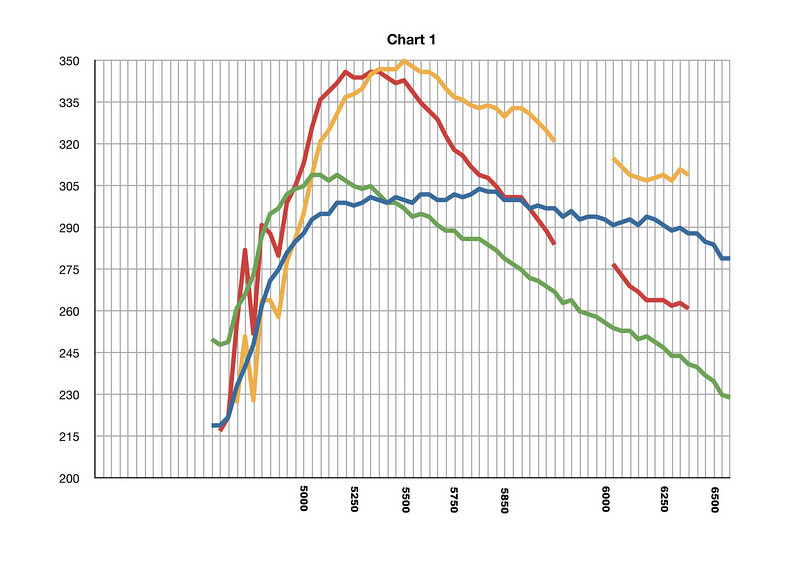

Here's what I saw for DSMlink calculated hp difference between 93 pumpgas and E85 at the dragstrip on the same night/same weather/same setup (this is data from 3rd gear of two different passes). Obviously the E85 made more power due to higher boost and more aggressive tune...trap speed went up a solid 4mph from 105 to 109. Take the absolute # values with a grain of salt. What matter is seeing the difference between runs.
The unfortunate part is if your going to push a 14b that hard, which means spiking it to around 26psi in order to get it to maybe hold 20psi by 6500rpm, this is going to eventually happen:

1) Uncleben: I'm tired of you ranting. Stop it. stop it! You never contribute anything useful and your diatribes just make me want to avert my eyes. I only got two sentences into the above post before I had resolved to tell you, yet again, to stop it!.
2) Nate: Is that a broken turbine shaft or am I missing something?

I'd've thought a decent electronic boost controller would've enabled you to have much more consistent boost than that.

Yes that's my 14B with the turbine wheel missing...snapped the shaft. An electronic boost controller does not somehow magically make a tiny turbo flow enough air to keep up with the engine. A 14B is simply too small for a 2.0L engine.
If you wanted to set an electronic boost controller to run a flat steady pressure through a run, the most you can set it to is about 19 or 20psi since that is the most boost a 14b is going to make up around 6500rpm. If you try to set the controller to 24, you will see the kind of boost and power curve I posted above (the red line) where you make large increases in midrange rpm but small gains up top. You could likely set your boost controller to over 30psi and see an insane amount of torque/midrange power but still end up making the same 310hp up top at 6500-7000rpm since the boost pressure is going to fall down to the same 19 to 20psi no matter what the wastegate and boost controller try to do.
Basically what Im saying is that using an electronic controller to tame down the midrange rpm boost spike, but it tames down your power output and track mph at the same time. The boost dropping off with rpm is a fault of the turbo being too small, not the type of boost controller. And the more boost the turbo spikes to, the faster it's going to die. /ubbthreads/images/graemlins/rofl.gif
