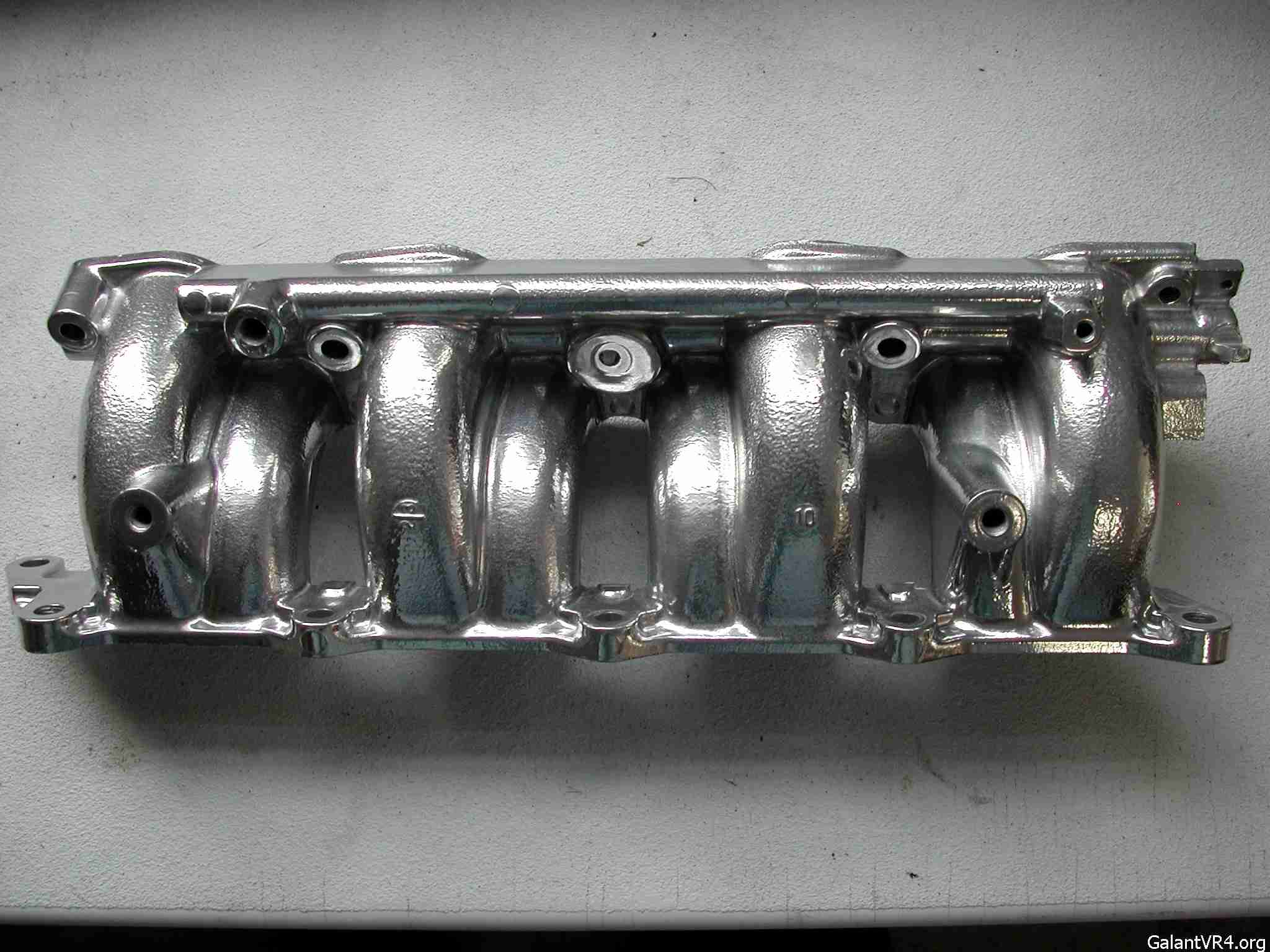

Garfield, got any data on the performance of that hybrid manny?

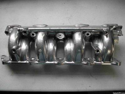

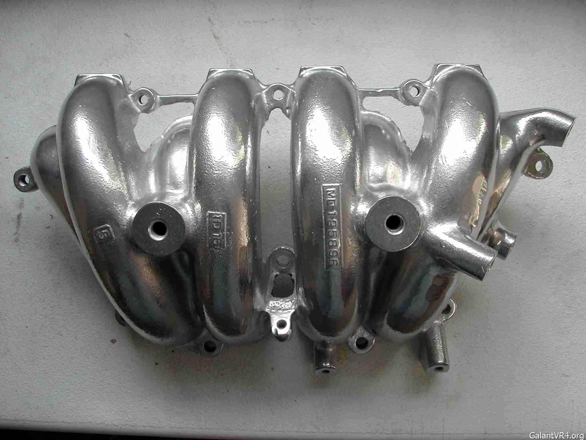

Howard, I wasn't there when this design was 1st tested over 3 years ago, but I'm told 100hp on a full race engine /ubbthreads/images/graemlins/worthy.gif Ofcourse on a street engine with mild work I don't think the gain would be that signicant. In the near future (when I finally dyno my car), I'm going to dyno with the oem mani & then with this. I have a friend with a fully built 2.4l galant that is working out the details of his 25g setup with this manifold. We're planning on going to the dyno the same time.

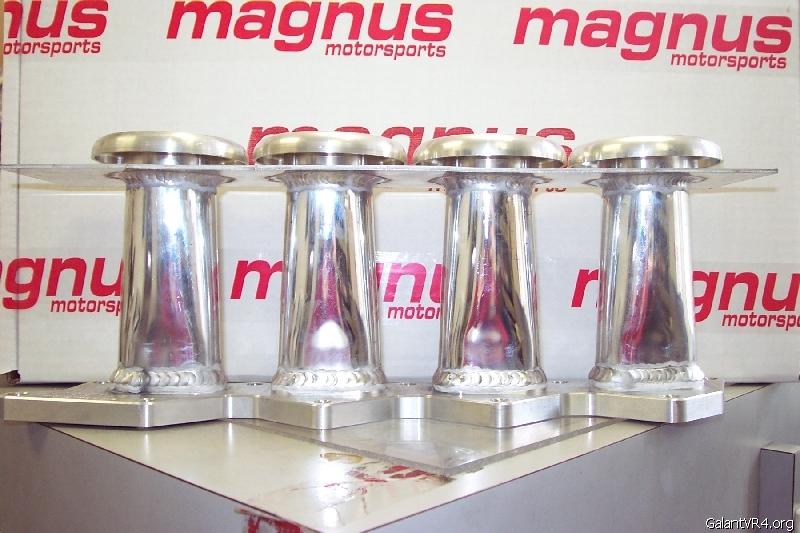

what needs to be done is intake that has longer runners of at least 6 inches with velocity stacks to even out the flow to all 4 runners and a hefty size plenum.
but with plenum size bigger than stock u will obviously loose that low end torque

What about a cyclone type manifold with slightly smaller, but same length primary runners, and bigger&shorter secondary runners? With a vtec-type controller you could control the changeover point. In theory it would give just as much bottom end with a bit more topend. Wouldn't like to think about the cost, though. /ubbthreads/images/graemlins/crazy.gif
Didn't Alex's partner from Dentsport (sorry don't remember your name /ubbthreads/images/graemlins/blush.gif ) post a pic of a Lancer Evo Group A Cyclone some time ago. That one looked the ticket, with shorter fatter runners and a bigger plenum than the VR4 cyclone.
