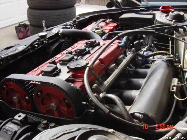

Im running the magnus manifold and it rocks. Look in the memebers ride for mods. Your gonna need new upper intercooler pipe, relocate the coil and transister pack. It bolts up to the factor TB. The car pulls harder up top and better spool up.

From personal experience and every car is different. The manifold pulls harder after 5500, that's before the FP2's. With the FP2's it pulls even harder at around the same rpm range.
I'm running a FRH manifold on my Talon, I noticed a differience in the upper RPM range, not a huge improvement over stock, but once I installed the HKS 272 Cams I noticed a huge gain in upper RPM response. If I had to do it again I would of gone with a BJ's but it really isn't a worth while mod until your pushing over 350 to the wheels, the stock manifold is good enough to run 11's with.

I put down 470 @ 28psi with the Extrude honed US intake that I have had forever.
Nate put on a Cyclone intake and dynoed his car and lost roughly 60-80 hp. His setup is pretty close to mine. He put the EVO intake back on. (The EVO intake is very simular to the US intake.)

I'm going to say cams too. The top end I picked up with a port job, Ferrea valves (oversize exhaust), and a set of 264's was nothing short of amazing. My motor was done by 7200 and with the fresh head it pulls to 8000 in first and at least 7800 in second. Then the injectors aren't enough and it starts knocking. All of that will be fixed soon though /ubbthreads/images/graemlins/devil.gif.

Good to know #1, I mean #3. However, the kick in the pants is the 'K' man's chip. As I recall, 30% increase in torque down low with a loss of 1% hp up top. Every setup is different. You've had actual real world experience, I'm going by what I read.
