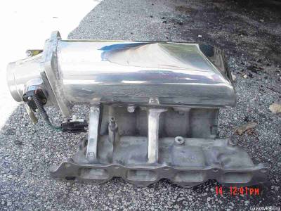

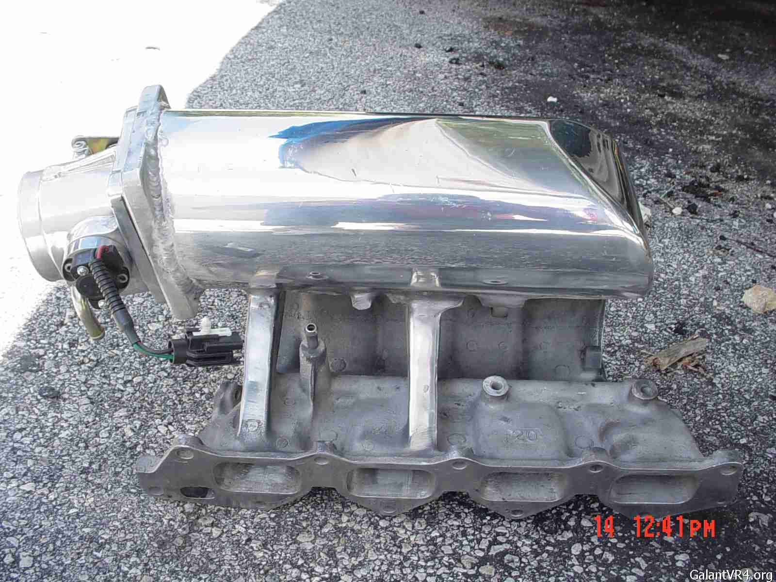

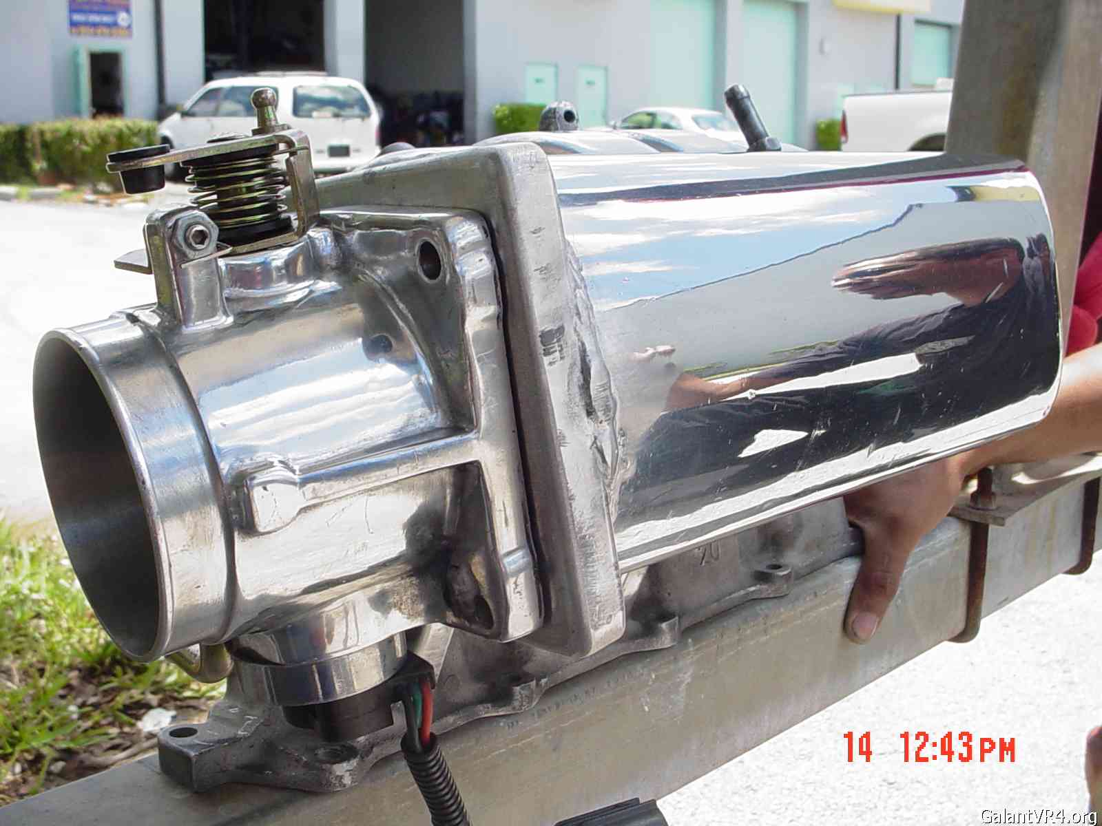

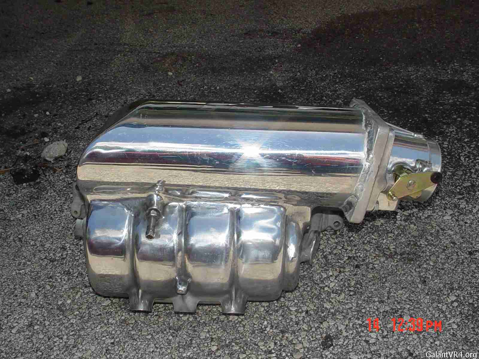

How's this for an intake mani? Plenum can vary depending on your need, also choice of stock t/body setup or Mustang 75mm. Maintain factory runners for low end torque & huge plenum for hi flow up top suckas. Who wants some more of this? Contact Steven Wright 9am-5pm 954 290 0145 or email Wrightouch Automotive & Supertuning. Tell him I sent you.

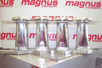

Those are velocity stacks which are at the top of every runner in a Magnus SMIM. They are a free option now, which I guess means they are standard and not options any more. Those bastards changed the pricing policy the very next day after they charged me for those! /ubbthreads/images/graemlins/mad.gif Oh Well, I still like it and would recommend it to anyone else.
I thought the whole point of a SMIM was to get rid of the OEM Runners...Isn't that the most restrictive part of an OEM Intake Manifold? Just wondering...
Not with a nice port job. Aslo keep in mind that the short runners only make the additional power up in honda vtec rpm range. The factory runners will keep you happy all the way through the power band.
