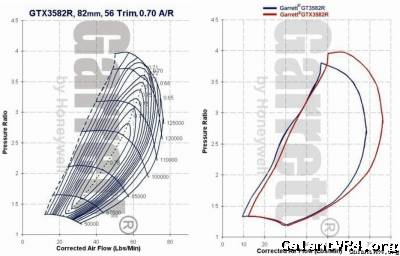

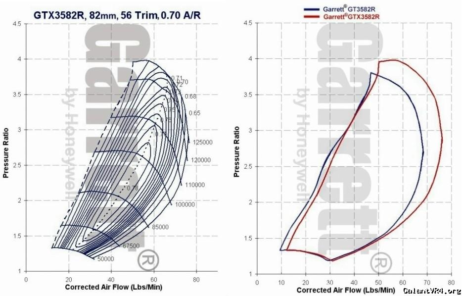

Yeah on that Dyno at TX2k it didn't have enough load and wasn't letting the car creep to 16 pounds like it did on the street and D3's Dyno. It only peaked at 10 pounds on that Dyno. I was pissed. And I can't turn the boost up because I'm already out of pump. So I'll be most likely upgrading wastgates and routing the wg dump tube back in the down pipe to help solve the creep issue, then go ahead and do the dual 255's and 2150's.
11,993
Not enough load? Looks like it worked for everybody else?
Running the wastegate dump tube into the downpipe won't alleviate a boost creep issue. You're trying to run super low boost on a turbo that needs to be ran above 20psi at a minimum anyway. Why don't you just do the pump and injectors now? That will allow you to run higher boost and then you won't need to spend money on moar wastegates.
jnava
Apr 18, 2008
2,083
Arlington, Tx
Under the circumstances, you need to use that turbo under operating range...I assume these compressor wheels are smaller than the HTA units. I have the 3582r and its efficiency is 2.5 or 36lbs. You need moar boost.
