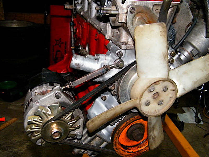

What if we use something like this tensioner instead? Seems more stable. Anyone fabbed up something similar?

That tensioner just doesn't seem as stable to me for some reason. I wouldn't do it, I don't know why but I just don't like the way it looks. Don't ask, maybe just personal preference.

Well it uses locking similar to your shifter cable and most of the force will be on the bottom mount. My thinking anyway.

Yea, I never said it was bad, just my preference. I know it would work.
Here's a question: once installed how much of a bitch is it to hold one nut and tighen the other? It's kinda tight in the engine bay, I'm wondering how easy it would be to have both hands and wrenches in there. Just a thought. Looks good on the stand, but in the car with power steering, I think it could be tight.

A lot of guys on DMSlink forums have been doing this for ahwile. It works much better and is cheaper if an alt needs to be replaced.
As for the new tensioner if built correctly it will be better than the stock part. If you build it with one side threaded normal and one with a reverse thread it should be a simple twist to add or subtract tension. Then you just have to snug the retainer buts to keep everything tight. My Jay Raing kit is just like that and super easy to use.

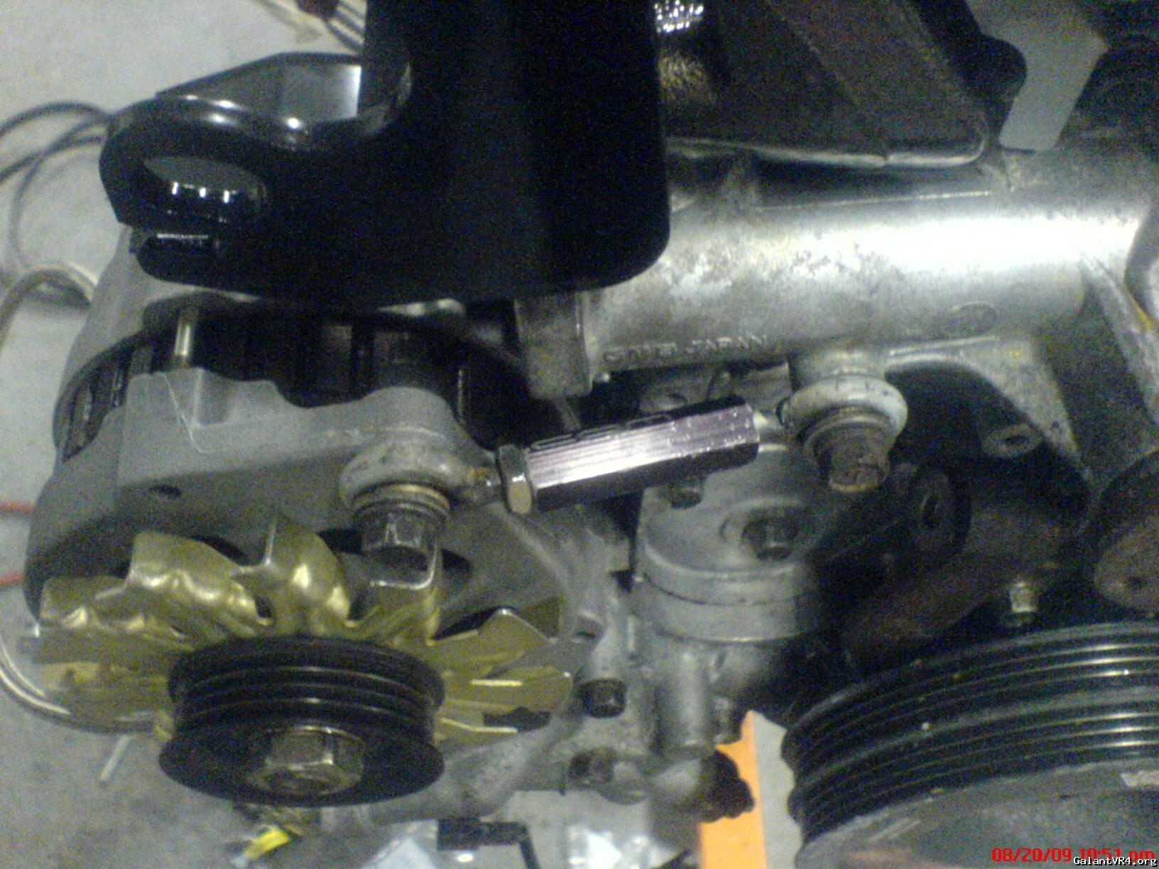

I'll get some pics of my setup. I shortened and modded a Jay Racing adjuster for my Saturn Alt swap. I'll be honest though, while it does look nicer than the flipped stock mount, damn is it a PITA to adjust. It's gotta be so short that the jamb-nut is directly behind the P/S belt. I had to make my own "line wrench" so it would clear the water pump outlet. I have some pics on my work computer, I'll add them shortly.
About the grinding part, I took a decent amount off the block, but I still had to take the ribs flush on the alternator. If you do it careful enough though, you almost can't tell that they were there, so you could probably return it with some grease and oil on it for a core...

Here are a couple phone pics. Sorry for the quality...
Only one is working right now... I'll see what I can do for the 2 others.
