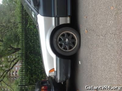

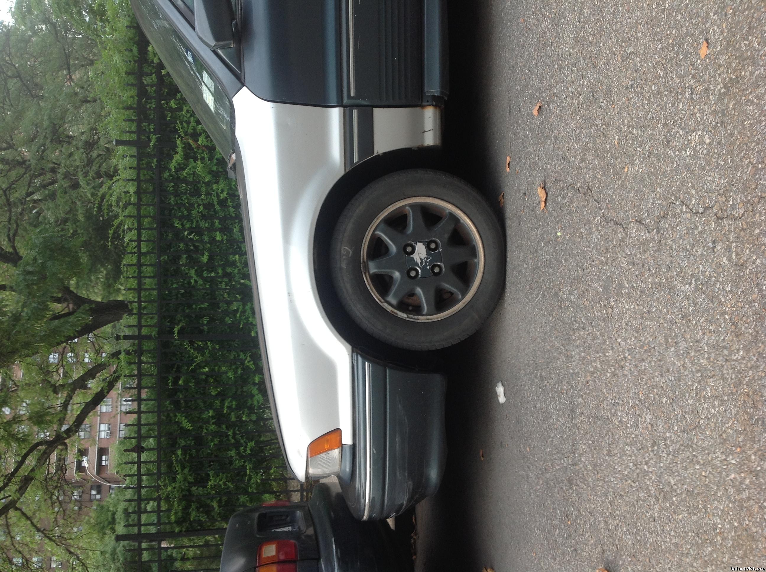

I have owned this Galant VR-4 for a least ten years.. Has been sitting at least six years and need help getting it going or getting rid of it.. No start / No power steering / No rear steer / No Brakes
