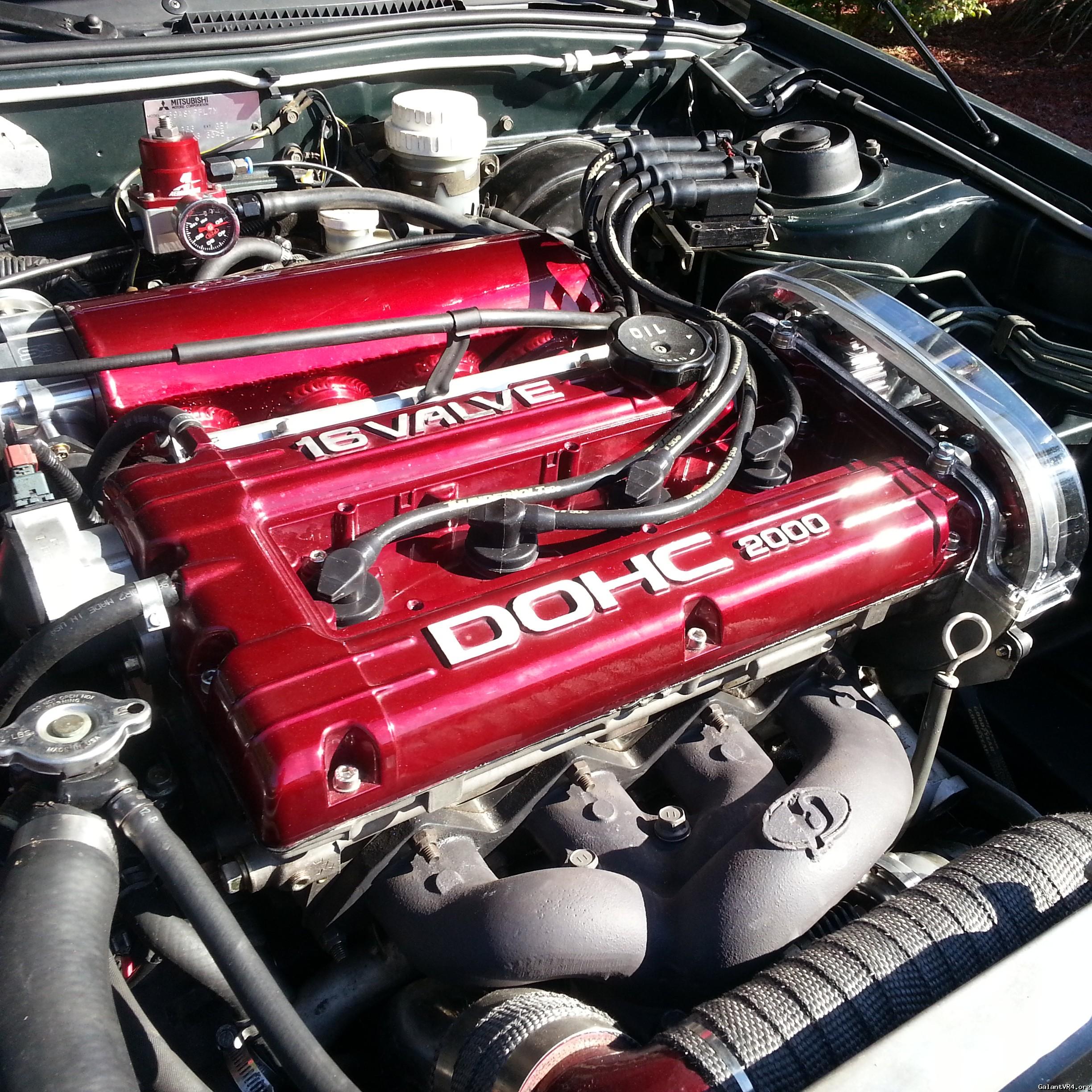

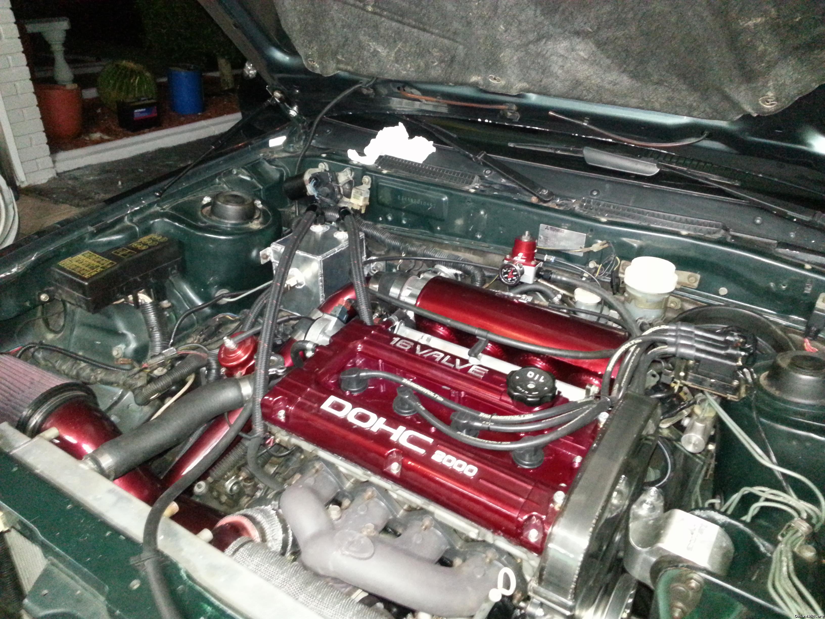

Here are some photos of what the car looks like now along with a current mod list.
Mods:
Eagle Rods with JE Pistons all clevit bearings. Fully balanced assembly with balance shafts eliminated
Ported 1G head with Comp Cams degreed with Fidanza Cam Gears, Stainless valves, Brian Crower Springs and Titanium Retainers. Mitsubishi Metal Head gasket with ARP studs.
ETS Intercooler, VENOM intake manifold, Self made -10 AN Catch Can, Tial Blow off valve and a S90 74mm Throttle body and a 4 Inch intake pipe into the fender.
AEM Series 2, AEM gauges, Kenn Bell Boost a Spark, Taylor Wires.
FP3065 Turbo, FP Manifold, Tial Wastegate Custom turbo back 3 inch stainless exhaust.
Clutch Masters Twin Disc (FX600), 17x7 Rims, Hankook Ventus tires, 4 Bolt Swap with 5 lug conversion
AMG Front and Rear bumpers, AMG Front Grill, AMG Steering wheel (not installed yet)
Dual Intake 255 LPH pumps, Aeromotive FPR and Fuel Filter, -8 Feed with -6 Return, AEM Rail

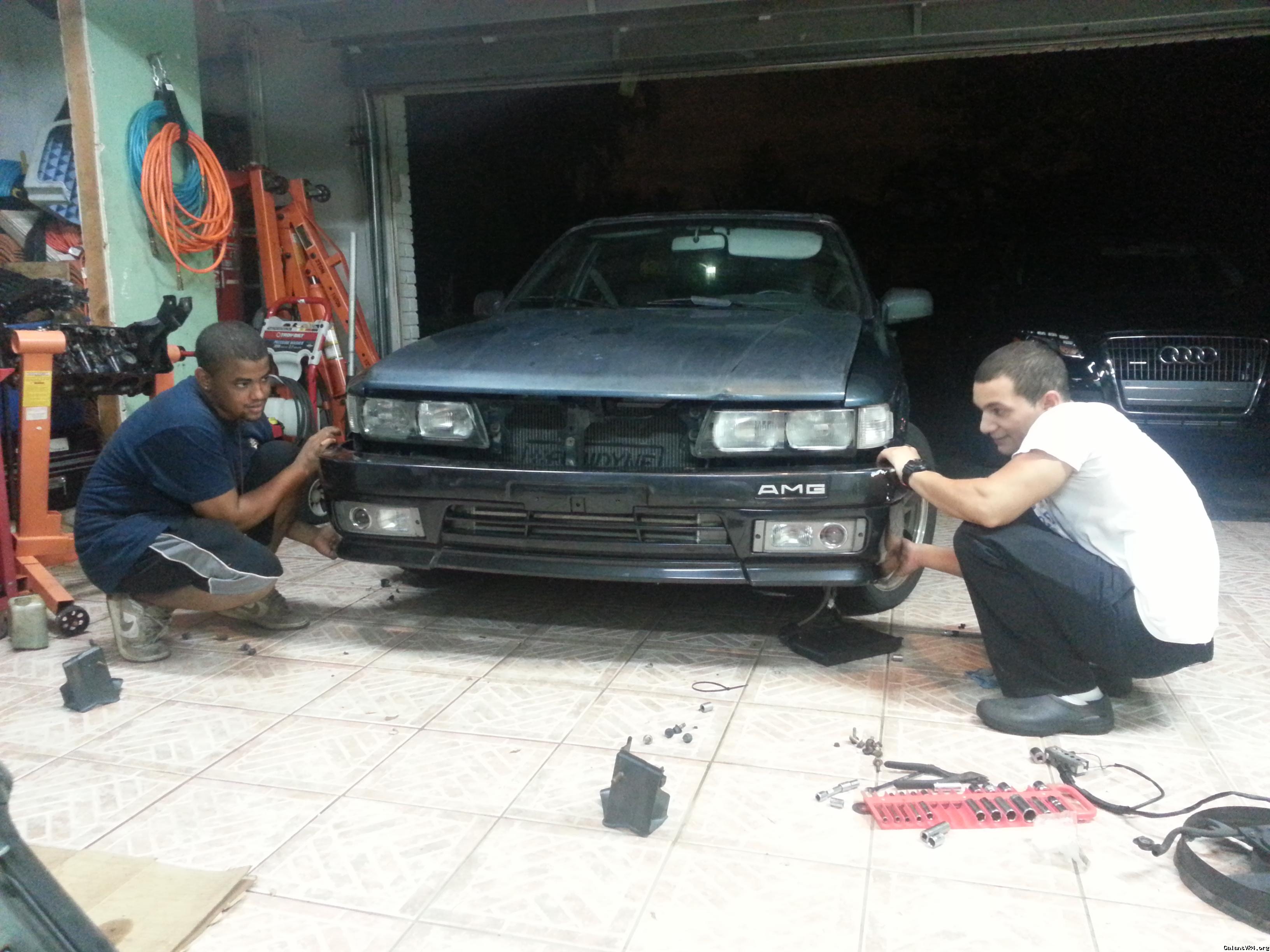

Current pictures.
