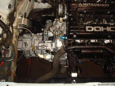

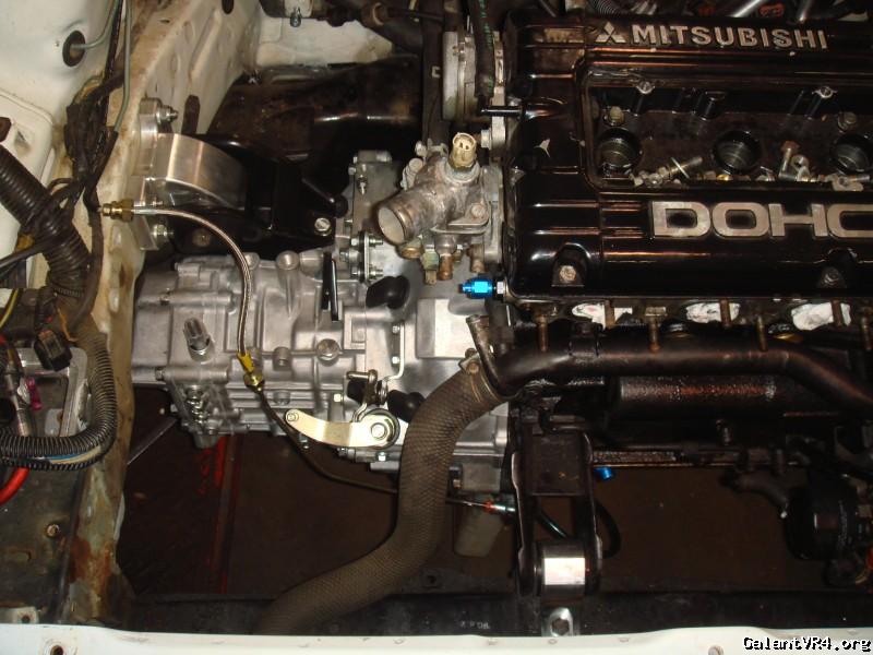

i had it happen too! go to far and you may wear a hole in something and then not have a good core. off subject i know but where did you get the aluminum mounts?!
