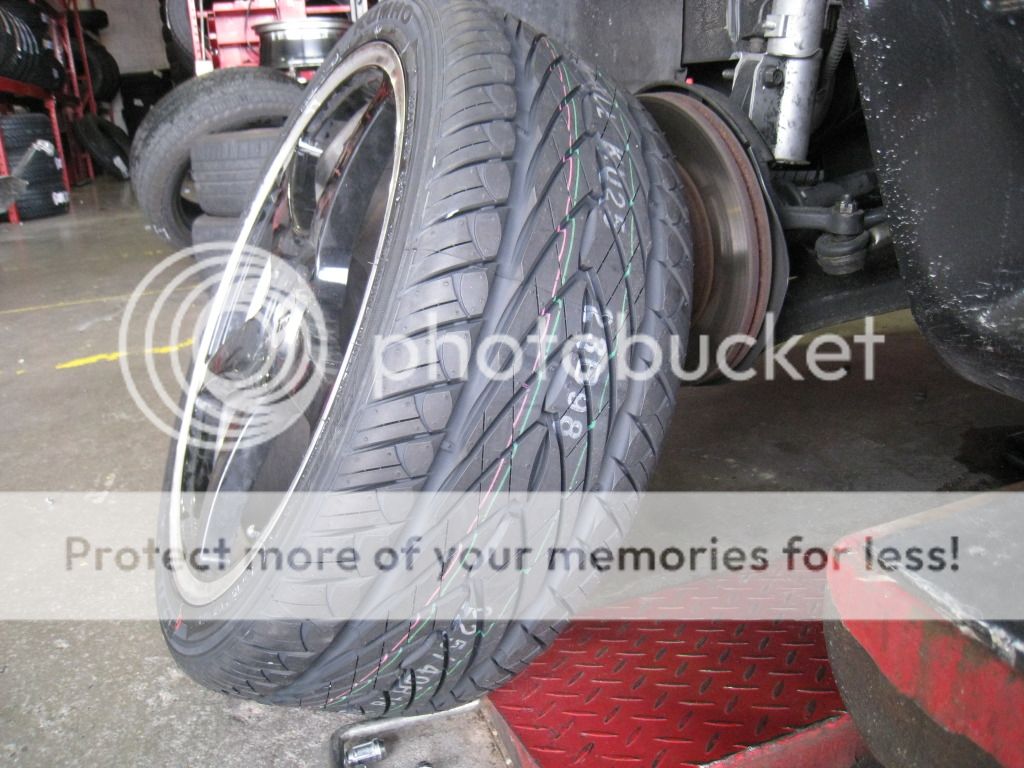

Last but not least, new tires. =) next is engine rebuild along with a few other odds and ends before the shootout.
