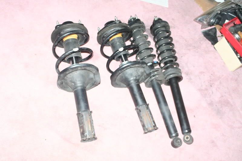

I had a 1g dsm friend ask me the same thing as he had acquired a set of Evo X stockers.
Here's a pic of them, now I know for sure those rear springs are definitely much taller than the Evo 8s I have on my car. Let's see what the Veterans say. My friend said the rear springs are within a inch of the same height as his stock springs, to me that would mean there wouldn't be any difference in height then, correct?
I had someone send me some measurements & the Evo X rears were ~2" taller than the Evo 8-9. If memory serves me right, the fronts were ~ the same. I can't gurantee these measurements though as I didn't measure the evo X's myself. However looking @ the X, you can see the car has a higher stance.
