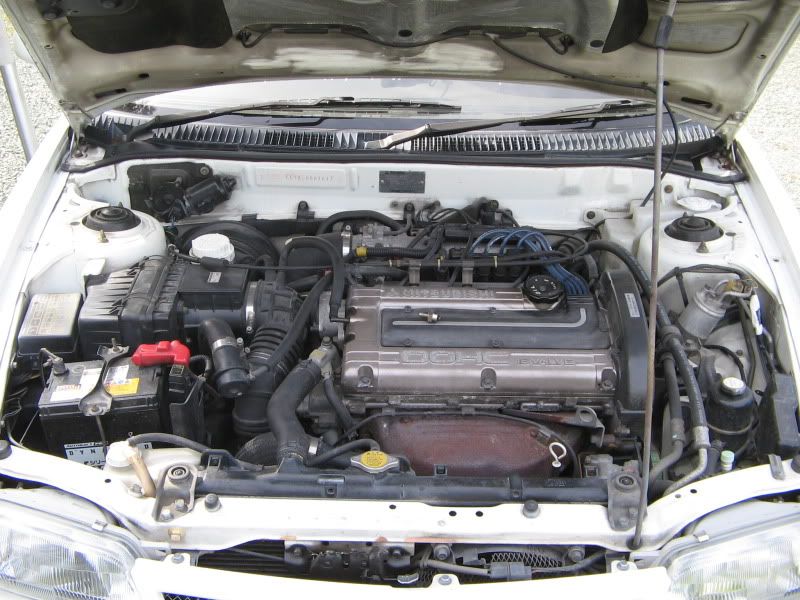

She is stock as far as I know,I just did a full service and also had to replace the "ISC"(due to a no idle situation when hot).
What happens is when first started in the AM,especially if its cold outside,the engine barely fires up(feels as if only running on two cylinders),is rough,shaking and stalls.On the couple of really cold days so far the year I had to start it 3 times.On the second or third attempt it runs fine for the rest of the day until the next AM.
