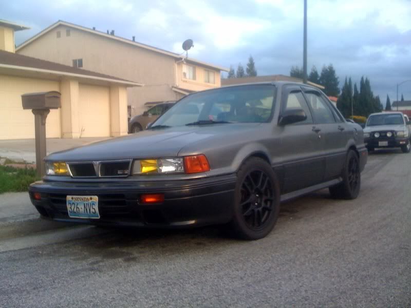

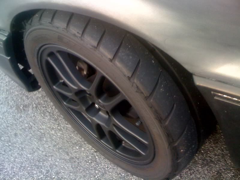

What did you use to camber it? looking to drop it abit more. maybe gonna cut a coil or 2 on the hnr springs.
here is what happened today when i drove it to the meet.
better pics with it.

/ubbthreads/images/graemlins/banghead.gif That SUCKS about your tires! Time for some camber! And don't touch the height it looks perfect the way it is. If you want the more slammed look like a Honda/VW you need to go to a 16" rim. You can still keep the width but just not all that height.
Car is the inverted color of Garfields and mine and I think it looks awesome. The Enkies should definitely stay black.
