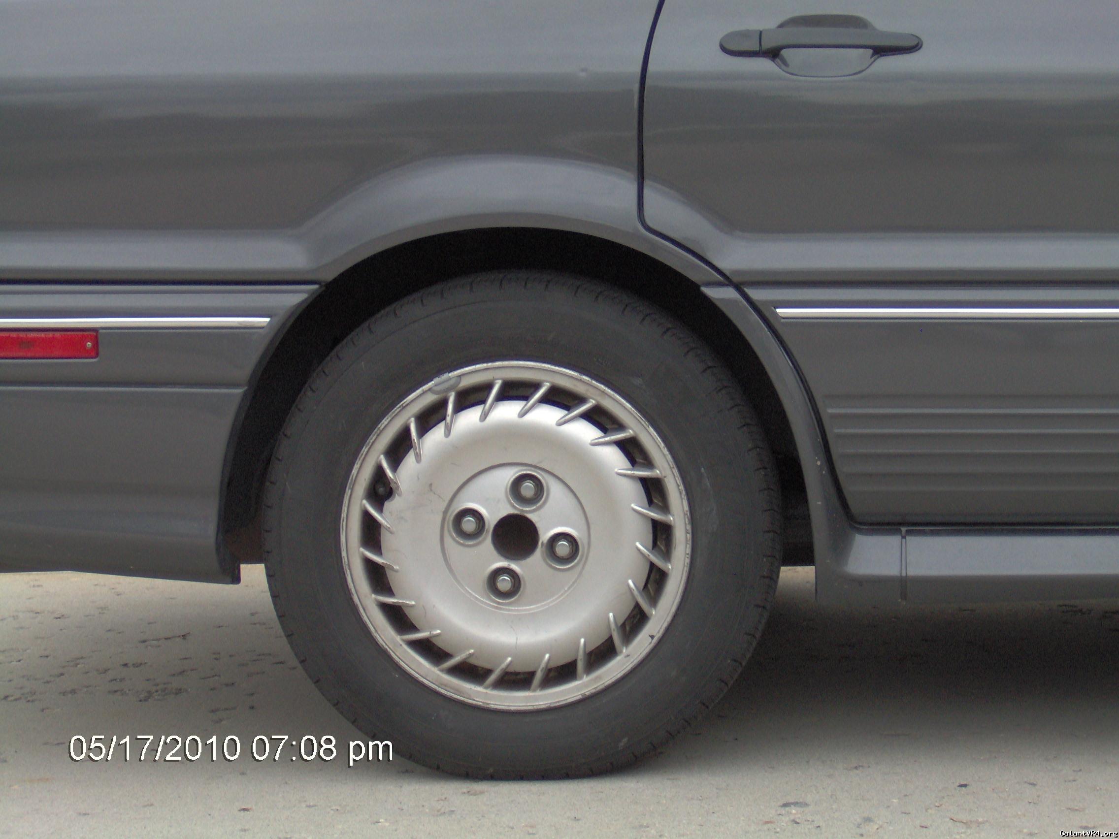

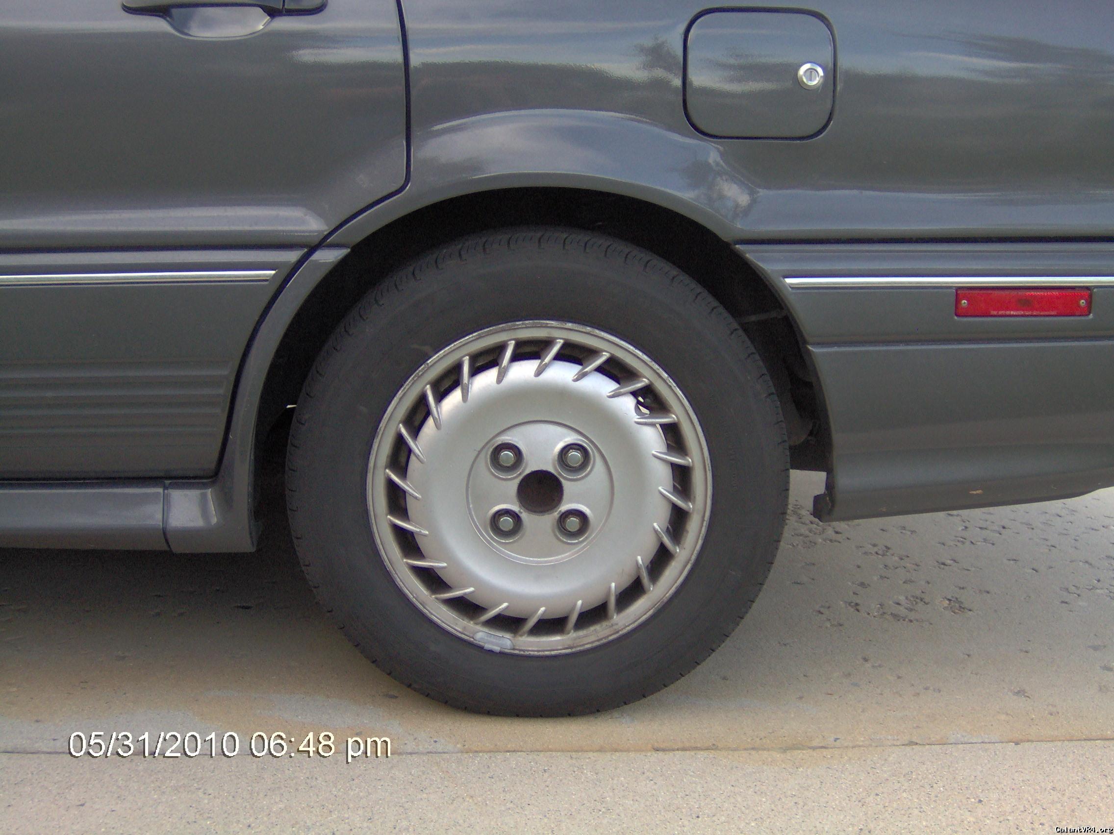

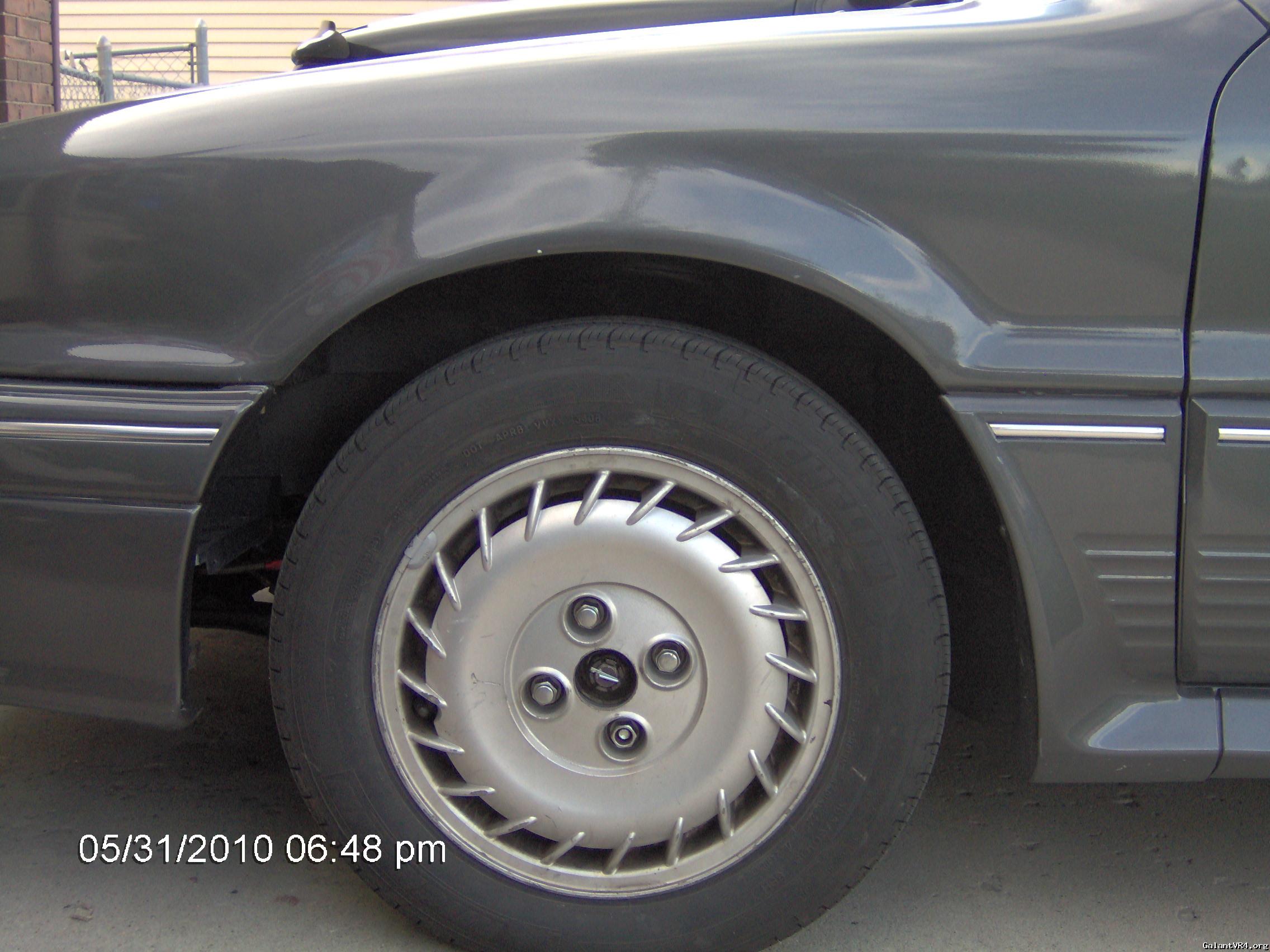

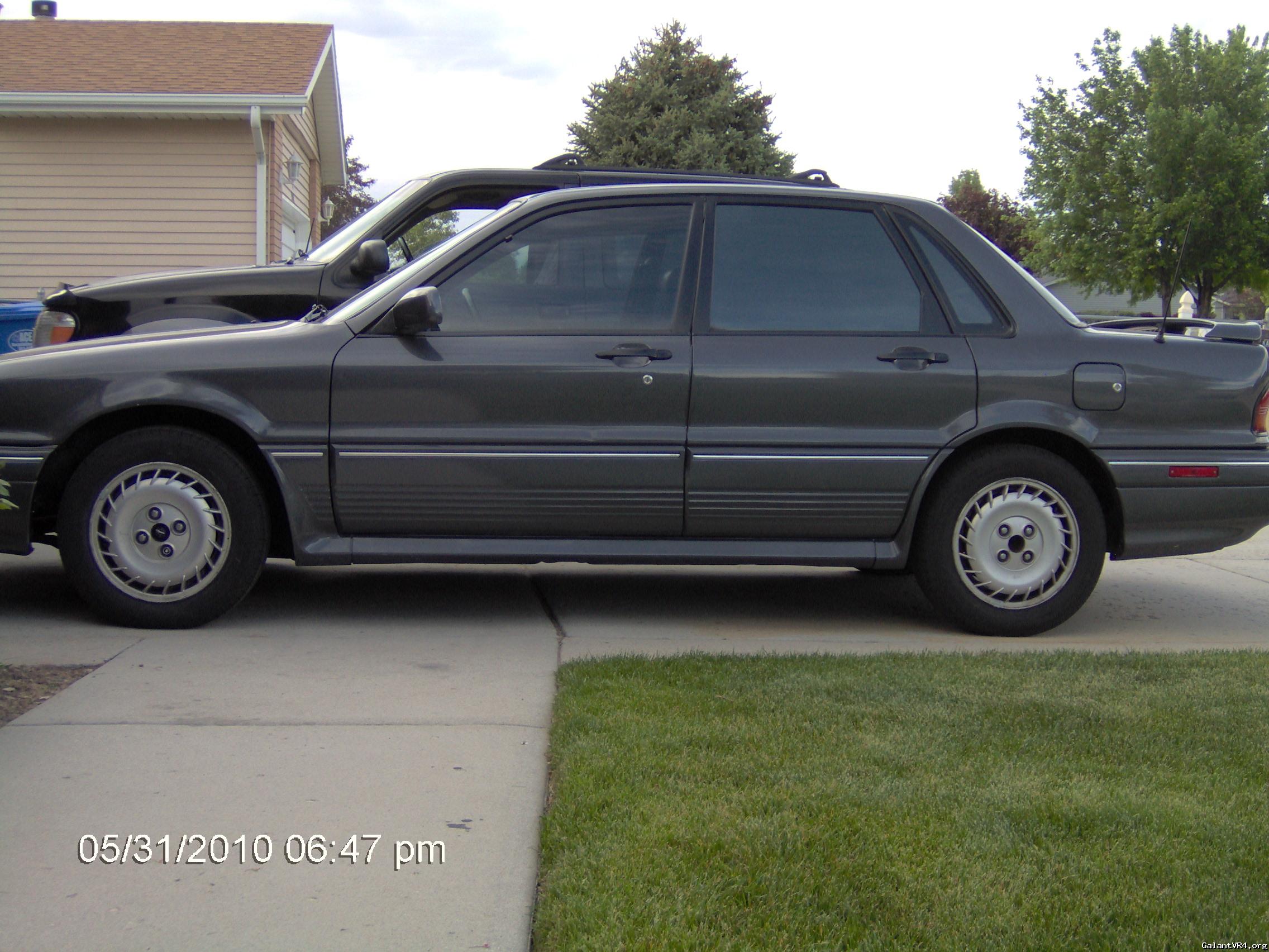

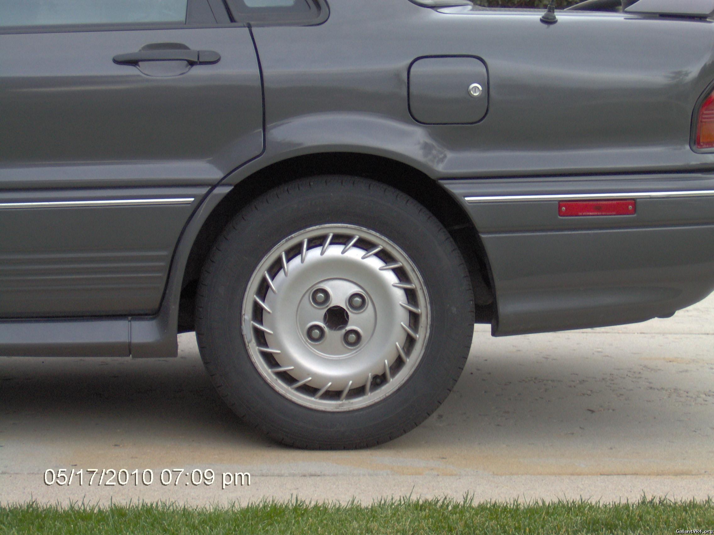

Thanks guys. I'm real pleased with how it all turned out. Best part is the handling. The poor 195/60 tires really get a work out now /ubbthreads/images/graemlins/grin.gif I plan on keeping them and the GSX wheels to keep the ride softer. I think 16s or 17s with a shorter sidewall would be a bit too stiff for a daily.
You'll actually get a better ride with stiffer sidewalls. There's not as much bouncing transfered as there is with 195/60's with a weak sidewall. 807 rides much better with 235/45/17 summer tires then my 195/60/15 snow tires. Looks great with the GSX rims BTW. /ubbthreads/images/graemlins/cool.gif

I put some different Evo springs in today. I liked how the springs in the first post looked, but didn't like how they would get loose when the car was jacked up.
Fronts are cut 1 coil and rears are uncut. Now the springs are tight when the car is jacked up. They also ride better. I'm unsure of camber in the front. They look real close to being straight up with maybe a very little bit of negative. I'm going to get an alignment this week, so I'll find out then.
