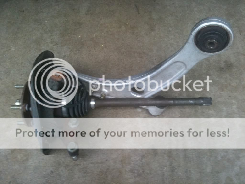

I've been looking over pictures and considering the possibility of swapping over complete evo 8/9 front spindles, as i will be running all evo brakes soon.
I'm working on getting better pictures of the evo front hub, i might just buy a pair and do all the measurements on them so i can see for myself.

So you're talking about using the lower control arm as well or no? If you are, you'd have to deal with the rear mounting point. If not, I know that the lower ball joing on an evo uses a pinch type fitting, whereas ours uses the tapered style. That's about all I Know. It would be handy if you had evo8 suspension on a galant I suppose.

no, sorry for the confusion, that was the best picture i found.
not using lower control arm
