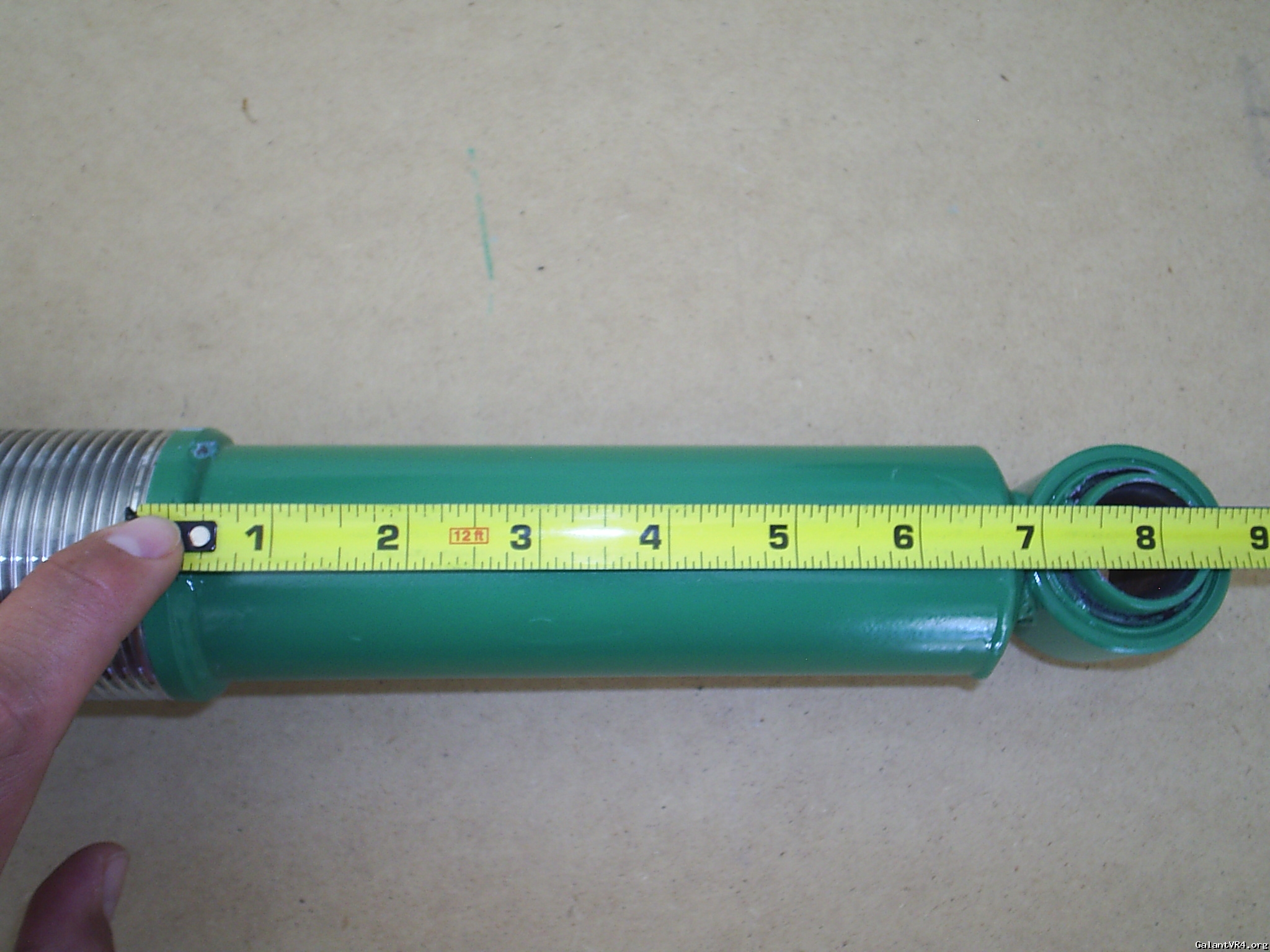

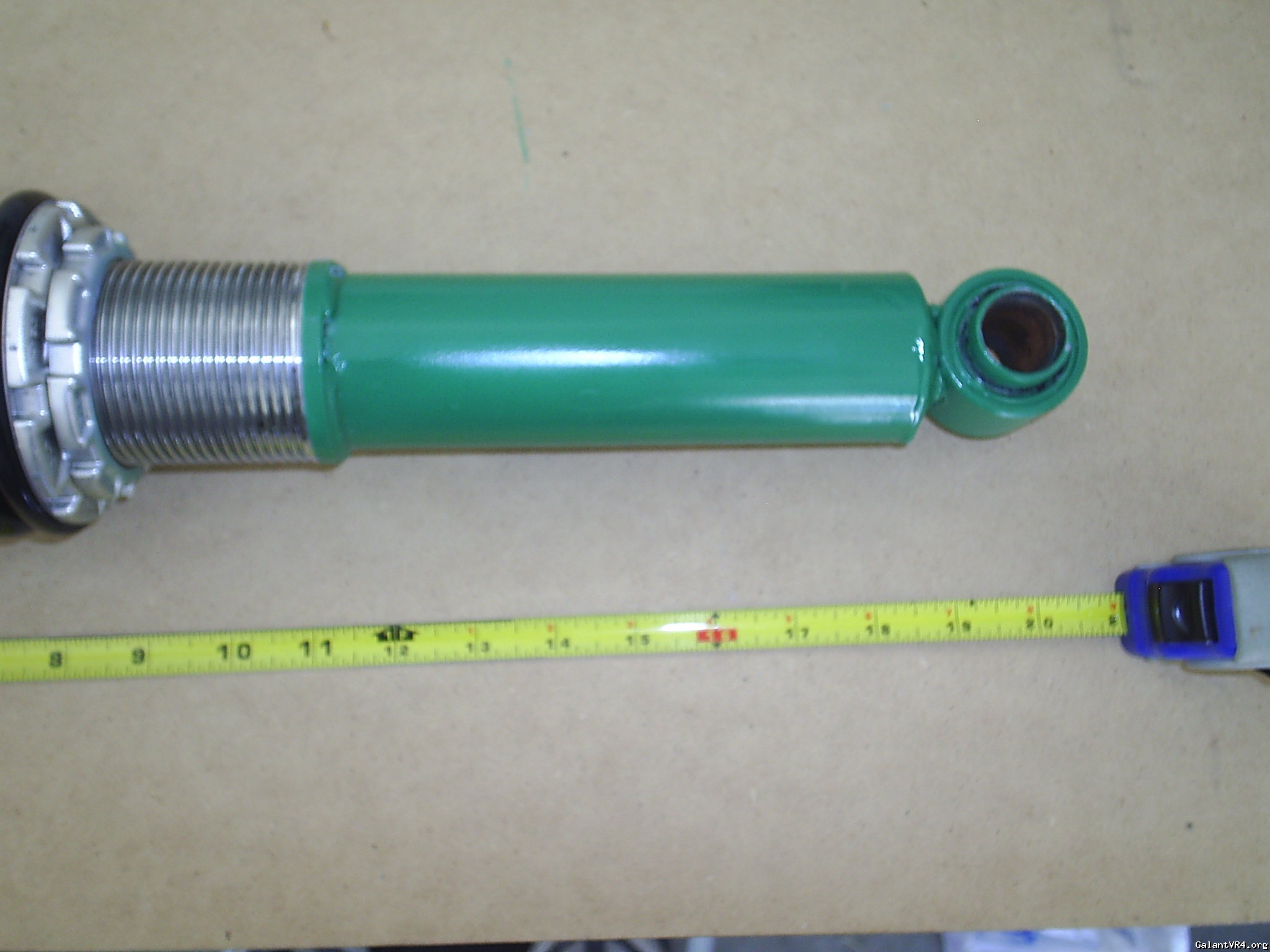

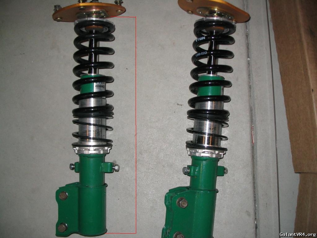

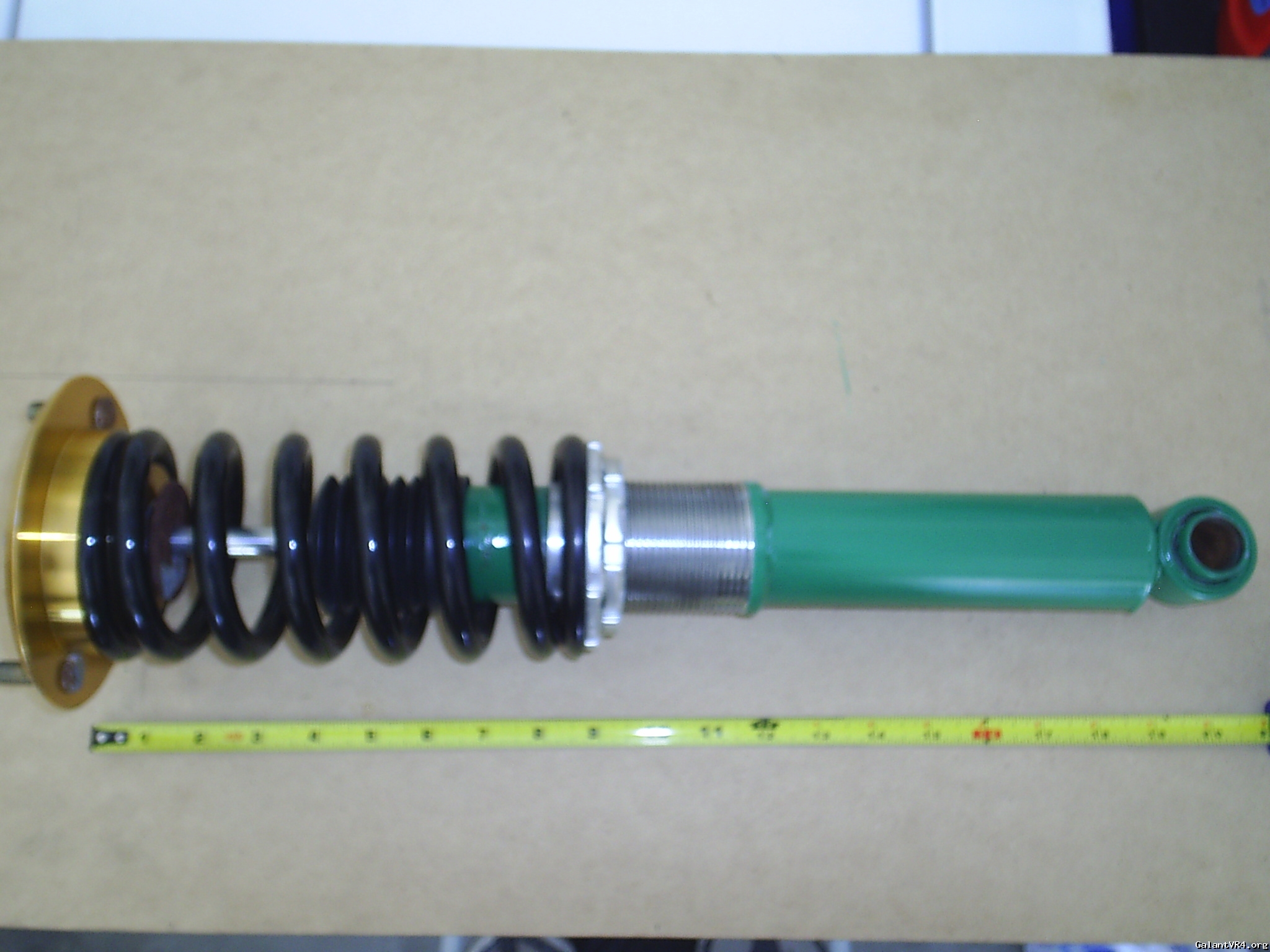

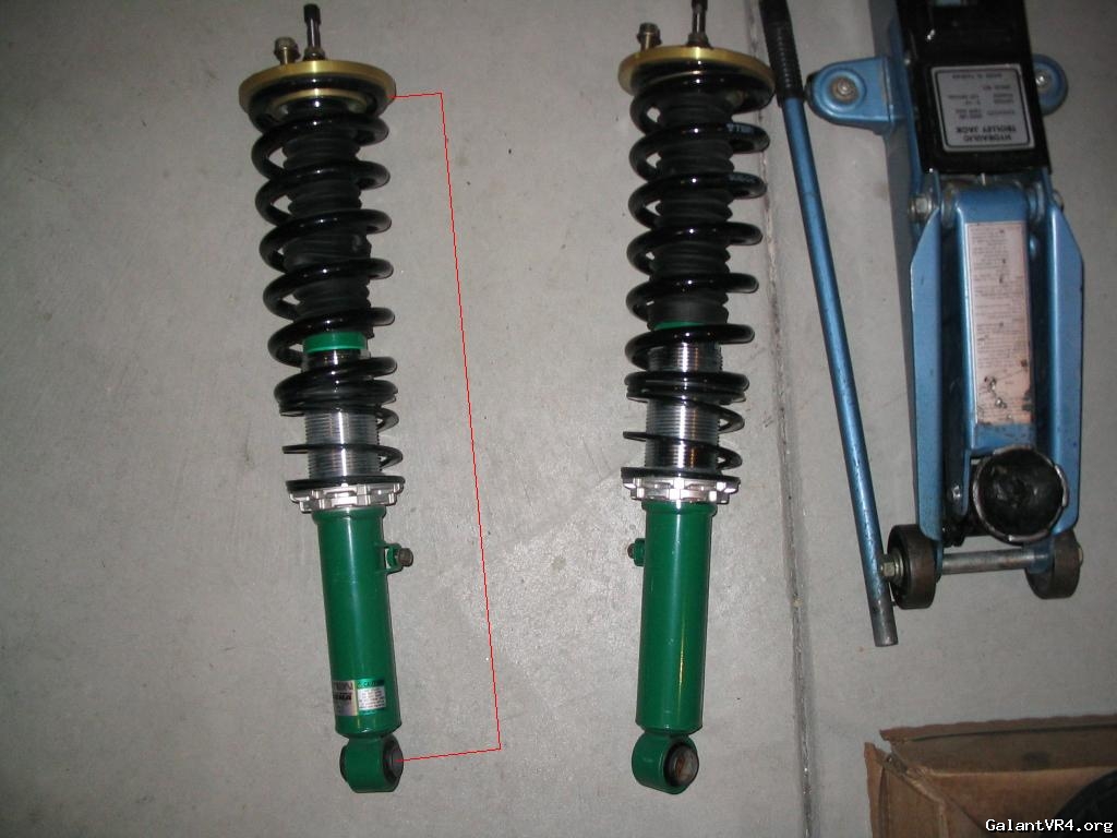

Here are a few pics form this afternoon, don't forget that you will still need a way to adjust your rear camber, such as a set of rear adjustable control arms. /ubbthreads/images/graemlins/hsugh.gif
11,992
I went out and jacked my car up to take measurements off my Tein HA coilovers.
On the rears I measured from the underside of the top mount to the center of the bottom mount.
On the fronts I measured from the underside of the top mount to the bottom of the strut.
I marked how I measured in red on both.
Rear: 21.25"
Front: 19.25"
These pics are from the last time I had them off the car. They are mounted at the moment.

According to the measurements the rears would work, but lower the car just by bolting them on.
What about diameter of the mounting bushing on the evo x vs gvr4? Front lower mounts the same?
