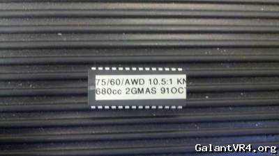

I need info on the contents of this chip. There is also a clutch wire assembly. It came with #415/1000.
The label on the chip reads as follows:
75/60/AWD 10.5:1 KNOCK
680cc 2GMAS 91 OCT

IIRC, it's a 7500 redline, 6k studderbox with 680cc injectors, 2G mas sensor tuned for 91 octane running 10.5:1 fuel ratio with the knock disabled at lower rpms.

Quoting prove_it:
I don't think it has knock disabled at lower rpms but instead the boost gauge repurposed as a knock gauge.
The chips with phantom knock code usually say so.

If you want to add phantom knock code it is:
At location 5B9D: 86 FF 97 52 96 E1 81 8C 23 03 7E DB F3 86 00 97 8B 7E DB F3
Explanation found here: here.
