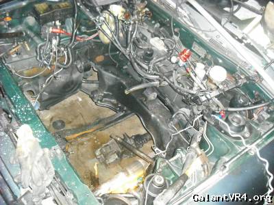

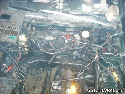

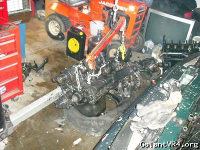

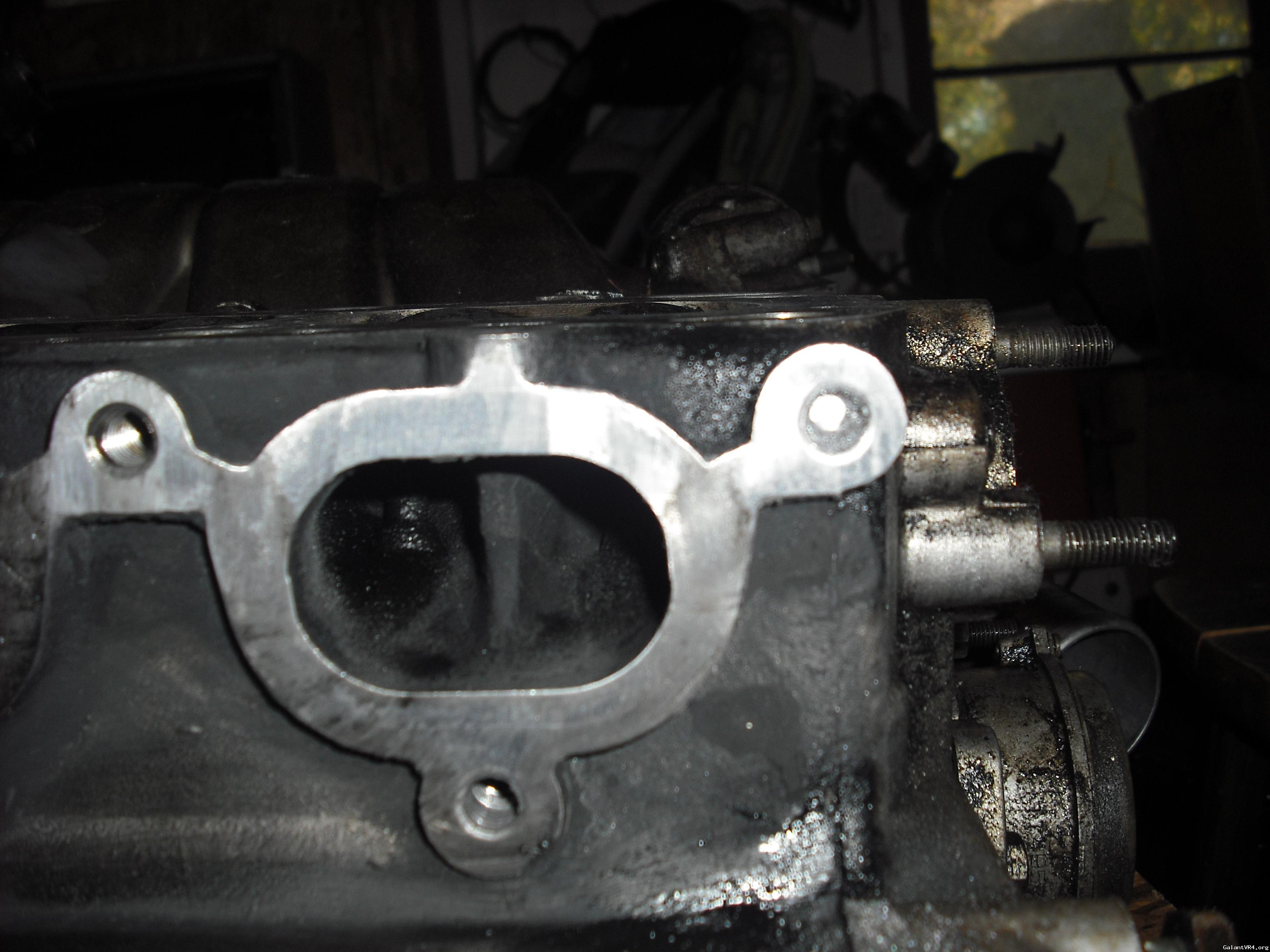

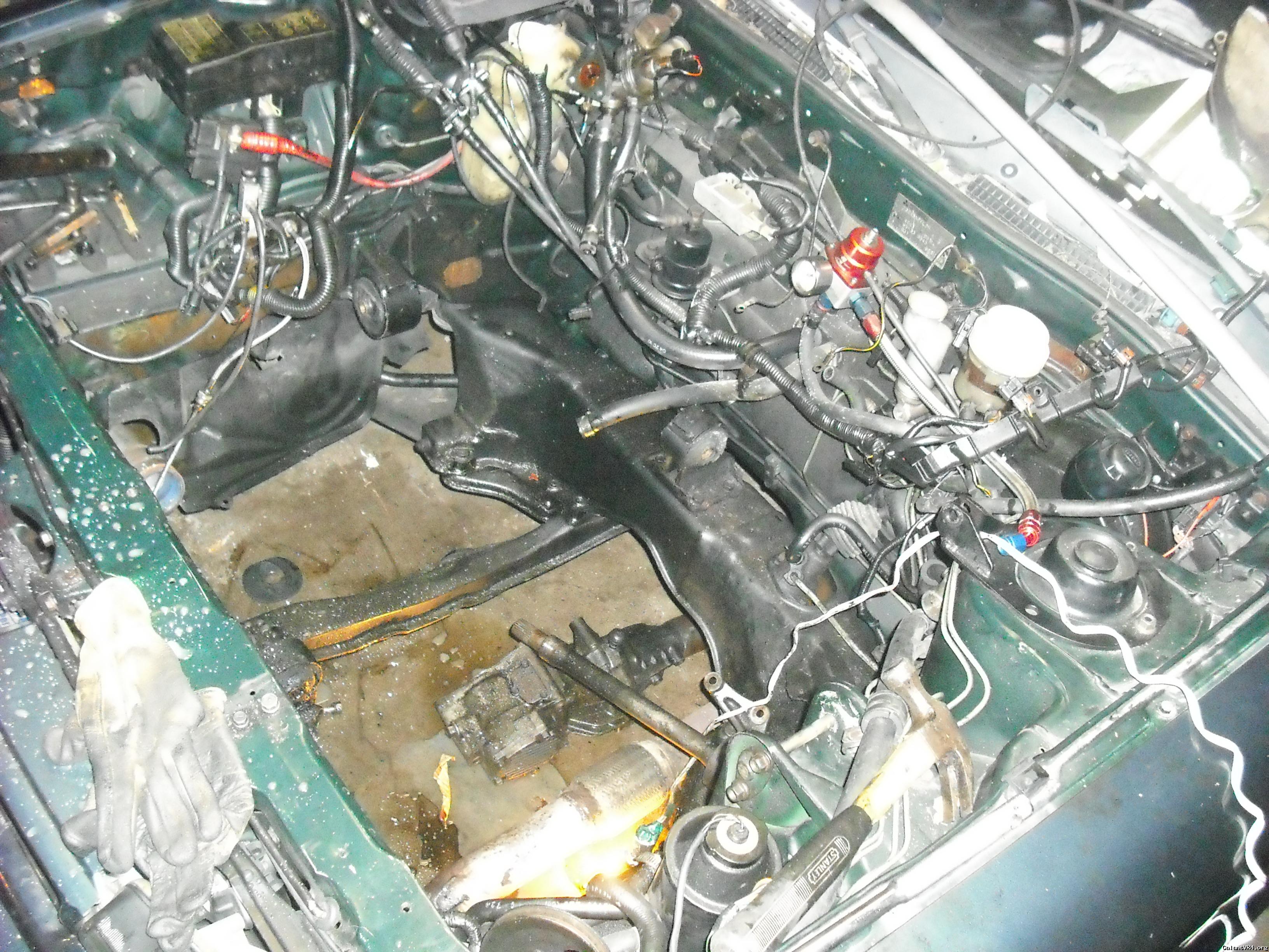

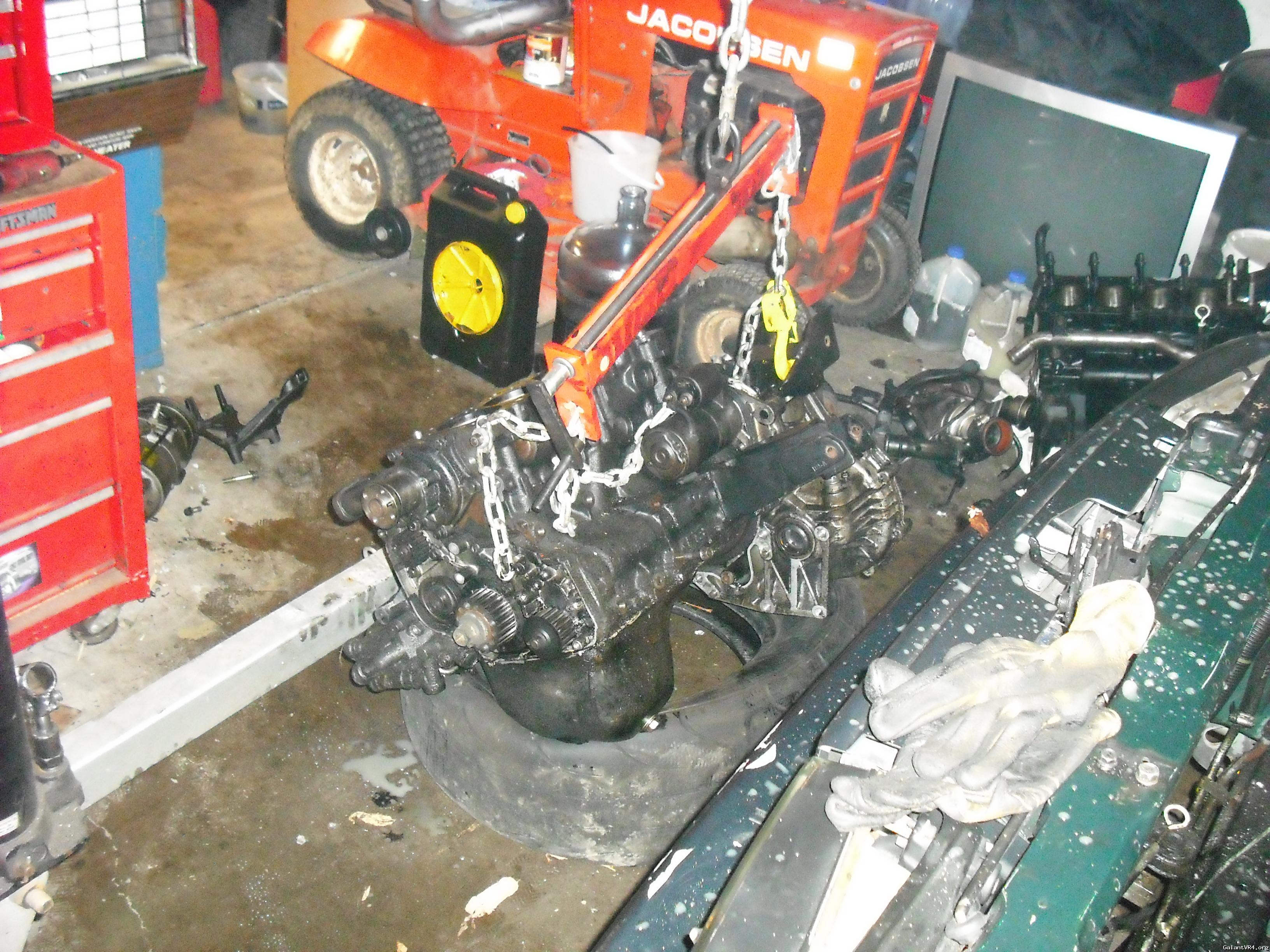

finaly got the old engine out and started swaping a couple things over. getting ready to send my head out to be resurfaced but am having a hell of a time drilling out a simple stud on the exhaust side.

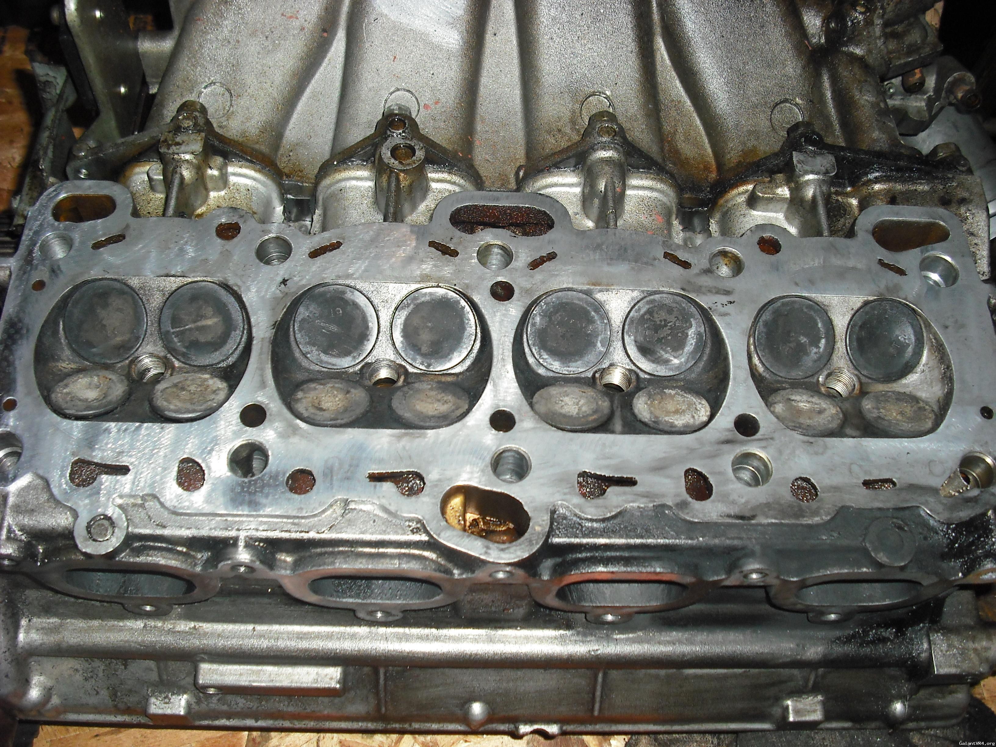

before i send my head out or even after should i do a valve job or should i be ok
boosted_85
Apr 2, 2009
198
milwaukee, wi
You should deffinalty get your valves seals, valve guides replaced along with the valve job. Most machine shops valve job includes cutting valves, seats and installing new guides and seals. Also the machine shop can fix the broken stud ordeal.

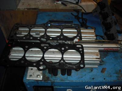

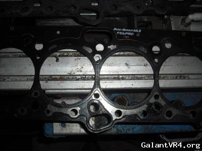

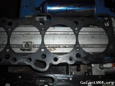

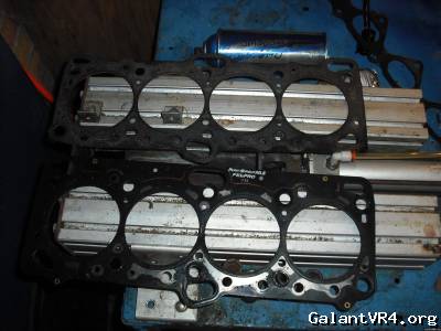

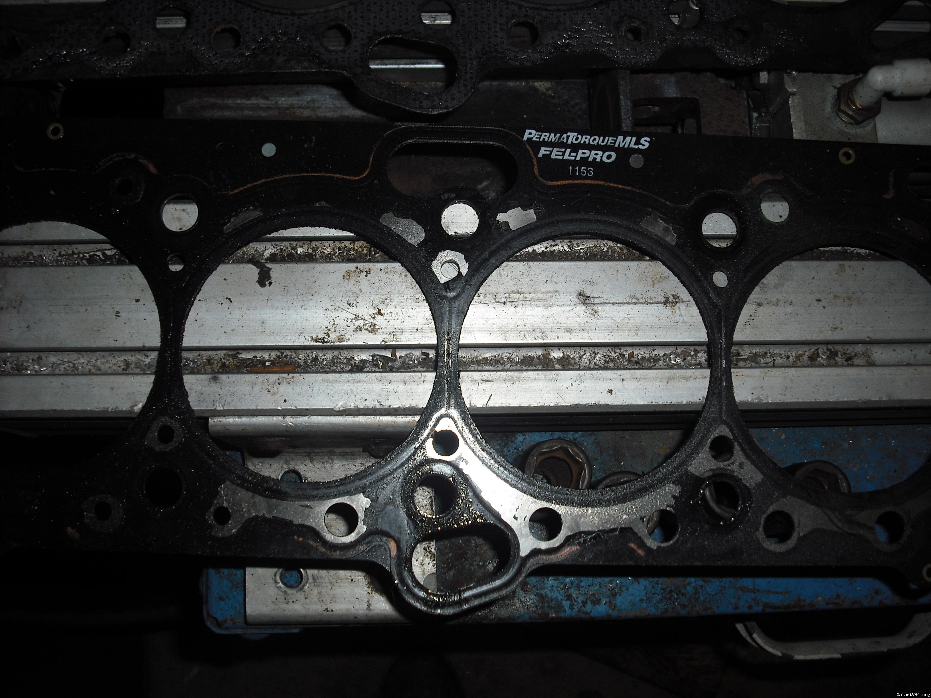

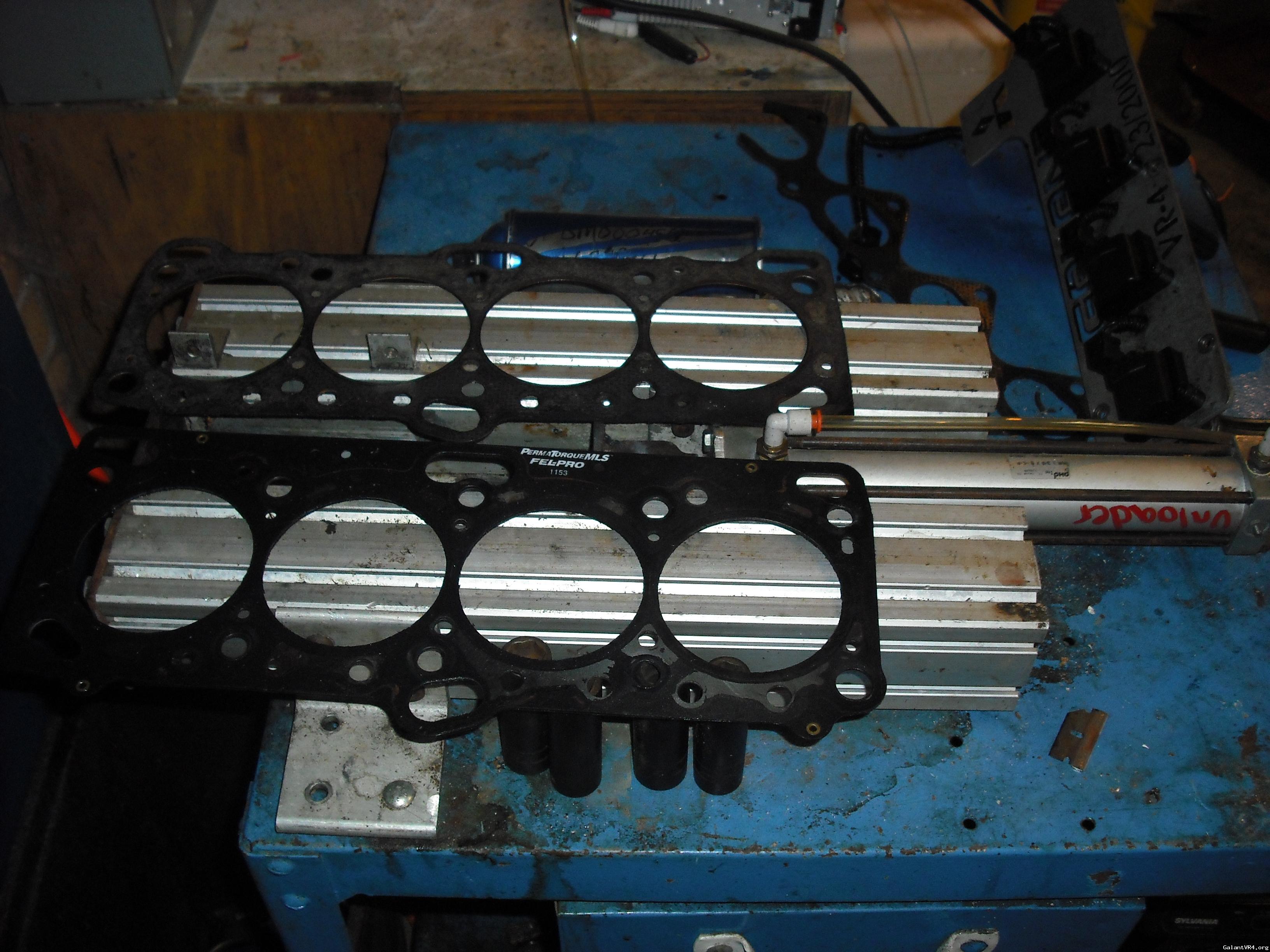

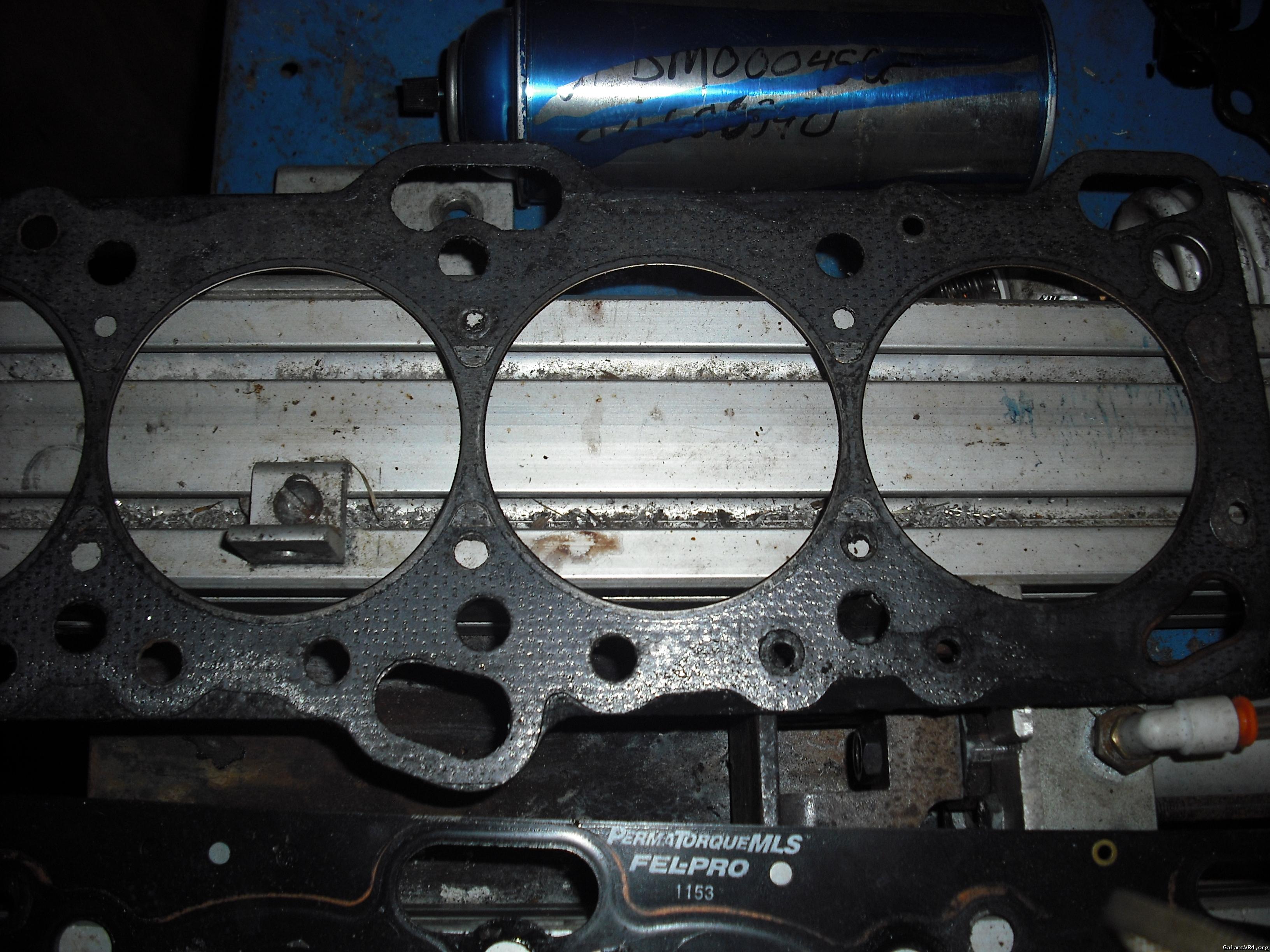

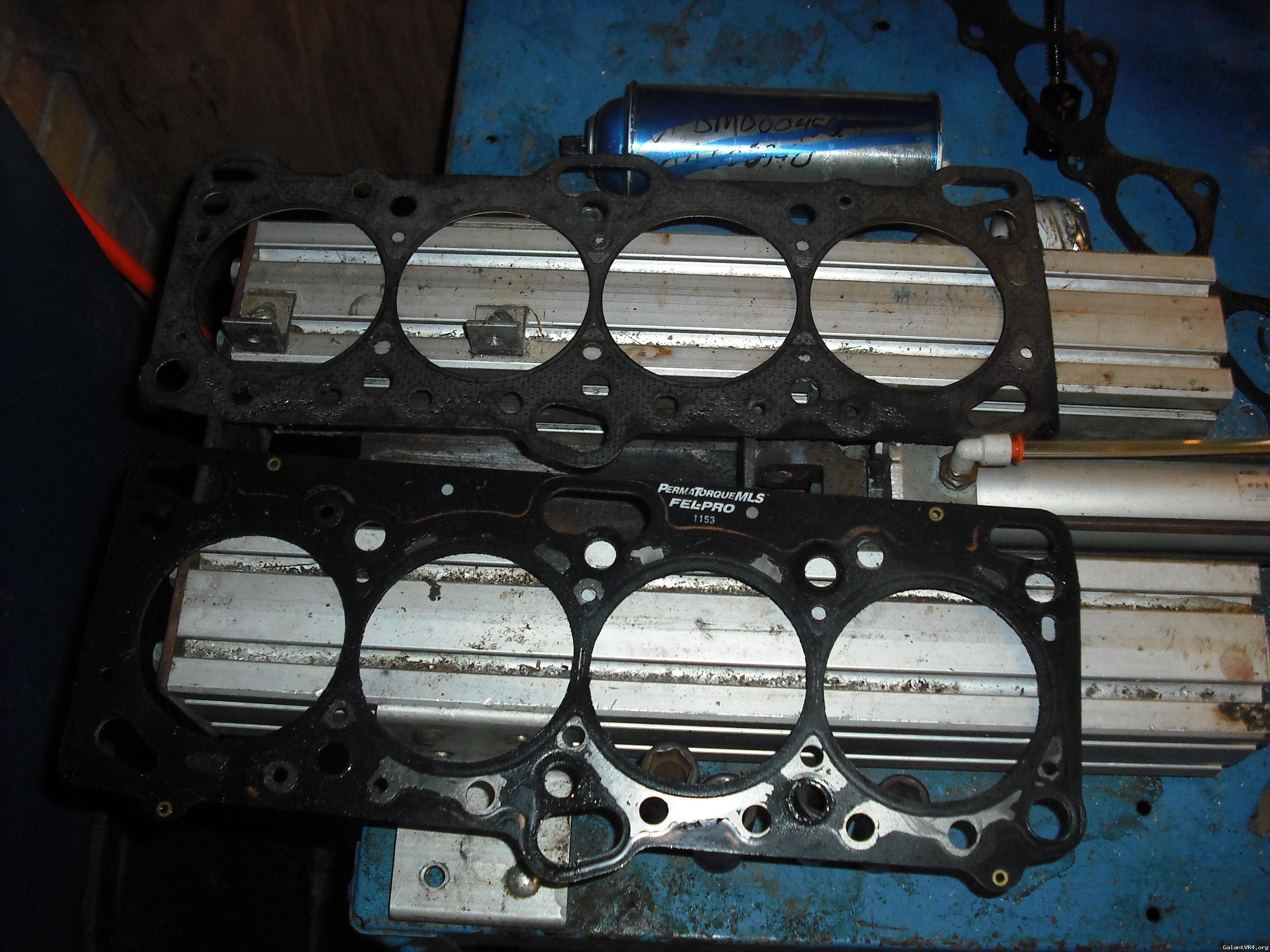

so i decided to just buy a new head buy would a stock head be enough? what i mean is well how much power can they handel and what head gasket should i buy wen i get new head the new engine came with the old felpro mls so what should i do? i use the car for a DD but i also want to be able to be able to go all out once in a while and turn some heads /ubbthreads/images/graemlins/jawdrop.gif
fuel
Feb 23, 2009
2,167
Toronto, ON, Canada
I would go brand new.. both of them look used. Cometic or genuine Mitsubishi MLS Evo1-3 head gasket would do the trick.

bought a felpro gasket set but i have one question the gasket that is used between the ehxaust mani and the turbo will it fit the 16g evo3 turbo and mani also or do i have to buy that seperate???
