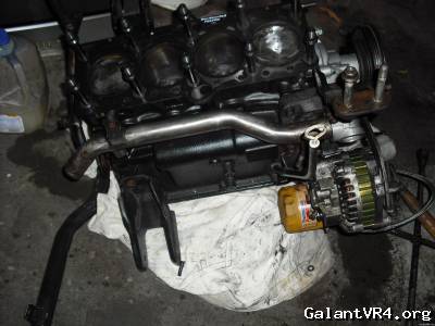

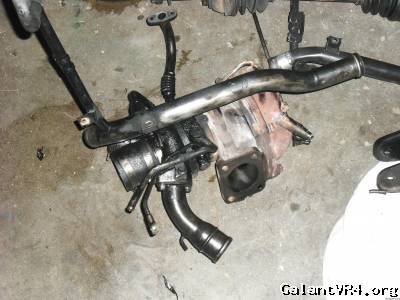

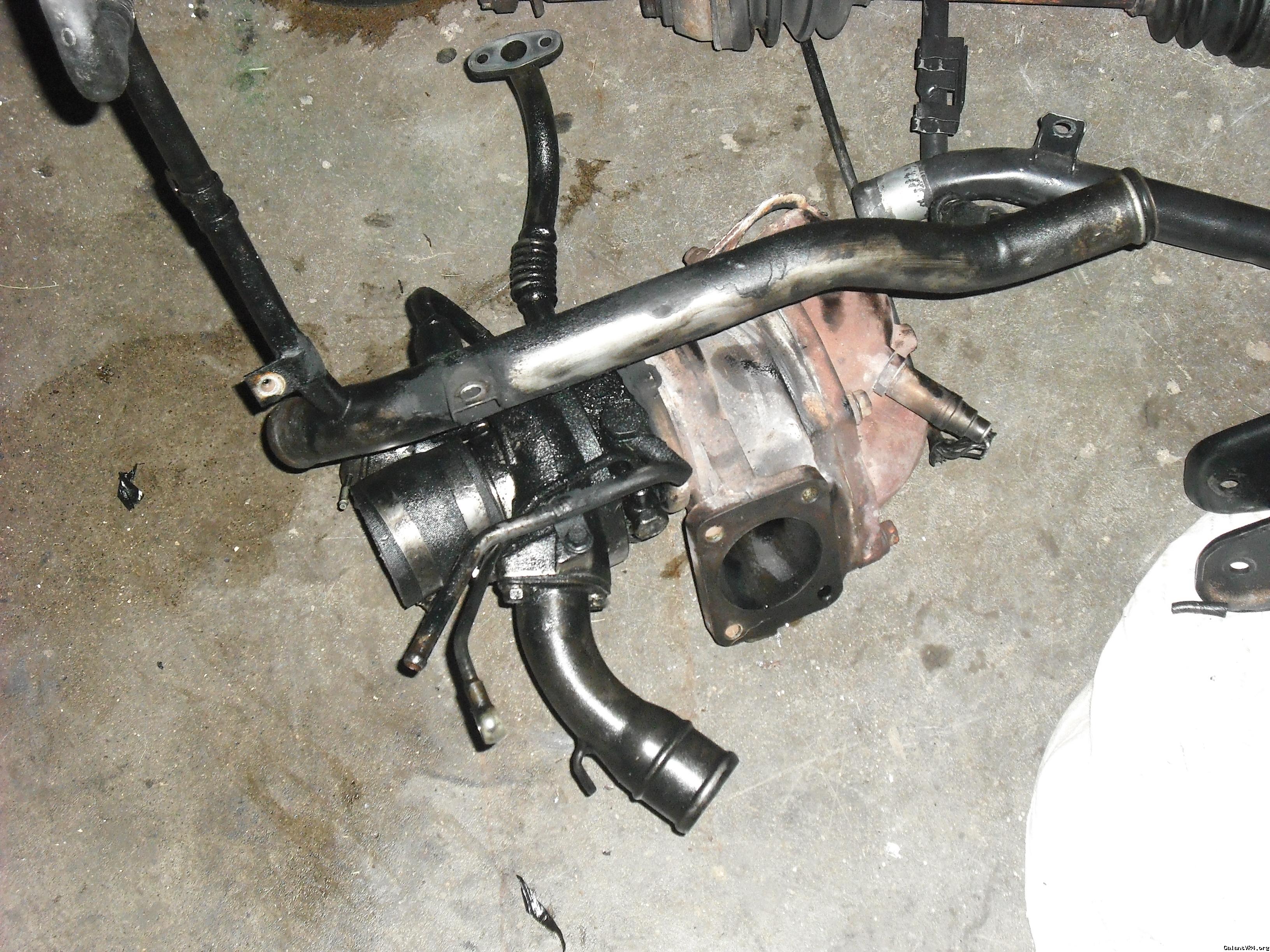

finally had time to post pics of my new engine /ubbthreads/images/graemlins/worthy.gif and used 16g turbo /ubbthreads/images/graemlins/dunno.gif

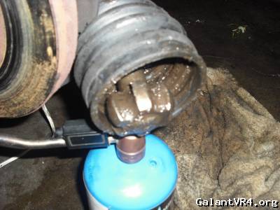

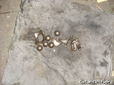

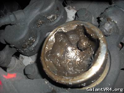

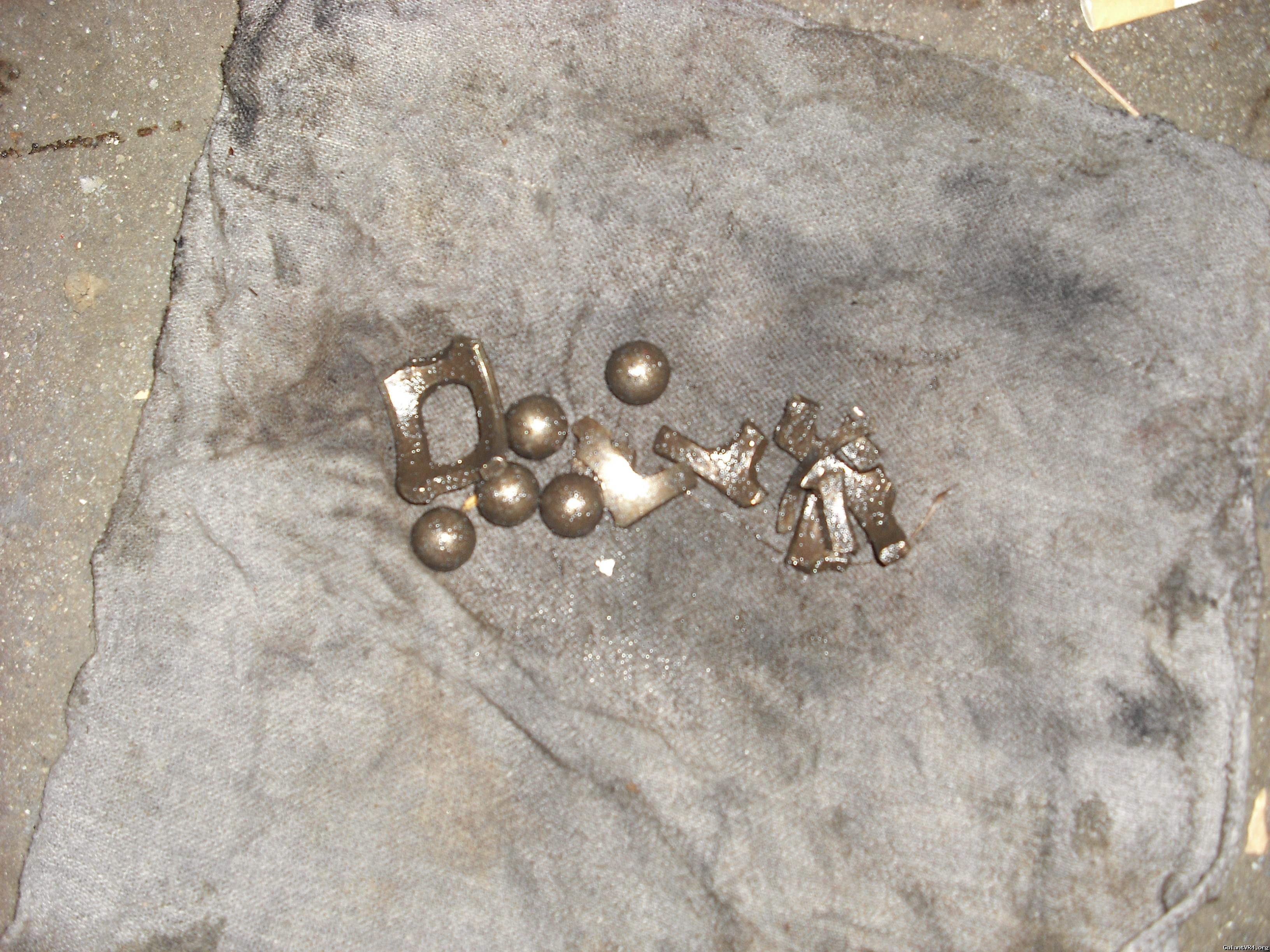

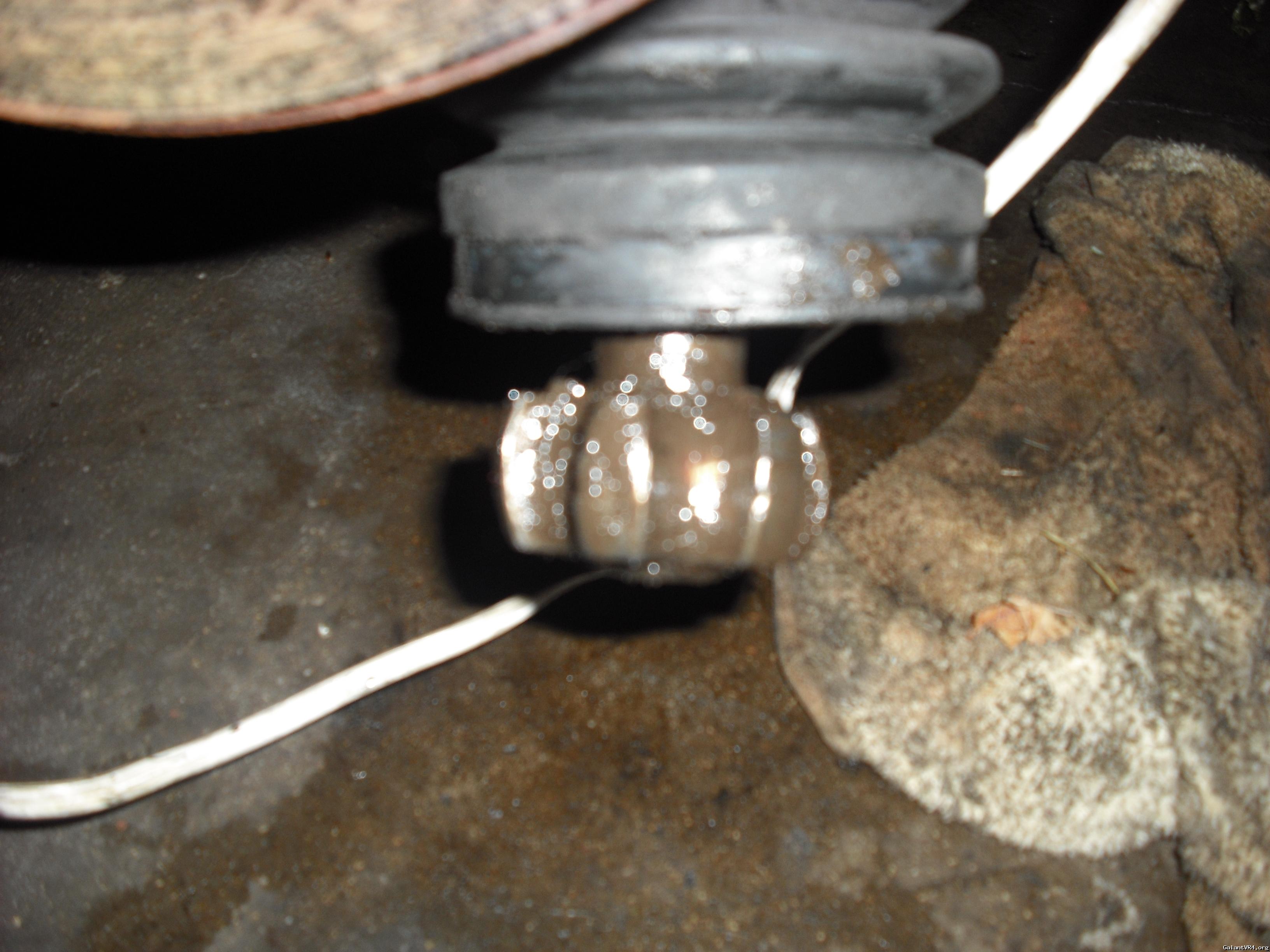

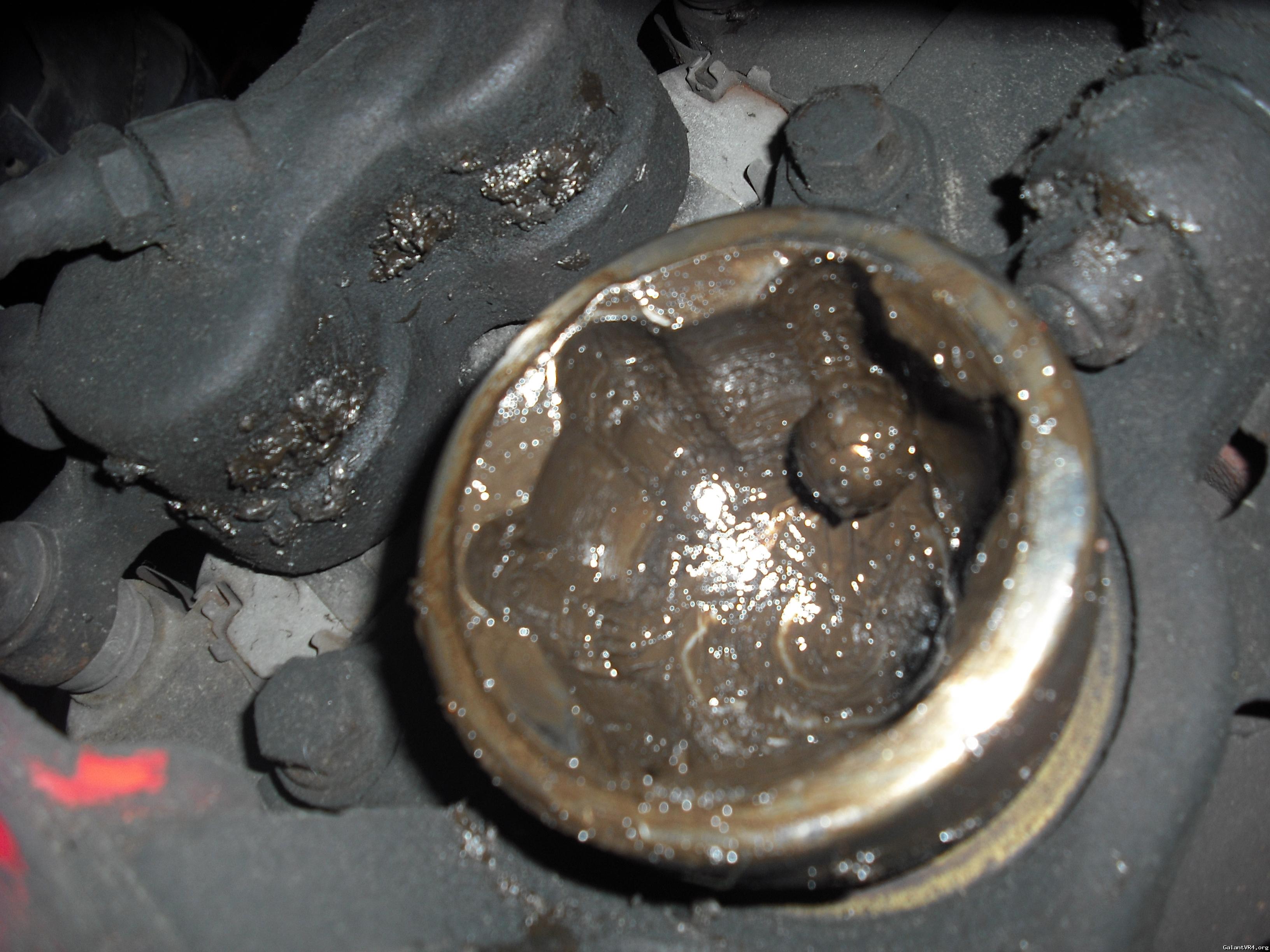

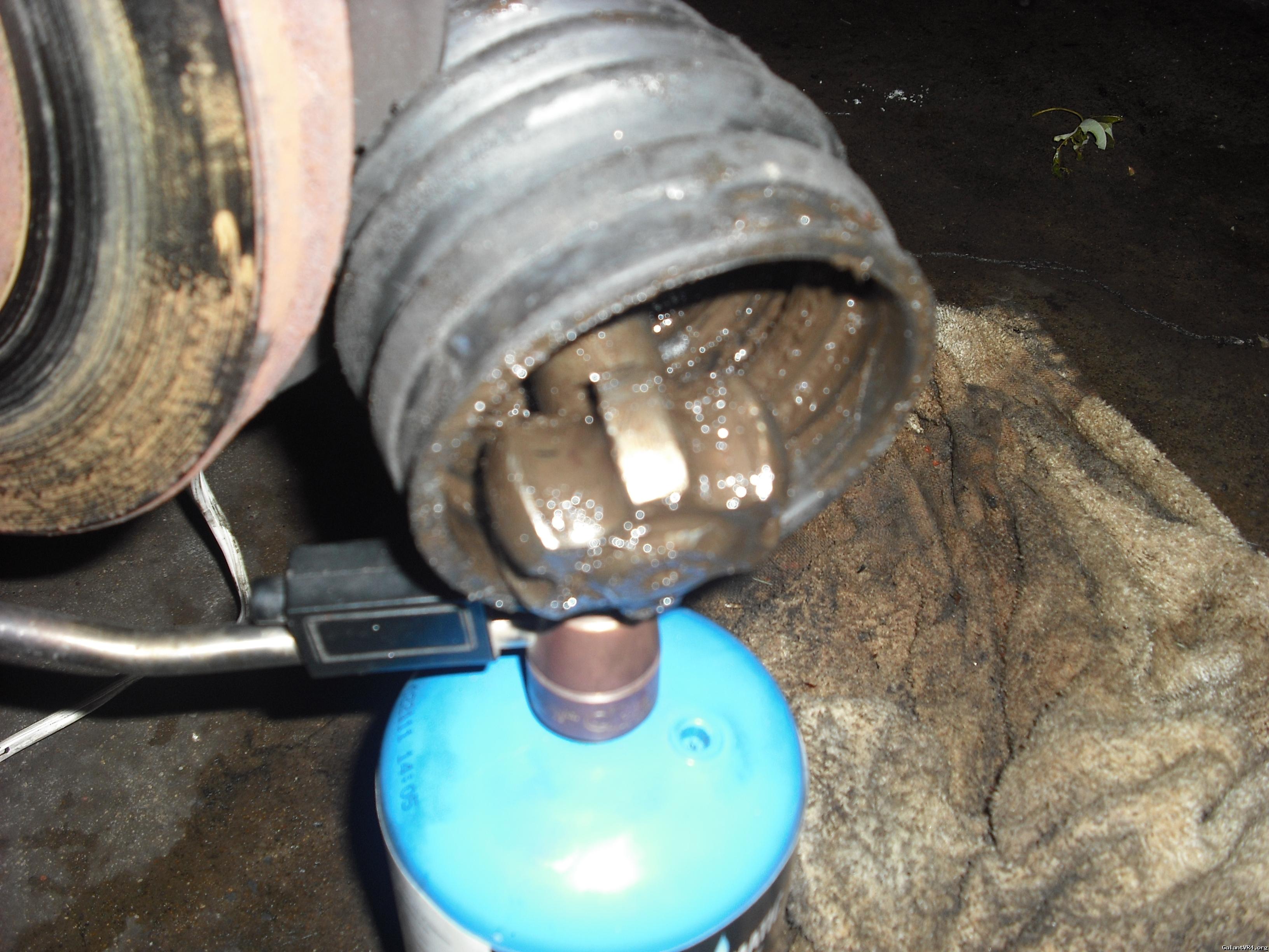

I know this is unrelated to the title of this thread but are there any other cars i can get half shafts off of that will work for the front because both of mine are f***** beyond repair
I know how to replace the rubber boots but the cvs are shaddered on the ends that bolts to the wheel hub. The balls and cage are all crushed and in pieces and the cv joint thats right before the hub are broke off on both sides

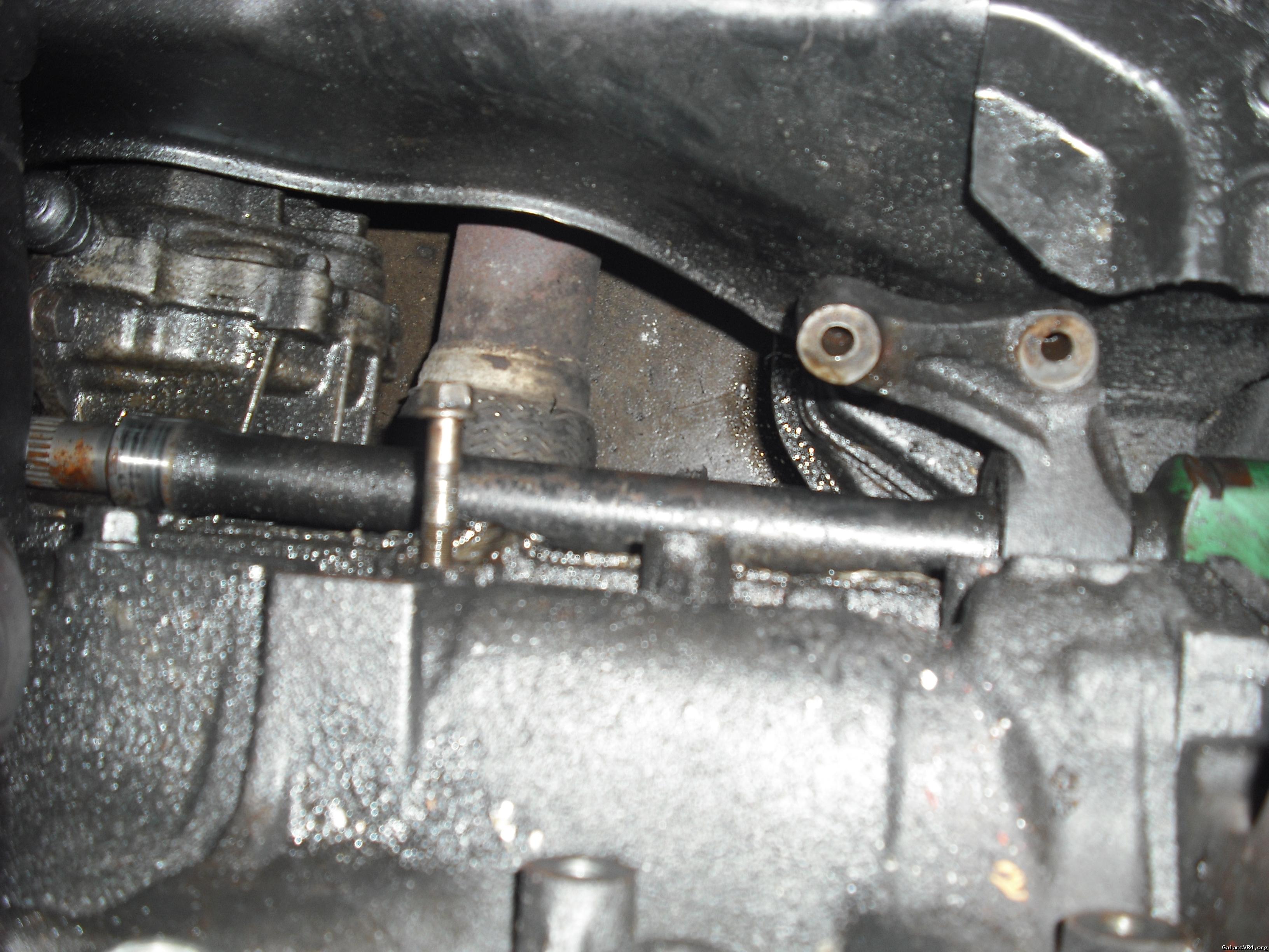

this is the driver side and all this happened because if u look at the picture below the bracket for holding the shaft up was held in by one bolt and wasnt even torqued down and the other bolt is snapted off clean
and the driver side the end of the shaft
is broken off

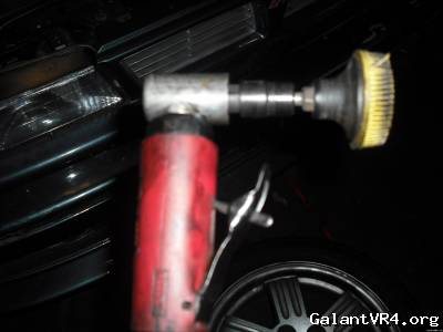

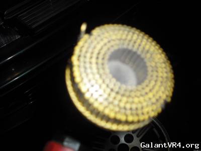

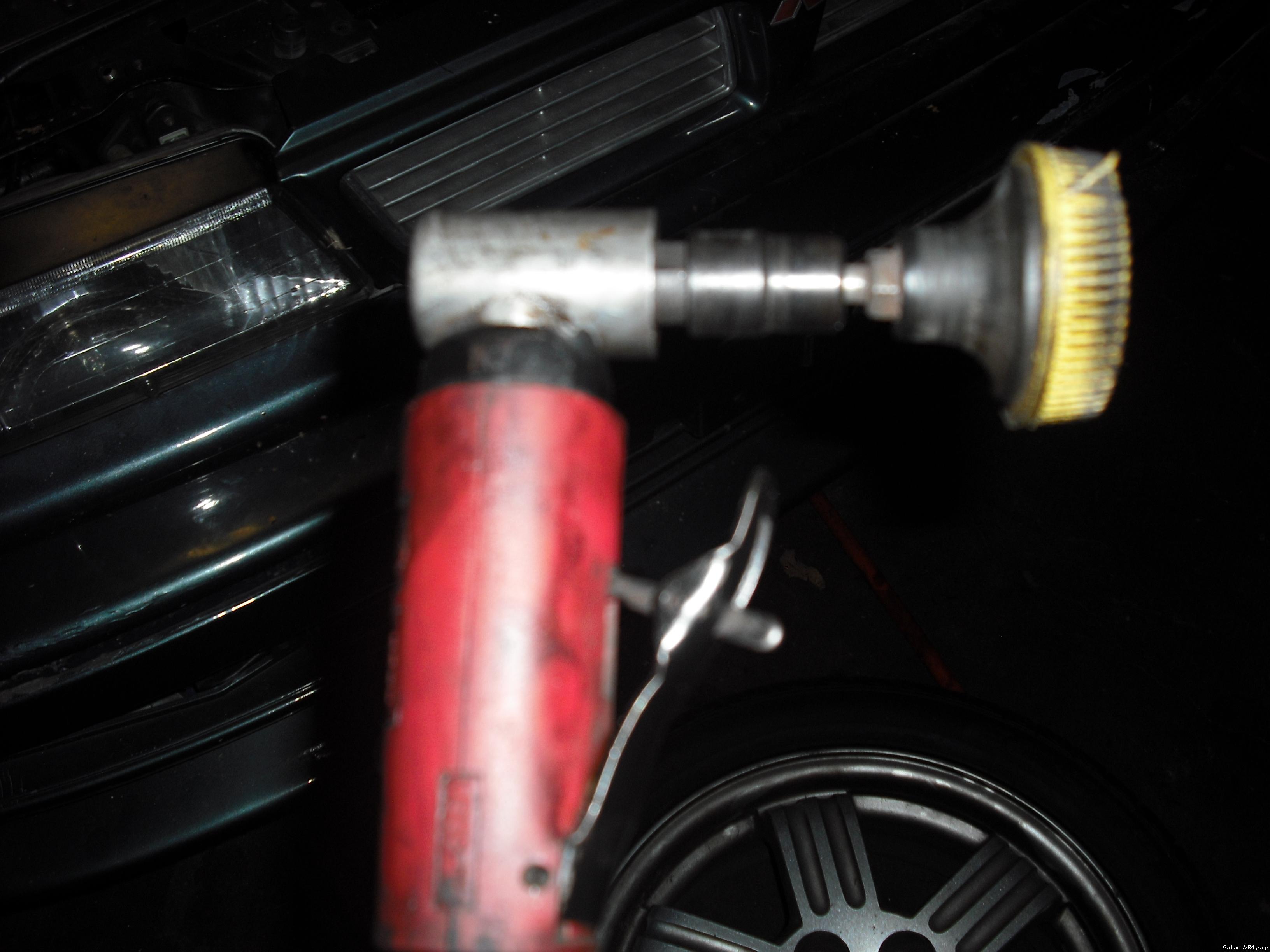

verry little progress spend most of my time cleaning 21 years of dirt and grime but ile tell u what this tool has been my best friend
it doesnt get everywhere but close enough

Simple Green and a tooth brush can get into a lot of little places. I used that to clean my motor and it worked great, time consuming, but well worth it in the end.
simple green never heard of it i been buying a crap load of engine cleaner but its getting expensive its like 3-4 $ a can. i wish i had my old dishwasher i i modded it to be a parts washer but the solvents ate it up like no other

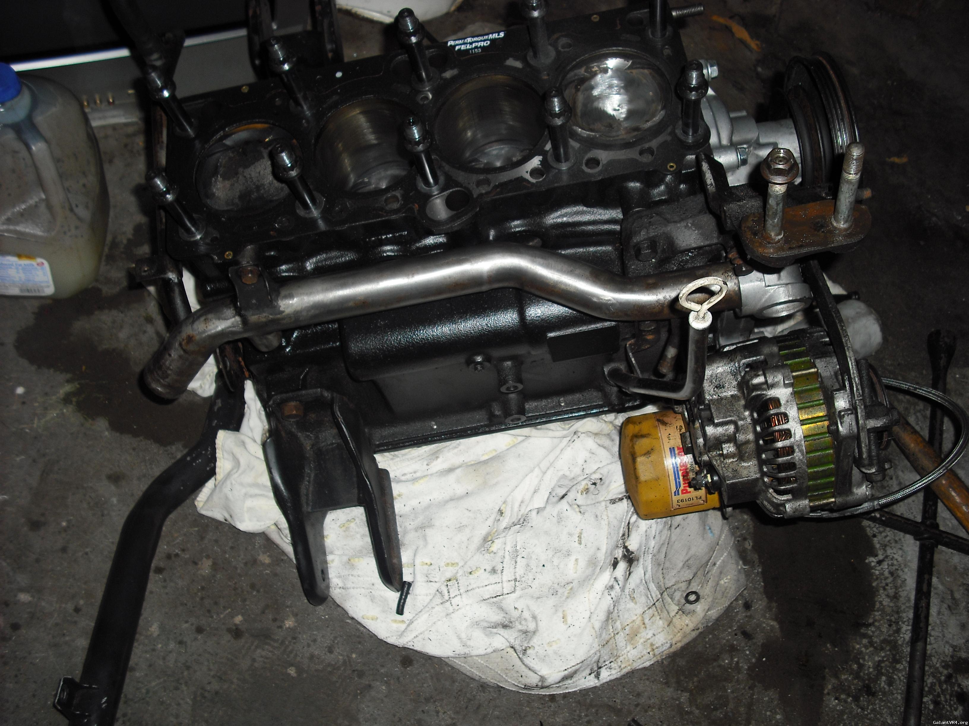

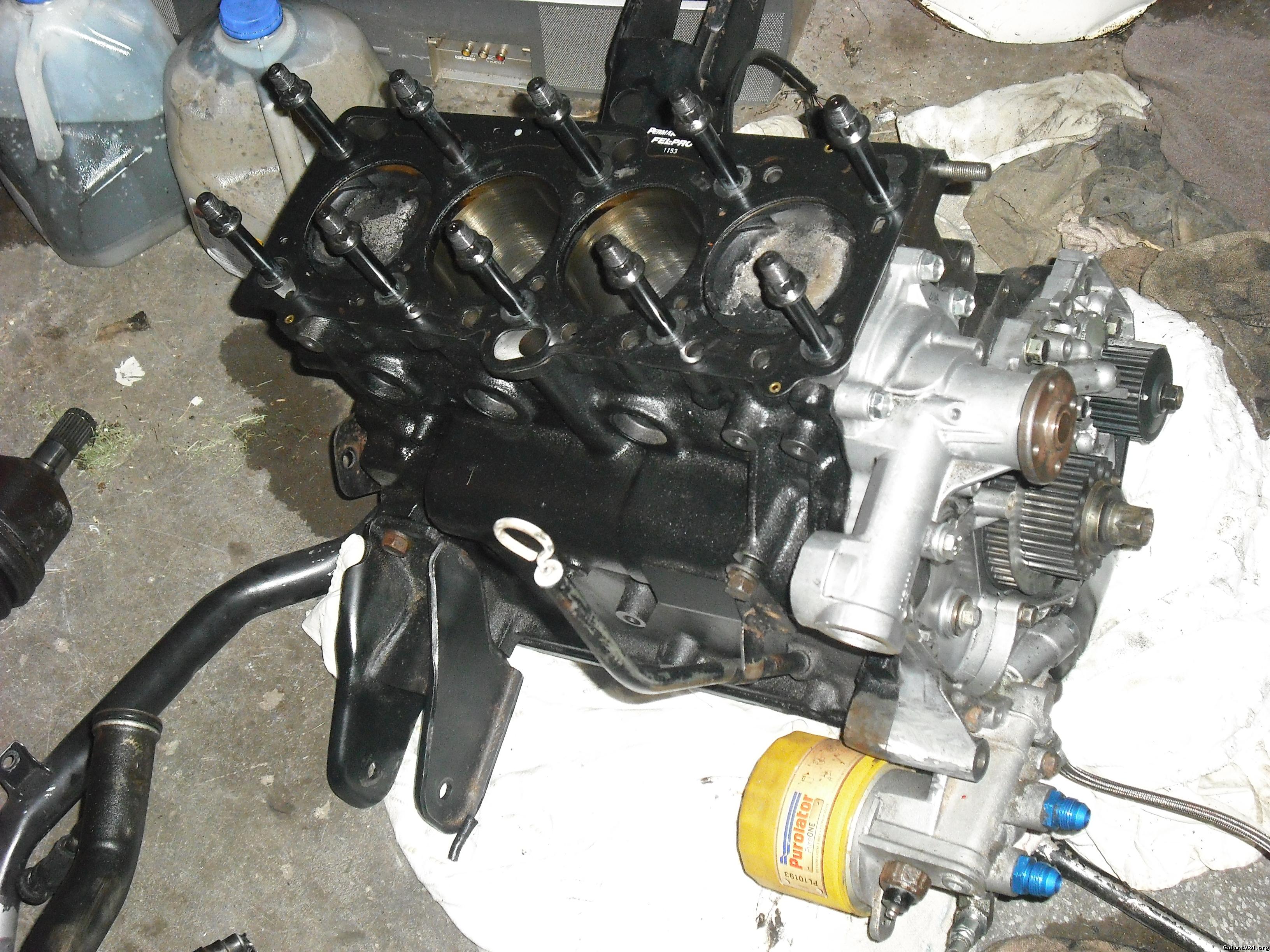

so i have a question i hope some one can answer. on my old engine the oil cooler goes on before the oil filter and on the new engine there are blue hook ups for the oil cooler would i just run lines from those to a oil cooler and mount it where my condenser used to be. i know some trucks have trans coolers would i use the same type of setup?
this is also a long shot and probly a bad idea but could i use my old condenser as a oil cooler or is that just a stupid idea because it could handel the pressure. idk whats ur oppinion
boostedinaz
Apr 20, 2006
4,085
Scottsdale, AZ
The oil filter housing (OFH) on the motor in the picture is from a 90 DSM. Most people switch over to those so they can plumb and external oil cooler on the car for better cooling.
I would not suggest using the condensor as a cooler simply based on size. It would be HUGE and might actually keep the oil to cold to really work well.
