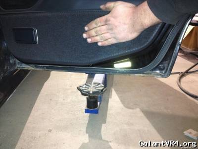

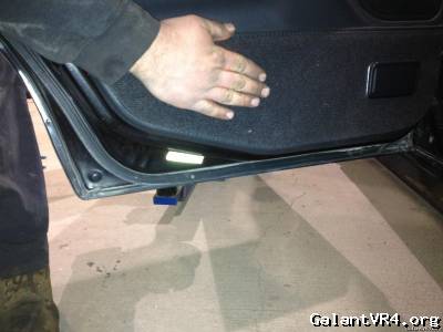

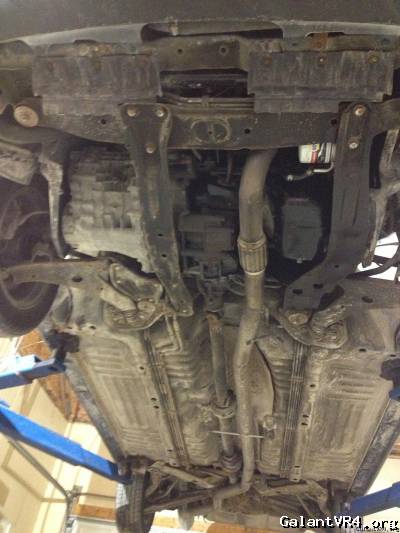

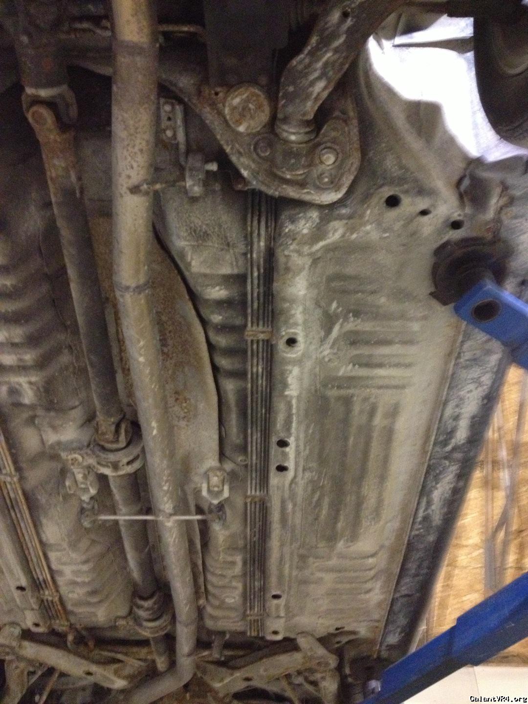

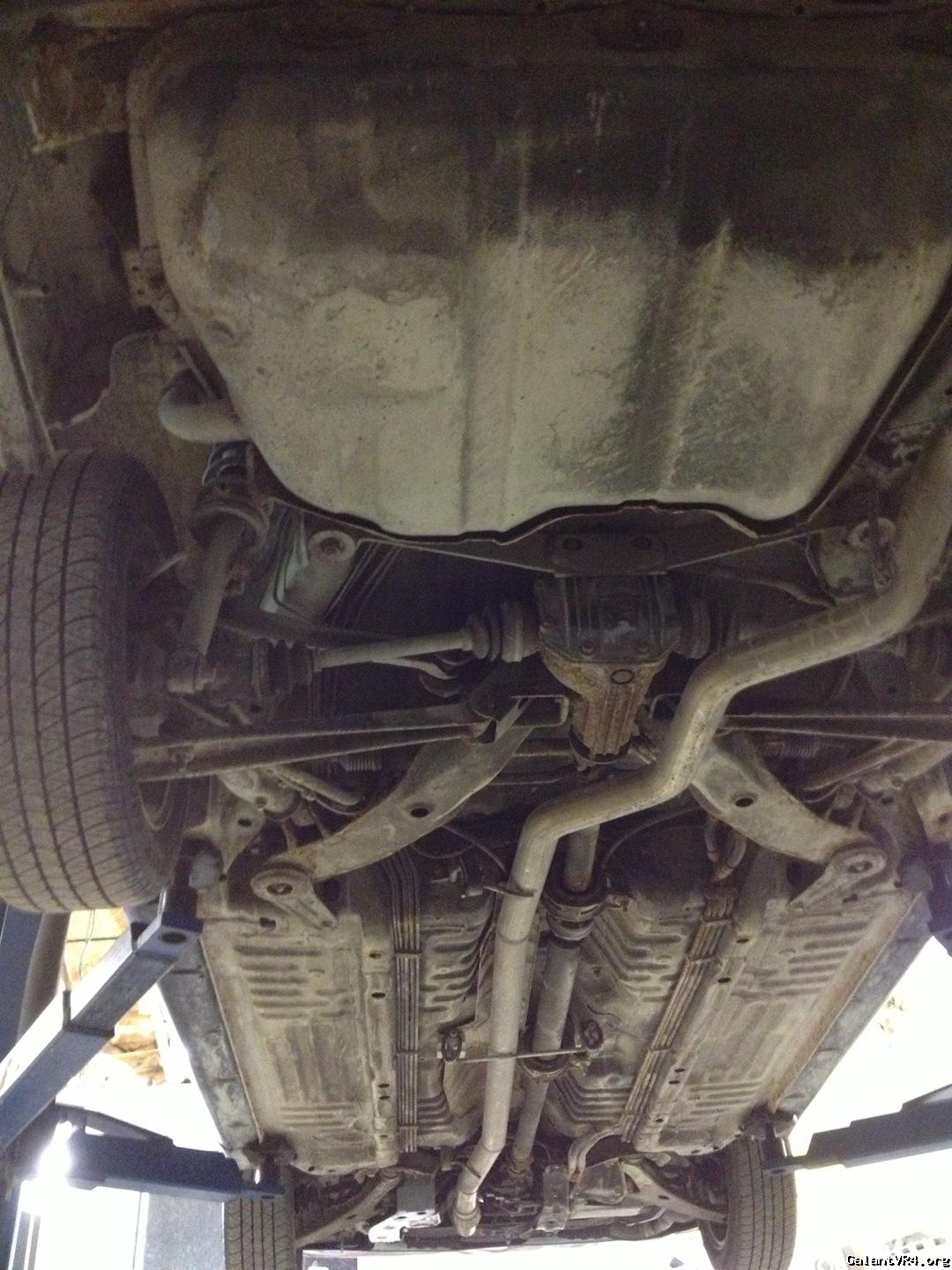

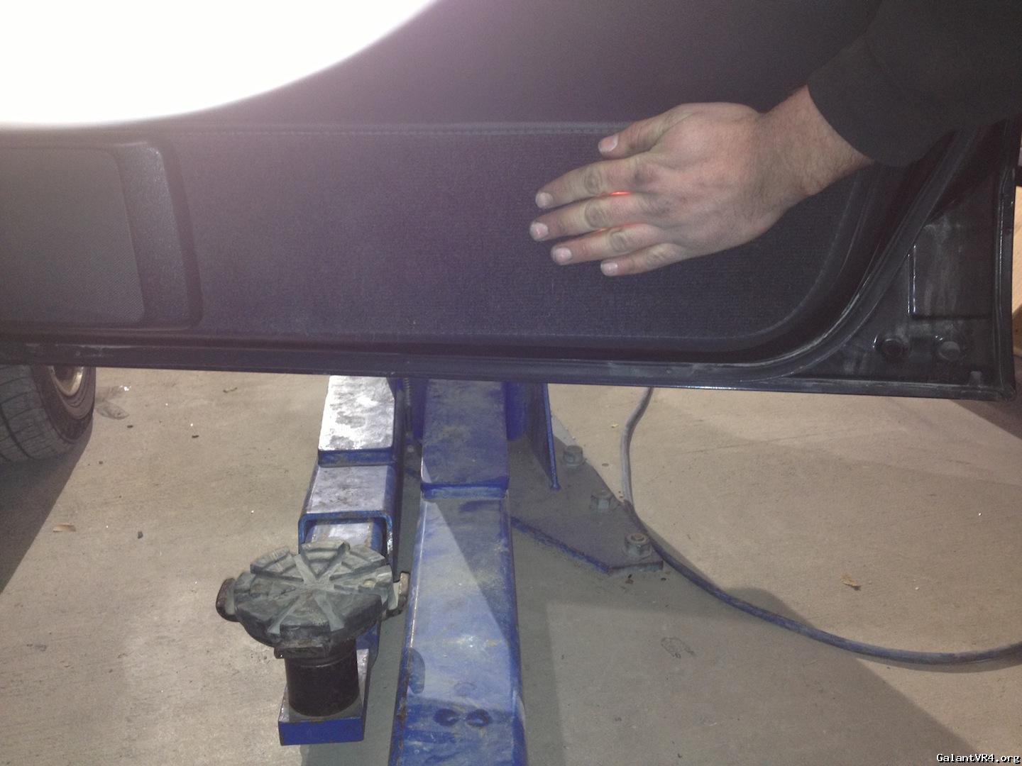

I have underbody pics the previous owner sent me. Here are some I saved. The only rust he said that was worrisome was on the bottom of the front doors which seemed very surface like. By no means am I saying the previous owner pulled one on me either. It is very localized and well hidden. Its just my dumb luck.
